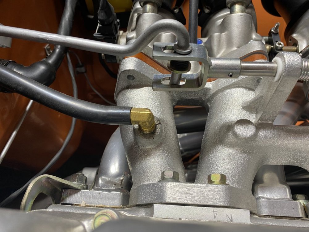

It was a great job for a very wet Sunday in the shed with the heater on and the footy on the radio. I used a 5/8 barb to 1/2 bsp elbow. Drilled out two washers to size then placed one on either side so as to spread the load on the filter cover. I cut the nut section off of a 1/2 female to 5/8 bsp nipple and used it to secure the lot together. After it was all together I drilled a 1mm hole through the bsp section of the elbow and installed a split pin through it to stop the nut coming off. I also used a fuel comparable sealer to help hold it all together. It shouldn’t go anywhere. Unfortunately I forgot to take a photo. Jeff

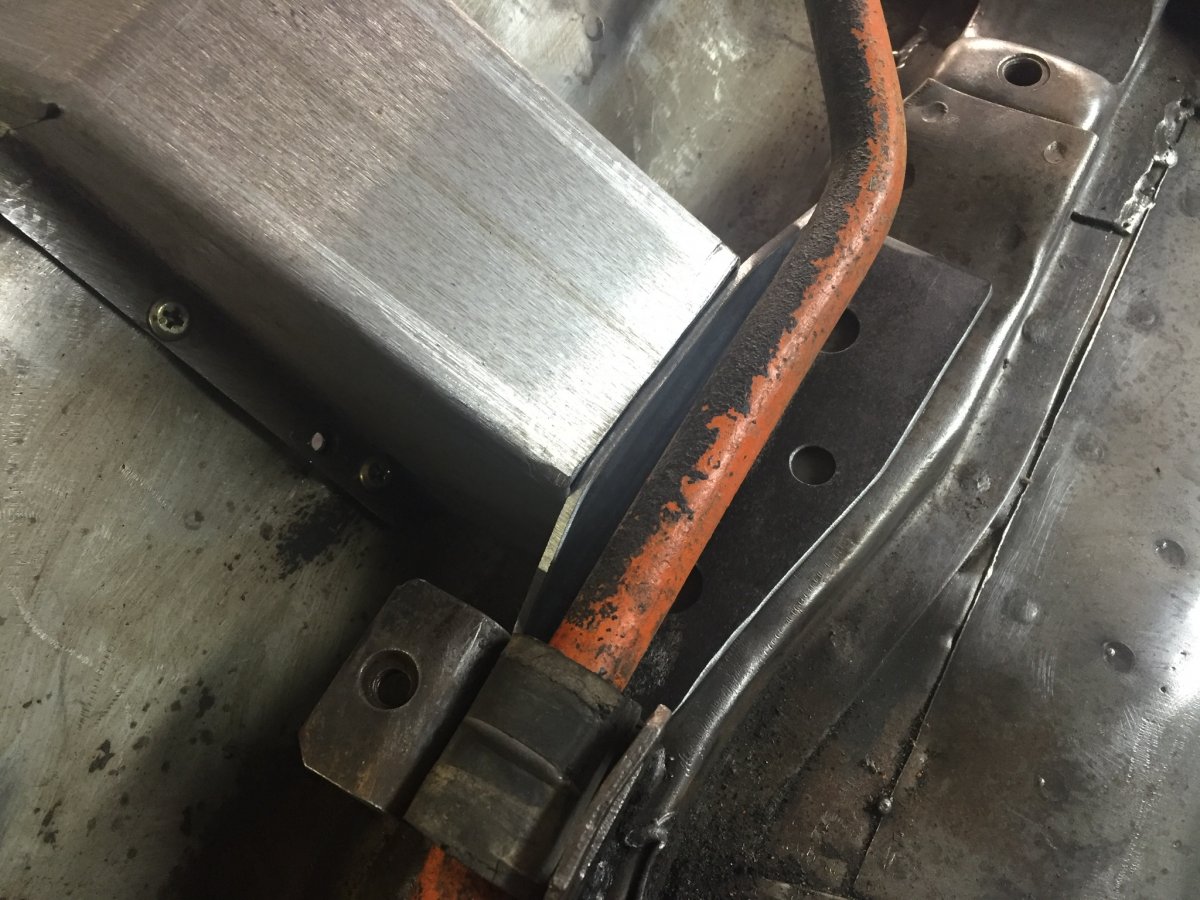

The angle is to box in the end of the extended rail and support it onto the cross sub frame. Basically attempting to replace what has to be cut out without fouling the sway bar. Not to support the sway bar in anyway. Jeff -

With the extended floor rails as they are you will not be able to mount the rear anti roll bar in its original position. You can either modify what’s been done or simply run a rear mount bar. Jeff this is what I did. -

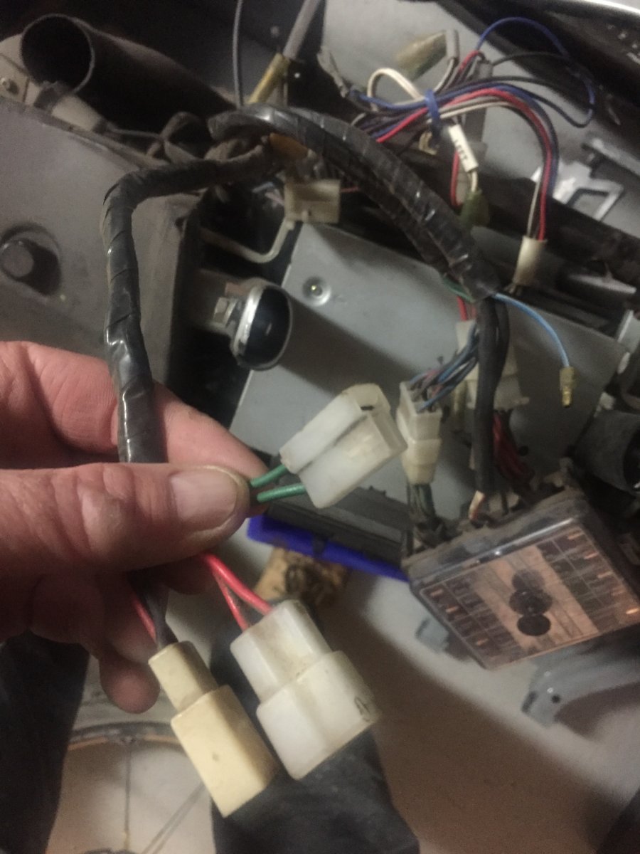

I picked up a wire (sorry cannot remember witch one) at the fuse box that was active when the ignition was turned to position 1. It was in the loom. I used this to tell the computer that ignition was on. Then ran the fuel pump output through a manual switch on the dash into the plug in the picture. Using the wire in the harness to connect to the in tank fuel pump. Im running EFI. The separate switch is a safety and anti thrift device so you cannot just start the car. If you have a dig around with a meter I am sure you will find the a wire that is energised with the ignition. Jeff
If you are mounting the pump under the car at the tank there is already (normally) a wire (Green) in the std harness that is for an electric fuel pump. Runs from a plug at the fuse box to the tank with the fuel gauge sender Jeff
