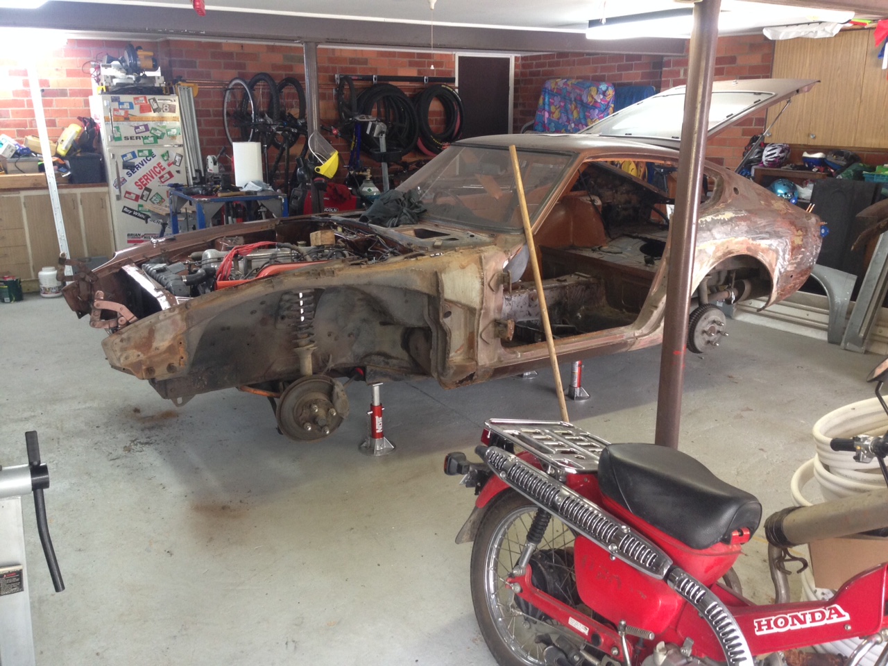

  1. Sometimes priorities get a bit compromised. Like going shopping to get food or work on the Z car. Spending time with she who shall be obeyed or working on the Z car. Doing some gardening because Mother is coming to stay this week or working on the Z car. You get the gist. All of this resulted in a very short time in the shed this weekend. So after putting the lamb roast in to slow roast at 12.30 today I made the shed at 1.00 pm. As it turned out, a productive afternoon was had by myself with able supervision from Rocky the Labrador. First thing was to re fit the passenger’s side door to be sure all was aligned. Then the rear guard was re fitted after some primer was applied. It was removed and re fitted several times before being fitted and cut with the angle grinder. Removal and drill holes for the plug welds and then re fitted and removed again. A re fit and then some tack welding. I’m happy with the outcome. I also made some copper weld helpers that came in handy during the process. Managed to get Max our son to give me a hand during the welding process as it was proving difficult not having disjointed elbows and longer arms. Photos are attached.

  7. Thanks Boys Catching up on brownie points today and some paperwork so not much action in the shed. I have been using a "renovator" with an assortment of blade type bits to remove the underbody. It is very effective. Took about 15 min for each floor section and about 20 min on the inner wheel arch. You can see the before and after in the photos. Inner and outer guard are a Tabco product via The Z Store from Merica 30-7301 Fender Repair Panel, Left, 70-78 240Z-260Z-280Z 1 $47.95 30-7302 Fender Repair Panel, Right, 70-78 240Z-260Z-280Z 1 $47.95 30-7307 Inner Wheel Arch Repair Panel, Left, 70-78 240Z-260Z-280Z Coupe 1 $137.98 30-7308 Inner Wheel Arch Repair Panel, Right, 70-78 240Z-260Z-280Z Coupe 1 $137.98
  8. And a few more photos

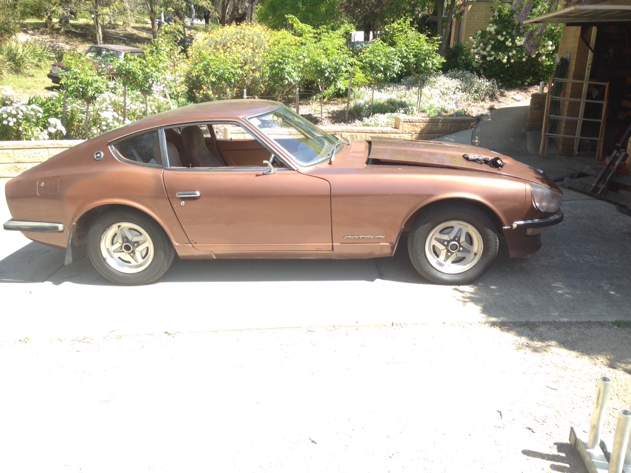

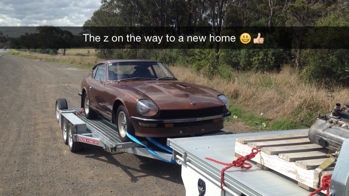

  9. Time to start a build thread… I purchased this car in October 2014 from Dolls Point in Sydney from an Ebay seller. It looked ok but upon inspection in person it had all the usual early Datsun problems with rust etc. The car ran quite well with a newish L26 having been fitted at some stage. The car also came with the original matching numbers L24 motor (This is probably what clinched the deal for me). The car is rusty but not as bad as some, I probably paid a bit too much for it but it’s all there and its only money after all and you cannot take it with you. I picked her home in late October and so the journey begins First thing I did was to fit new tyres, cleaned a few things up and took it to rego inspection in November to see what would happen. It failed on two items, rust in the drivers floor (not the only place but only place that seemed to matter) and the turn indicators not flashing fast enough (they worked but are a bit slow, like me) With Christmas then holidays for most of January and a work trip nothing much happened until March 2015. After getting our shed organised, cleaned out and purchase of some equipment, work has now started in earnest. After closer inspection of the rust and mechanicals a clear path has been set and the wheels are now in motion. Lots of parts have been ordered components removed cleaned and shipped off for repairs or modifications. I decided to start work on the passenger’s side (good place to practice as I won’t see that side as much) The Sill has been removed and replaced, Most of the sound proofing has been removed (renovators are an amazing tool for this). Rear quarter is next in this area with a new outer cut and inner guard to be fitted. Struts have been removed stripped cleaned up and sent to MCA for Josh to sort out. Gearbox and Diff have been removed had years of gunk cleaned off and shipped to LCR (the original L24 will also go south) I will try to keep this sort of up to date but I would rather spent time in the shed, not on the computer…..

  11. Hi guys. I must confess to have been lurking around the forum for some time now. I have picked up some great information as I have gone about getting ready to firstly get a Z, secondly start to get ready to do some work on it (lots of work) and now carry out that work. Don’t expect me to post much as I would rather spend the time in the shed than on the computer . I purchased a Brown Metallic car from Sydney that was advertised on evelbay last October. It was presented as a “Dry Country Car” (good joke). If it could only talk it would have tales to tell. It is in need of lots of work but it was all there and ticked the boxes that I wanted. It actually only failed rego on two things when I got it back to Canberra. The indicators flashed to slowly and the rust in the driver’s floor was just too much for the garage man to pass. At some stage Ill post a build thread but to date it’s been stripped down and I have ready for installation new floors, new complete full length rails, new sills, new seat mounts, rust repair panels for the both rear guards. I have started fabricating some new sections around the rear lights (bugger of a job this). I am about to pull the brakes off to get them sorted, the struts are bound for Mr Coote and if Mr Collins has time a few items will be heading south. Regards Jeff
