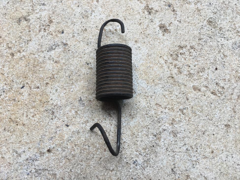

Hi all. I'm in need of this spring that supports the hand brake cable on a 240Z (don't know if its the same for 260Z and 2+2). The spring hangs from the high point of the body above the diff and clips on to the hand brake cable to support it and keep it from falling onto the driveshafts. My car only had one on it when I got it. Looks like this: Melbourne hopefully! Thanks. David
