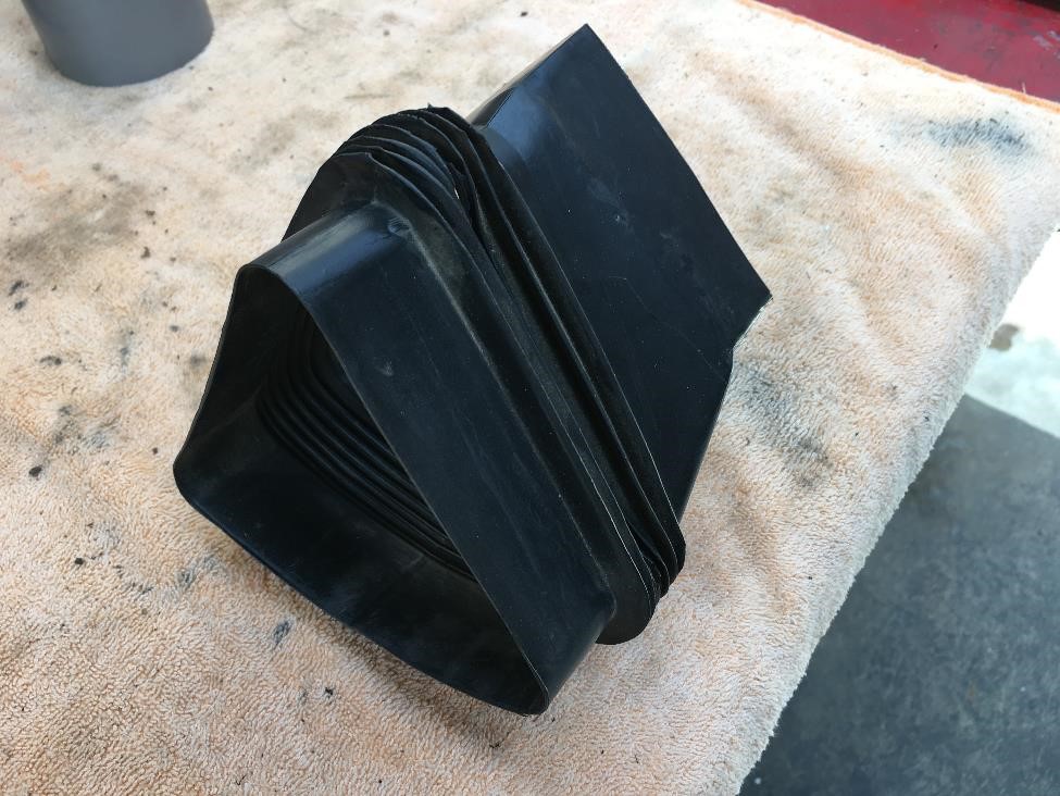

  13. Ripper, thanks Andy.....that's much better than mine which is split in the bellows region. PM me how much and to post to 3154. Cheers

  16. As the title says....mine is split so need another. No idea if the same for 240 and 260....anyone know? Cheers. David
