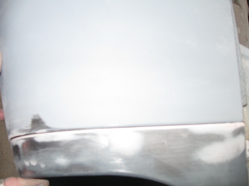

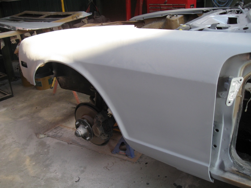

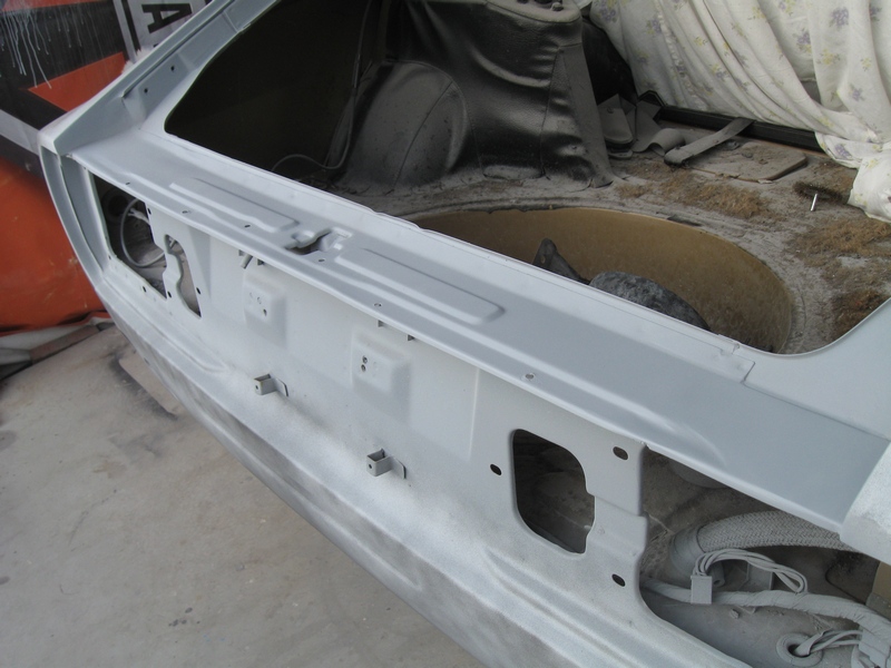

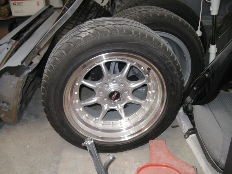

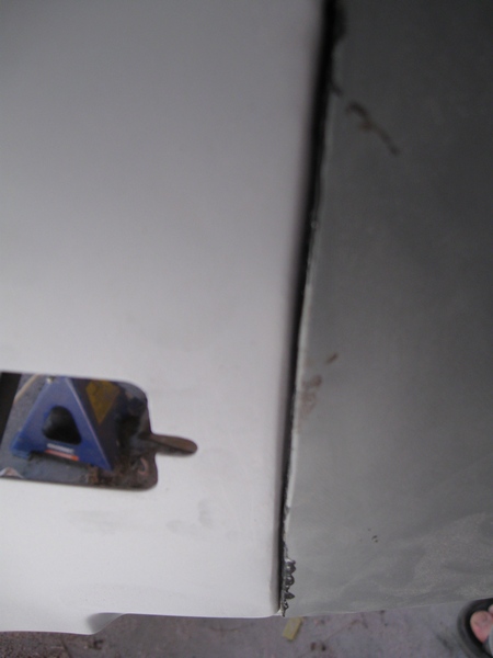

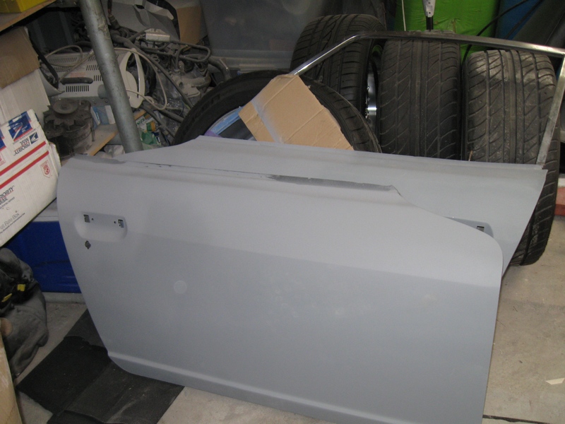

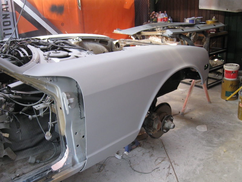

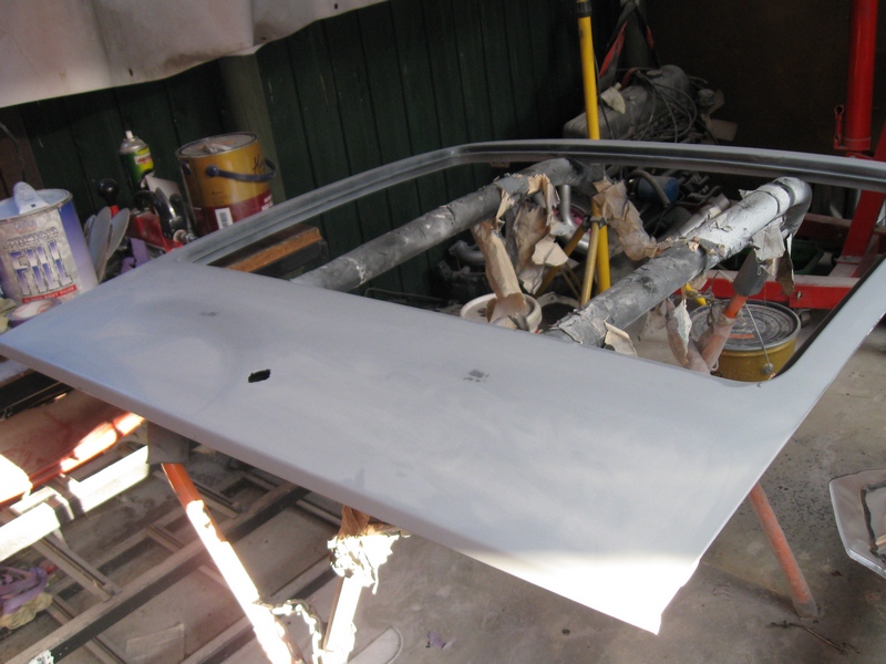

reverendzed Posted February 21, 2010 Author Posted February 21, 2010 Thought that it was time for an update. I underestimated the time I would need to spend on the Ol' fashioned 'hammer & dolly' work on the guards I think I probably spent about 10 hours per side and probably 5 hours per side on the doors! But after almost giving up I'm happy with the result. Just got engine bay left to do and inspection flaps and I'm ready for a bit more Polyester high fill, run back, prime and topcoat...not long now. Also got the rubber on the new wheels and it looks ok! Rev. Quote

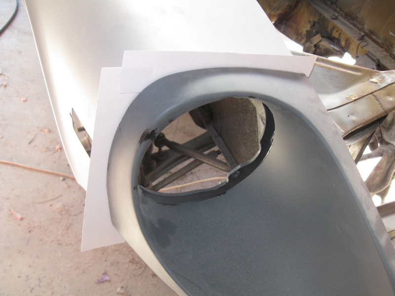

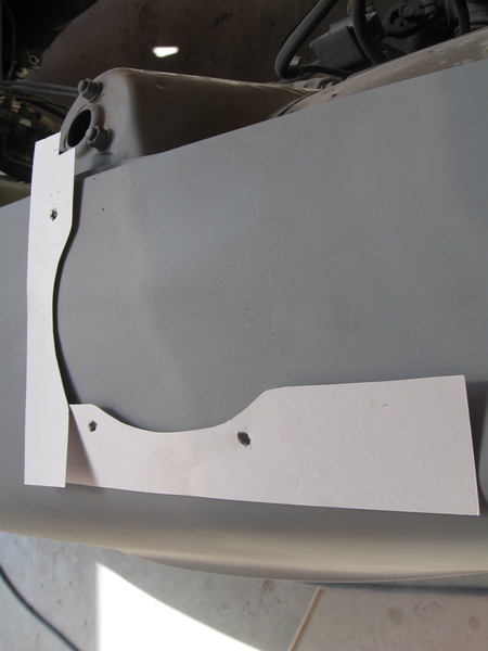

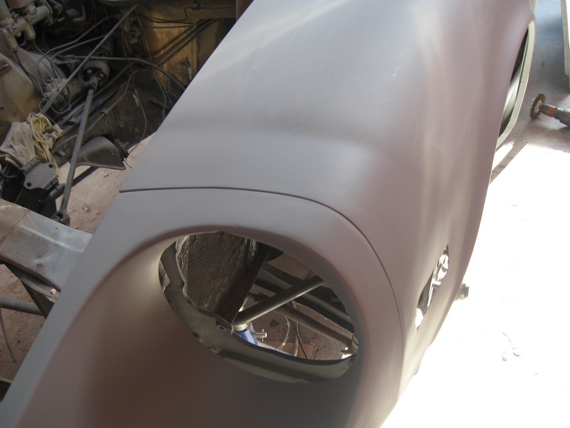

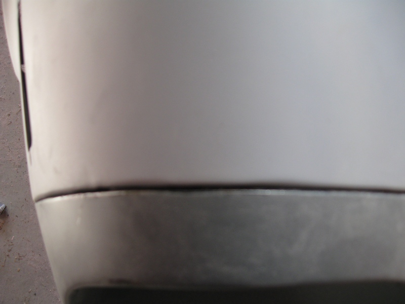

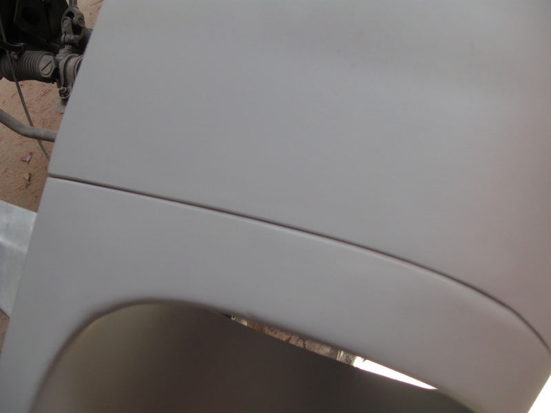

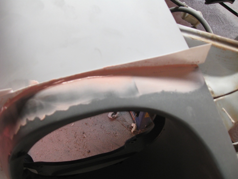

reverendzed Posted March 2, 2010 Author Posted March 2, 2010 Well I had some fun on the weekend, went to fit up the headlight buckets onlt to find that like most Zeds there was uneven gaps between the fender and the cone...so I came up with an idea that worked fantastic. I thought I would post some pics in case anyone else encountered the same problem. What I did first was to make a template out of thick card that would protrude about 2cm around the guard and bucket, I then bolted it together and applied body filler up to the card on both sides. When this had hardened well I then did a rough sand to remove most of the excess filler. I then removed the bucket from the fender, removed the card (carefully) and then reattached the bucket. Then using a hand flat sander made sure that I sanded accross the fender and bucket to make sure they were even. Separate the bucket again and sand a small chanfer (beveled edge connecting two surfaces) on the bucket and guard. Prime both surfaces and reattach...and presto perfect gaps with factory appearance. Quote

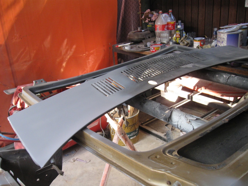

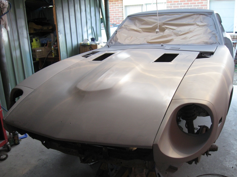

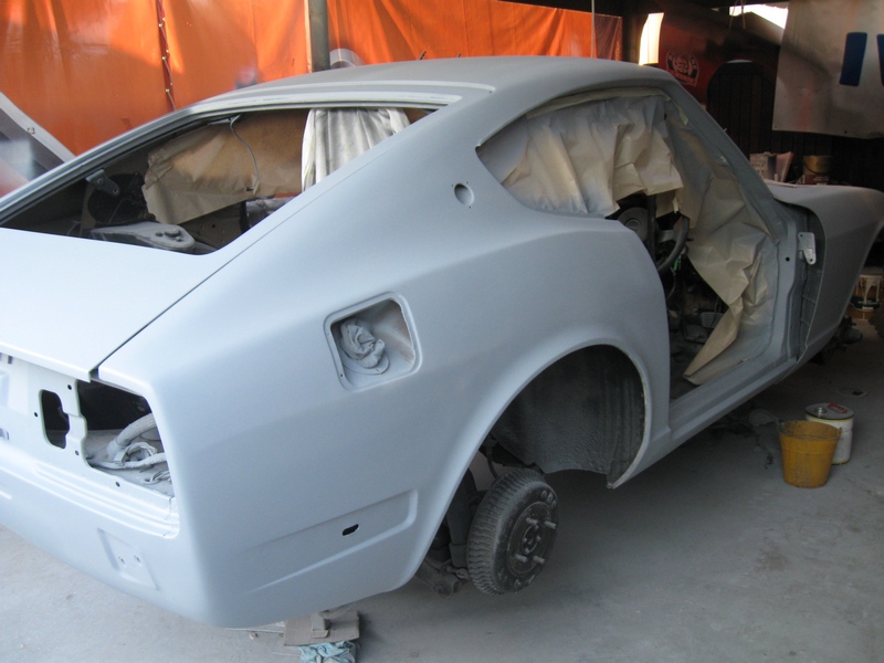

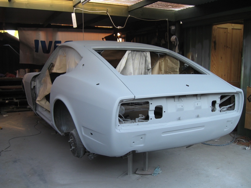

reverendzed Posted March 12, 2010 Author Posted March 12, 2010 Last coat of primer, ready for final sand on the weekend and paint hopefully next week! YAY!!!!! Quote
Sirpent Posted March 12, 2010 Posted March 12, 2010 Hey rev Looks great, so this is the primer over the EP? How did you find sanding the EP back, was it worth the time and effort? Cheers John Quote

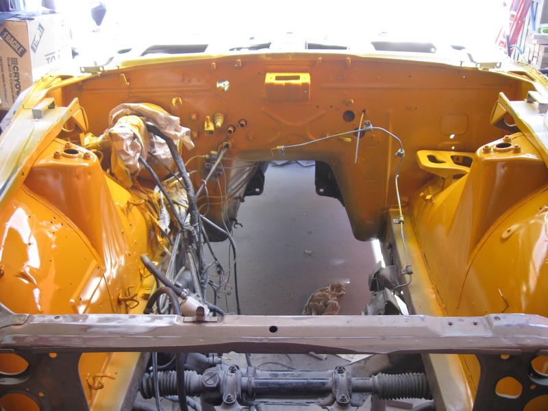

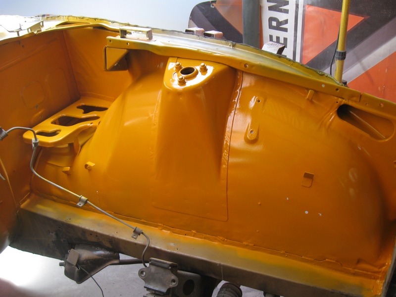

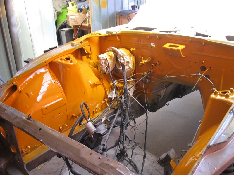

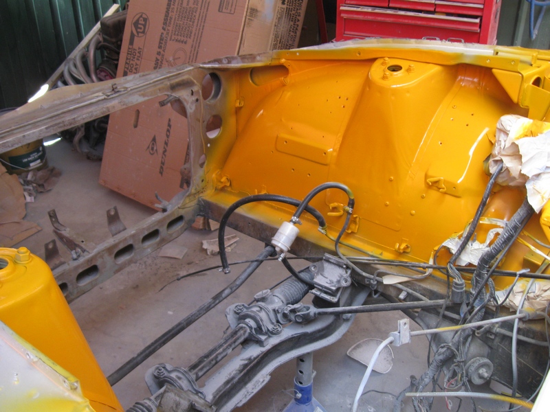

reverendzed Posted March 13, 2010 Author Posted March 13, 2010 Thanks for the encouragement. The EP is fantastic and a real winner in getting a smooth substrate. Couldn't help myself today had to lay down some color, so now everyone knows where this is going. The color is FORD OCTANE ORANGE and yes it is in your face! Rev. Quote
Sirpent Posted March 13, 2010 Posted March 13, 2010 AHHHHHHHHHHHHHHHHHHHHH My Bro from Sydney is going to creme himself when he see's this Rev, thats the color he wants although I have got a very similar color on a Lambo posted in my Gallery which he also likes. Nice Rev, very period but very contemporary also. Is it 2K or acrylic? Im about to head into the bedroom with my girlfriend also and see if I can finish the nose today and tomorrow........... Cheers John Quote
reverendzed Posted March 13, 2010 Author Posted March 13, 2010 Hey John...yeah I hope once the whole thing is done that I don't feel it's too much, anyway add some chrome on the exterior and a full new interior with lambo style seats and it should look the goods! I'm using Acrylic, under the bonnet I put some retarder and use Aclac for thinning and it holds quite a good gloss, I can't be bothered trying to sand and cut that back. Have fun with your Zed today. Rev. Quote
