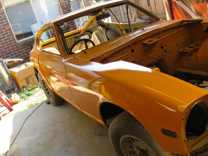

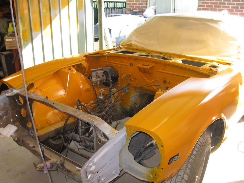

reverendzed Posted March 21, 2010 Author Posted March 21, 2010 Got the whole car painted. Now to color sand then final coat of color and 3 coats of clear. Then sand again and polish. The countdown is on! Quote

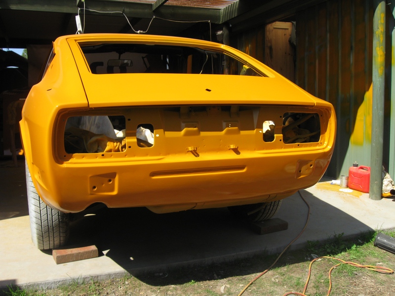

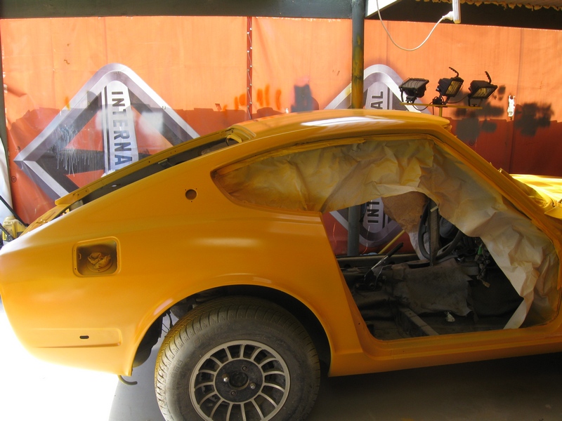

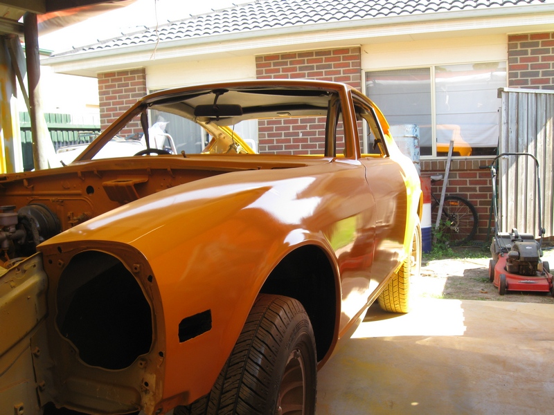

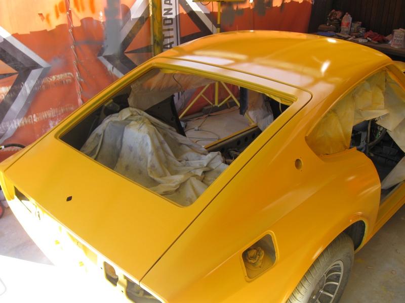

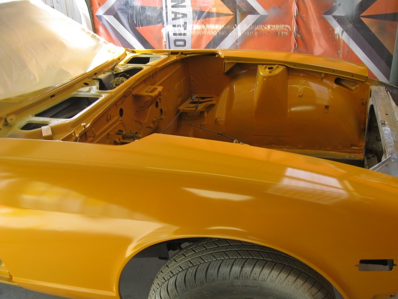

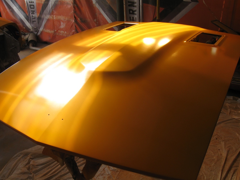

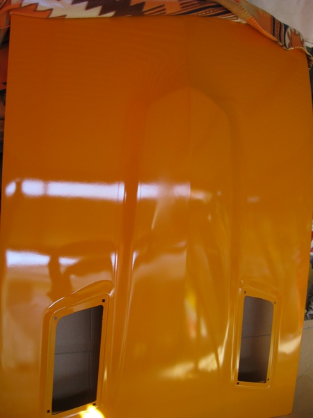

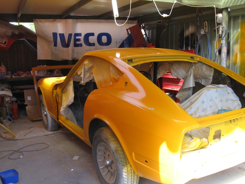

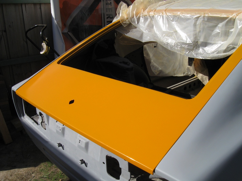

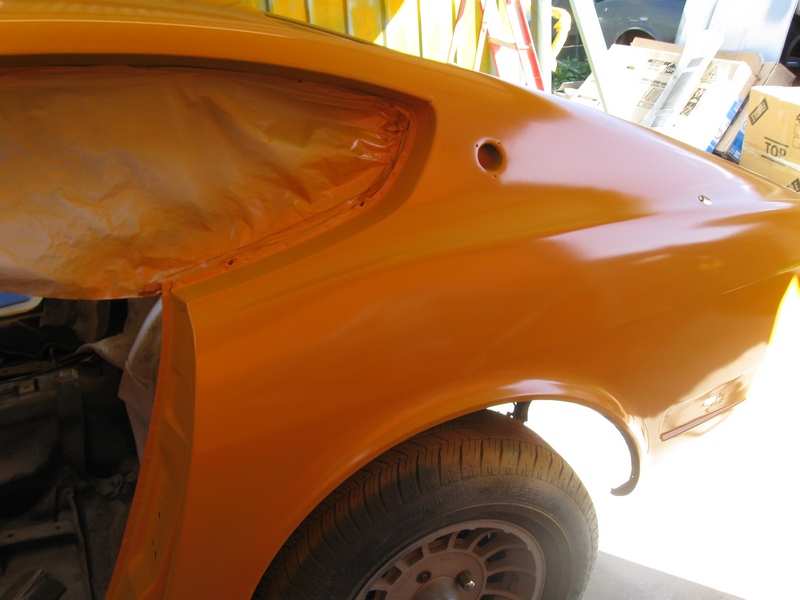

reverendzed Posted March 25, 2010 Author Posted March 25, 2010 Here's the final shots of the finish (pre final sand & polish) this color was a hard one to get coverage! it took 6lt of Acrylic and 3 lt of clear all up, which equates to about 5 coats of color (wet sanded after 3) and 2 coats of clear. I'm pretty happy with the results and once again a whole lot cheaper than a paint shop! The great thing about painting yourself, if you take the time you can get an orange peel free, high gloss, repairable finish. that you can touch up anytime! I will now leave the paint until everything is finished on the interior and motor goes back in. Acrylic is best left to harden for as long as possible before it's cut and polished. Rev. Quote
