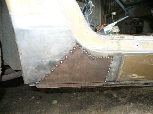

Zedback Posted April 19, 2009 Posted April 19, 2009 Let me know if I'm boring people... Not boring! More rust, more welding, where's that door skin walk through? More intricate Z nerd detail please. This is the closest thing to satisfaction I'm getting since going back to work. Quote
C.A.R. Posted April 19, 2009 Author Posted April 19, 2009 http://www.viczcar.com/forum/index.php/topic,4189.new.html#new Just coz you asked so nicely mate Quote

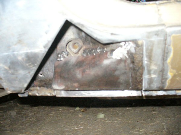

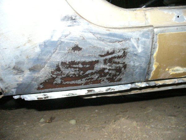

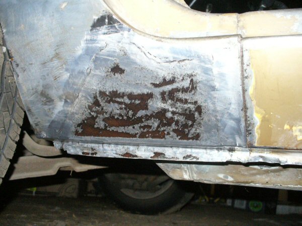

C.A.R. Posted June 8, 2009 Author Posted June 8, 2009 I finally finished the rust repairs this long WE, but between the on again/off again weather & the olds having a very distracting 'Inebriated Geriatrics Party' I really didn't get a lot done... Unfortunately one edge I welded did 'suck' in slightly even after cooling the weld down (damnit!), so it'll require a thin skim of filler (BTW my new toy is teh awesome!!!) Quote

Zedback Posted June 10, 2009 Posted June 10, 2009 Well done Lurch, looks very neat in the photos Unfortunately one edge I welded did 'suck' in slightly even after cooling the weld down (damnit!) Don't forget it is a 30 year old Z, not a new toyota! I need to make some decisions soon... Half your luck! Quote

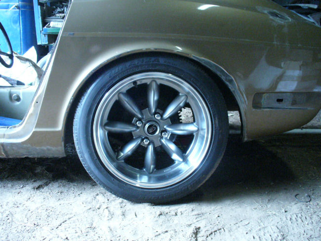

C.A.R. Posted July 4, 2009 Author Posted July 4, 2009 Thanks to Dimitri I now have a pair of 225/50/17" tyres. I had them mounted on the Rota rim's, removed the rear springs on the Zed this morning (to get the car low enough) & trial fitted the wheels on the Zed to see how far I need to pump the rear guards... It doesn't look like I'll need to pump them out far - maybe 20mm at the most (after I roll the lip up/back). Pic is at the desired ride height - now to start playing around with pumping the guards... Quote
NZeder Posted July 4, 2009 Posted July 4, 2009 Looks good Lurch. I have 16" as I did not really like the look of 17" on a zed as they always look over tyred IMHO however this is the first time I have seen 225/50/17 ie a larger side walls and it does not look as over tyred as I thought. So I might have to get a set of Rota RB-R from Ben in the 17x9.5.......hmm will have to think about that....more tyre choice in the 17" these days vs the 16's with only limited 245/45/16 to chose from. Quote
Scando Posted July 4, 2009 Posted July 4, 2009 Looks like a good fit. The Rota RB offsets sure suit Z's well Quote
RB30X Posted July 4, 2009 Posted July 4, 2009 Did you ever end up making a flared gaurd template out of cardboard to see what sort of shape you need to cut and press?? Unless that was someone else. I've been thinking of whether to pursure making my own steel weld on's. Quote
C.A.R. Posted July 4, 2009 Author Posted July 4, 2009 No I don't think I'll be needing a template - just a tape measure to see how far they have to be moved. Quote
Moderators Zedman240® Posted July 4, 2009 Moderators Posted July 4, 2009 My, the 225 50's certainly fill out them guards! If you wanted to use the 50's instead of the 45's the rolling radius of the 45 series is 317.15mm compared to the 50 series 328.4 according to a site that I frequent for anything to do with wheels and tyres; http://www.carbibles.com/tyre_bible.html which will mean you will be a bit faster than what your speedo is showing. Original zed tyre (based on the 195 70 14" RR is 314.3mm) Check your tyre sizes at that site to make sure its all within tolerances. You will find that rolling radius calculator on page 2 about a quarter down. Quote
