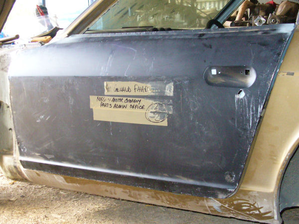

C.A.R. Posted March 17, 2009 Author Posted March 17, 2009 It's got a bit of Metalic in it now Shane, so I dunno Rev. Dave has offered to paint it for me (after I badgered him to do it ) & it'll be painted in Acrylic - so nothing fancy. Also, I've finished the PS door! It's not perfect, but by the time it's been high-filled & painted it should be good. Now onto the DS door! Quote

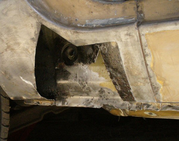

C.A.R. Posted April 13, 2009 Author Posted April 13, 2009 I'm now onto the last bit of rust that needs repairing - the DS dogleg. I need to fab up a new inner section first, then the outer panel can be welded back into place. Quote

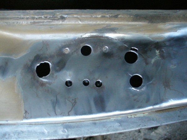

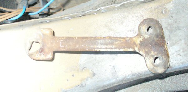

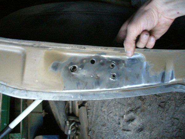

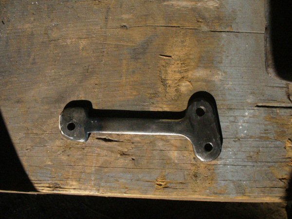

C.A.R. Posted April 14, 2009 Author Posted April 14, 2009 While I was waiting for the old man to finish with the angle grinder, I decided to remove the door catch - it turned into a right PITA... The plate behind in the C piller was fairly fooked... I found that there was no thread left in the top hole & there was a seized bolt which I had to drill out. So I decided to remove the plate to fix it properly... Two spot welds drilled out & the plate fell out the bottom (where the sill is open atm where I'm repairing it). So I welded up the holes & redrilled/tapped 6mmx1.0 them - just have to replace the plate now Let me know if I'm boring people... Quote
