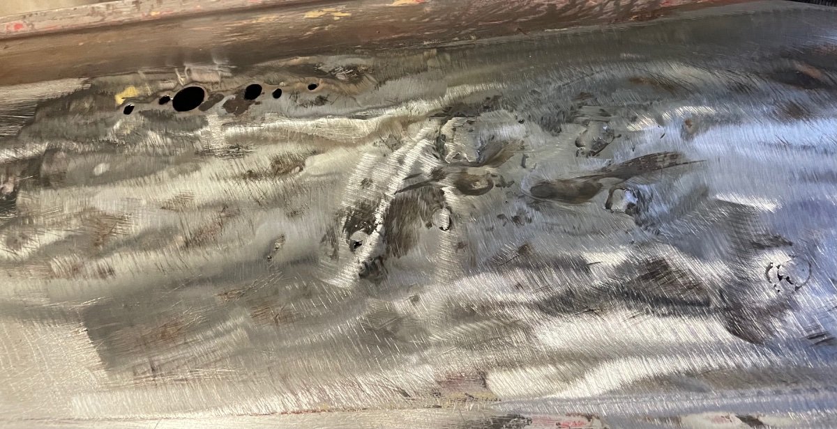

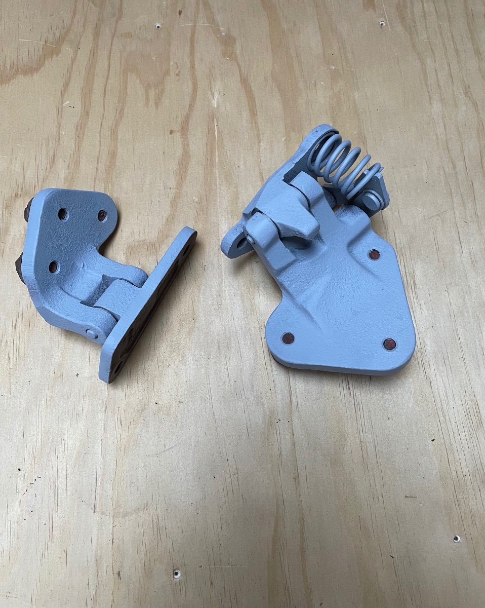

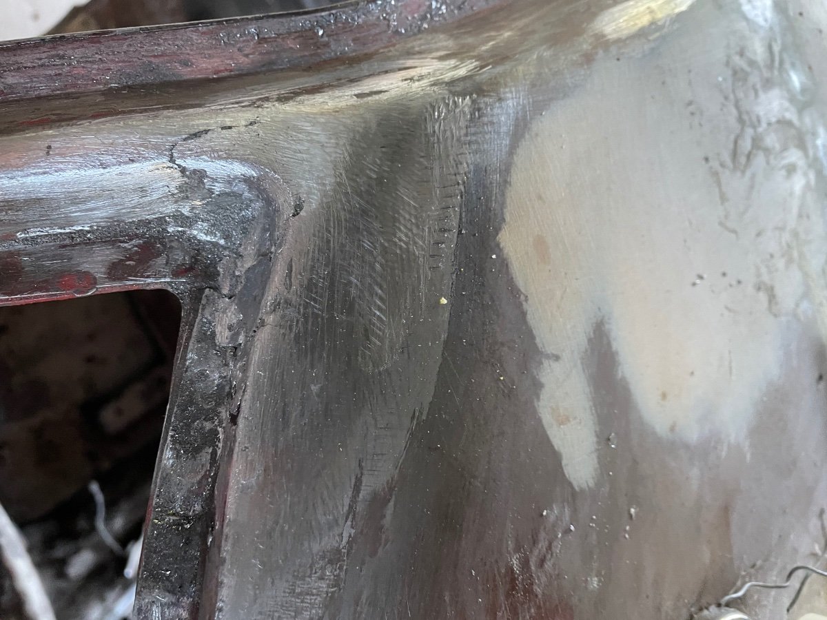

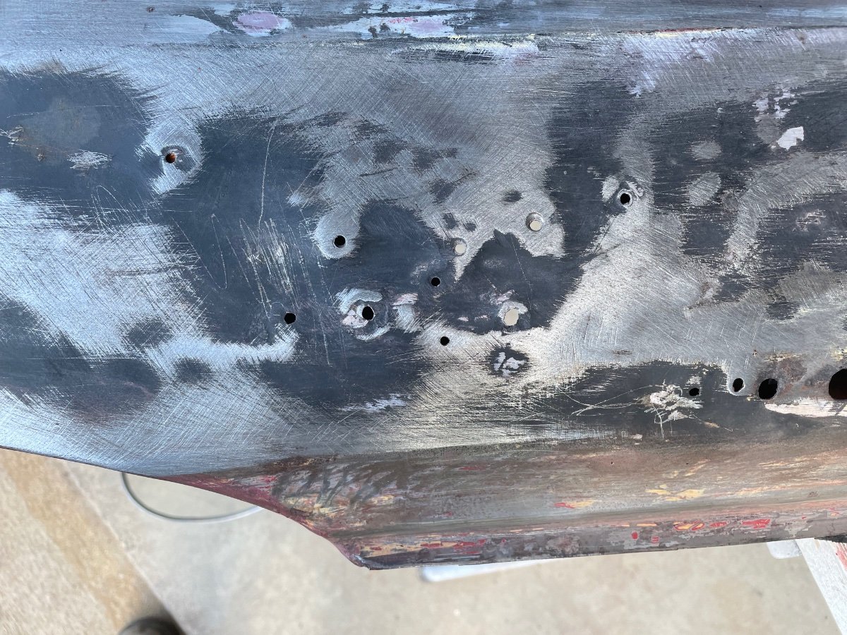

NickF Posted April 16, 2022 Author Posted April 16, 2022 (edited) A few bits sorted over last couple of months Rebuilt drivers side hinges, repaired top of screen surround drivers side, cut out rust and repaired both doors Removed a 2.0lt bucket of body filler from doors and removed most of the dents, used a shrinking disc on high spots works pretty well welded up holes that had been left from slide hammer. My welding is pretty ugly but seem to be solid think I might try .06mm easier on thin metal??? Edited April 16, 2022 by NickF Quote

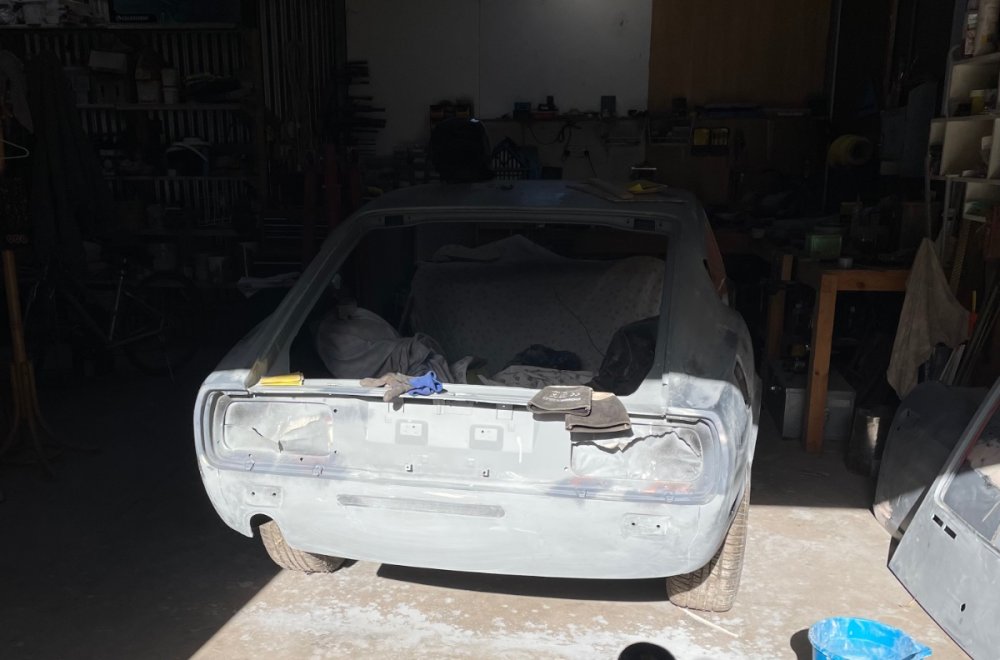

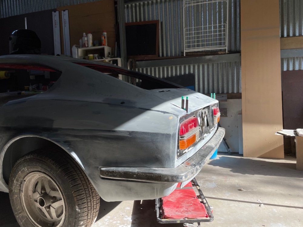

NickF Posted June 18, 2023 Author Posted June 18, 2023 Its been a long time but thanks to the help and generosity of Lochy at C.A.R I've finished the rear valance and rear 1/4 repairs. Lochy fabricated the valance and supplied the trim clips. Without the clips I couldn't moved forward as I couldn't position the trim. The job would have been so much easier if I had a car to reference as photos are not really good enough, getting gaps right and shaping the rear 1/4s was tedious. Now that the rear is in primer I am torn between keeping the car original 905 red or going for a grey not metallic (very popular at the moment)???? Plan to move on to repairing floor pans (Keep as much original material as possible) OdinZ, gav240z and 240ZBUILTBYME 3 Quote

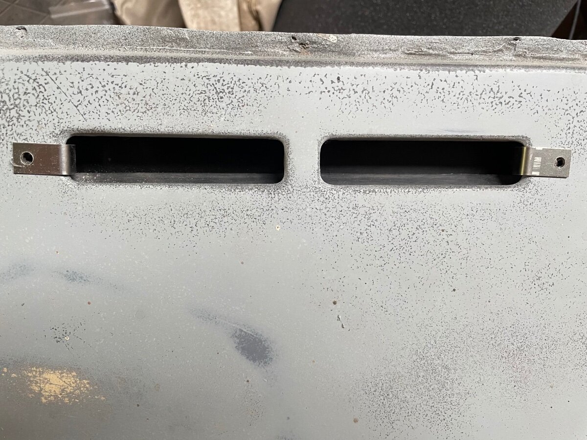

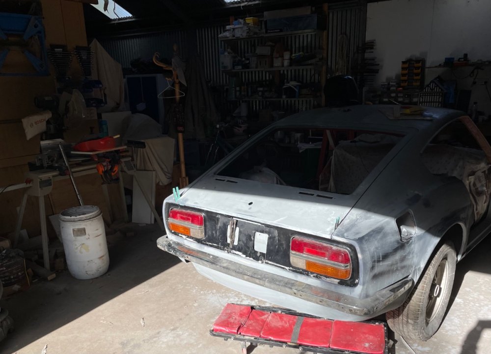

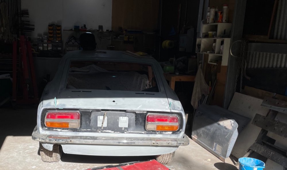

NickF Posted December 17, 2025 Author Posted December 17, 2025 Been a long time but have been chipping away Repaired dash just need to texture Tidied steering wheel Body work all done managed to get 5mm gap all round In the process of sorting out the rear hatch venting system I need to source some barrel clips (same as the ones that hold on the emblems?) and some speed washers, Nissan have discontinued, so will have to find some generic ones. Need so many small bits and pieces that are not available in Australia and the postages costs from Europe and the States are so expensive. Lucky the only panels I've had to replace are the bonnet and rear valance Hoping for paint by end Jan. C.A.R. 1 Quote
C.A.R. Posted December 17, 2025 Posted December 17, 2025 You should have the hatch vent P clips in your possession by now. The barrel clips can be bought from Nissan (last time I checked). Quote

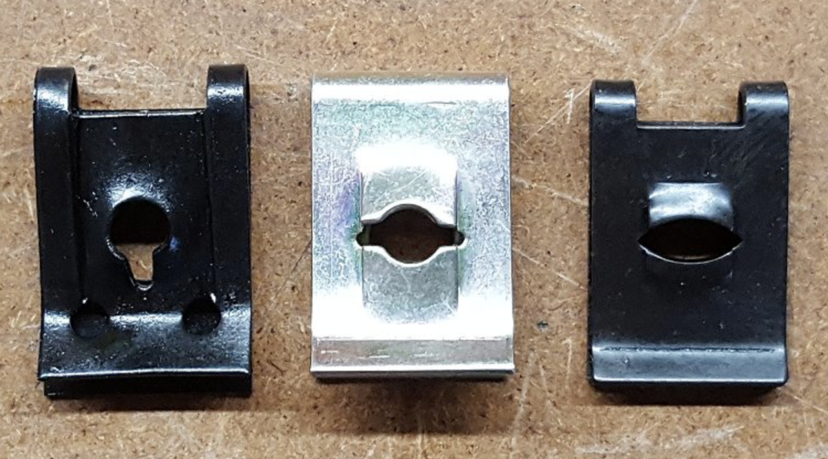

NickF Posted December 17, 2025 Author Posted December 17, 2025 51 minutes ago, C.A.R. said: You should have the hatch vent P clips in your possession by now. The barrel clips can be bought from Nissan (last time I checked). Thanks clips arrived barrel clips on back order, need some speed nuts 08961-43210 no longer available guess generic nut would do? middle on is genuine Also need to source some foam Thanks again you have been a great help Merry Christmas Nick Quote

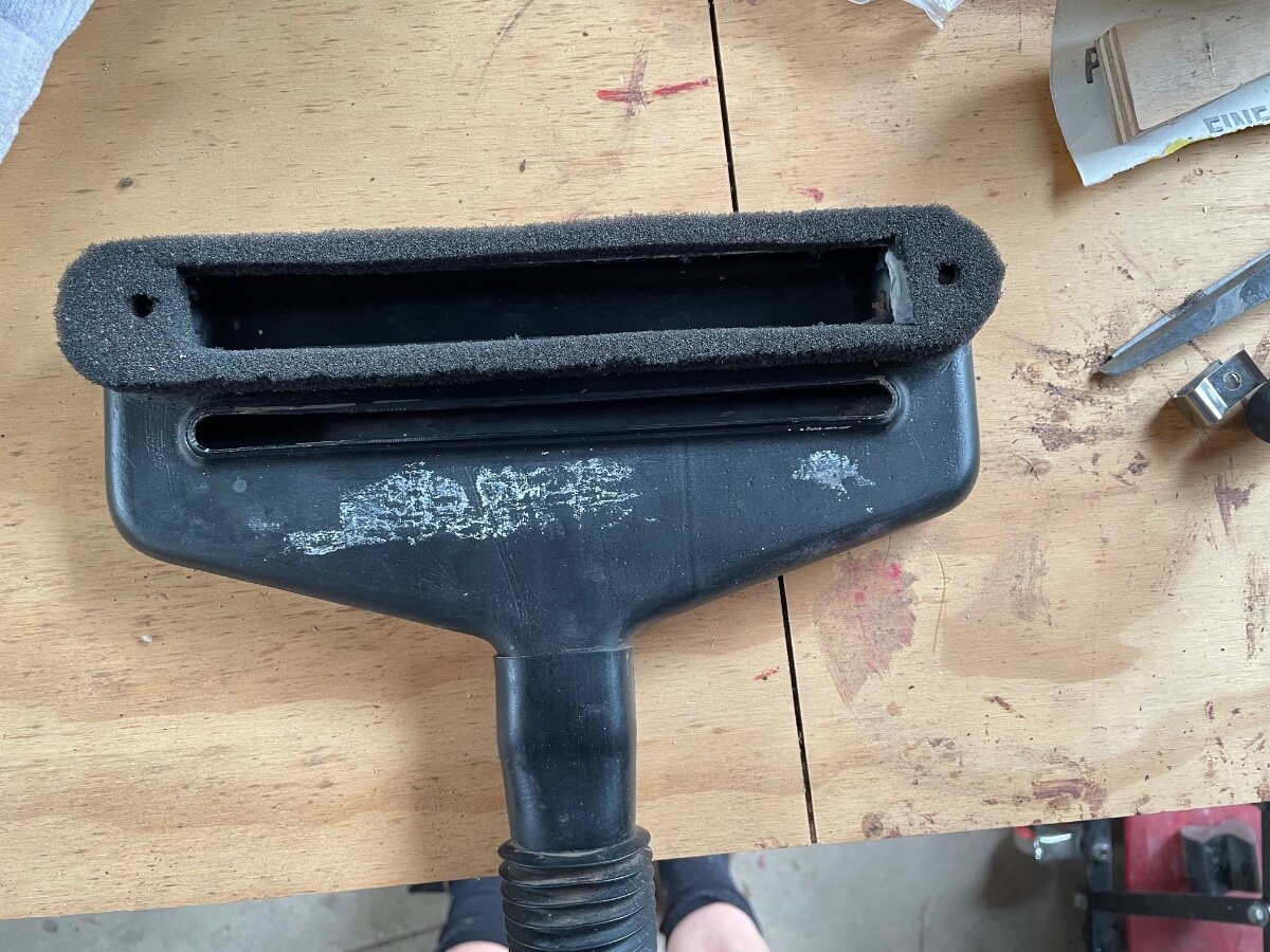

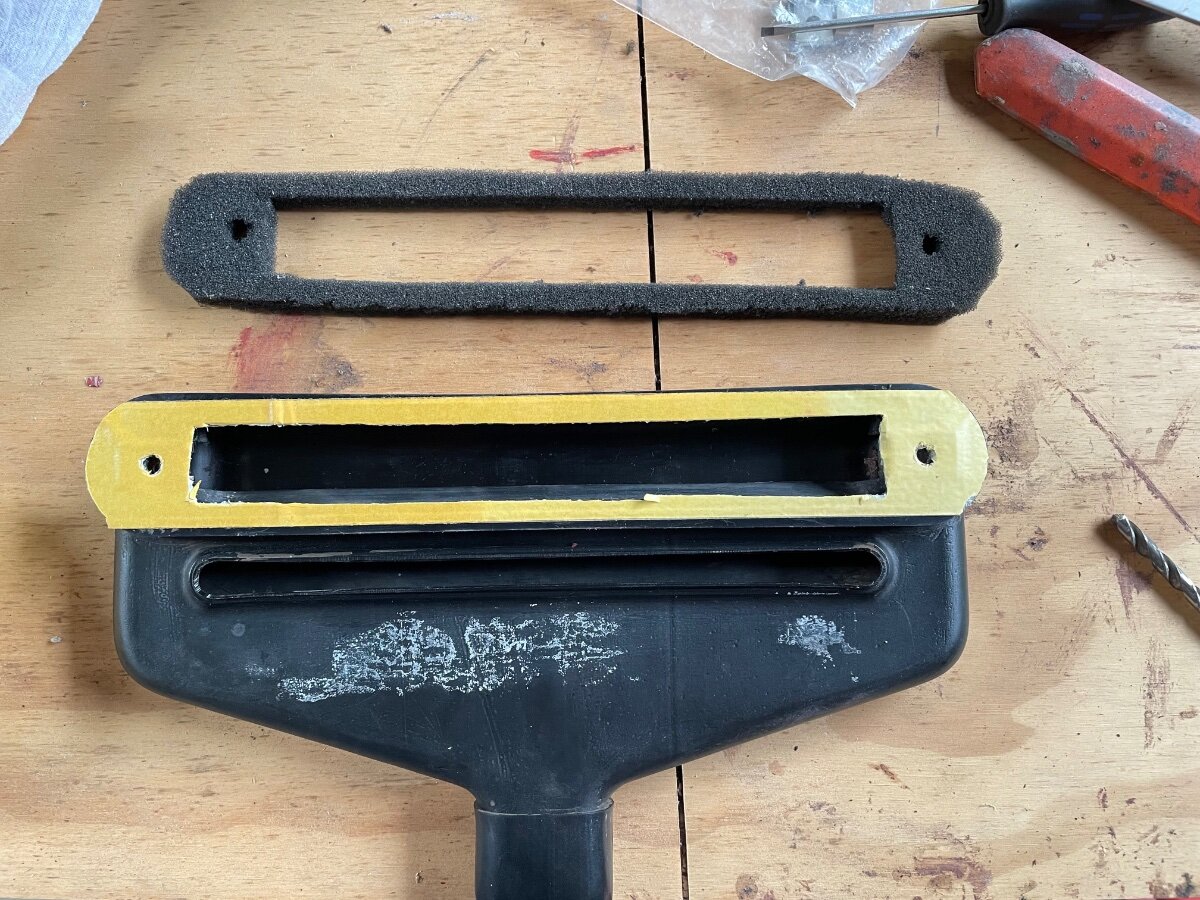

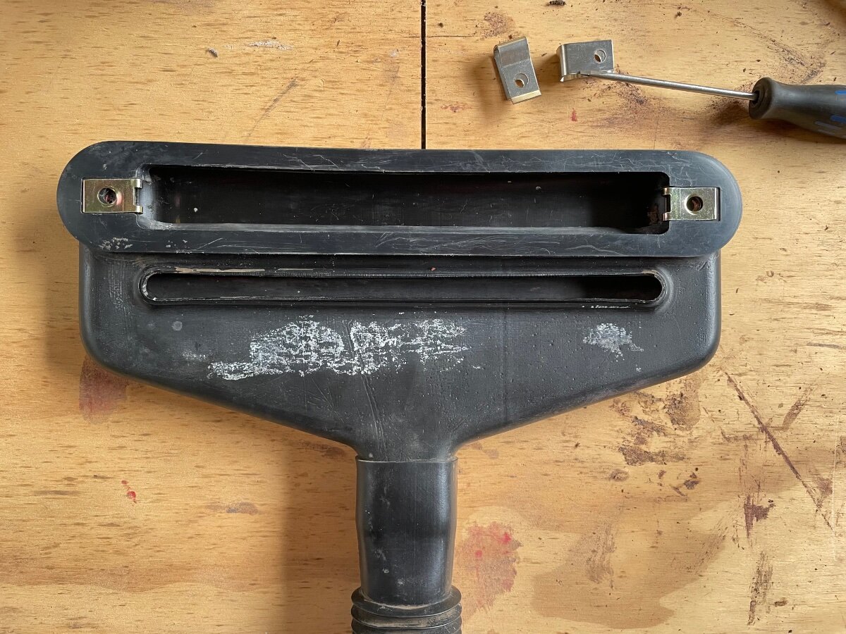

NickF Posted December 19, 2025 Author Posted December 19, 2025 A small achievement cleaned and rebuilt a hatch vent. The plastic/rubber components where all good but painted and dirty, they cleaned up ok I got some generic speed nuts that fitted Used some 8mm open cell foam and cut it to size and stuck down with double sided tape. I will have to repeat this step as the tape stuck the speed nut so it was hard to jiggle into position for fitting the vent. Satisfying couple of hours Its easy to see how the cost of restoration builds up. 4 clips to hold components to hatch $110 Speed nuts $18 2 packets Barrel clips 4 $16 Vents $150 Had the foam and tape Nick C.A.R. 1 Quote

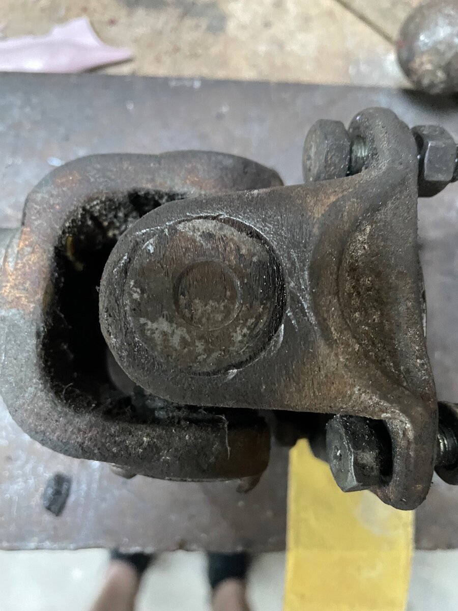

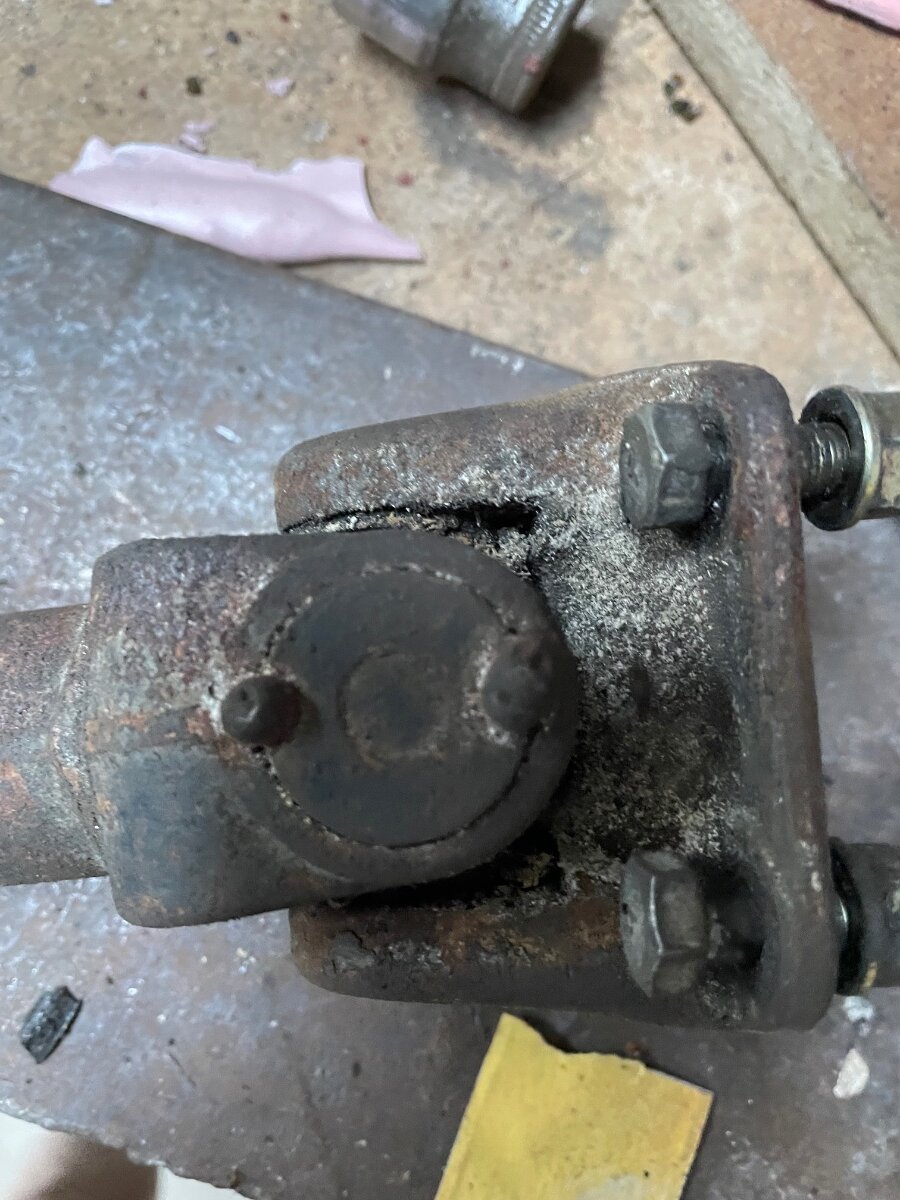

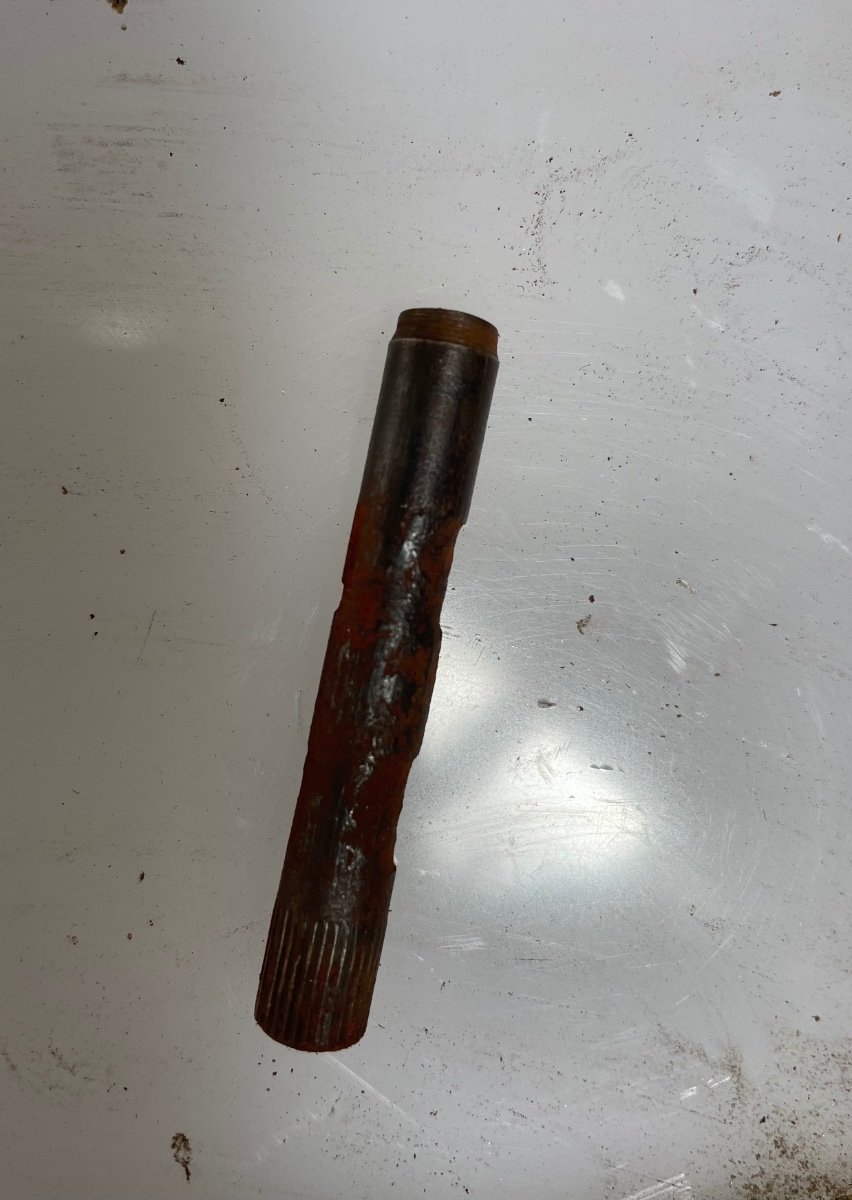

NickF Posted December 27, 2025 Author Posted December 27, 2025 More disappointment. Remover engine and gearbox the super cheap autos engine leveller jammed solid with gearbox too low to clear front crossmember! Very hard to lift box and move hoist. All worked out ok and returned leveller. Replaced rather than refund most probably not a good idea. Noticed that the universal joint was welded onto yoke. Is this salvageable? Thanks Quote
C.A.R. Posted January 16 Posted January 16 On 12/27/2025 at 8:20 PM, NickF said: Noticed that the universal joint was welded onto yoke. Is this salvageable? Thanks Yoke is possibly worn, hence the tack welds. Or they used the wrong UJ cup. IMHO fit a new UJ and see if the cup moves. If it does, acquire a replacement half shaft. Quote
