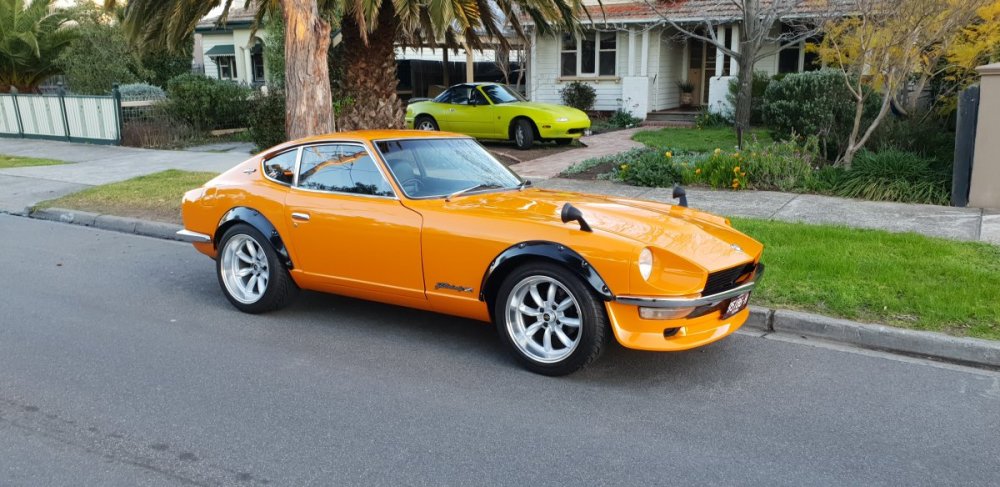

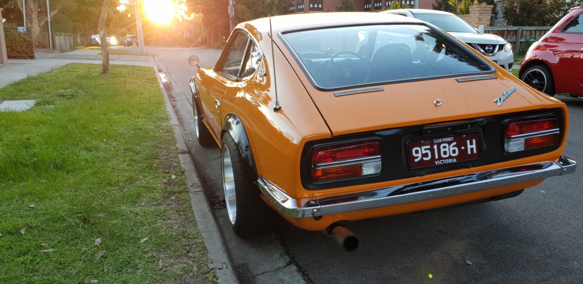

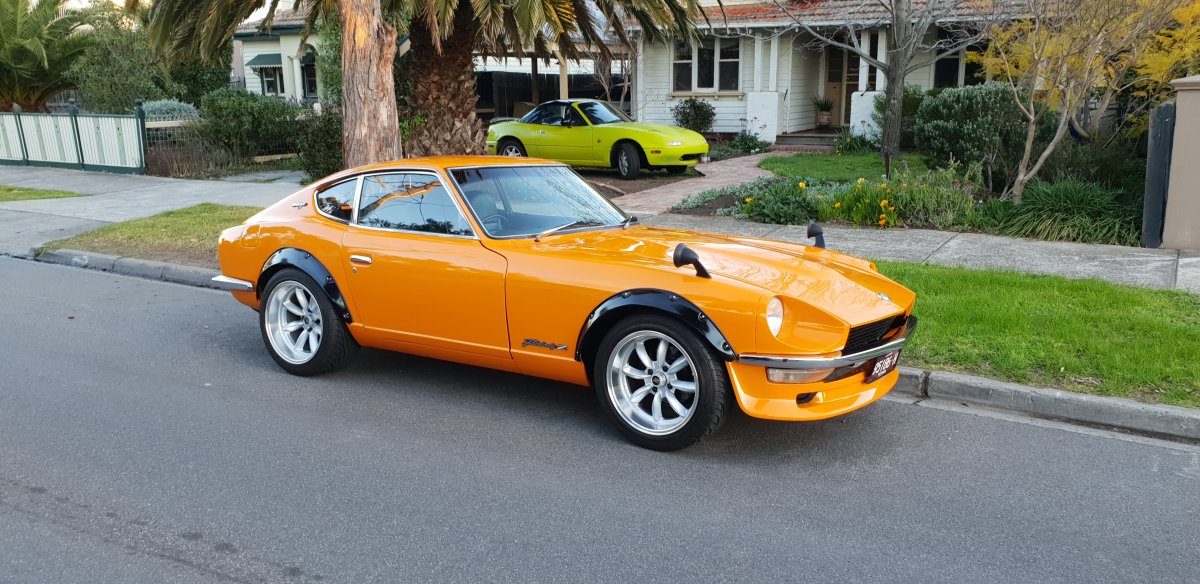

DreamZproject Posted September 8, 2018 Author Posted September 8, 2018 (edited) Oh yeah, and I also got Lock to install my genuine Z JDM fender mirrors I gave it a decent crack today as well. I gave the whole car a decent wash for the first time, and then spent about 3 hours grinding the window tint off the rear hatch (awful job!) Ready for the my first hill run tomorrow :D:D:D:D:D:D:D:D:D:D Edited September 8, 2018 by DreamZproject C.A.R., lightmaster240z, RAP260 and 2 others 4 1 Quote
