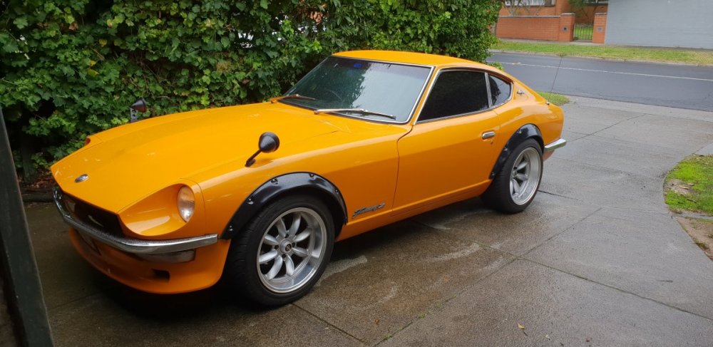

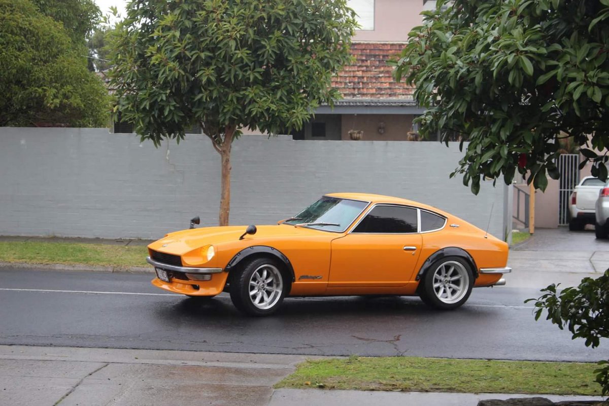

DreamZproject Posted July 11, 2018 Posted July 11, 2018 (edited) I came to the very sad conclusion that I had to give up on my 260 full resto project, as full time work and a healthy social life was leaving me with little energy and time. This incredibly depressing scenario caused me to inspect the state of the Z market on Carsales and gumtree, and would you know it, within 2 minutes I spy an early number 240Z in the EXACT! colour I was looking for, advertised at a price I was willing to pay... Current Car info (to be updated) Edited July 11, 2018 by DreamZproject RAP260 and Wombat 2 Quote

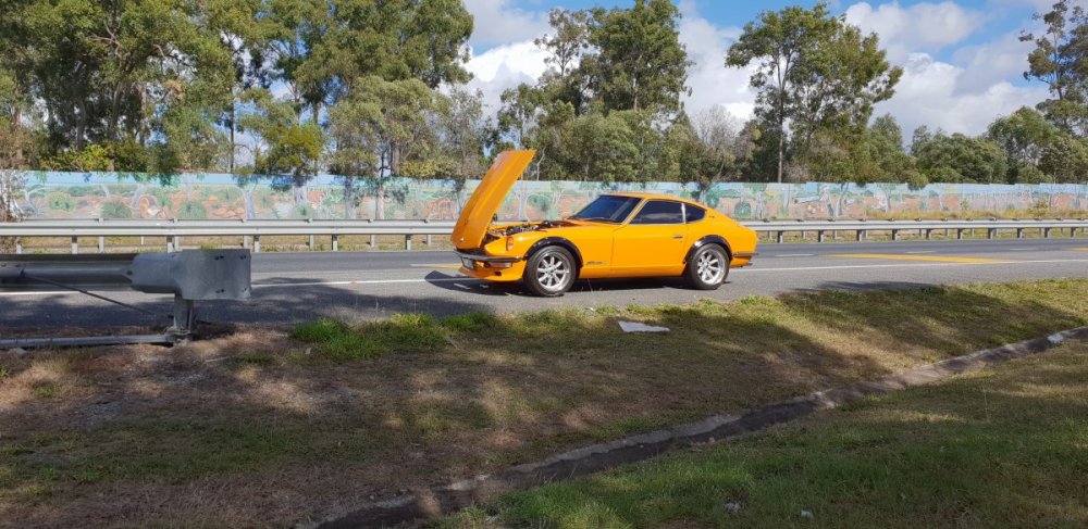

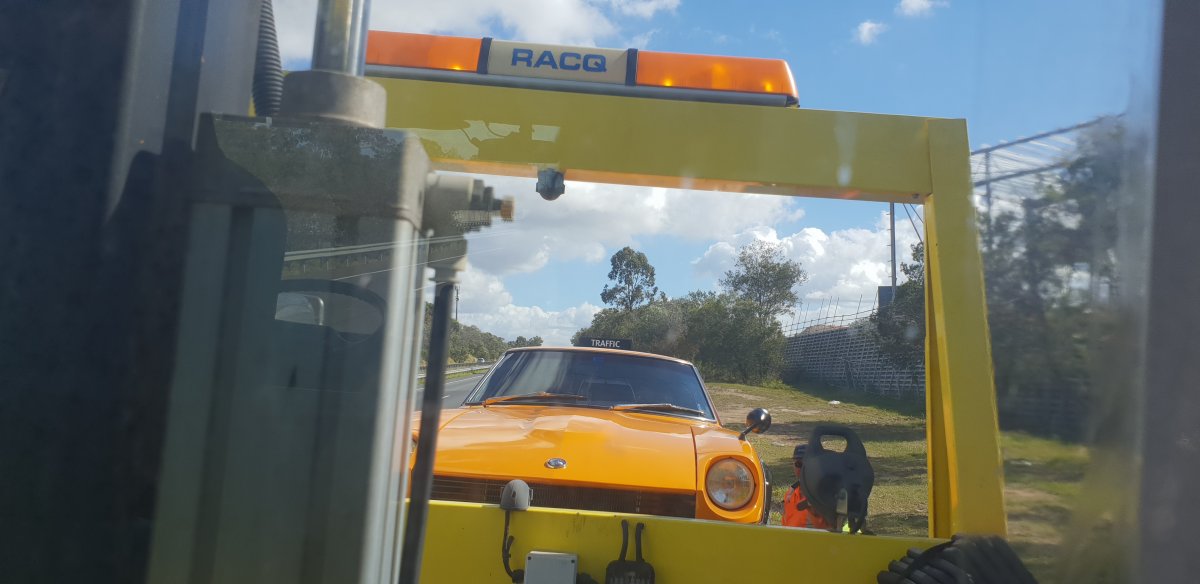

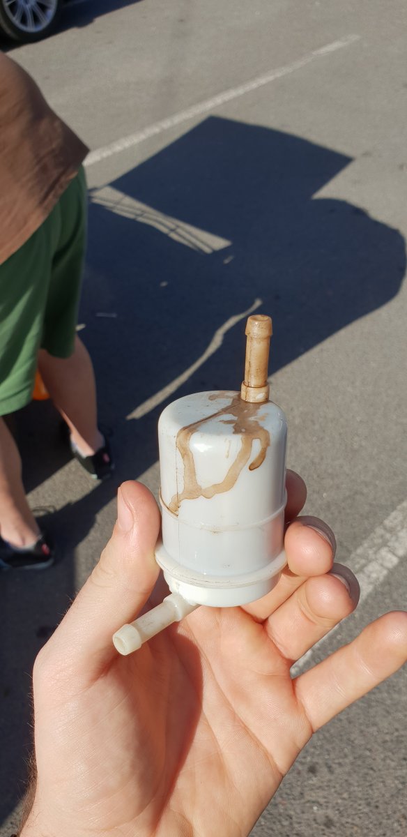

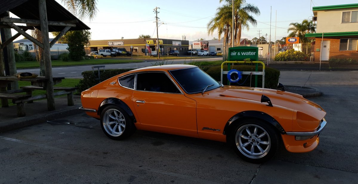

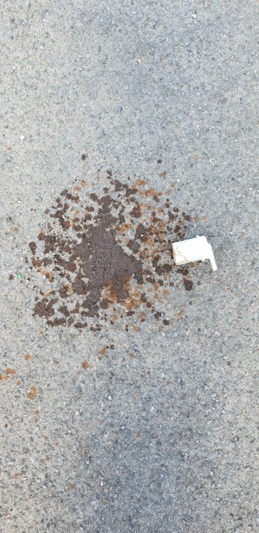

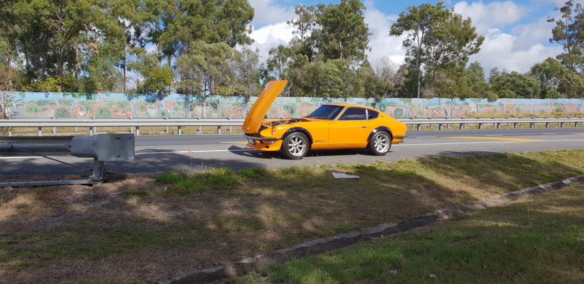

DreamZproject Posted July 11, 2018 Author Posted July 11, 2018 (edited) What a way to start my journey with this beautiful car; a nearly 2,000k roadtrip from Brisbane back home to Melbourne! 10k in to the trip the car was down and out. Broken down on the side of the highway. I nearly cried. Luckily Lock put the call out on the forum and within 10 minutes Matty shot me a call and was out to help me within 40 minutes! 20 minutes after that the issue was diagnosed and fixed (rust clogged fuel filter), and I was back on the road again! The rest of the trip went by without issue, but was bloody scary at points where I was doing 110 it was pissing down rain, with the wind nearly blowing me into the next lane. Would drive 2,000k's in the car again? not any time soon, but with that sort of reliability, I am now very confident with it. Edited July 11, 2018 by DreamZproject RAP260 1 Quote

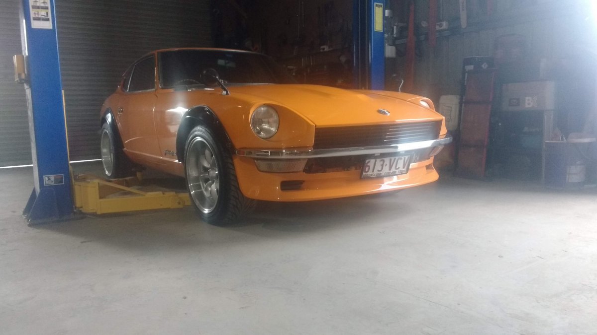

C.A.R. Posted July 13, 2018 Posted July 13, 2018 So Robbie has dropped this off to my shop to have a bit of work done in preparation for the Victorian RWC test. One of the main things to deal with is installing windscreen washer hose and jets! Zedhead, OdinZ, RAP260 and 1 other 4 Quote
RAP260 Posted July 14, 2018 Posted July 14, 2018 (edited) So the whole systems been deleted by the sound of it? I'm assuming they were standard, even on early 240s?? If that's the case, who ever got it registered up here knew the right person. Edited July 14, 2018 by RAP260 gav240z 1 Quote
Administrators gav240z Posted July 14, 2018 Administrators Posted July 14, 2018 Yeah the problem is those hoses get hard and dry over time. The motors seem to keep working but they can block up if people use plain water in them instead of that alcohol stuff. Quote
Administrators gav240z Posted July 14, 2018 Administrators Posted July 14, 2018 Sinking the money into a good early 240z vs a rusty old 260z 2 seater was the better decision long term. However when I sold my first 240z after buying my 72 240z because it was far less work, I always felt like I'd given up and "cheated" a little. But there is always something to do on these cars. If you're ever feeling too busy with work etc.. and contemplate selling it, take it for a drive and then think about it again. I find each time I drive mine I fall in love with them all over again. OdinZ and RAP260 2 Quote
C.A.R. Posted July 14, 2018 Posted July 14, 2018 2 hours ago, RAP260 said: So the whole systems been deleted by the sound of it? I'm assuming they were standard, even on early 240s?? If that's the case, who ever got it registered up here knew the right person. Only the bottle and pump was there! And yes, quite probably... Quote

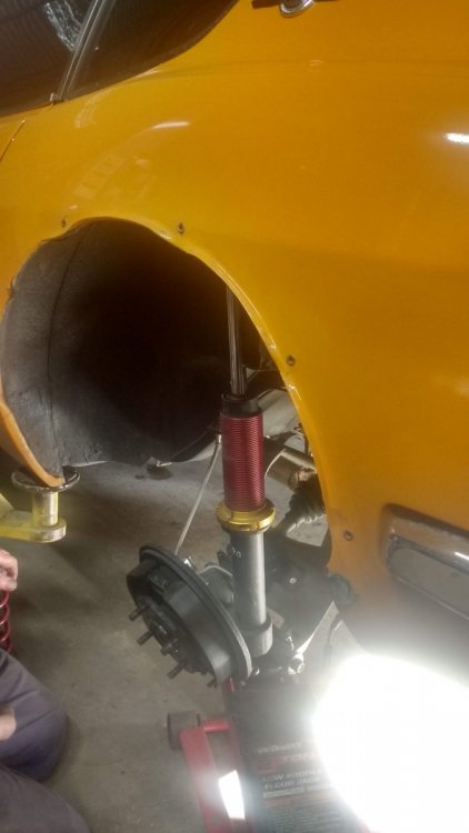

CBR Jeff Posted July 18, 2018 Posted July 18, 2018 (edited) bit of droop......... Long travel 240? Edited July 18, 2018 by CBR Jeff Quote
C.A.R. Posted July 18, 2018 Posted July 18, 2018 It had a weird clunk from that side. Gland nut was loose. Quote
Retro Z Posted July 20, 2018 Posted July 20, 2018 What sort of Ft Lbs should the Gland nut be torqued to Locky? It have a few clunks i'm trying to sort out aswell. Quote
C.A.R. Posted July 20, 2018 Posted July 20, 2018 Just tight, Tai. A dap of lock-tight is a good idea too. Don't forget to fill the tube with light oil or straight engine coolant. Retro Z 1 Quote

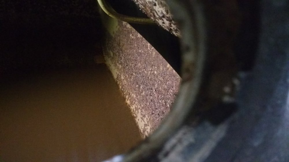

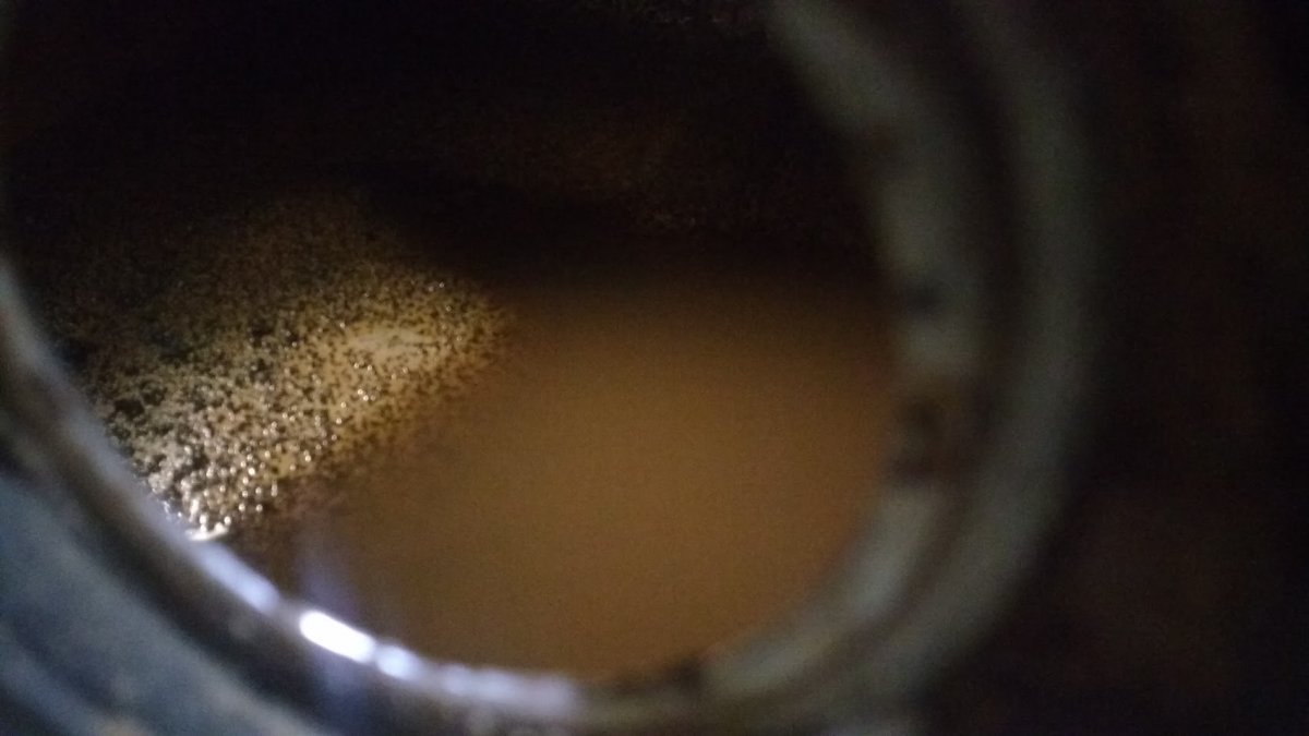

C.A.R. Posted July 20, 2018 Posted July 20, 2018 We got the tank out this afternoon - now we know why it was blocking the fuel filter... Good second hand tank is on it's way to me next week. Quote
