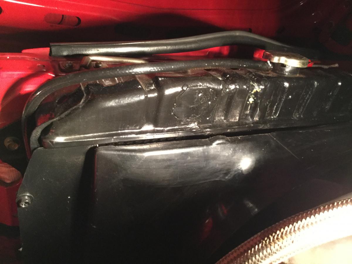

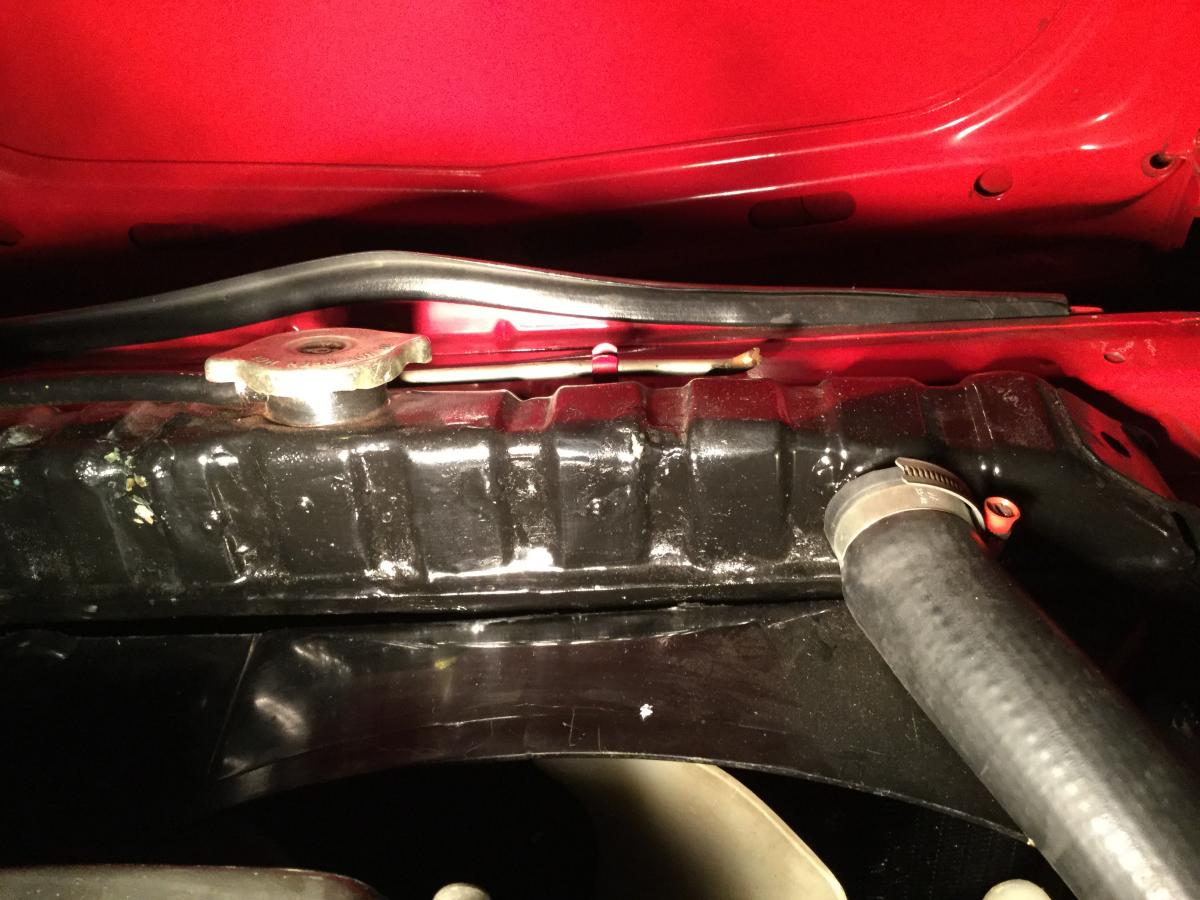

ScottyD Posted May 6, 2018 Posted May 6, 2018 (edited) You could have the original modified like mine, never had an overheating issue. I’ve heard mixed results with the Aluminium radiators. Edited May 6, 2018 by ScottyD Quote

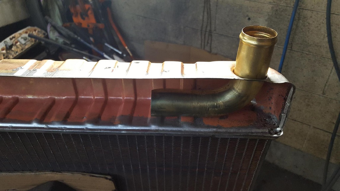

GregTas Posted August 15, 2018 Author Posted August 15, 2018 So i"ve got my radiator sorted I went with the HZ V8 rad that was suggested by @dat2kman It's a brass 'Auto Rad' 618 core. It's a big core and very snug fit between the rails. Only 3 or 4mm clearance. The side bands had to get the bottom trimmed off them and the bottom of them sits on the top of the chassis rails. Very pleased with it. On the RB25 both pipes are on the drivers side. I was going to have the bottom pipe on the passenger side and use an external pipe to cross it back. The guy doing it had a better way and the top pipe has a 90 degree bend inside it to direct the water to the passenger side so it should work similar to if the pipes were on opposite sides. The rad is a bit taller and will sit lower so I got the bottom fitting pointed up. It ended up costing me $700. Close now to getting my engine started up. RAP260 and KatoKid 2 Quote
