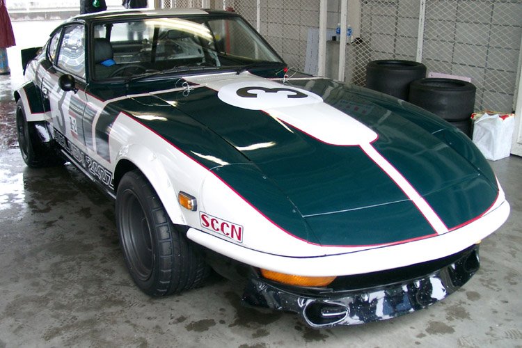

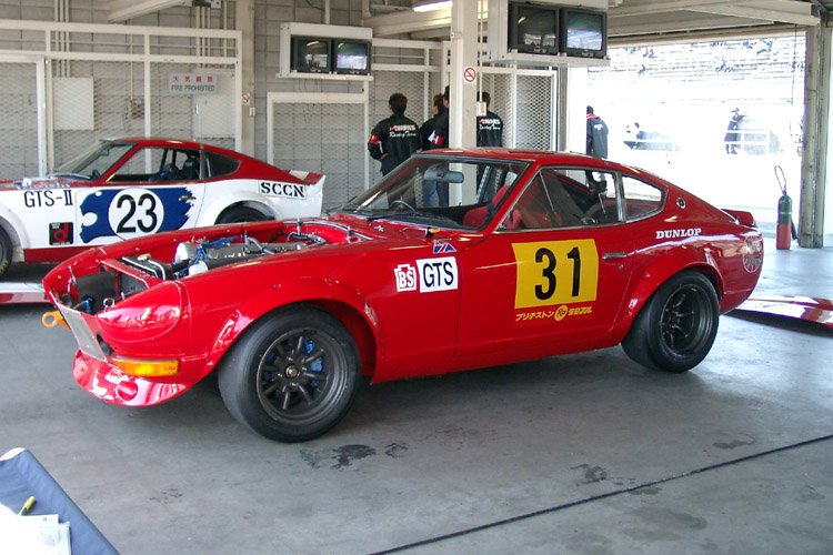

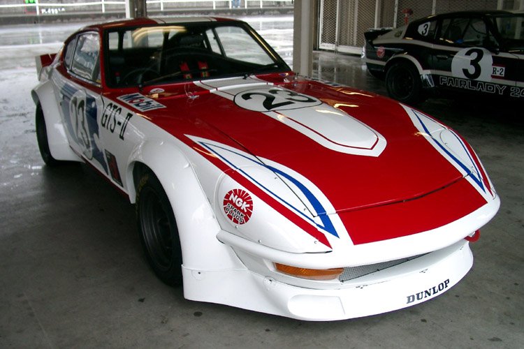

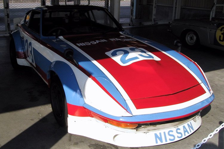

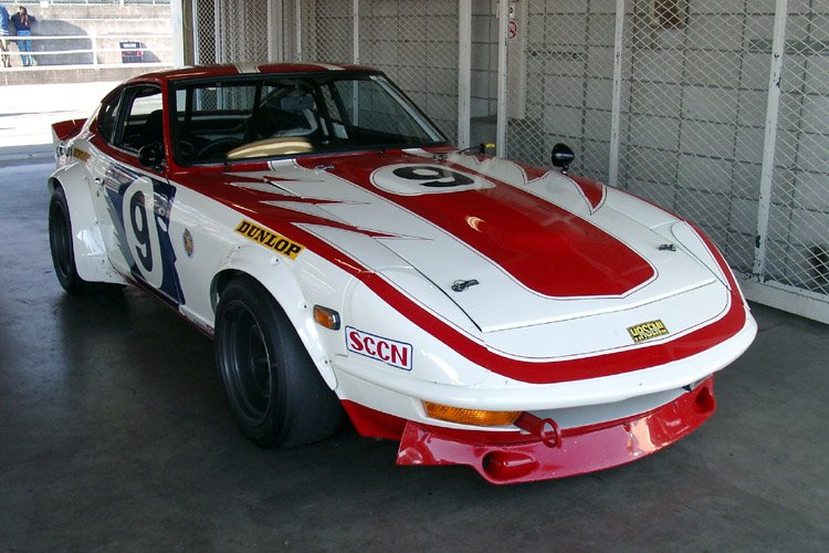

Administrators gav240z Posted April 12, 2018 Administrators Posted April 12, 2018 she's not number matching and will predominantly be a track car, plus IMO of the kits available the rocket bunny one is the most aesthetically pleasing. Your car, your decision, but if I can steer you in another direction. How about a Fairlady 240Z-R? Photos below. These are the cars that the Rocket Bunny kit draws inspiration from in my opinion. http://www.yatsuzaka.com/gallery/PC/N-Z.HTML HS30-H Works HS30-S OdinZ 1 Quote
