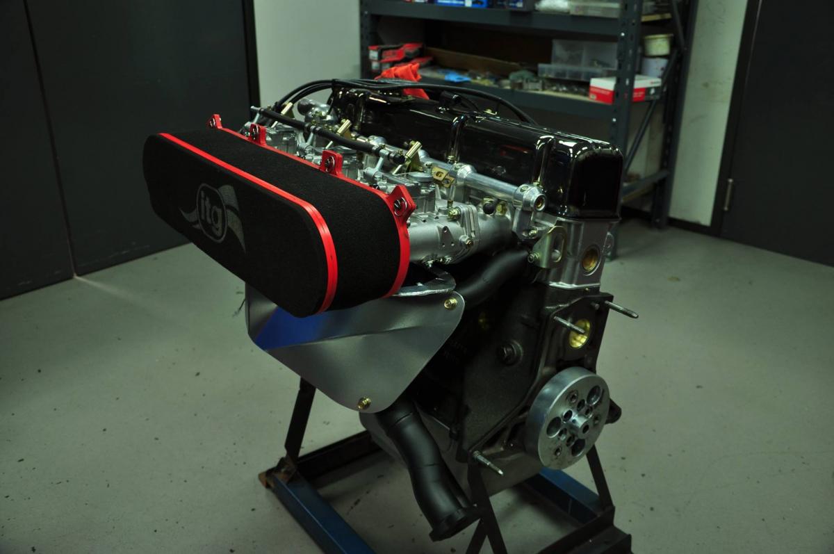

Administrators gav240z Posted January 10, 2016 Administrators Posted January 10, 2016 The problem with the ITG filter is where do you put the oil breather hose? I guess you require an oil catch can then? Most S30z's in Japan appear to run Triples. Not many on the stock SU's. My guess is that conventional wisdom there is that Triples are the way to go. Especially with a warm L-series. Nissan was looking at offering the Triples as standard fitment to the 240z but the pin was pulled on the idea. I guess bean counters and emission rules are partly to blame. Would have been great if they did it like on the Fairlady Z432. Nissan or Prince offered to Skyline GTBs here in the 60s with Triple Carbs and LSD + large fuel tank as standard. Quote
d3c0y Posted January 11, 2016 Posted January 11, 2016 Stick a little filter on the rocker cover? I don't see this as a big deal. My engine doesnt even have a crankcase vent anymore. Quote
Administrators gav240z Posted January 11, 2016 Administrators Posted January 11, 2016 Stick a little filter on the rocker cover? I don't see this as a big deal. My engine doesnt even have a crankcase vent anymore. I'm sure there was a discussion about this previously in 1 of your threads, where do you vent it? Just read this myself. http://oppositelock.kinja.com/ditch-that-pcv-system-before-it-is-too-late-1634156554 Quote
Moggie Posted January 11, 2016 Author Posted January 11, 2016 Iv just got both my breathers running to a catch can filled with steel wool and a little filter on it. Or if you want to keep a simular setup as if you were running a pcv. Weld a tube in at 45deg in your headers collector and connect the crank case breather to that. That will draw air in through the top breather and out throught the cranks case allong with all the crank case gases. The hot exhaust will burn the oil vapor aswell. Quote
d3c0y Posted January 11, 2016 Posted January 11, 2016 (edited) I'm sure there was a discussion about this previously in 1 of your threads, where do you vent it? Just read this myself. http://oppositelock.kinja.com/ditch-that-pcv-system-before-it-is-too-late-1634156554 Basically i talked to PMC about it and my crank swings out so far there isn't room to run it. He said "don't worry about it, it's fine" so i didn't. The pressurised air can still come up the timing chain gallery and vent out through the rocker cover, which I will run to a catch can for track purposes, which ultimately will terminate with a filter on the top. So really same same as running it on the rocker cover. I'm currently fitting the ITG 100 to my stroker motor too. I'll detail the install in my build thread. Looks so much better than those crappy uni filter socks i have currently. Edited January 11, 2016 by d3c0y Quote
