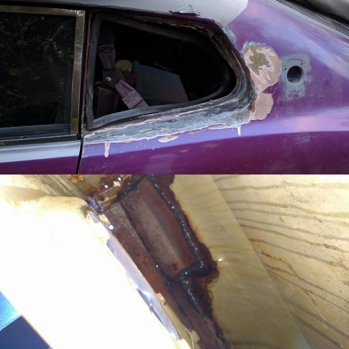

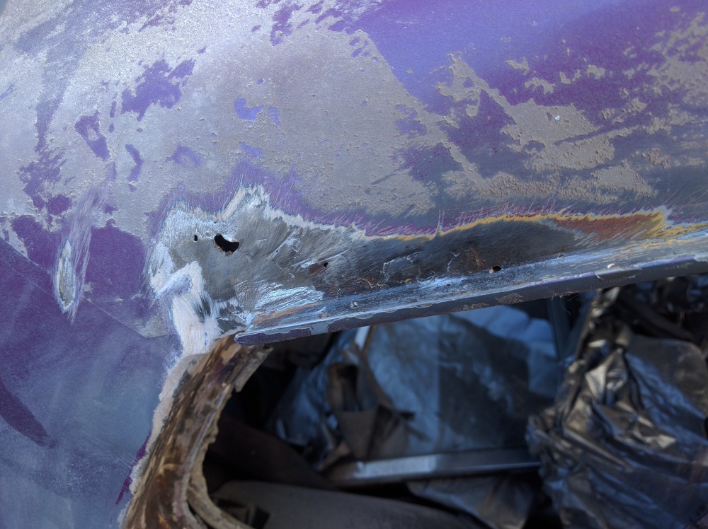

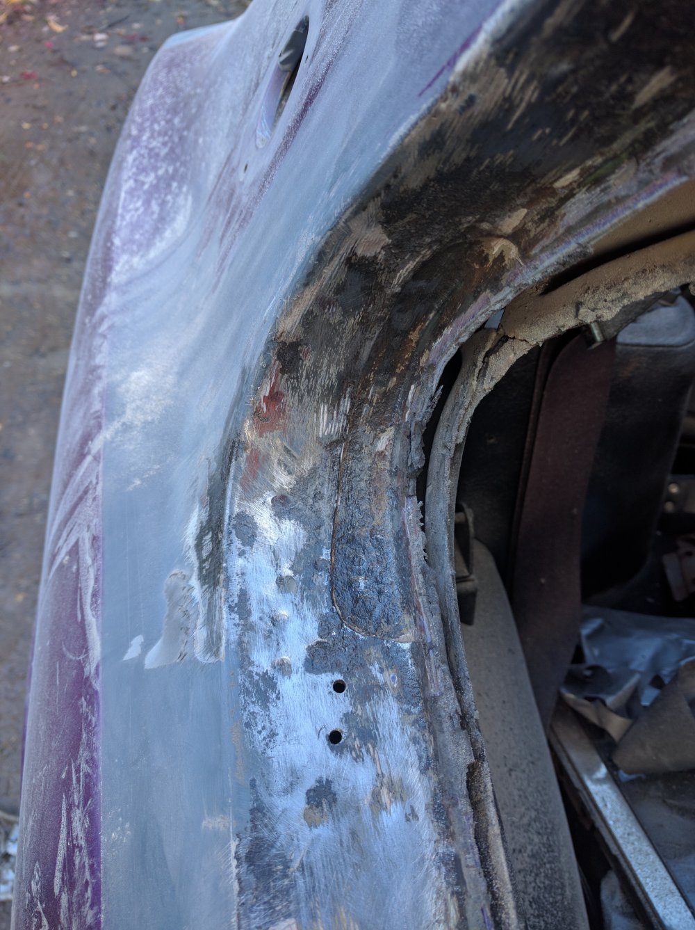

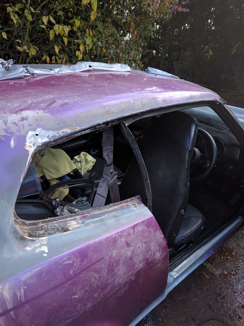

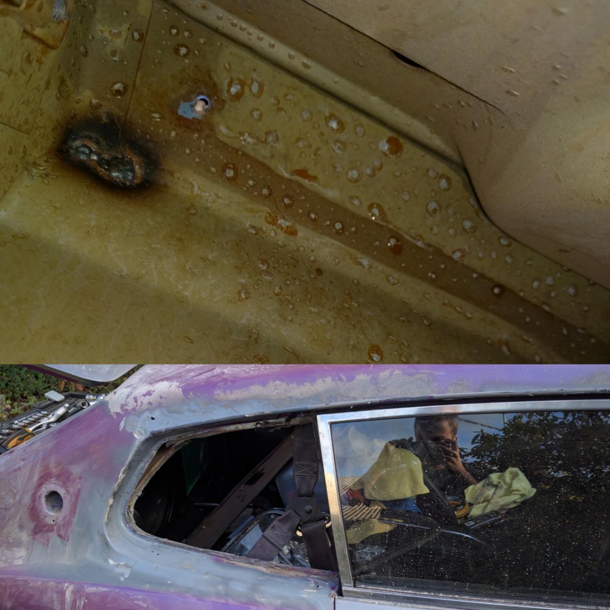

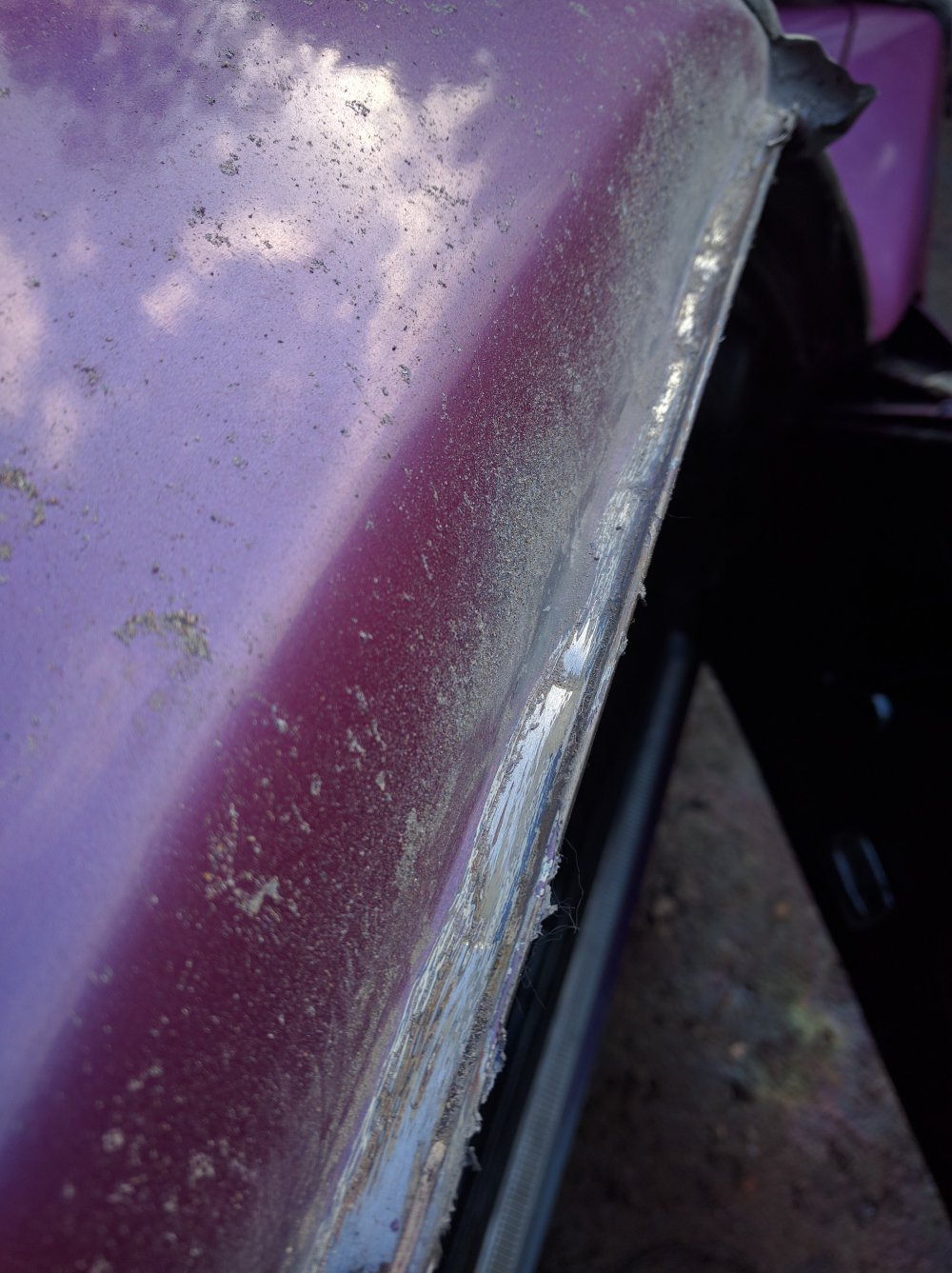

Andrew_L26 Posted June 13, 2016 Author Posted June 13, 2016 Well, started ripping into the rear window more, it seems fine on the driver's side, the passengers side has had some serious hackory in the past but it's a fairly decent job. Got the interior panels off and had a good look from the inside. The passenger side dogleg has been replaced with a proper panel (and done well) whereas the window area was pretty hackky but it will do for the time being. Also was able to see that my sils are fine on the passenger side and are rusted on the drivers side, it feels mostly ok however there is a hole about 4-5cm on the bottom. I've rust converted everywhere and I'll get some primer where I can in the next few days. Looks like someone has spent stacks of money though. I can imagine a body shop charging plenty for this repair... The images are looking up from the inside. I'll get some more pictures up tomorrow! Feeling pretty positive about the car now. I've come to realise that it may never be worth fully striping down due to the nature of the repairs. But hey, if it's not bubbling or getting any worse and I can get her on the road and enjoy the driving experience that will be good enough for me ? Have a good one guys and girls! Andrew Quote
Moderators PB260Z Posted June 14, 2016 Moderators Posted June 14, 2016 (edited) Hi Andrew Great to see that you are back into it. Keep at it - you will get there. Cheers PB Edited June 14, 2016 by PB260Z Quote
Andrew_L26 Posted June 17, 2016 Author Posted June 17, 2016 (edited) Hi Andrew Great to see that you are back into it. Keep at it - you will get there. Cheers PB Thanks PB! I've finally gotten in contact with the girl that painted my z up! Turns out her dad did all the work between 2004-2006 and I spoke to her dad, he said that all major rust areas were cut out and new metal in, he did say that a few areas such as the rear hatch were acid washed and then bogged however he said that there wasn't much that was just bogged over. Apparently the repairs aren't perfect but there is metal everywhere (and bog was just used to cover his welds etc) he also said that he had the roadworthy inspector look at the work he did to the frame rails in 2006 (when it was re-registered) and they said it was fine however I think they have deteriorated since then. He sounded like he didn't want to do anything such as bogging over large rust areas because he didn't want his daughter to drive something that was dangerous etc. From what I've seen in the car this appears to be true and I don't see why he wouldn't tell the truth considering he isn't selling me the car. The car was kept around the Donald/Ballarat area after the repairs were done up until 2011 when it went down to Philip island. The girl is overseas but she said that she would send photos of the various repairs and the car before anything was done to it when she gets home which is fantastic! It's really great to be finally able to know what the deal is with the car! I must also say that this girls hair is a very similar color to the car which explains a lot. Also, I ordered one of these on eBay: http://www.ebay.com.au/itm/121956705254 A 20$ 5meter 2mp borescope camera (with a light and everything) which will allow me to get a look inside the car, I'll get it into the frame rails, down under the sill, up into the roof and rear 3/4 panels which will give me a really really good idea of what I'm dealing with! Have a great weekend! Cheers, Andrew Please enjoy this photo which explains why my car is a little odd... Edited June 17, 2016 by Andrew_L26 Quote
