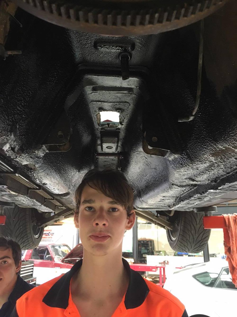

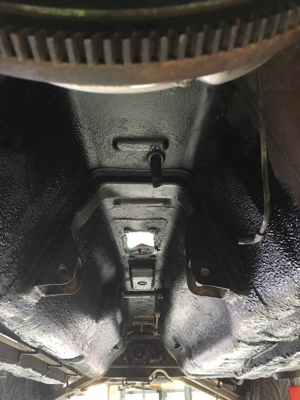

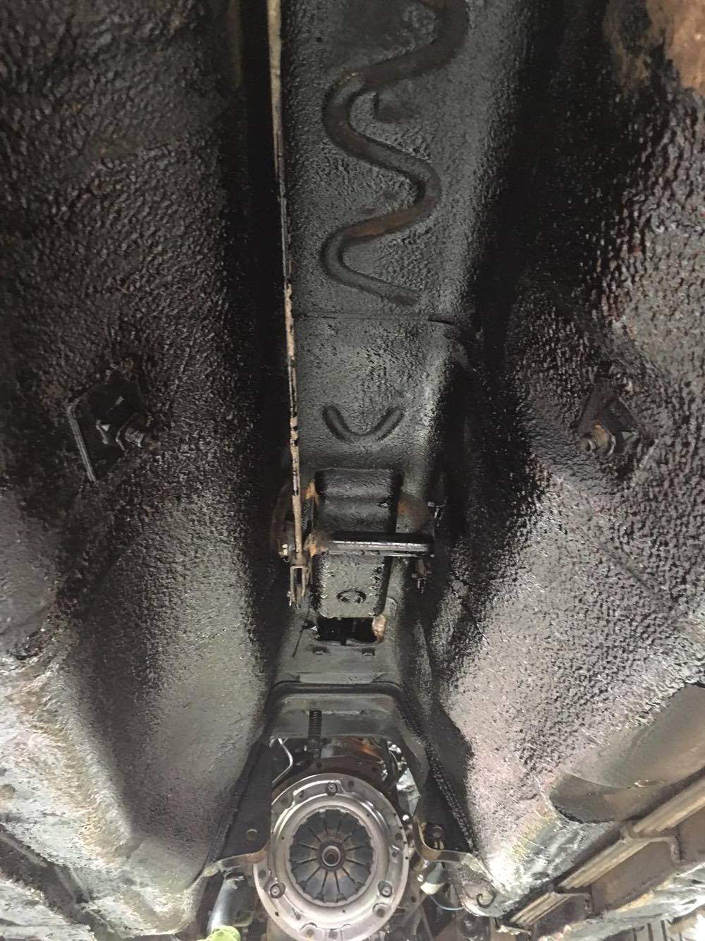

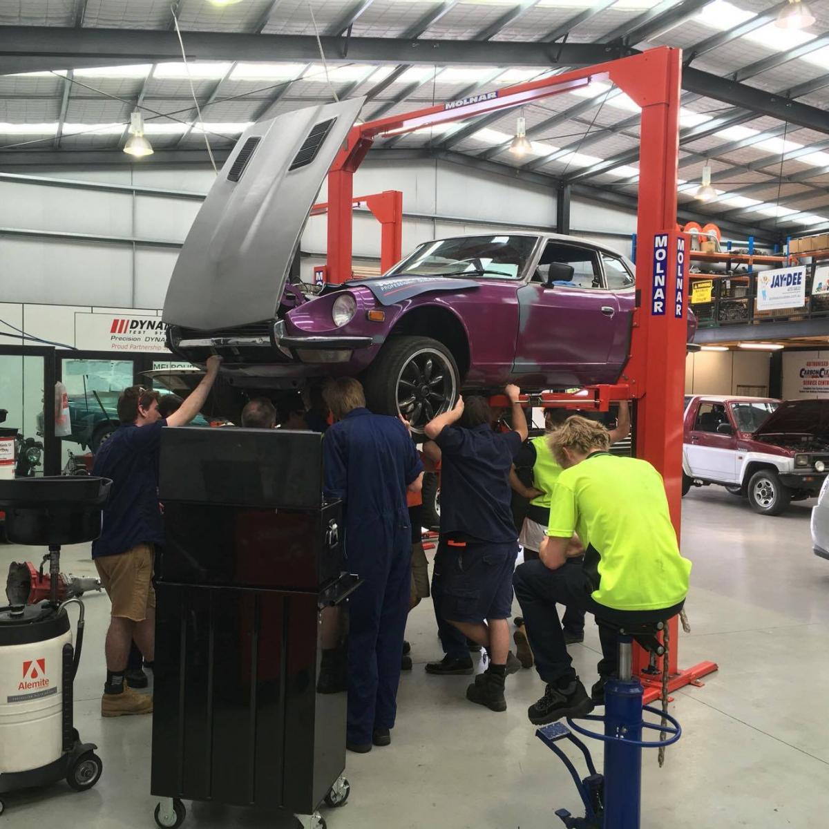

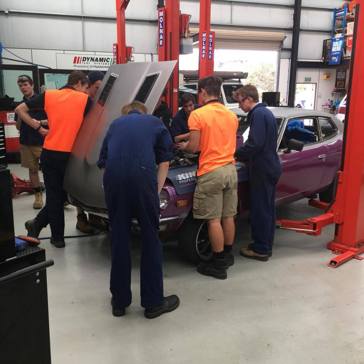

Andrew_L26 Posted March 27, 2016 Author Posted March 27, 2016 So, taking advantage of the unit we were doing at my TAFE (clutches) I thought it was time for some manual gearbox action. Got all my parts ready including a box (ZX) and everything went smoothly, I ended up spending $650 with a new master, slave, clutch line, pedals, gearbox, new clutch and pressure plate, machined flywheel, rear main seal. I think that I did it fairly cheaply which I'm happy about. Here are some photos of my fresh underbody sealer. I decided not to take too much of the old sealer off as the whole transmission tunnel had been protected with ATF from my leaky box. The hoist arms didn't fall through the sills! Enjoying that nice new clutch! Only issue I'm having now (after a free oil change) is firstly, I have oil weeping from my headgasket! I'm really worried about this. I drove the car about 30k and when I got home I noticed a small amount of oil had seeped from the head. The car still runs fantastically though... I haven't driven it since I got it home and I don't intend to. I'm thinking that it could be due to incorrect oil grade (I'm not sure what the boys put in but it was whatever was given to us by penrite) The oil could also be over-filled however I will double check tomorrow as when I checked it the car was on a steep incline and showed about 3cm above the full line on the dipstick. I also don't have any gauges at the moment which doesn't help due to (I suspect) a faulty voltage regulator. I really hope I'm not in for a rebuild of this beautiful L28 (F54 Block and P90A Head) Any ideas? Happy Easter! Andrew Quote

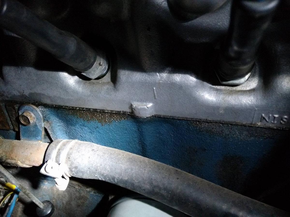

CBR Jeff Posted March 27, 2016 Posted March 27, 2016 Did you spill any oil when you put it in? If you did it's likely that it has accumulated on the gasket and run along. Try cleaning it off and then see what happens. It's unlikely that changing the oil has caused the head gasket to leak. I am enjoying following your adventure. Jeff GongZ and Andrew_L26 2 Quote
Andrew_L26 Posted March 27, 2016 Author Posted March 27, 2016 Did you spill any oil when you put it in? If you did it's likely that it has accumulated on the gasket and run along. Try cleaning it off and then see what happens. It's unlikely that changing the oil has caused the head gasket to leak. I am enjoying following your adventure. Jeff Boy do I hope thats the issue. I cleaned it off when I found the issue and I haven't had anymore oil come out, although. I haven't driven it... Thanks for the support, Andrew Quote
Linton Posted March 28, 2016 Posted March 28, 2016 (edited) a weeping rocker cover will do the same thing, mines is the same just give it a wipe every so often. Edited March 28, 2016 by Linton Quote
TobyMyers Posted March 28, 2016 Posted March 28, 2016 (edited) Recently Installed an L28 into My Dads Zed, After getting it running and driving i noticed the same thing, then realised i hadn't fully tightened the Valve cover bolts down! Definitely a bit of a scare Edited March 28, 2016 by TobyMyers Quote
Moderators PB260Z Posted March 28, 2016 Moderators Posted March 28, 2016 (edited) a weeping rocker cover will do the same thing, mines is the same just give it a wipe every so often. Recently Installed an L28 into My Dads Zed, After getting it running and driving i noticed the same thing, then realised i hadn't fully tightened the Valve cover bolts down! Definitely a bit of a scare Definately reinforces the need to look for the simplest solutions first. Edited March 28, 2016 by PB260Z Quote

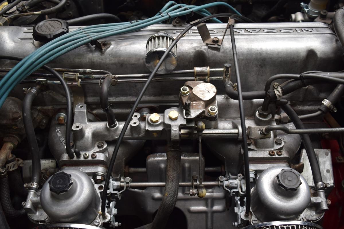

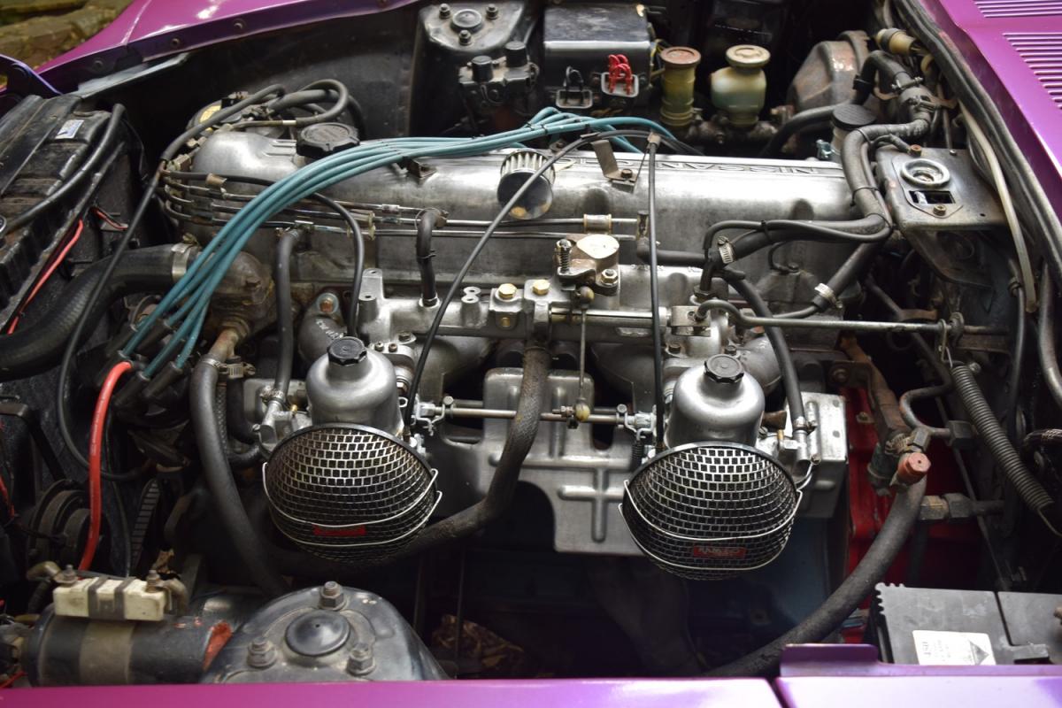

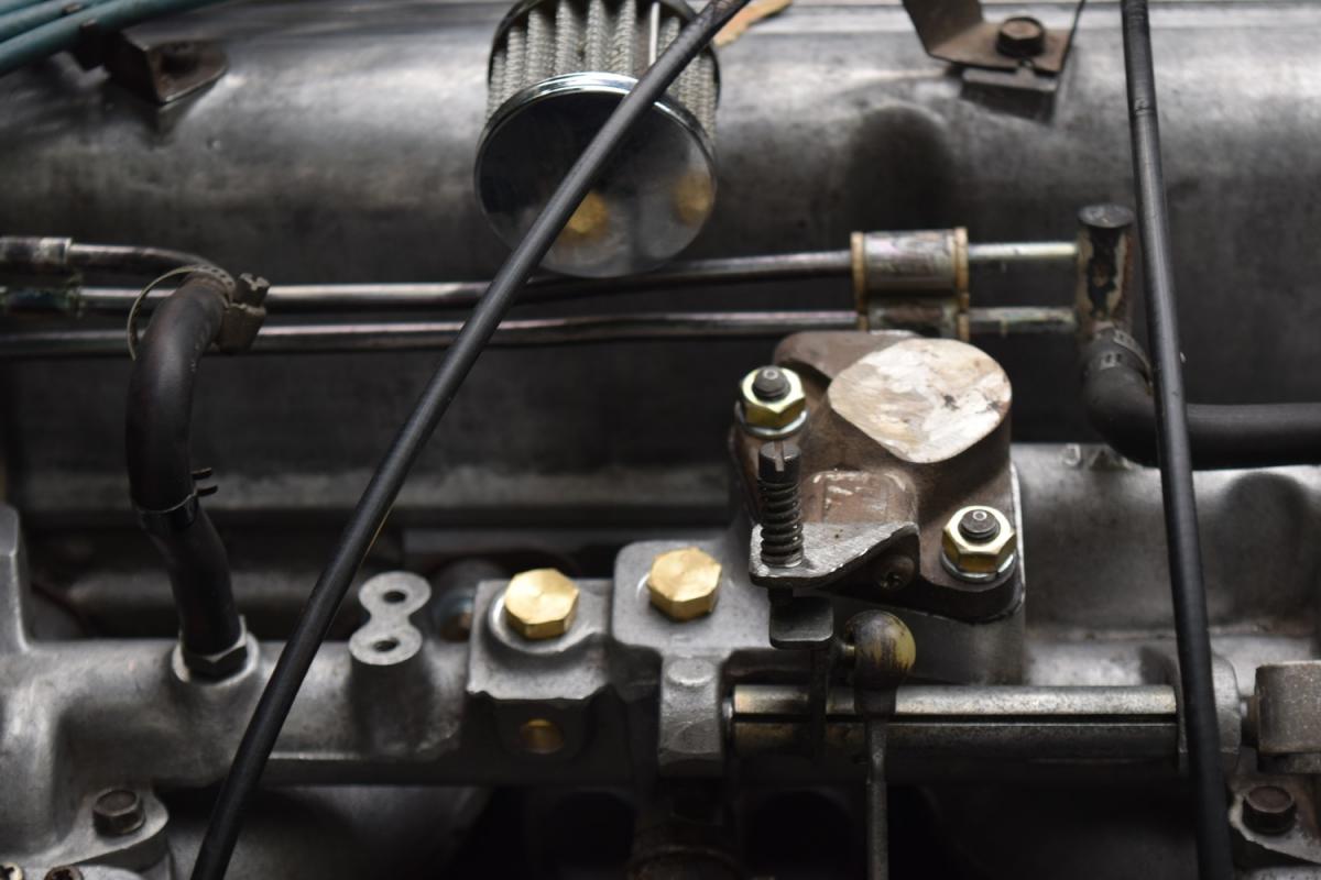

Andrew_L26 Posted April 12, 2016 Author Posted April 12, 2016 Also, cleaned my carbies and tidied up my engine bay! they look great. Put some blanking plugs in where some old emissions stuff which wasn't connected due to the British SU not supporting it all. Deleted the EGR valve thingo and welded up the holes. Also got rid of those (asbestos?) heat-shields as the new British SU's don't really have any issues with vapour locking Quote
