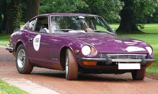

Brabham Posted July 7, 2015 Posted July 7, 2015 I thought it was a darker purple color, think they used to have a pic up on zhome but took it down. I love purple on zeds, would be tempted to get a liter of #362 to see what it looks like. Would have to be the rarest zed color, never seen a registered one. You could always redo it in #362. Nice looking zed. Cheers Quote
Andrew_L26 Posted July 7, 2015 Author Posted July 7, 2015 I thought it was a darker purple color, think they used to have a pic up on zhome but took it down. I love purple on zeds, would be tempted to get a liter of #362 to see what it looks like. Would have to be the rarest zed color, never seen a registered one. You could always redo it in #362. Nice looking zed. Cheers Picking her up tomorrow, here is a photo of a filthy spark-plug and you can see the colour better in the back. Also is the #362 a paint code or something else haha (don't mind my noobish questions I'm here to learn https://drive.google.com/file/d/0B-7sJCmAZ6KaejViMXpUTktlUUk/view?usp=sharing Quote

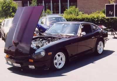

Administrators gav240z Posted July 7, 2015 Administrators Posted July 7, 2015 On S30z's the paint code is often referring to as a number, it also has a name usually. For example 918 is Kalahari Tan, 920 is Safari Gold, 905 Monte Carlo Red etc.. But not all paint codes have such exotic names. #362 Seems to be a purple hue but I can't for the life of me recall what it looks like now. Quote

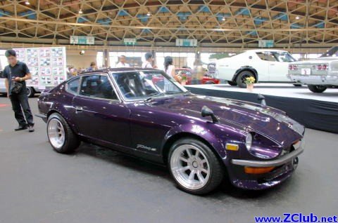

Administrators gav240z Posted July 7, 2015 Administrators Posted July 7, 2015 I think the purple may look like this. Source: http://zclub.net/gallery/showphoto.php?photo=4682 I had always assumed these were repainted cars and not OEM factory original colours. Must be quite rare indeed... Funny thing about that second photo is that I recall seeing that picture around 97/98 when I first started looking at S30z's on the Internet... Back before Google was the search engine you'd use to find information.... Ahh nostalgia. Quote
Brabham Posted July 7, 2015 Posted July 7, 2015 Think it is like the ones Gav posted, its a dark metallic, that last one looks like a solid and isn't that dark. I like the color in the first pic Gav posted, think it is closest to that. Quote

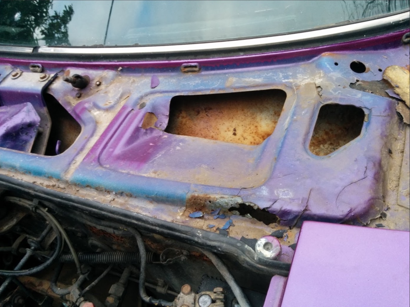

Andrew_L26 Posted July 9, 2015 Author Posted July 9, 2015 So I have come across a few more issues whilst changing oil, fixing little things. The main issue is that there is a fair bit of rust under the front cover (under the wipers) it's not too bad but there are a few holes. The next issue is that the car has some (presumably) aftermarket electric fans which aren't functioning. I believe that it is a connection issue as all of the spade connectors are pretty corroded. Other then that, I lifted allot of the carpet out and there isn't much more rust then I was expecting which is good! https://drive.google.com/open?id=0B-7sJCmAZ6Kafndvd1NHN1B6QnUxaTRQaEUwU0RWOGVyTXo2cWh6bldEaGdoWmw5QzNKNlU Here are all of the photos of the problem areas. Quote
chris240 Posted July 9, 2015 Posted July 9, 2015 A few holes ahhhhhhh, The enthusiasm of youth. You should clean up that wiring, and remove whats redundant, and properly insulate it. Quote
Andrew_L26 Posted July 9, 2015 Author Posted July 9, 2015 A few holes ahhhhhhh, The enthusiasm of youth. You should clean up that wiring, and remove whats redundant, and properly insulate it. The wiring is on my list for tomorrow haha Quote
Administrators gav240z Posted July 9, 2015 Administrators Posted July 9, 2015 If it were me, I'd remove the thermofans and re-install the stock clutch fan. I had a thermofan in my 260z years ago and it was nothing but trouble. It drew too many amps and the alternator couldn't keep up. So it made the battery go flat on more than 1 occasion. Clutch fan is simple and reliable...Albeit saps a small amount of power. The rust spots look common enough, but a little tricky to repair given that you can't get replacement panels / sections in those areas. You've got your work cut out for you there. I suspect the floors will be worse than they look. Quote

Andrew_L26 Posted July 9, 2015 Author Posted July 9, 2015 Could that be 305 Light Blue I can see on some of those panels ? I believe the car was the 304 gold metallic as that is what is under it and in other areas such as behind carpet etc. Also, I was wondering if this floor pan from rare spares would be ok for the 2+2, it states that it will not be suitable but I thought they would be ok may require a bit of welding and fab but where would the fun be if it was just drop in, weld and go haha Quote
Administrators gav240z Posted July 9, 2015 Administrators Posted July 9, 2015 Rare spares ones are suitable for a 240z only, although can be installed in a 260z but the pressings in a 240z/260z floor is different. So it depends how fastidious you want to be. Also 2+2 floors are longer than 2 seaters so I guess it depends on how much of the floor you need to replace. I would get the sound deadening material up and then determine how much of the floors need to be replaced. Quote
Andrew_L26 Posted July 9, 2015 Author Posted July 9, 2015 Rare spares ones are suitable for a 240z only, although can be installed in a 260z but the pressings in a 240z/260z floor is different. So it depends how fastidious you want to be. Also 2+2 floors are longer than 2 seaters so I guess it depends on how much of the floor you need to replace. I would get the sound deadening material up and then determine how much of the floors need to be replaced. Ok, I'll rip up the sound deadener tomorrow and see what comes of it. Also, any suggestions on getting a windscreen washer pump. I will trade bobby pins and a cd featuring captain planet. Quote
Brabham Posted July 9, 2015 Posted July 9, 2015 If the holes in the floors aren't that big you will probably be better off making up a patch and repairing that. The firewall rust is a big problem (depending if you want to fix it to pass rego in Vic, NSW is pretty tough when it comes to rust). To fix that you would prob want to pull the engine out and repaint the engine bay once the rust work is done. Check the battery tray area too for rust. Quote
Andrew_L26 Posted July 9, 2015 Author Posted July 9, 2015 If the holes in the floors aren't that big you will probably be better off making up a patch and repairing that. The firewall rust is a big problem (depending if you want to fix it to pass rego in Vic, NSW is pretty tough when it comes to rust). To fix that you would prob want to pull the engine out and repaint the engine bay once the rust work is done. Check the battery tray area too for rust. Thats what I'm going for, roadworthy in Vic. I thought about getting the whole engine bay painted however it was painted 8-10 years ago and it seems to be in good condition everywhere but those rust spots in the firewall Zedstar 1 Quote
