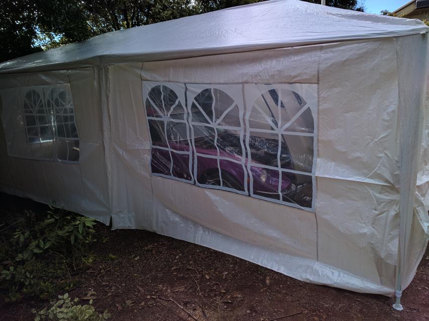

Andrew_L26 Posted June 23, 2016 Author Posted June 23, 2016 Ah ok, I thought they acrylic was easier to paint? If 2pack I easier to get a good finish then I'll go with that Quote
HomeBuiltByJeff Posted June 23, 2016 Posted June 23, 2016 I think it is a common misconception. 2 pack is nasty stuff so you have to make sure you have the correct mask etc. You can have a look at my video on how to build a spray booth if you like. I have found it works really well and didn't cost that much, and I have found it works great for smaller cars. Anyone can pick a a spray gun and have a go at painting acrylic, but it always looks pretty average, no matter how much you buff it. The best way I can put it, is with acrylic you have a very narrow window between spraying too dry and getting runs. That window I find is much larger with 2 pack, and with a small amount of practice you can do a pretty decent job. blu260z and Andrew_L26 2 Quote
HomeBuiltByJeff Posted June 23, 2016 Posted June 23, 2016 I must also add, that if you watch that spray booth video, you need to watch the second one I did, with some of the initial issues sorted out, and several improvements. Quote

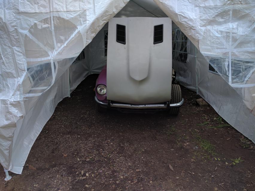

Andrew_L26 Posted June 23, 2016 Author Posted June 23, 2016 That's actually crazy, me and dad were thinking about using one of these exact eBay gazebos to paint it in! Dad's got a full respirator and everything that he uses for his work so I'll be sure to use that! I'll definitely check out the second video + some others! HomeBuiltByJeff 1 Quote

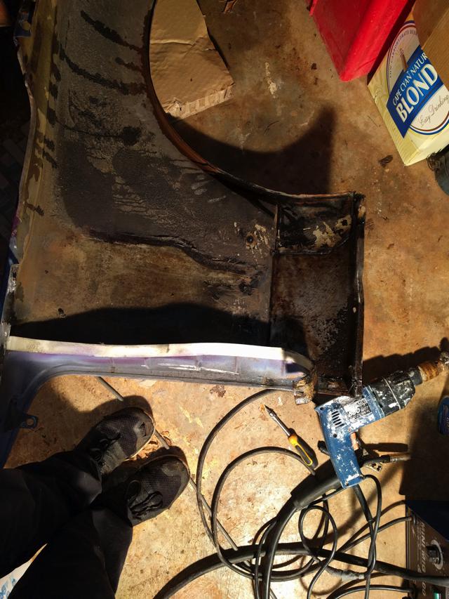

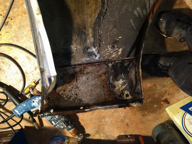

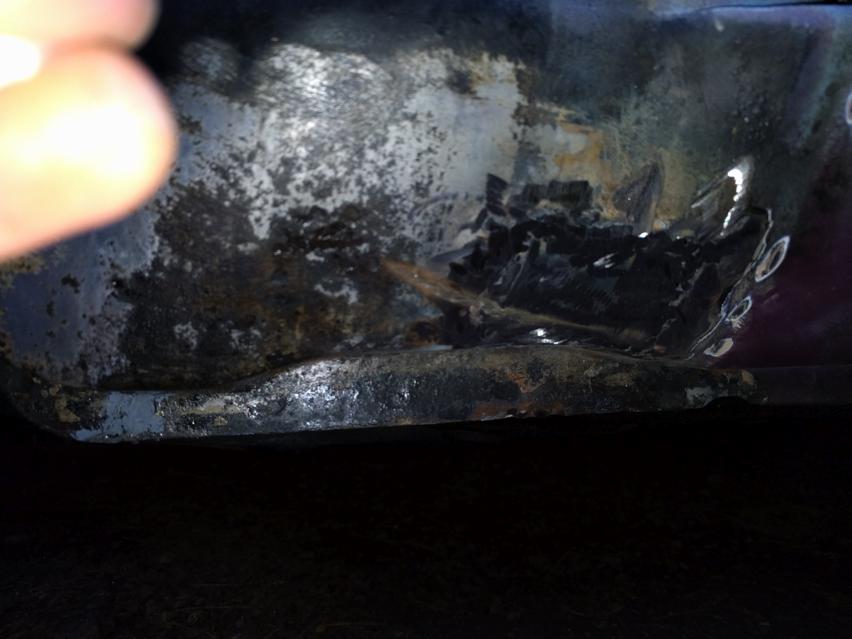

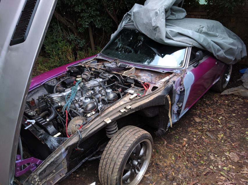

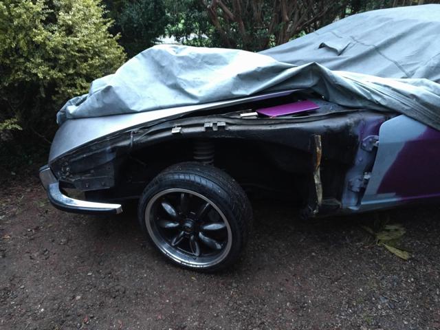

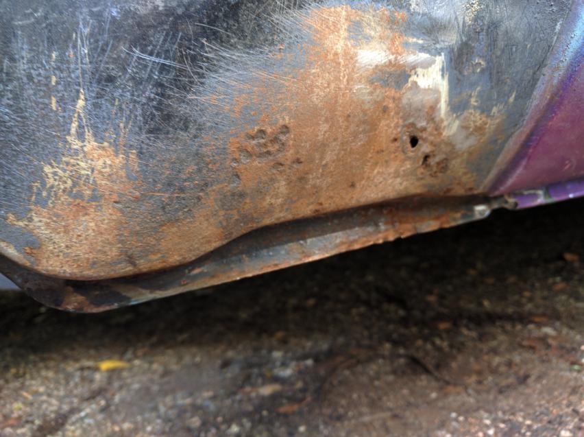

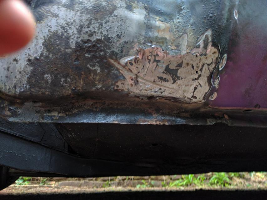

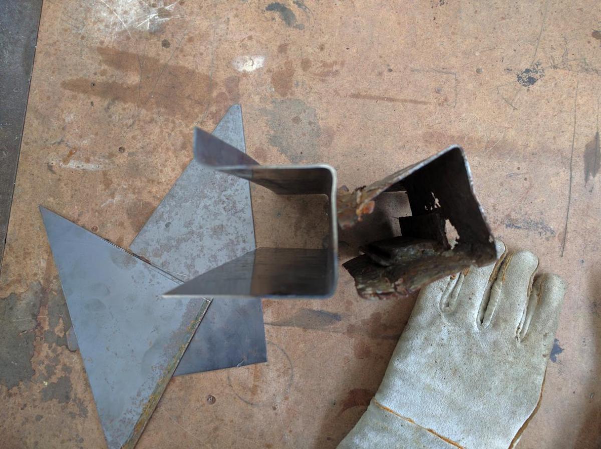

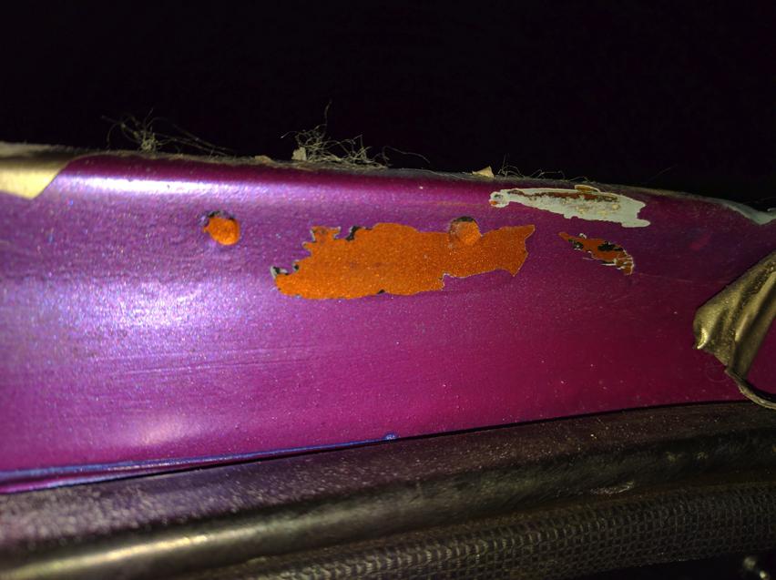

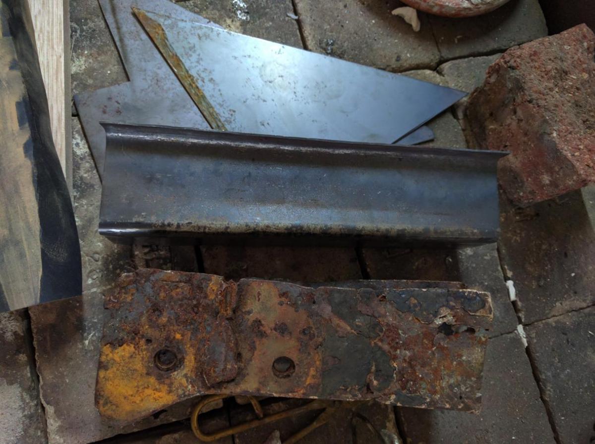

Andrew_L26 Posted June 27, 2016 Author Posted June 27, 2016 Got my LH fender off, the dogleg looks to be in goodish shape with just some surface rust and rust juices from the fender. The fender is a different story, a section has been cut out previously and they've done a pretty good job, not fantastic but it's not really worth re-doing. They didn't treat the panel correctly so the rust has come back and I'm going to need to cut out a small section and weld in some fresh new metal. I also managed to make a new section for the frame which will be getting put in properly when I take the motor out some time this week. Much much better then the last repair that I did. I was able to use my schools workshop which allowed me access to some great hardware and tools. Just starting to pull things out of the engine bay so that I can get the motor out, do my repairs and paint it. I am starting to lean towards the Bayside Blue colour however I'm still keeping 362 Purple in mind. I'm also wondering if anyone has any nice looking engine bays in black, do they look good in a different colour to the body or is it better to keep it all the same? Cheers, Andrew mspecr 1 Quote

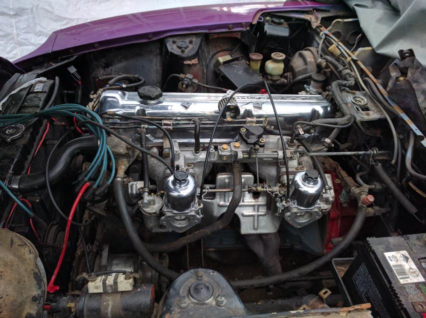

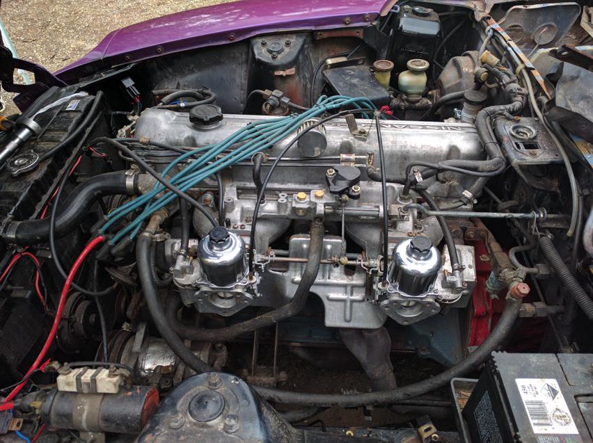

blu260z Posted June 27, 2016 Posted June 27, 2016 (edited) Nice work Andrew. In regards to engine bay colour its a personal choice. The black engine bay really emphasizes the engine, and therefore the engine must look neat and clean !! I asked the same question in my build thread and got a few pictures for an example. Here is some old pics of mine, I am still tidying up cables and hoses etc Edited June 27, 2016 by blu260z Andrew_L26 1 Quote
Andrew_L26 Posted June 27, 2016 Author Posted June 27, 2016 Nice work Andrew. In regards to engine bay colour its a personal choice. The black engine bay really emphasizes the engine, and therefore the engine must look neat and clean !! I asked the same question in my build thread and got a few pictures for an example. Here is some old pics of mine, I am still tidying up cables and hoses etc It certainly does emphasise the engine! I might do my bay in black if I do go for the dark purple otherwise if I go bayside blue I might do the engine bay in colour! Quote

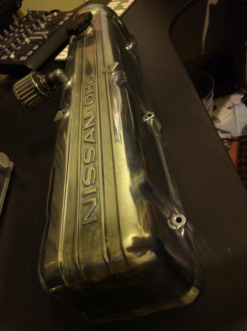

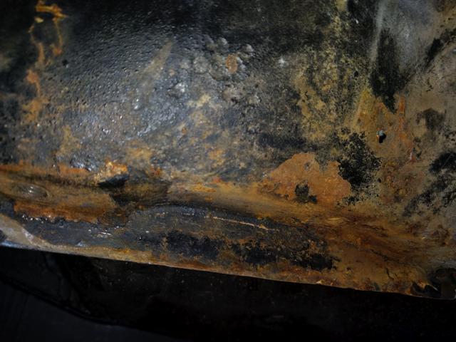

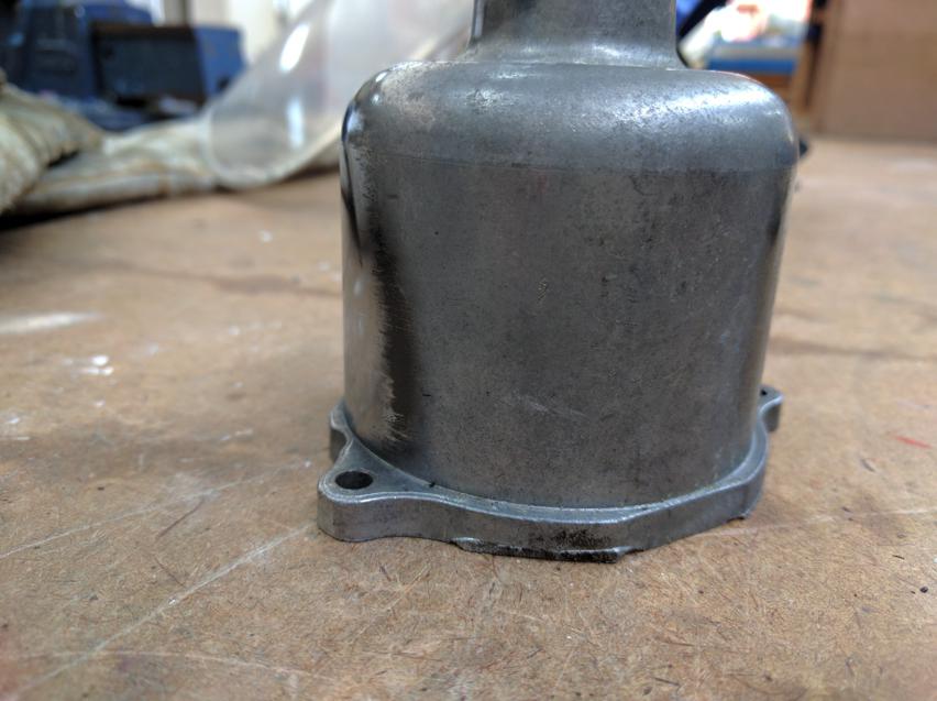

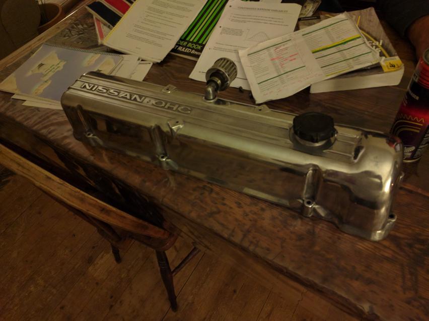

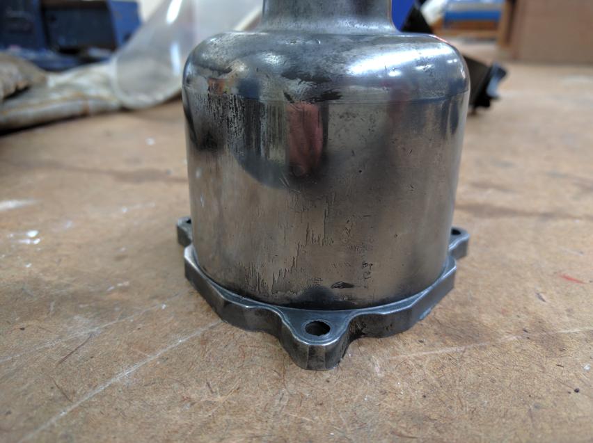

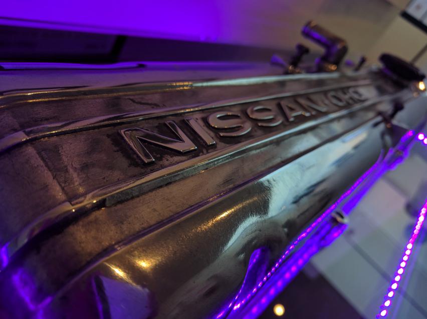

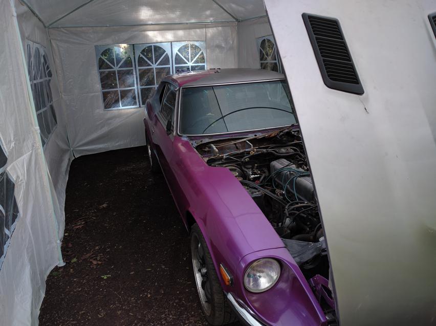

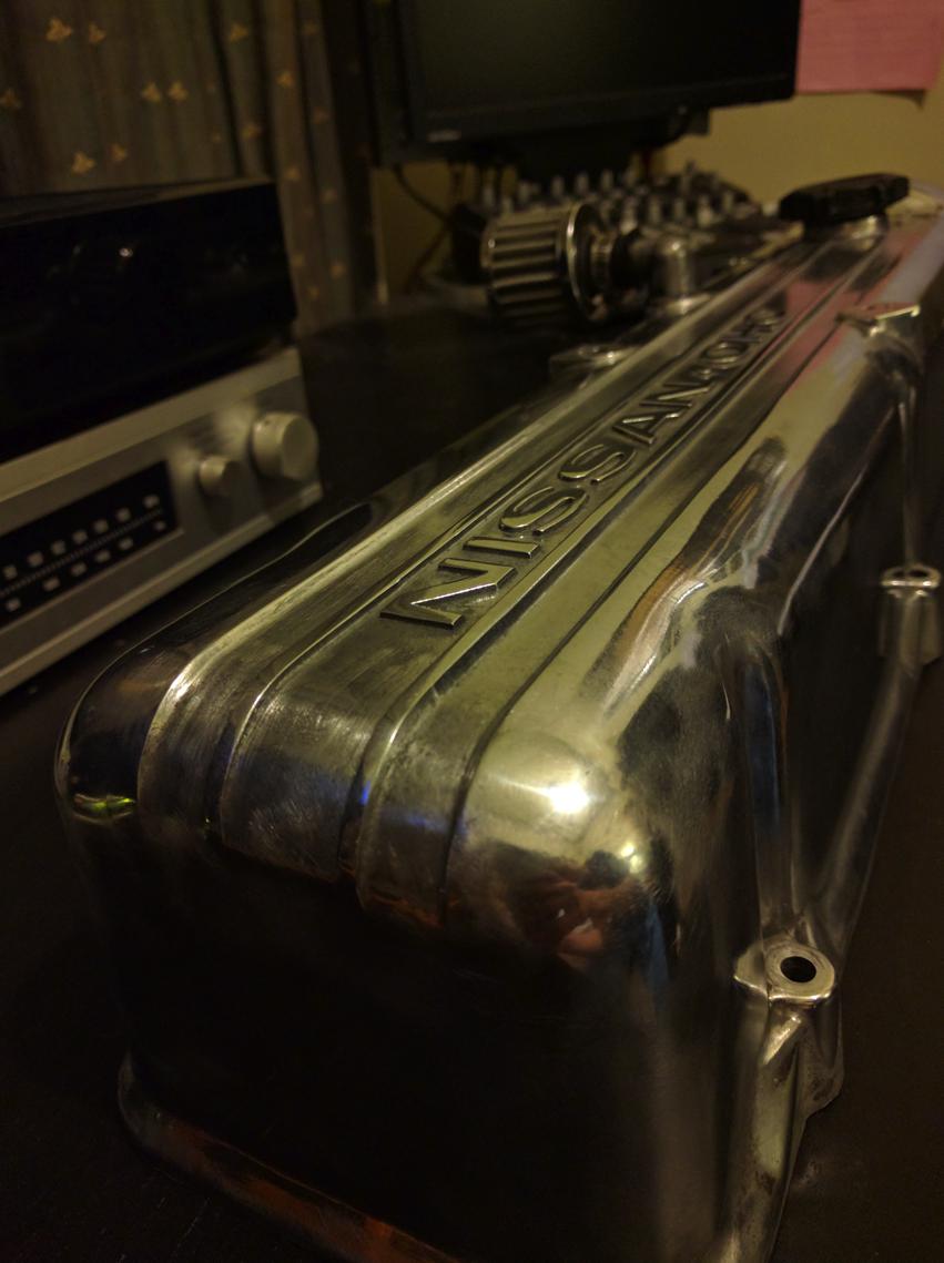

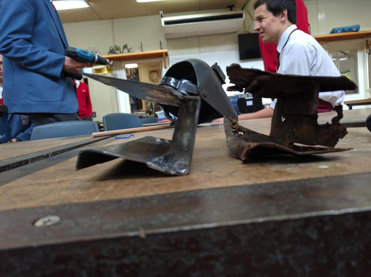

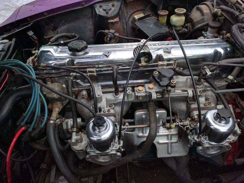

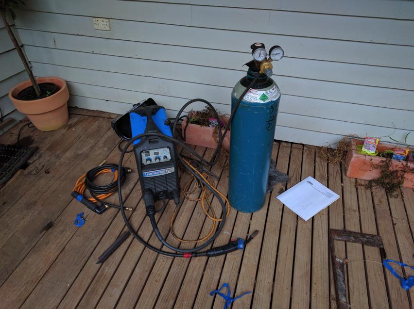

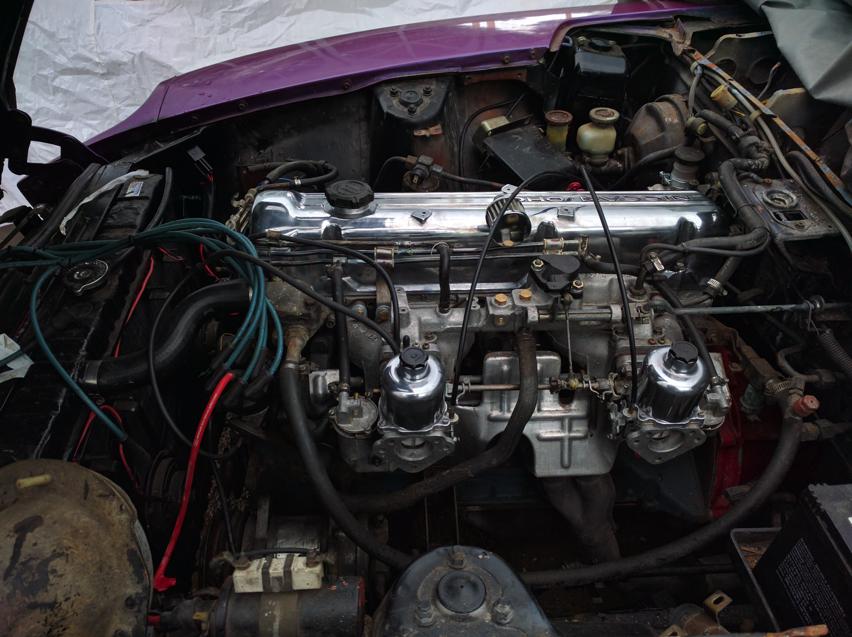

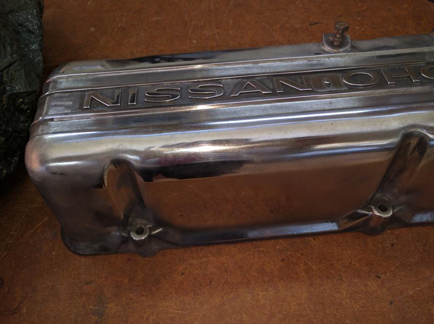

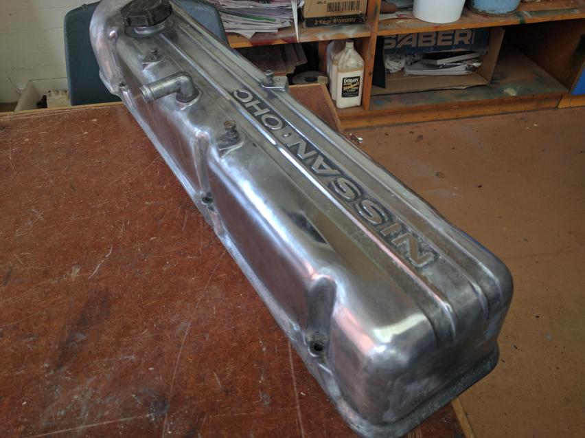

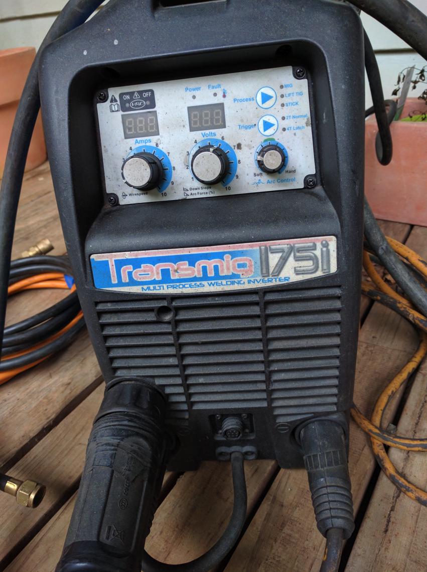

Andrew_L26 Posted August 20, 2016 Author Posted August 20, 2016 (edited) Last few weeks I've got a little bit done, found a bit more rust and decided to actually solve the problem properly (which Locky will hopefully love) and I purchased a second hand Cigweld Transmig 175i with a Gas bottle and regulators etc. I also purchased my spraybooth/ working area which I can thank Jeff for! Polished my Twin British SU domes and Rocker cover which looks fantastic (Just something small to do at school during lunchtime) Also cut a little rust out of the sill and put a borescope camera down the sills and rest of the car to find the extent of the rust issues. Passenger sill is fine other than what I cut out, drivers side needs to be replaced or repaired to a higher standard as I am not happy with the previous repair (although they got rid of all the rust) Dash needs to be pulled out as well as the windshield, scuttle panel removed completely repairs done and replaced, the tail light area needs to be repaired (which shouldn't be too hard with a decent welder) I will re-do the rear window repair properly or I might even be able to hammer and dolly it in to an acceptable state. Also found the terribly done black paint job, makes me think they didn't prep it at all considering the lack of primer and roughing up of the original paint, looks like the paint is coming off at the end of the year! After using a good quality gassed mig (with what very little gas was left) It is incredible how much better my welds were (Not like swiss cheese when ground down which is amazing) having the ability to turn it down so it won't blow through is also incredible! Thanks to Jeff again for the spraybooth idea! Looking forward to seeing what you do with the 240z! Cheers Guys, Andrew Edited August 20, 2016 by Andrew_L26 HomeBuiltByJeff and casho 2 Quote
HomeBuiltByJeff Posted August 20, 2016 Posted August 20, 2016 Looking good. The Gazebo is a nice cheap handy shed. I am not sure how well they will stand up to the weather outside though. I would make sure it is well pegged down Andrew_L26 1 Quote
Andrew_L26 Posted August 21, 2016 Author Posted August 21, 2016 Looking good. The Gazebo is a nice cheap handy shed. I am not sure how well they will stand up to the weather outside though. I would make sure it is well pegged down Yeah, It gets blown around but it's in a fairly sheltered spot so it seems to be ok just with some pegs and guide ropes! We will see in time haha HomeBuiltByJeff 1 Quote

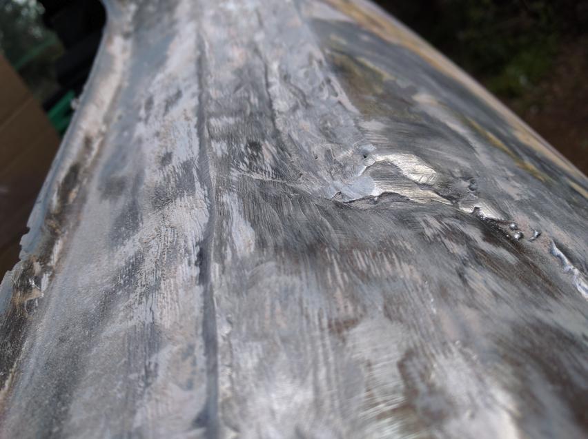

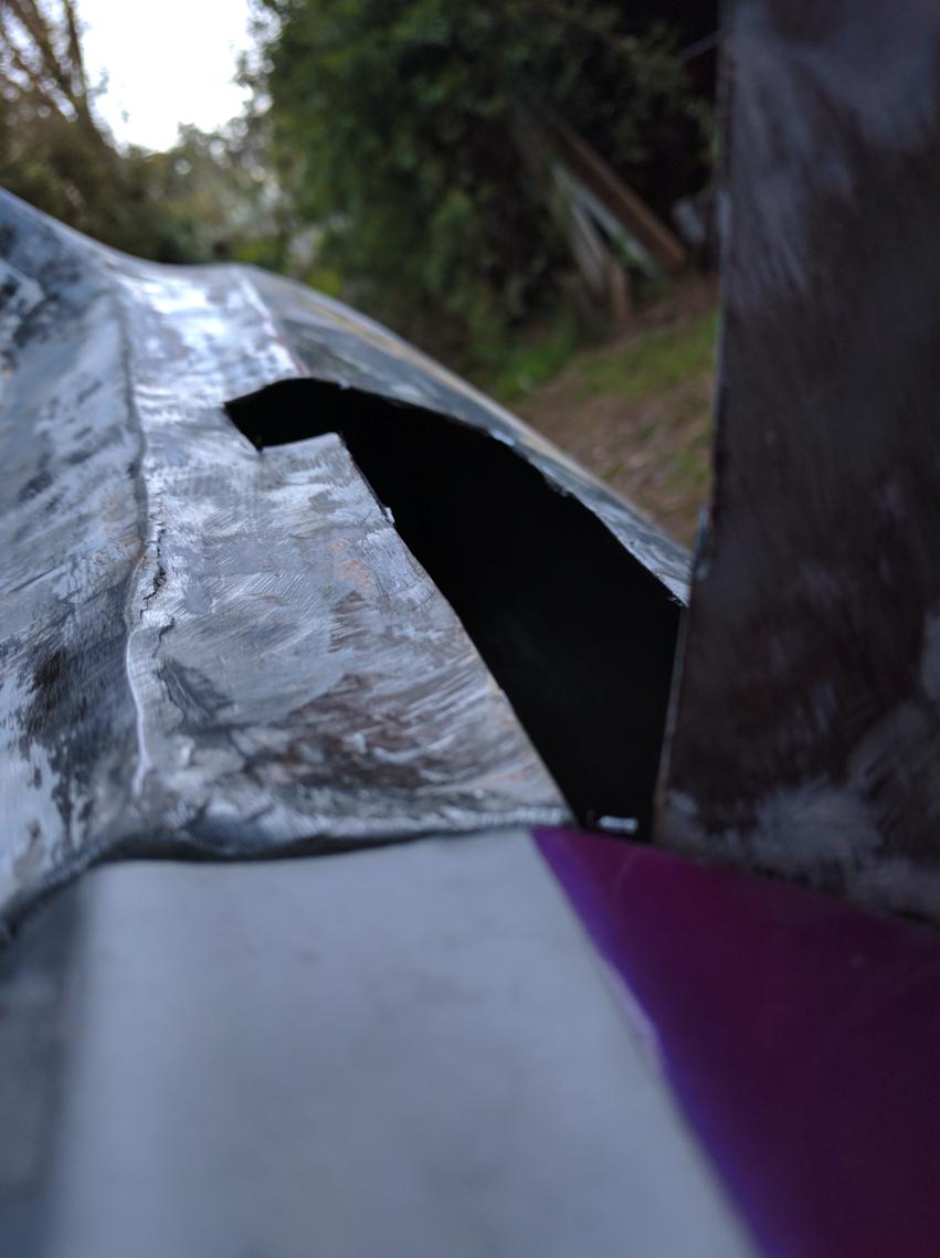

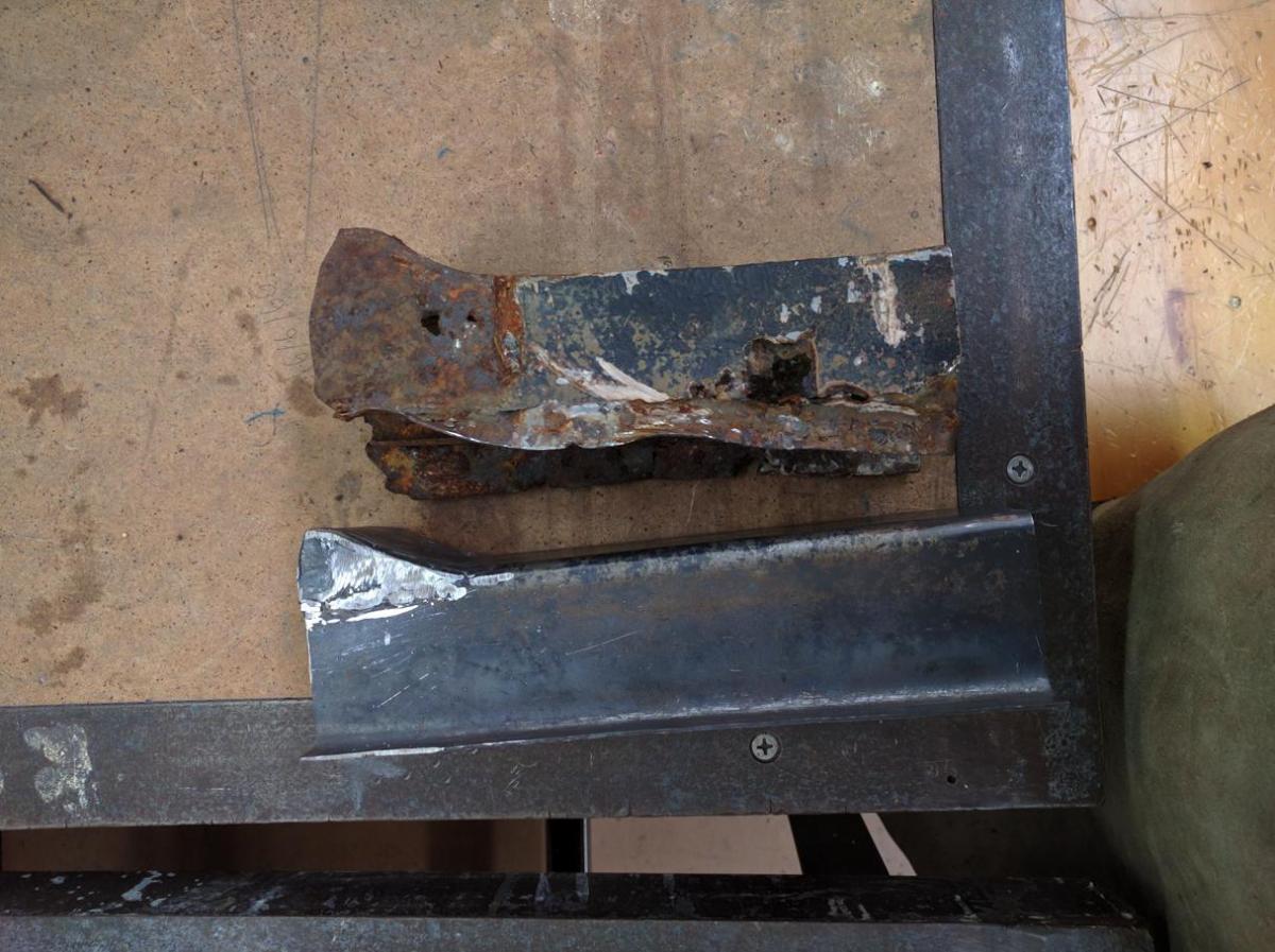

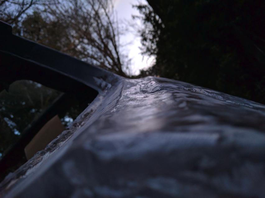

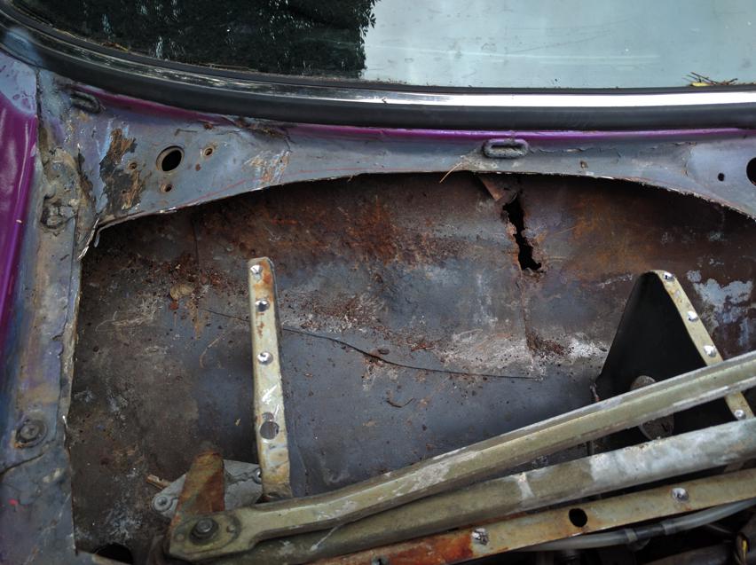

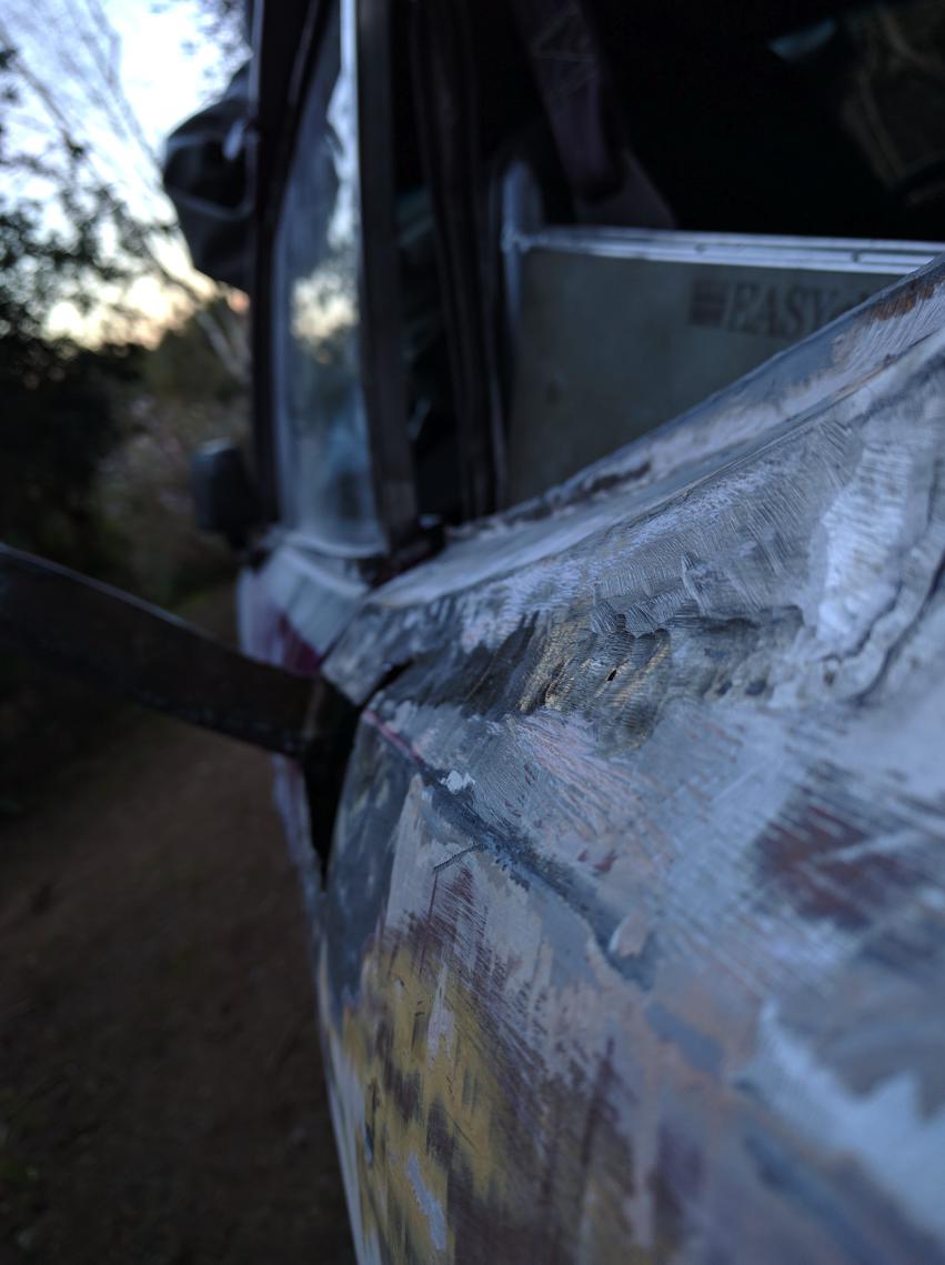

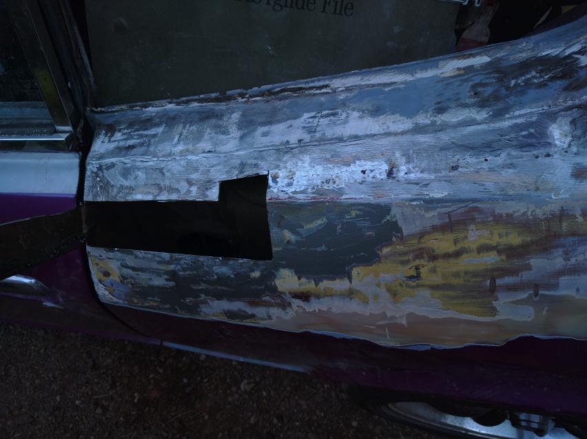

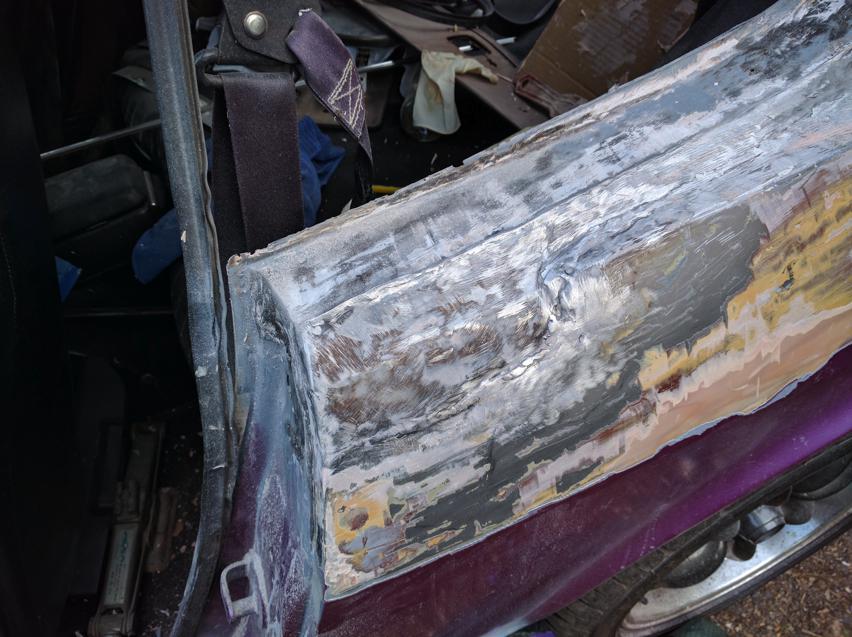

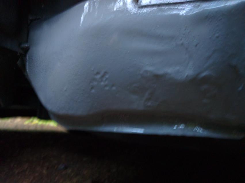

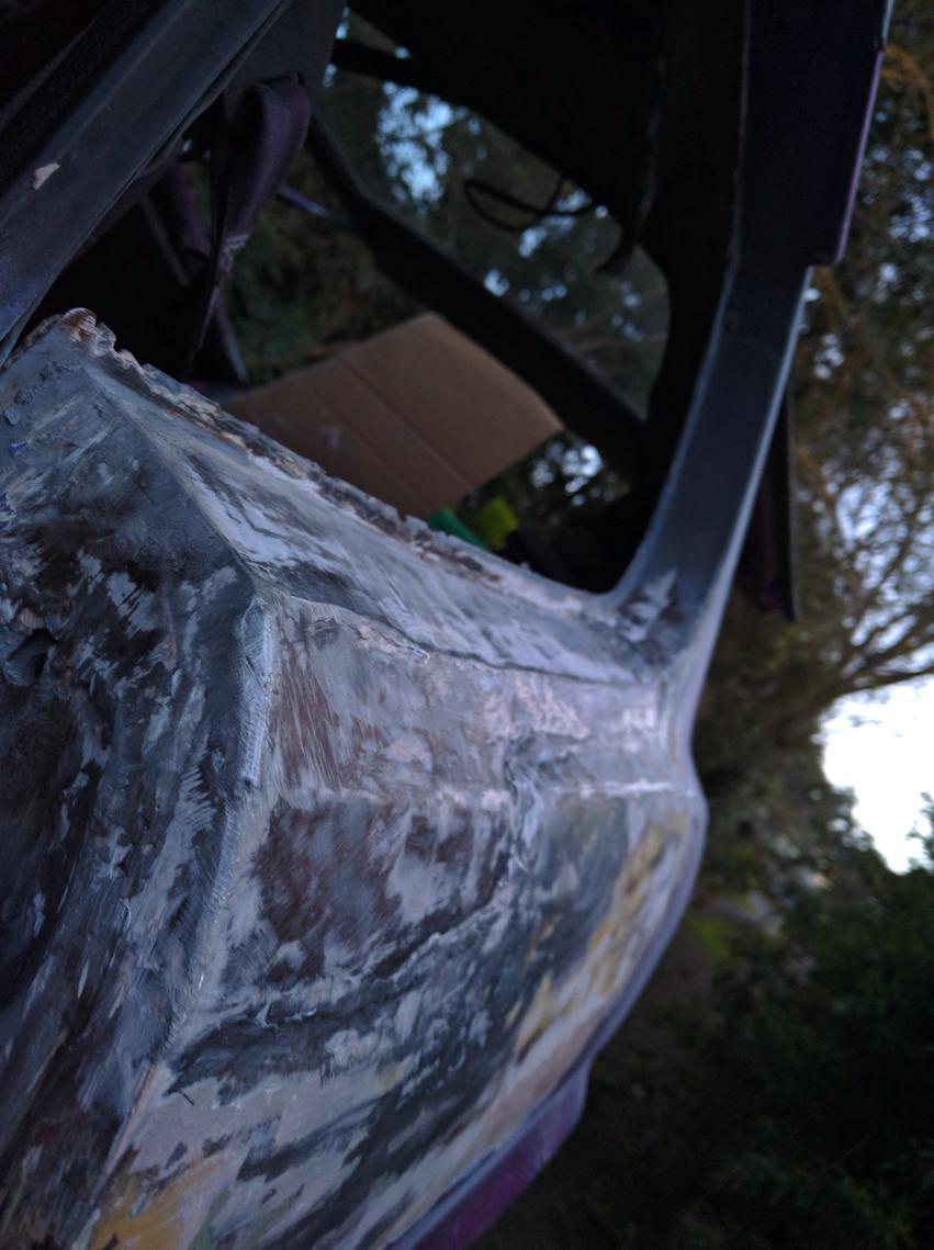

Andrew_L26 Posted August 29, 2016 Author Posted August 29, 2016 So I've pretty well decided on a full stripdown rebuild. I'm not going to strip it down all at once though, I think I'll do a panel at a time to avoid getting distracted and overwhelmed, decided to rip into some bog and begin refining the passenger rear window sill repair. I began with this: Got the little hammer out and began to shape the upper curve Cut out the overlapped bit that was poorly done and ground down some of the welds, I'm planning to weld up the one or two little holes that have appeared since grinding and lead fill the small indent. Actually really enjoyed this little job and I just need to form a bit of sheet to fit these hole. what thickness steel is everyone using for their bodywork? Cheers, Andrew Quote
Administrators gav240z Posted August 29, 2016 Administrators Posted August 29, 2016 19 or 20 gauge (or 0.8mm) seems to be the consensus, but you could measure the thickness of what you cut out and ask for the same when you go to buy sheet metal. PS: That upper swage line on your 1/4 panel would be the perfect candidate to fix with lead wiping. By the way did you see this? http://www.viczcar.com/forum/topic/1924-cars-for-sale-3rd-party-sites-ebay-carsales-etc/?p=182273 Might be easier to unpick the 1/4 panels and use them on your car? The whole shell is $800. Quote
CBR Jeff Posted August 30, 2016 Posted August 30, 2016 I have been using a mix of 0.8 and 1mm cold rolled sheet depending on what section and what I am doing with it. It its just a simple section that does not need any forming or work I tend to use 0.8. If I need to form it, role or us a hammer on it I have been using 1mm as by the time it's been worked it's often thinned and stretched a bit and could be as thin as 0.8. That's a bit of a job you have uncovered there Andrew, I think Gaz has a good suggestion about using a donor panel. I sometimes look at work I have done and wonder if it could have been done better. Then I look at jobs like yours that have probably been done by "professionals" and decide my works not that bad after all. Jeff jeff43 and gav240z 2 Quote
Andrew_L26 Posted August 30, 2016 Author Posted August 30, 2016 19 or 20 gauge (or 0.8mm) seems to be the consensus, but you could measure the thickness of what you cut out and ask for the same when you go to buy sheet metal. PS: That upper swage line on your 1/4 panel would be the perfect candidate to fix with lead wiping. By the way did you see this? http://www.viczcar.com/forum/topic/1924-cars-for-sale-3rd-party-sites-ebay-carsales-etc/?p=182273 Might be easier to unpick the 1/4 panels and use them on your car? The whole shell is $800. I've been thinking about that car but I haven't got the cash at the moment, maybe in a few months I'll take a look if it's still available. I'm thinking that this line shouldn't be too hard to fix if I do it in two sections so I'll just see how I go! Cheers, Andrew Quote
