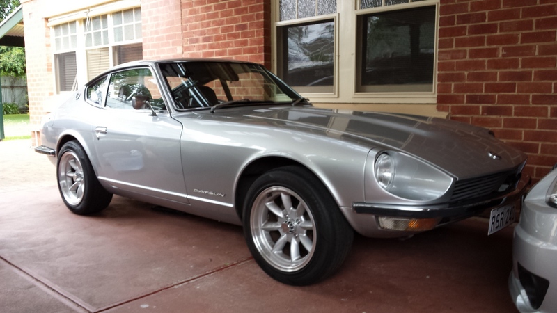

cracker Posted September 19, 2013 Posted September 19, 2013 A little while ago I made an impulse purchase to get back into the zed scene. I had sold my previous 240z with much hesitation and through a largely forced hand, and I'd always end up back on this forum reading up on other people's build progress and watching on with a little envy. So when this sexy little number popped up I simply couldn't refuse. It was priced fairly, was neat and tidy and was very nearly completely rust free - a perfect start. I was keen to have a car that was driveable straight away but that had room for improvement and would let me put my own stamp on things as time went on. Luckily I called first and agreed to buy sight unseen, because the crowds were building and I think a couple of people missed out. A week later and after a short drive (haha!) to and from Wodonga, I was again the owner of a beautiful Datsun 240z. Unfortunately that's where the fairytale start finished... about 3 leisurely drives later, the gearbox decided enough was enough and refused to continue. A few extra dollars later and with the expert guidance of Peter Hall in Lobethal, I had a reconditioned L28 5-speed installed and the car was going great (sort of). It has a few little issues that need to be sorted, one of which being suspension, which is very tired indeed - the front right is very stiff and the rear springs sag and bounce quite badly. I am currently considering either coilovers or new struts and have been scanning the forums for options and associated costs etc. In the near future I will be addressing the suspension and the rubber door seals which also need replacing. The old rubber has "decomposed" onto the door frame so the removal of the old seals will be even more difficult than the installation of the new seals. With these jobs complete the car should be very comfortable and capable for weekend (or even daily) driving, though will not be by any means fast. I'll be happy enjoying it for what it is and for the same reasons people enjoyed it back in the early 70's. A little bit more about the car... September 1973 240z - factory silver L24 with reconditioned L28 5-speed manual gearbox and twin 240z SU's Red vinyl interior (previous owner re-upholstered the seats which look fantastic) 14" Hotwire mags Down the track I will look at changing wheels, installing headers and exhaust, replacing suspension and rod bushes all round (probably at the same time as I get around to replacing the suspension) and repairing the cracked dash, along with some other small interior imperfections. I'm not in any rush and will enjoy learning about the car as I make repairs and improvements, as I never really tackled too much on my old car. James Quote

cracker Posted December 24, 2013 Author Posted December 24, 2013 Slow progress as anticipated but I have recently bought some new wheels, have removed the "over bumper" indicators (installed 260z style indicator/park lights) and removed the protective stripping from the side of the car. I put the new wheels on but wasn't happy with the ride height so it is already on jacks awaiting new suspension to be installed. I bought the KYB GR2 struts for all 4 corners as it was by far the cheapest option (around $400 posted from US) and I already have some firmer, lower springs to suit. Overall starting to look a bit sleeker I think, looking forward to seeing it a little lower, but also a little worried the guards will scrub. If I need to lip the guards I'll tackle that when it becomes a problem - is this possible to do yourself or should an expert be sought? James Quote

dat240z Posted December 25, 2013 Posted December 25, 2013 What rim/tyre size mate? By looking at it, id say yes itll scrub once lowered! Quote
Moderators Zedman240® Posted December 25, 2013 Moderators Posted December 25, 2013 The rims look good on a silver zed! Rims are 16x8 with a -4 offset; they fit on my zed but with some lipping of the wheel arches. I did get some scrubbing but only on large bumps through tight corners under speed. Other than that on the normal roads they were fine. Quote

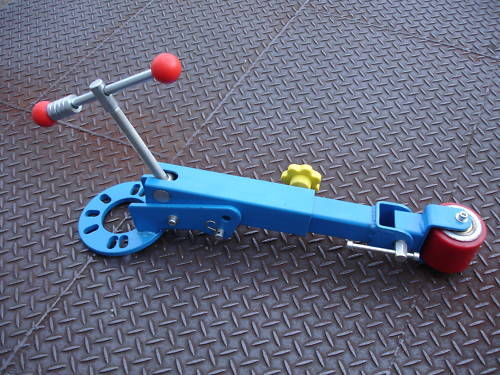

cracker Posted December 26, 2013 Author Posted December 26, 2013 Thanks Mark! And yeah I'll be looking at lipping the guards just to be on the safe side - is this a DIY job or should I be seeking a professional? Quote
Scoota G Posted December 26, 2013 Posted December 26, 2013 I'm sure someone here has the proper roller. There is always a risk of paint damage professional or not. http://www.ebay.com.au/itm/Auto-Vehicle-Fender-Guard-Roller-Lip-Reforming-Rolling-Expander-Tool-/390732640115?pt=AU_Car_Parts_Accessories&hash=item5af97aef73&_uhb=1 Quote
cracker Posted December 30, 2013 Author Posted December 30, 2013 Hmmm... DIY roller is tempting! With 40 year old paint I'm not sure anybody will be able to prevent a little cracking... haha Quote

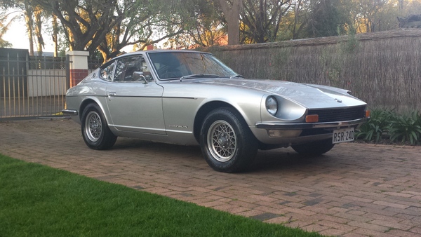

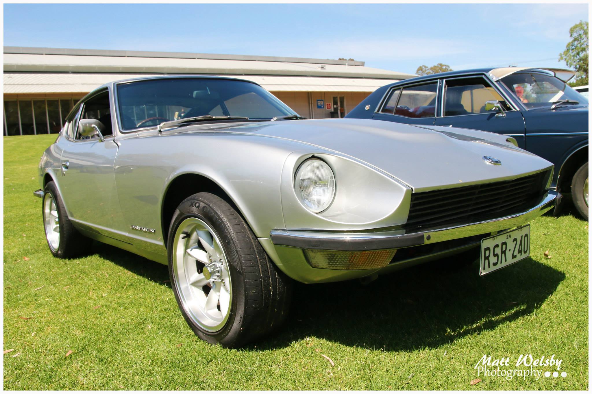

cracker Posted November 27, 2014 Author Posted November 27, 2014 Quick snap taken by a photographer at the Datsun day last Sunday - makes it look pretty good! Still looks a bit 4wd though... ah well. Quote
oldmates260z Posted November 27, 2014 Posted November 27, 2014 Looks great, those wheels really set it off! Quote
Moderators PB260Z Posted November 29, 2014 Moderators Posted November 29, 2014 Hi James Really nice looking Z you have got. Cheers PB Quote

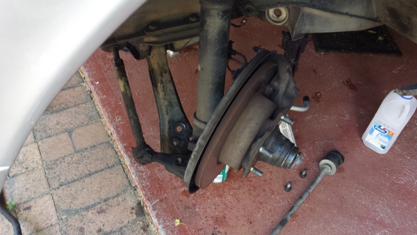

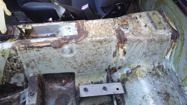

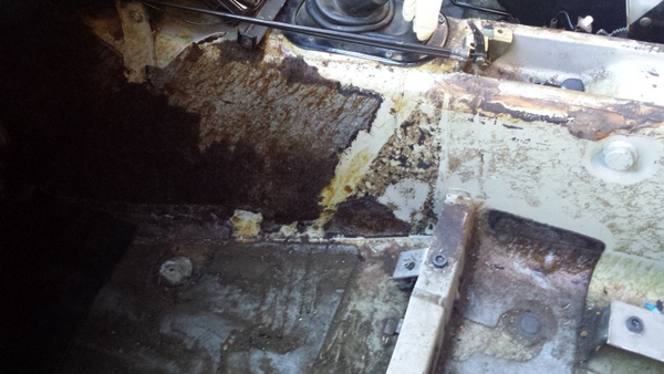

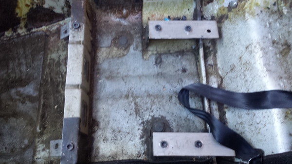

cracker Posted January 1, 2015 Author Posted January 1, 2015 Thanks for the kind words all! Some work over the Christmas break while nobody wants to buy or sell houses... I've started to strip the interior of the crappy old tar and horse hair insulator (if you can call it that!?) - I gave up after getting to the front of the trans tunnel where the tar is REALLY stubborn - anyone know any tricks to getting this off without damaging the paint? I've now got a full set of reasonable condition secondhand black vinyl trim to install once I've finished stripping the old crap and putting in new sound deadener/heat insulator. I've included photos of my bolt in seat rails (installed a few months ago) which have allowed me to retain the stock seat mounts. This solution is for FD rx-7 seats, which are a great fit and very comfy/supportive, in case anyone has interest. Currently re-bushing the whole suspension setup as well, just finished the front and will be tackling the rear once Adelaide temperatures return to sub-40 degrees.. I accidentally took the outer metal sleeve out of the transmission x-member without realising the urethane bushings require it to be retained! Grrr Super keen to get it done and see how much difference there is! Had some very very tired rubber bits haha :/ Quote

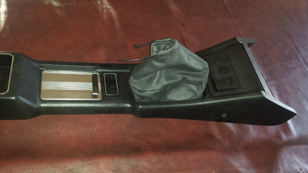

cracker Posted January 1, 2015 Author Posted January 1, 2015 Should also add that in all my tinkering I have come across zero rust - WIN! The girlfriend also bought me leather shifter and handbrake boots (and helped attach the shifter boot!) for xmas so decided to give the console a tidy up ready to go back in shortly. Quote
Administrators gav240z Posted January 1, 2015 Administrators Posted January 1, 2015 Apparently dry ice helps remove sound deadening material easily? Never tried it myself and don't know much about proper handling of the stuff. Quote
CroS13 Posted January 1, 2015 Posted January 1, 2015 i used dry ice on mine. you can get it from any BOC gas, it isn't cheap, about $9 per kg. i just took a big esky with me and they filled it up. (BOC have dry ice pellets) Don't use your bare hands, you will get a chemical burn, i just used old leather gardening gloves and i was fine, mind you they were riddled with holes, my fingers were poking out through the ends, but i didn't hurt myself. you just get a scoop, lay it over the area, wait about 2-5 minutes, you will hear it cracking and freezing the sound deadening. then i used a chisel and hammer and chipped it all away. The transmission tunnel was a real pain of an area as it was hard to get the ice to sit there without sliding off. i ended up taping down some clear sheeting just bellow the area i wanted to work on, and tipped the ice into it to catch it and hold it against the trans tunnel. seemed to work. Pro tip, after the 5 minutes or so, scoop up the ice pellets back into your esky before you attack the panel, it isnt cheap! still a real pain to do, it took me all day. Rudolf. Quote
cracker Posted January 2, 2015 Author Posted January 2, 2015 Thanks guys, hadn't even thought of dry ice! Found a couple of DIY guides that suggest using isopropyl alcohol with the dry ice (once mashed or similar) as it helps break down the ice into a paste of sorts which makes application a bit easier, so I'll give that a crack (no pun intended) once rear suspension bushes are done. Quote
