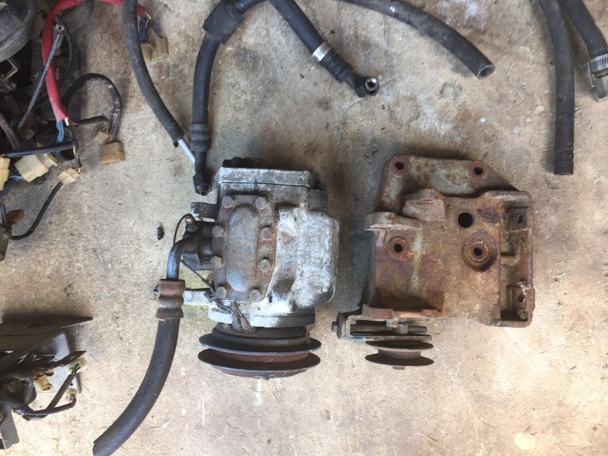

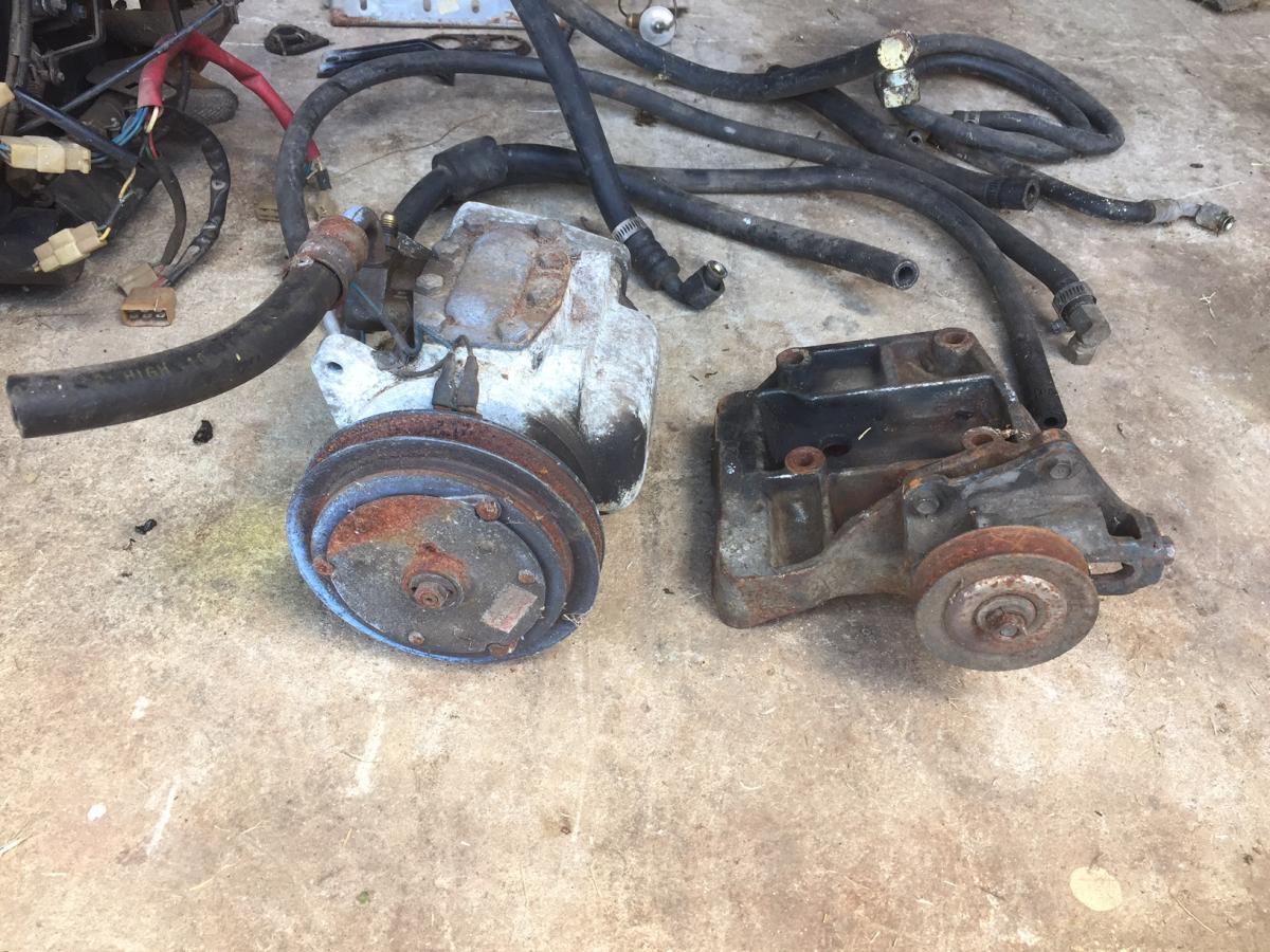

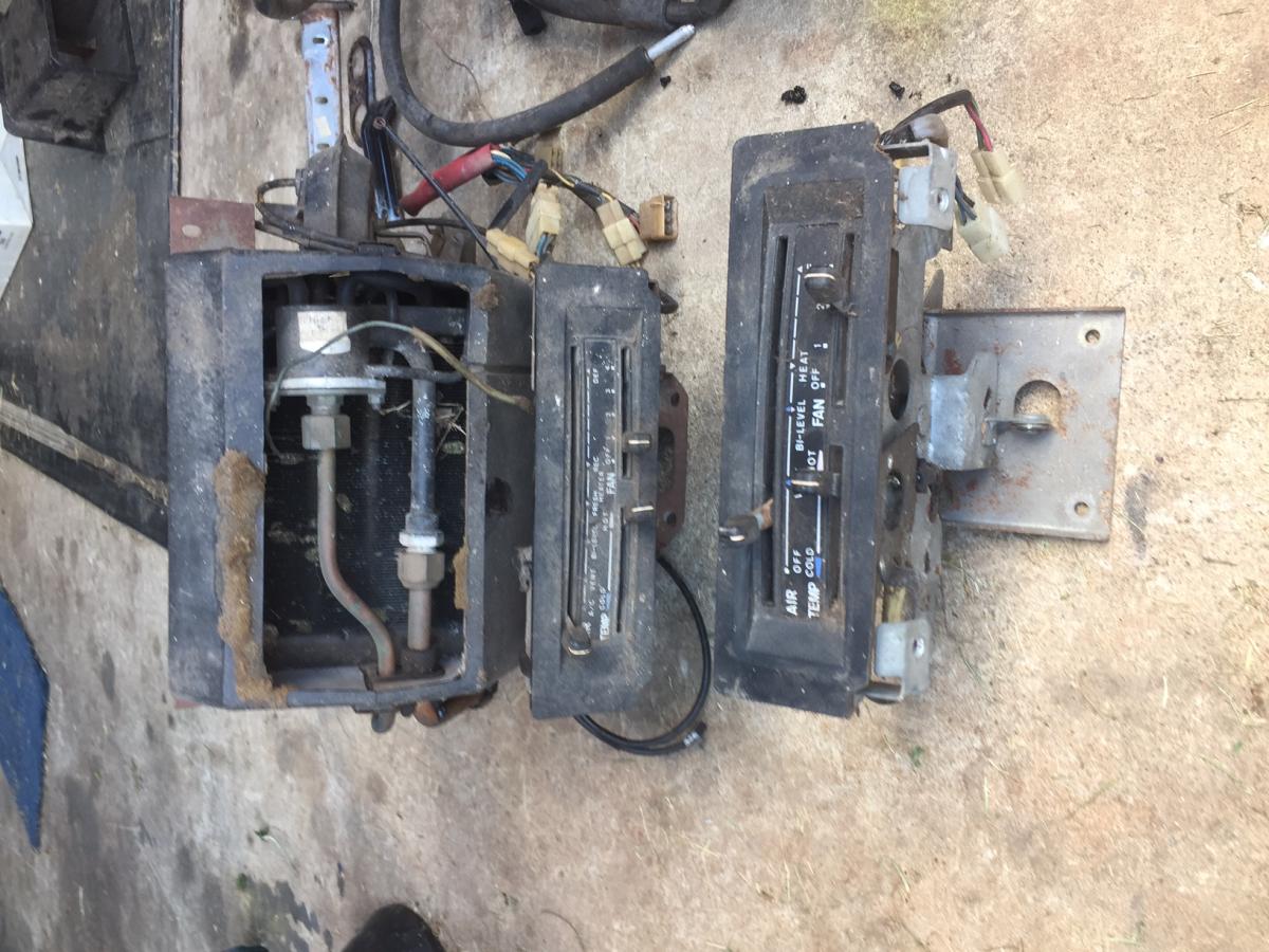

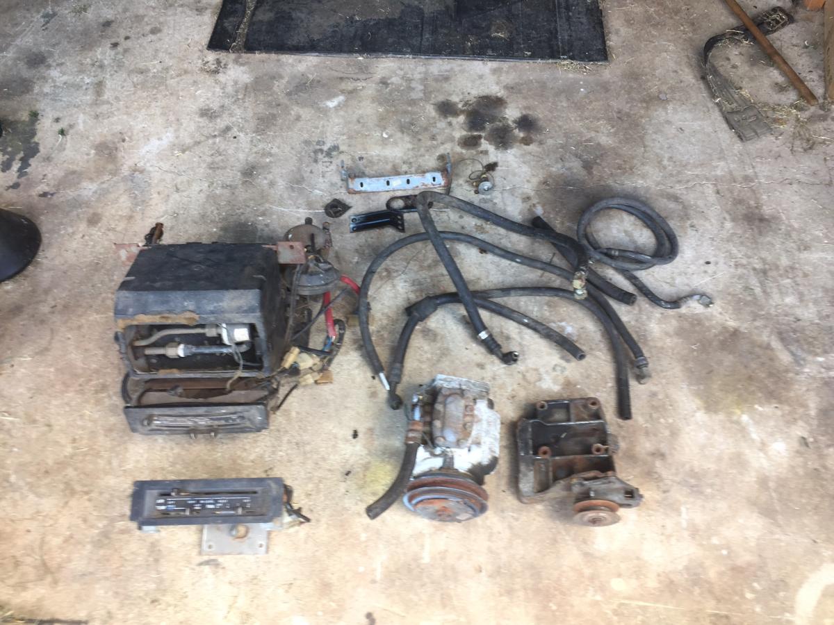

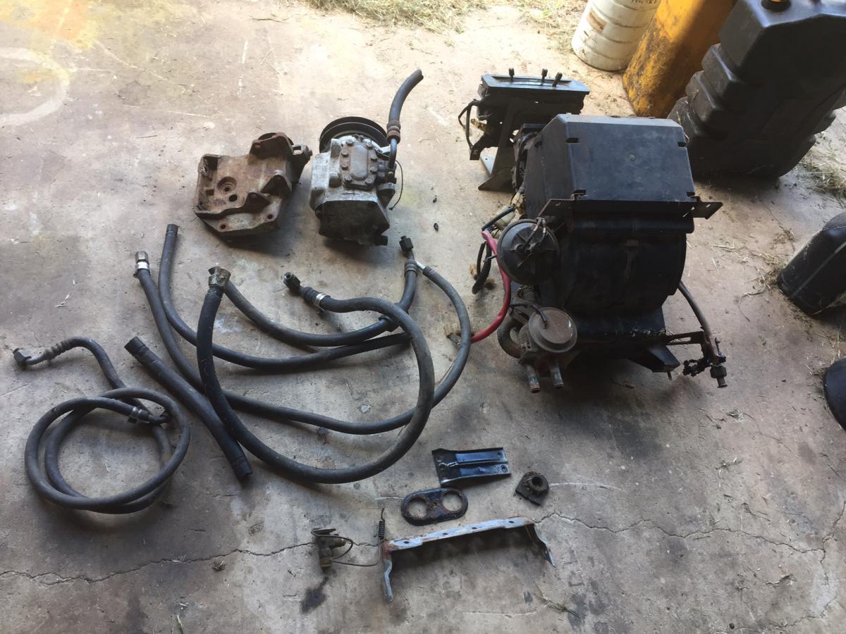

The following parts I bought over 10 years ago and never used so do not know their working condition: - evaporator section complete with coil, controls, valve and piping - compressor mounting bracket - compressor (but best you buy a new one) - various hoses and fittings (but you will need to buy new ones) - new receiver drier You still need the condenser coil It fits later model Zeds, 1976 onwards I think $350 ono Located in Outer Brisbane

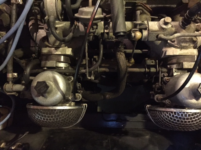

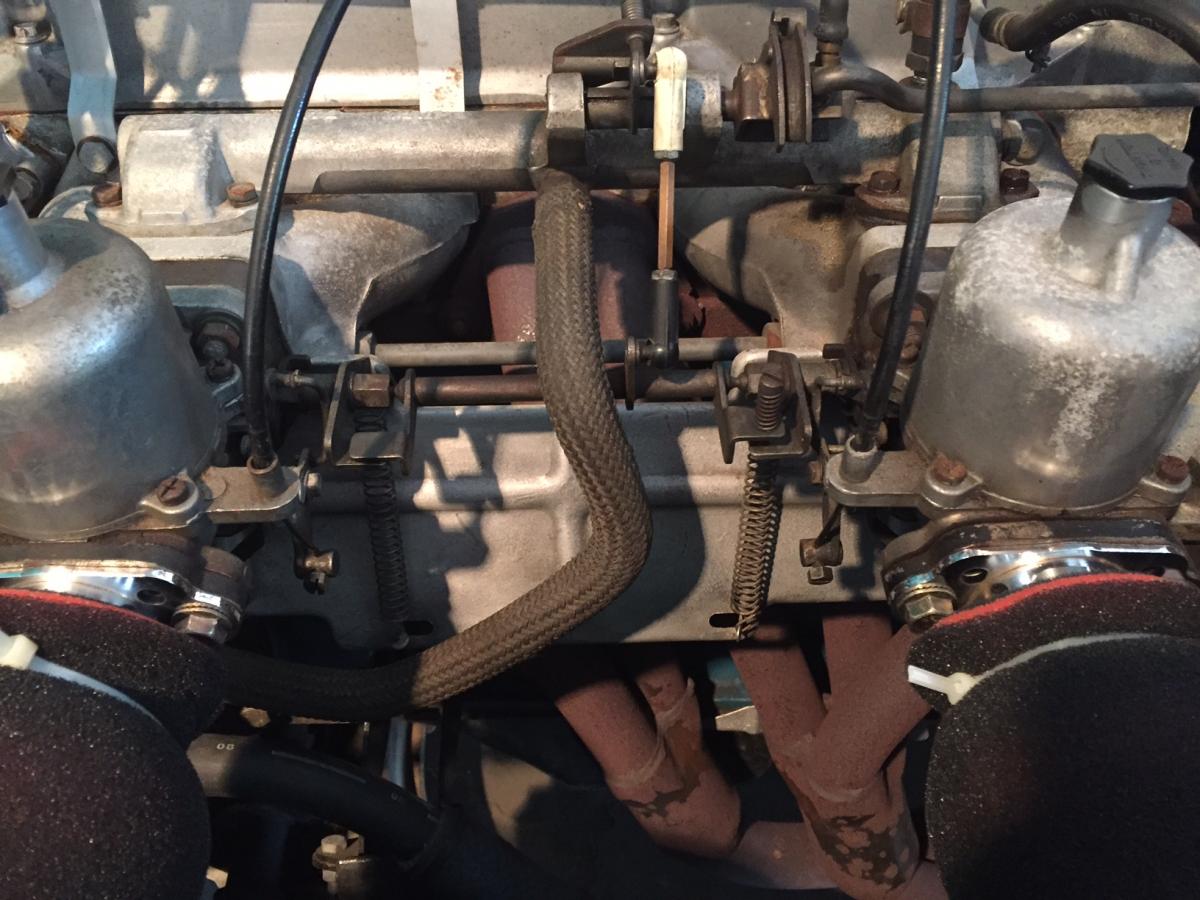

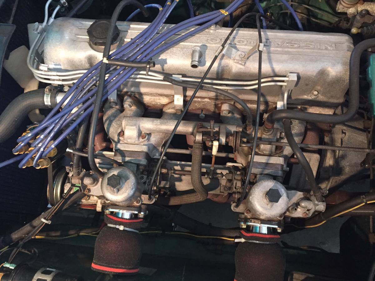

Could not find a thread here anywhere here but has anyone put up much about the various setups on the SU's? Firstly my 2+2 has what I thought was the standard setup but with a closer look it was not getting full throttle. The geometry appears wrong with the way in which the adjustable arm that goes down perpendicular to the linkage between the carbies. When I compared them to a mate's L20A Fairlady (import JDM-last photo) its setup was different in that the centre linkage was in board of the centreline of the shaft between the carbies. This resulted in the shaft rotating counter clockwise looking from the front of the car whereas mine rotates clockwise. Checking my son's 2+2 it rotated the same direction as mine. 1. Has anyone come across differing shaft rotation directions before? 2. Has anyone seen a instruction to set up the linkages

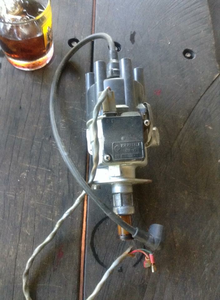

I am thinking a older dizzy with points and put in a electronic upgrade would be best. Looking at the complexity of this dizzy it does not look like a good option. Thanks guys
After a working distributor, what ever will get my L28 running again Prefer Brisbane

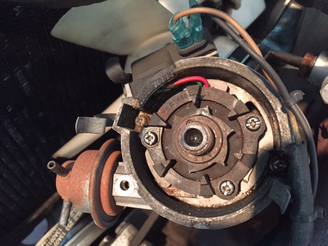

Movement in the right direction.... Found a big leak in vacuum advance hose, fixed that but little change in timing. Will not go above 25 deg with hose on or off. So vacuum advance not working. Took top distributor and found the magnetic ring broken..... Is there anyone in Brisbane that rebuilds them?
