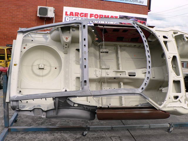

DreamZproject Posted November 4, 2013 Author Posted November 4, 2013 Woweez, It's been a looooong time since my last entry, i wish as much work had been put in as time, but I have been ridiculously busy and unmotivated to do anything really. Luckily in the last month or so i have found a little more time, have substantially more money (coming from being a student) and feel pepped up again to get this car on the road! So, the car is now on the rotiss me and my dad made. It's not 100% perfect which i am a little concerned about, but I'm going to reinforce it more before i fully commit to getting under the car. It had a slight tendancy to rock backwards and forwards, which I'm sure would put stress on welds and bolts. I'm 90% sure this is due to the center rod being a bit on the thin side and flexing over the 6m length. Do you guys think it would be worth laminating another length of metal on to it? All that is now left on the car is; Diff and rear assembly petrol tank rear break lines 30% of original body deadener (yes i am using a chisel to get it off) So what I'd assume is another 5 hours of work and the car will be 100% stripped up until the point of paint stripping. In regards to body deadener that is painted on the wheel wells, is it worth me scraping that all off before i take it to the media blasters? Or will their guns take it off easily? Time to get Lurch to check it all out! Quote
Linton Posted November 4, 2013 Posted November 4, 2013 put some blocks under the centre of the bar it will take some of the bounce out of it Quote
DreamZproject Posted November 4, 2013 Author Posted November 4, 2013 I had thought of that, but it poses a problem when i will eventually want to move the rotiss and put it up on a trailer... Perhaps i should put in some removeable diagonals? Quote

C.A.R. Posted November 4, 2013 Posted November 4, 2013 Top job Robbie! Get the suspension out & you won't have the flexing issue - the suspension weighs a heap... EDIT: as per Dave's comment below, you need castors on the bottom tie bar. Quote
KatoKid Posted November 4, 2013 Posted November 4, 2013 Rotisserie is good but the tie bar from front to back needs to be more substantial to stop flexing. Use some 50x50 and put casters on the bar like mine.... Quote
DreamZproject Posted November 5, 2013 Author Posted November 5, 2013 Great suggestions guys. I'll definately put in a thicker tie bar and some wheels before i get under the car properly. The next problem i have realised is that I'm going to have to get this whole thing up on a trailer at some point... not sure how that's going to happen. And do most media blasting places have their own trailers that you borrow or will i need to rent an extra wide trailer? Quote

RB26DETT Posted November 5, 2013 Posted November 5, 2013 Just add the extra castors on bottom tie bar. You can leave the car as it is on the spit and hire a tilt/slide tray tow truck. They can then just winch it on as is, saves heaps of stuffing about. Quote
Agno Posted November 5, 2013 Posted November 5, 2013 First thing I'd do after adding the castors is taking out the suspension, diff and brakes. You will find it about a trillion times easier to manoeuvre after that! Quote
DreamZproject Posted December 2, 2013 Author Posted December 2, 2013 Hey guys, just a little update. I added a 3mm 50x50 square section to the rotiss, and added a little more boltage to the rotation plate (i was only using 2 bolts each end, now 4) and the car is heaps more sturdy. I have also now taken 99.99% of the parts off the car (with the odd bolt and clip remaining). It feels as though the car would only weigh a couple of hundred kilo's now!!! All that's left to do before the strippers take it away (I propbably should have said blasters) is remove the last few bits of body deadener from the inside of the car and the POR15 like stuff in the wheel wells. IM ALMOST THERE!!! Quote
