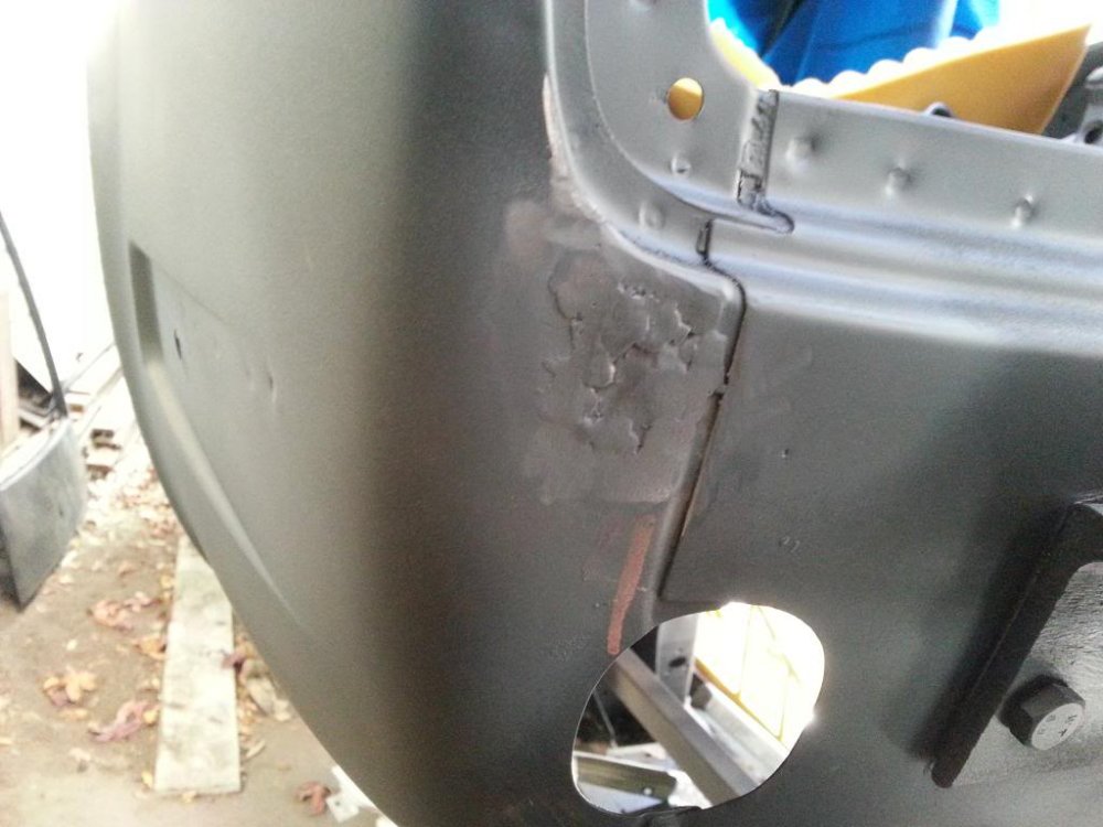

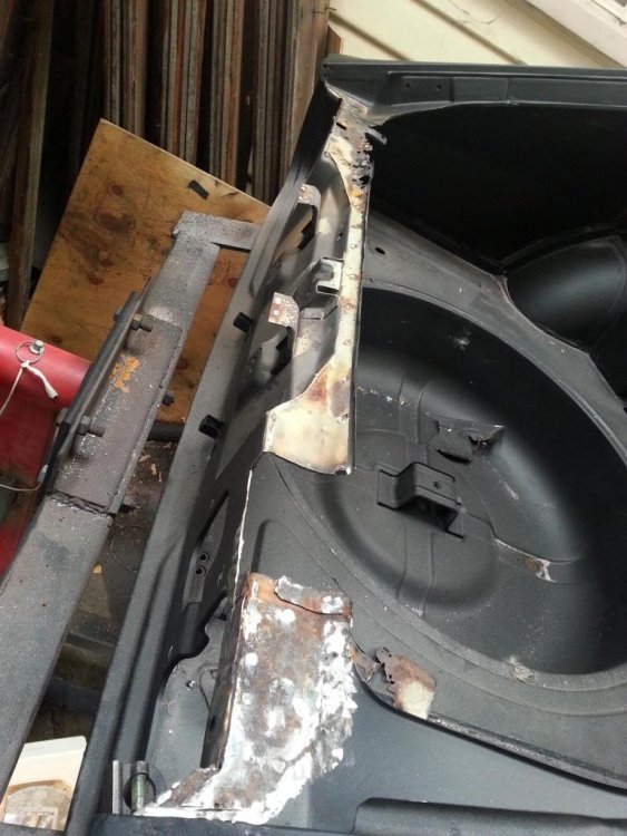

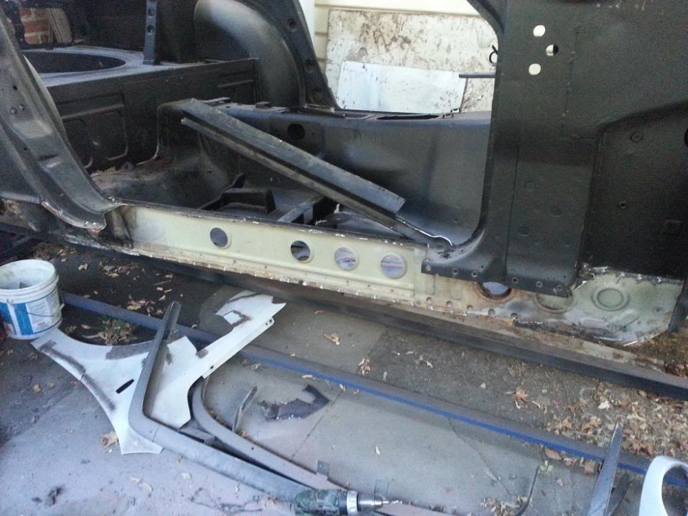

C.A.R. Posted May 11, 2014 Posted May 11, 2014 So some progress has been made on Robbie's 260! Saturday (10/5) I gave him a hand in making a start on the rust repairs on his shell. Robbie has bought new floors, sills, doglegs & hatch slam panel so I set him to work in unpicking what remained of the hatch slam panel. It's was made harder by the fact that someone had previously attempted to (badly) repair it. So we chopped it all out & started again. Robbie has more photos, so I'll let him continue the story... Quote

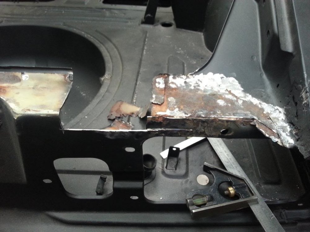

DreamZproject Posted May 11, 2014 Author Posted May 11, 2014 As the good man says, Yesterday I bravely soldiered on with the knowledge and guidance of said "good man", and boy did I learn a bit! All of the things were extremely logical, but would have taken me months and months of work by myself to learn the same things as I did in one day. The most beneficial points were how and when to use the various tools that I have, and should have, at my disposal. Just tonight I ran out and grabbed another hundred odd dollars worth of tools that my dad very kindly sponsored me for! (his logic being that he'll use them a lot more than me in his own work). Two tools I am yet to grab are the spot welder drill bit, and a carbide burr. Both somewhat difficult to find, and the Burr I found in Bunnings was 70 over dollars!!! I'll check out total tools this week. I think that we may have, combined, covered roughly 5% of the work yesterday, so I really only have 38 solid days work left! :/ Here comes the rust! Quote

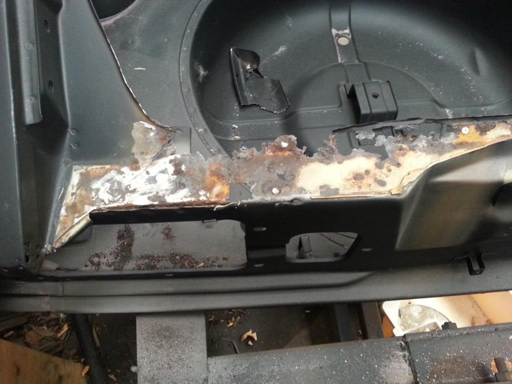

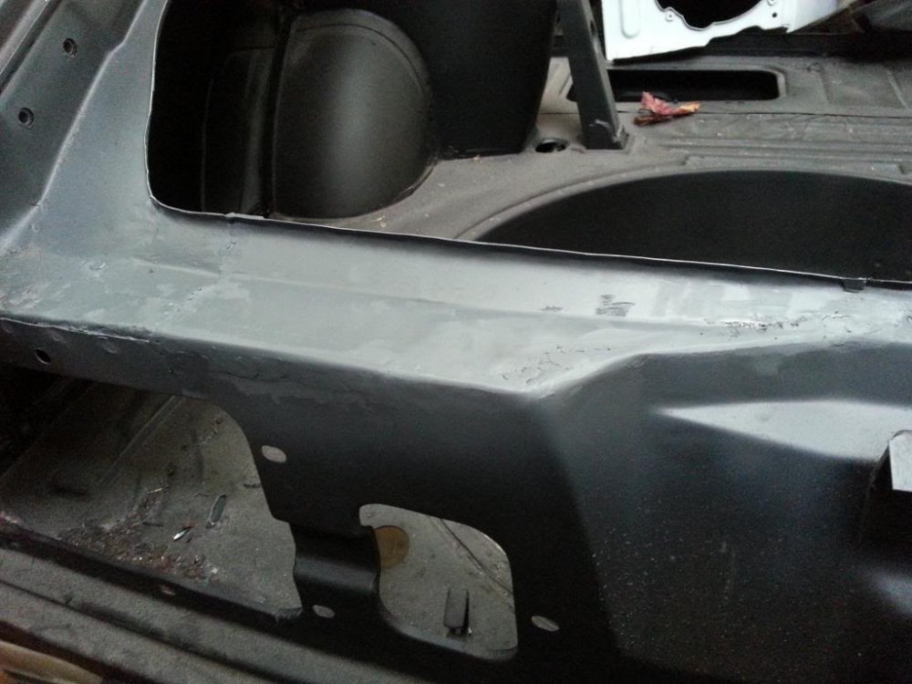

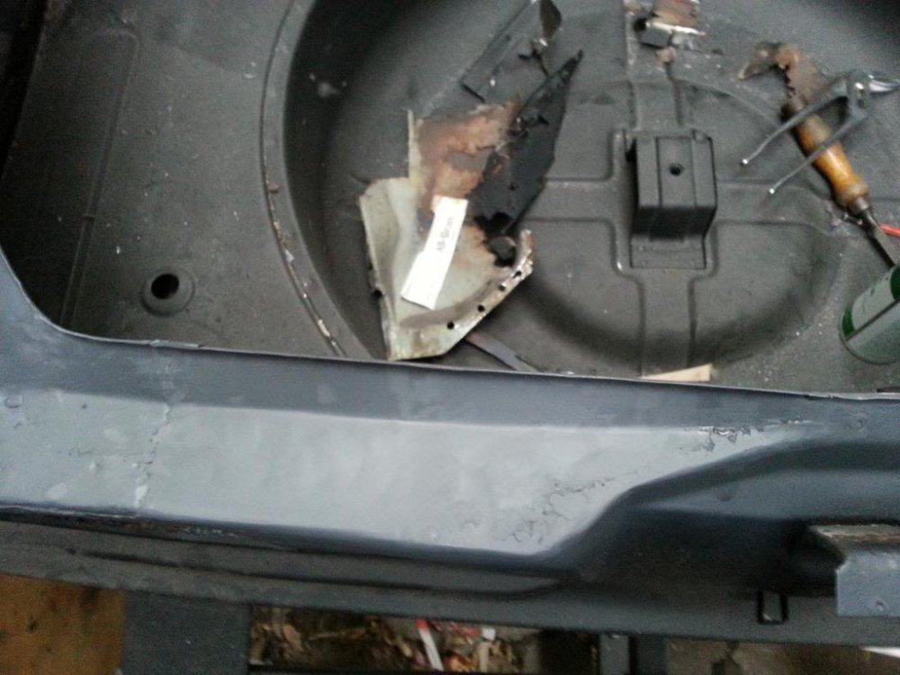

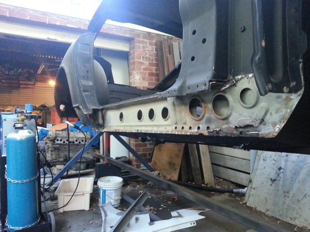

DreamZproject Posted May 17, 2014 Author Posted May 17, 2014 Rust? What rust? I did the left hand side completely unassisted. It's not perfect, but pretty damn close i think. There were some areas where I felt like I was constantly chasing blow-through, so I'm assuming I didn't cut back hard enough and was welding into some very thin rusted out panel. Just took more time. What do you think guys? Quote
Karljsw Posted May 17, 2014 Posted May 17, 2014 Looks awesome, have to do the same to mine sooner or later so thanks for the info Quote
C.A.R. Posted May 17, 2014 Posted May 17, 2014 As long as you're happy with the result Robbie, that's all that matters Quote
DreamZproject Posted May 17, 2014 Author Posted May 17, 2014 As long as you're happy with the result Robbie, that's all that matters uh oh... sounds like I did shit :/ Quote

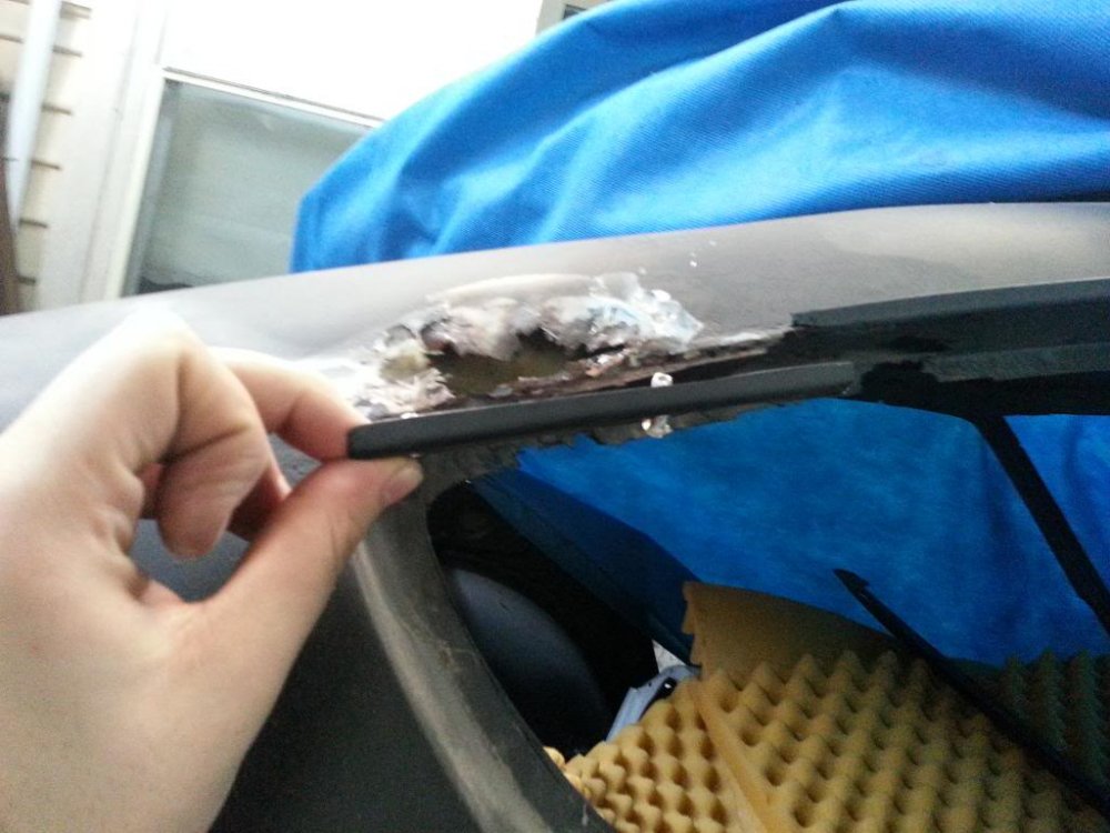

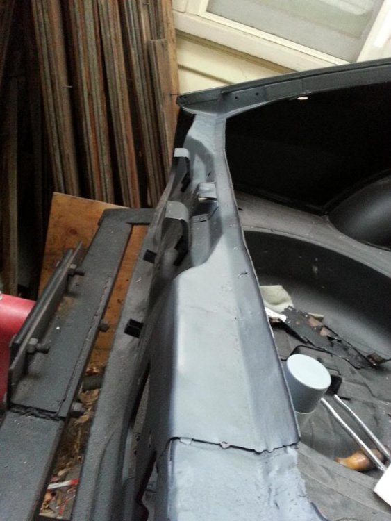

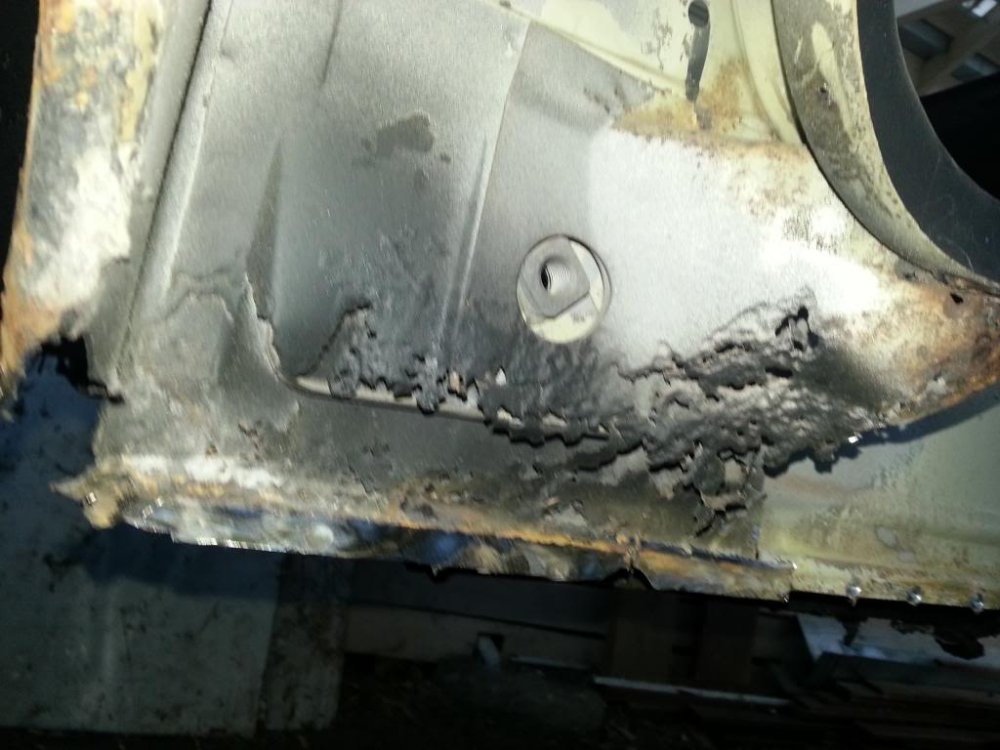

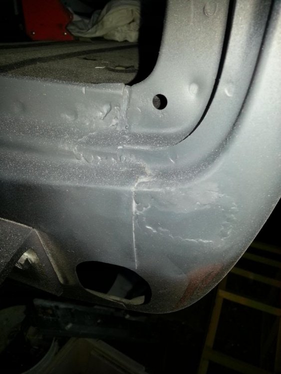

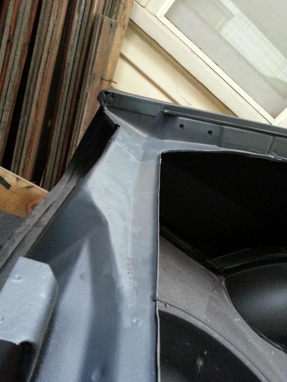

DreamZproject Posted May 27, 2014 Author Posted May 27, 2014 Huh, just realised I didn't chuck up last weekends work. This one looks much better in real life. I guess I could still grind it back a bot more too... Who's been walking on my sheet metal!? Hey! Look what else I found!!! :/ Just out of curiosity, how many peoples cars were worse than this? Would my car happen to be in the top 10% of rusted areas? Quote
Moderators Zedman240® Posted May 27, 2014 Moderators Posted May 27, 2014 Seen worse...much much worse... Quote
DreamZproject Posted May 27, 2014 Author Posted May 27, 2014 Ok good. Was starting to think that I was wasting my time. Every time I did a bit of welding I'd uncover more bodged up rust. :/ Quote

Administrators gav240z Posted May 28, 2014 Administrators Posted May 28, 2014 Plastic print that instead of metal . As to how rusty your car is? Well.. I suspect many Zeds are like that, it's just the owners haven't stripped them all the way down to find out. These cars rust from the inside out, which is why I might be unpicking my roof just to see if there is anything that needs to be taken care of.. but I'll be asking the experts about that when the time comes. Quote
DreamZproject Posted May 28, 2014 Author Posted May 28, 2014 Hmm plastic printing. .. Yeah it just peeves me that someone spent all their time covering up all the rust holes with fiberglass instead of spending a bit longer doing it properly. Now I have to inspect every bloody nook and cranny that isn't just metal. Quote
d3c0y Posted May 28, 2014 Posted May 28, 2014 Probably would have cost a heap more if someone fixed it properly and you wouldnt have been able to afford it. Quote
DreamZproject Posted May 28, 2014 Author Posted May 28, 2014 This is true... Eh you know what they say about hindsight! At least I will be able to very safely say I have one of the most rust free Z's in the country! Quote
