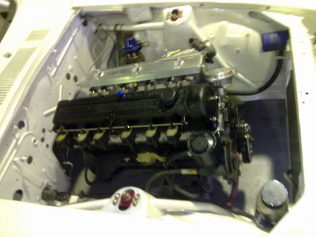

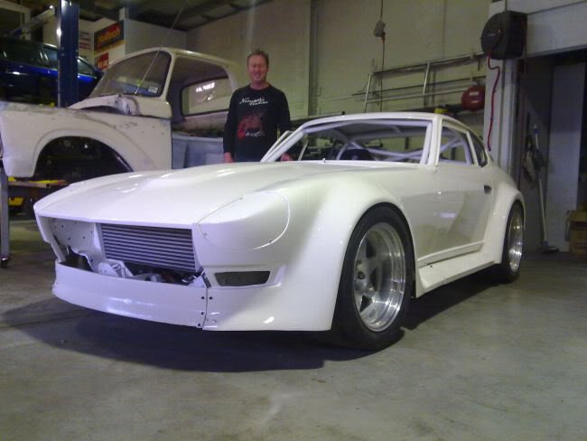

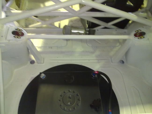

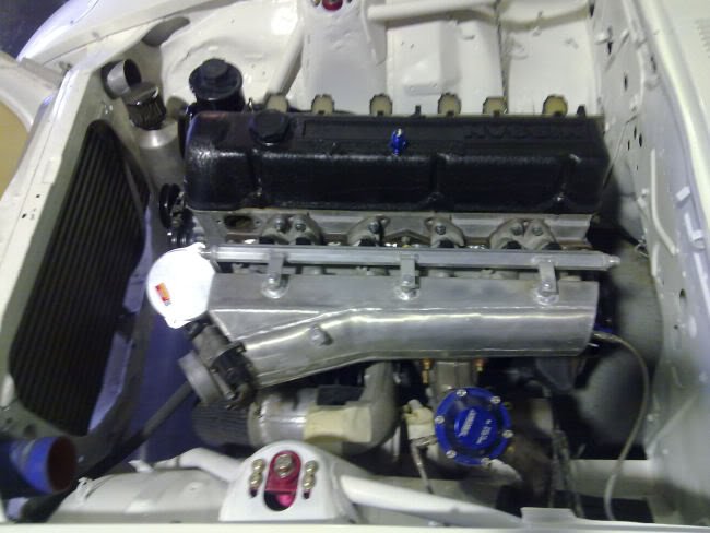

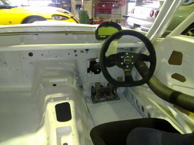

C.A.R. Posted September 26, 2010 Posted September 26, 2010 Peter bought his 260Z from forum member 'GV260' 8-9 years ago as a neat, stock street spec 260Z. But it didn't stay that way for very long... It started off with a warmish L26 with about 150hp which was 'OK' for a while. Then Peter got a bit excited – an FJ20et race engine with a T66 turbo (+nitrous) was fitted produce around 650hp at the tires, which eventually ran 9.9 @139MPH at Calder.. This had the effect of slightly modifying the chassis alignment – which can kinda happen with stock S30 shells... Next the circuit bug took over & Peter decided that the Zed was going to better suited to going round some of Australia best circuits as a proper race car. Cue a massive rebuild over the next few years, culminating in the beast you see here. Body: Off-White colour Heavily stripped & lightend RS30 shell. Comprehensive 4130 CroMo ROPS. Flare are MASSIVE AlfaFG units moulded to the body Front guards are FG FG ultra light doors (3.5kg) FG Bonnet FG Hatch (2.5kg) FG front splitter Suspension: AZC full track pack (refer to AZC website) Modified BMW 3Series Power steering rack. Brakes: Front: Wilwood Superlights 6-spot, 13” rotors Rear: Wilwood Superlight 6-spot, 12.5” rotors Diff: 2-way nismo Short-nose (GTR centre) GTR CroMo driveshafts Gearbox: R32 Skyling with Albins gearset & L-series bellhouseing AP twin plate on custom flywheel Engine: L28 block CR billit crank 86mm stroke Pauter Rods SPS pistons Head: N42 casting with extensive modifications to the chamber & ports. Cam: Special turbo grind Ex manfold: Custom steam pipe – extrudihoned Inlet manifold: Redline manifold with custom S.TB plenum Turbo: 700hp Borg Warner WG: 48mm external gate ECU: Haltech Platinum series RacePak data logging dash Wheels & tires: Custom built Harry Withham rims – 17x12” Tires: Dunlop slicks. Over to you Peter... Quote

Administrators gav240z Posted September 26, 2010 Administrators Posted September 26, 2010 This build looks incredible. I've seen some of the pics you have been uploading in the gallery and I knew it was going to be a detailed build. Lots of hard work I'm sure. How much power are you expecting to get out of the old L28? It's good to see you went the L28 route. We should definitely get the write up on the homepage once you get this thing fully assembled. Quote
peter mc Posted September 26, 2010 Posted September 26, 2010 hope the motor makes 350kw it will run on e85 it will run about 25 -30 psi in top gear. Quote
lightmaster240z Posted September 26, 2010 Posted September 26, 2010 The photo barley do the beast justest . I just lov this thing a cant wait to see you drive it around a track soon. Bruce Gordo 1 Quote

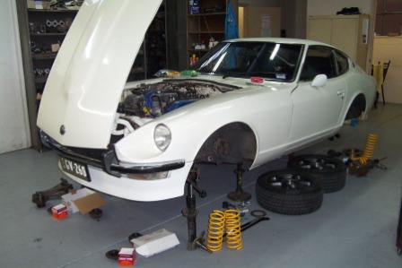

NZeder Posted September 29, 2010 Posted September 29, 2010 Hi Peter, So what spring rates are you going to run with your AZC coilover setup?? Those red items look the ones Dave sends with the kit = 250lb? or did you order with more lb/in? Cheers Mike Quote
peter mc Posted September 29, 2010 Posted September 29, 2010 hi nzeder the springs are 350lb i all so got 500lb to try not shore wot will work Quote
NZeder Posted September 29, 2010 Posted September 29, 2010 with slicks I think you will find the lighter springs will work better - well that is what I have seen on track cars here in NZ Quote
peter mc Posted September 29, 2010 Posted September 29, 2010 thanks i will try when i see the track .i run 250lb in the 240 we race with grate results .but we all so run one with big slicks that runs 750lb springs .it runs a v8 tho. we can only try. Quote
