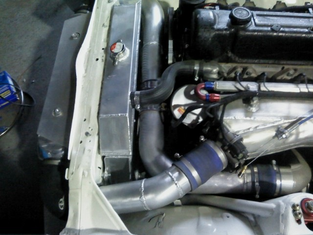

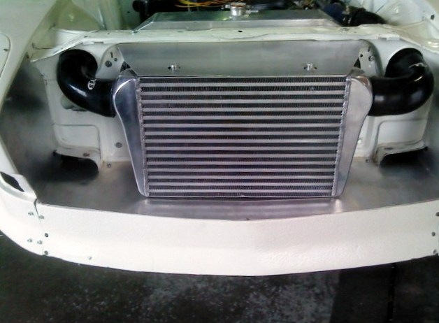

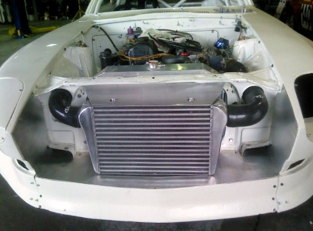

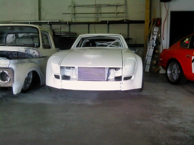

peter mc Posted December 12, 2010 Posted December 12, 2010 Soooo what did i do this weekend..... Well i was very busy trying to enclose the front intercooler and radiator area, also incorporated some break ducts into the front opening. I was also able to start making my intercooler pipes. Quote

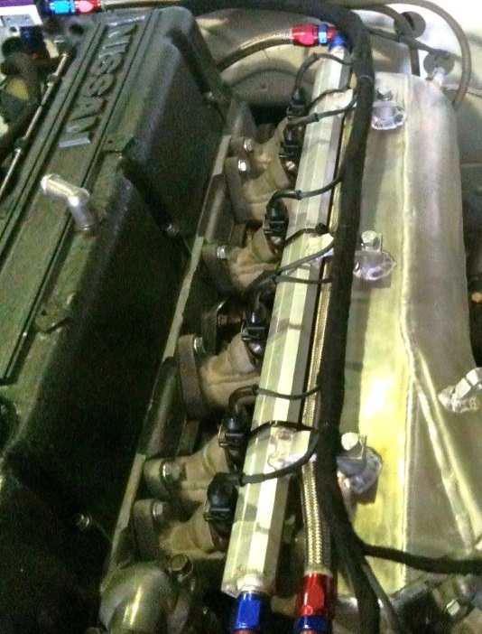

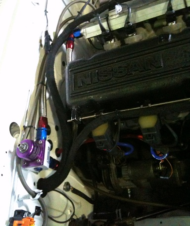

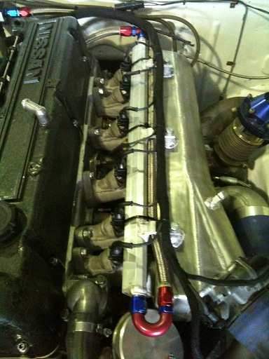

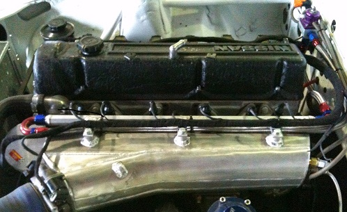

peter mc Posted January 4, 2011 Posted January 4, 2011 Hi All, Just thought i would do a bit of an update coz it has been a while...... Over the last 3 days i have nearly pulled all my hair out wiring the car, i was going to get my auto lec friend to do it but he was to busy so i had to nut it out myself..... Not really my forte but it is done now. Quote
NZeder Posted January 4, 2011 Posted January 4, 2011 Nice work on the wiring - I know what you mean - I have been working on mine over Xmas/New Years. Well done on the work - it takes time to get the wiring looking good. Quote
PeterAllen Posted January 4, 2011 Posted January 4, 2011 ...Well I was very busy trying to enclose the front intercooler and radiator area,.. Peter - Sorry I missed this post earlier but that is terrific how you have created that enclosure to prevent escaping cold air. Also, my panels forward of the radiator surround and the surround itself look like fried bacon, you've given me some ideas on how to kill two birds with one stone - thanks Quote
peter mc Posted January 4, 2011 Posted January 4, 2011 yer nice way to clean the area up and get the air to go ware i need it, the brake duct will work a treat . Quote
