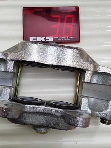

Administrators gav240z Posted May 11, 2017 Administrators Posted May 11, 2017 That's a vented type MK63-20S, with all hardware (pins, retaining clips and link cable) but no pads. Fosters!? Thanks but no thanks... So it looks like the MK63 caliper weighs the same as the stock twin pot? I would love for someone to weigh up the Toyota 4x4 S12 or S12W calipers. I suspect they are much heavier. I just recall driving a late 260z 2 seater with these brakes (S12s) fitted and you really feel that extra unsprung weight in the front wheels. PS: Can't believe he offered you Fosters, does anybody actually drink that stuff? Quote

Riceburner Posted May 11, 2017 Posted May 11, 2017 I've got the S12+8 calipers, they look very similar to the MK63. The 12+8's have different size pistons, I would think the weight will depend on the size of the pistons, bigger pistons will mean less material in the caliber body and then less weight overall. I can't see there being much more than a kilogram difference between each type. There will probably be a small weight difference between vented and no vented types too? Quote

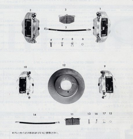

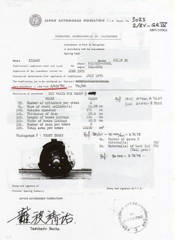

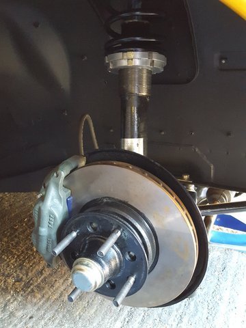

HS30-H Posted May 12, 2017 Posted May 12, 2017 (edited) Not sure if I've posted these before, but some reference to what the unvented and vented type MK63s look like: Original FIA 3023 homolgation papers addition for the vented type MK63 caliper and disc: NISMO catalogue page showing the parts: Vented type MK63-20S as mounted on my 432-R replica project car: I'm intrigued by the comments about weight of the MK63 vs the Toyota four-pistons. I think I'll put some new pads in these NOS MK63s and weigh them again to make sure, but I'm convinced the MK63s are lighter than the pair of Toyota calipers that are lurking in the back of the garage. Yes, the MK63s are cast iron, with steel pistons, and are heavy by comparison with modern calipers or pure race calipers (the Sumitomo MK63 was originally developed for the President limousine from a Girling patent!) but they are not that bad. As you can see, a vented type MK63 with no pads comes in on my scales at 3.8kg, so the pads will take it over 4kg. Let's see... Edited May 12, 2017 by HS30-H gav240z 1 Quote
