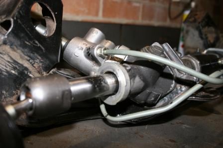

jamo240 Posted December 4, 2010 Posted December 4, 2010 Thanks very much Kato...that and the fluid lines between the pump and rack will see the install done. Cheers, Jamo Quote

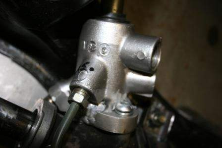

jamo240 Posted December 5, 2010 Posted December 5, 2010 Hey Kato Rob (Robco engineering) organised the welding via a local bloke...see pics below. I am happy with the work...the welds look good, and there is no distortion in the housing assembly, and it all went back together with no fuss. Just need the tie rods and rack to pump lines now. Cheers, Jamo Quote

KatoKid Posted December 5, 2010 Author Posted December 5, 2010 Looks good Jamo. I contemplated going this way but engineers get a bit funny when there is welding involved in steering components so decided modifying the crossmember is a going to attract less scrutiny at rego time. Is your rotary valve assembly alloy or steel? I know they have both and yours looks like alloy. Quote
jamo240 Posted December 5, 2010 Posted December 5, 2010 Thanks Kato...I agree that the engineers will get all excited about welded steering components, so probably best to modify the X-member, but provided it's done properly, it's no problem, and it fits a bit better in my view, with the valve re-indexed. My valve housing is aluminium....possibly a bit easier to weld than the cast iron ones. Cheers Jamo Quote

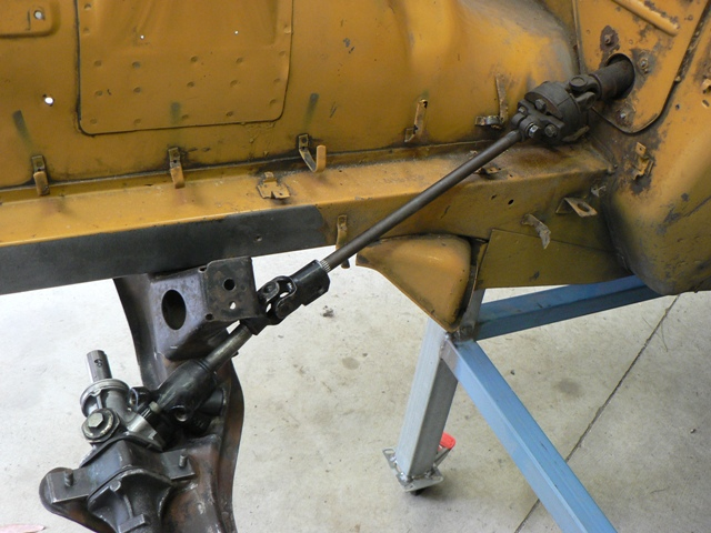

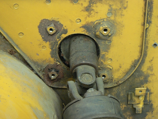

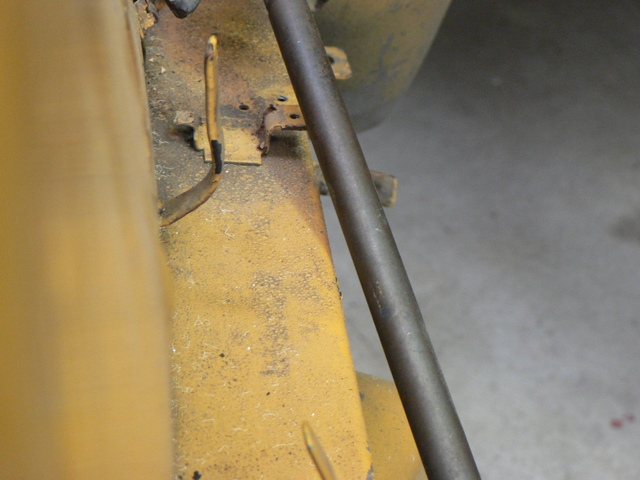

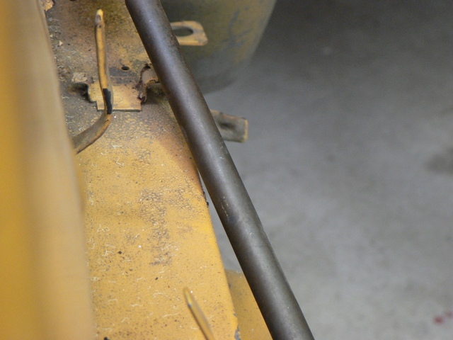

KatoKid Posted January 10, 2011 Author Posted January 10, 2011 Installed my resplined shaft between the column and the rack and it all works! As expected the shaft runs very close to the chassis rail and while you could "massage" the rail for more clerance Im going to move the base of the column by sloting the mounting holes on the plate that bolts it to the firewall. This is an old trick from the time whan I put an SBC in my LJ Torana and provides the necessary clearnce without the steering wheel relocation being really noticeable. Quote
620Z Posted January 10, 2011 Posted January 10, 2011 Very neat work there. I like the idea of moving the base of the stearing column. Bit easier doing this with no brake master cylinder or engine in there. I will have to wait and see how much clearance if any I have when my instalation gets under way. Mind you I might mover it anyway while I have the dash out at the same time. Hmmm........ maybe. Either way with the shaft over further will help with the clearance from my headers which are very close at the moment. Quote

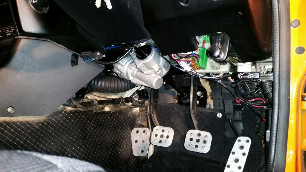

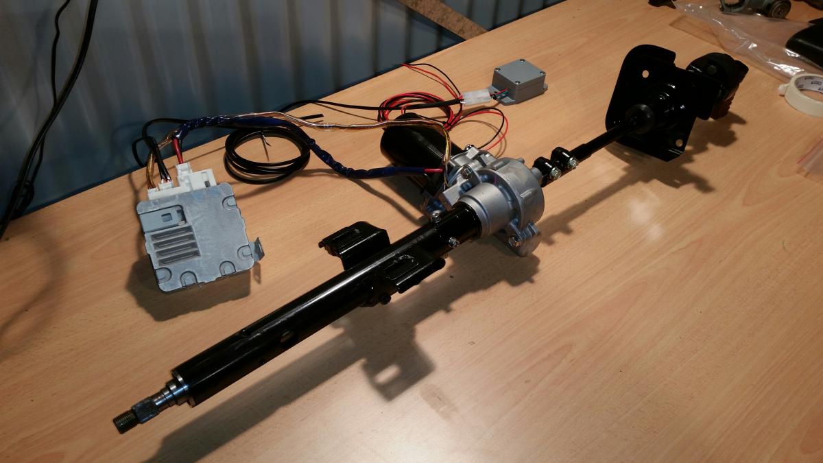

600Z Posted April 21, 2016 Posted April 21, 2016 (edited) Electric power assisted column is so much easier then hydraulic for many reasons. - No change in steering geometry. - No hydraulic pump needed for mounting and or chances of oil leaks. - If it was to fail it is only as heavy as stock steering. - Bolt in to all factory mountings, and wire up and your ready to go. - No power taken from engine for the running apart from very minimal from alternator. - Works without engine running as long as ignition is turned on to accessories. - Slightly adjustable in sensitivity. - For those who want to keep the car original no modifications needed and unless you look under the dash it can't be seen. I guess this is why so many of the car manufacturers have gone to electric power assisted units over hydraulic and why I have too. Just my two cents worth guys. Justin. Edited April 21, 2016 by 600Z GongZ 1 Quote

600Z Posted April 21, 2016 Posted April 21, 2016 Hello Gurbachen, The first one that I made was for my car and I'd hate to think if I had to add the cost of time in working out what parts and modifications I had to do along with getting the unit to operate electricity. One of my mates has just done Targa in his car with one of the columns in it and all went well and I have a couple more that I have to make up, one for my wife's 260Z and another for a 240Z for one of the guys on here. I have done a bit of a write up on the column somewhere in the form but in essence I will be making the up to sell from time to time though they are quite time consuming (not as much as the first one). The column is supplied with everything you need to install it apart from the main 50amp fuse as I'm sure people will like to choose that depending where they want to mount it. So it includes the following: - Converted electric power assist column (Exchange basis for your column) - All wiring supplied. - Weld NDT test certificate for the two welds that need to be done. This is needed if you want to have it legally passed and added as a conversion to be used on the street, otherwise as you know insurance's can be void. - Fitting instructions but you have to choose where you can mount the two control boxes. ( I have the main large one in behind where you would have a radio as I don't have one lol, the other small control box in the glove box but can be mounted anywhere.) Price I'm after for them is $1500 plus postage and your old column so I have one to replace it that I can convert. I certainly know it's changed how my car drives now, no more fighting with caster, wandering, etc. Now it's one hand driving and able to change gears mid corner if needed lol. Groundhog 1 Quote

600Z Posted September 2, 2017 Posted September 2, 2017 (edited) Hi Aircobra, Paul Henshaw has fitted one to his time attack race car though hasn't had a chance to get it out on the race track as yet. Another went into a mates targa car and it's done one targa series since with no issues at all. As for any other members having one, no there aren't any members here who have fitted one sorry. The unit is certainly not a generic one from either of those places or any other place, the main unit is from a particular vehicle just like theirs are but not from the same vehicle as theirs if that makes sense but from one that matches our zed columns very well and tucks up under the dash better then theirs. I made my original unit up as I didn't like the ones that are available and I didn't want to use hydraulic for several reasons plus I wanted mine to be street legal which it is. That's not to say you can't get the others passed you would just have to get the welds tested and submit all the information to vehicle modifications and then checked, just as you have to do with hydraulic conversions if you want it to be legal and be covered by your insurance. Cheers, Justin Edited September 3, 2017 by 600Z Quote
