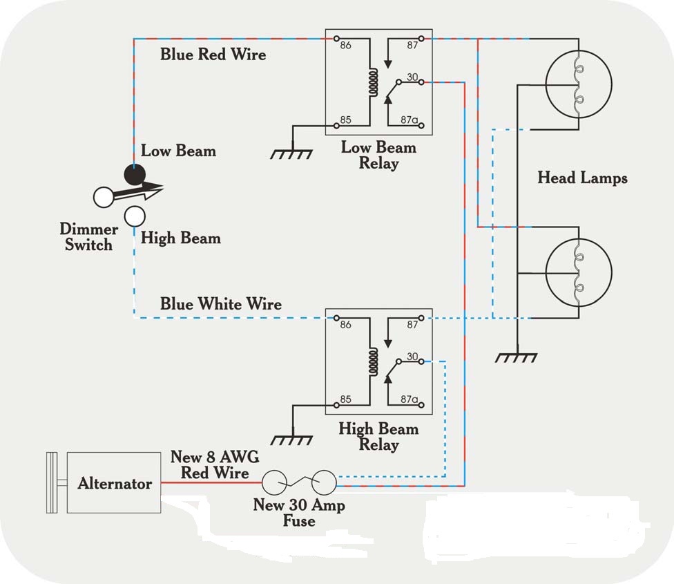

Stivva Posted December 14, 2011 Author Posted December 14, 2011 Yes I am! Keen eye you have there! I bought the spacers after I bolted the flares on so I was able to measure up a perfect fit. I have a bit of a problem with my headlights. Maybe somebody will be able to help me out here. My headlights suddenly stopped working. My dash and taillights work no problems, but nothing up front. I ran a bypass switch that allowed me to turn on the high beams so they are working up the front end (power and earth are making it to the beams. The bypass actually bypassed the indicator switch. So I bought a new indicator switch thinking that would solve the problem. No luck I am afraid. The new switch ha the same result; tail lights and dash lights but no headlights. However the new switch turned on the highbeams when then indicator stalk was toggled left or right to indicate (killing my indicators). Any ideas? Why has my headlight disappeared? And why would the new switch turn on the highbeams rather that the indicators? Quote

PZG302 Posted December 14, 2011 Posted December 14, 2011 If you are not running relays at your lights and have upgraded them to something that will put out decent light, eg a 100W high beam, you may have fried the new switch when you flicked on the high beams. The standard lights were only 55W high beam, giving you roughly 10amps through the circuit. The switch should cope with that. If you have upgraded lights to say 100W then the combined 200W will be putting about 20amps throughg the switch which it probably won't like. Especially with 40 year old wiring. On any old car I have owned, pre 2000, I generally upgrade the lighting circuit with relays so that the only current going through the switch is to flick the relays on and off. I also upgrade the wiring from battery, through relays and to the lights to handle whatever power I need, and have used multiple relays for switching depending on the lights. My old ZG fairlane had two relays to run the standard 4 light set up, though those lights were 90/140W low high beam and 100W aircraft landing lights, so on high beam a total of 480W with a current draw of 40amps, enough to fry most headlight circuits and require a alternator upgrade to keep up with them. The big advantage, I could see about 2km down the road when doing a late night/early morning brisbane Sydney run at a touch over the speed limit. Quote

PZG302 Posted December 14, 2011 Posted December 14, 2011 have you fitted relays for the light circuit? If not, chances are you will keep blowing the switch up, they don't like putting up with high current loads over a period of time. Quote

MaygZ Posted December 15, 2011 Posted December 15, 2011 I actually bought a set of those a few months back, but they didn't work on high beam, just low beam. I have not fitted a relay..... I would know the first thing about that OK, now I'll put myself out there to be burned: A relay is effectively a switch. You put it in your current light circuit but earth out the other side. That is to say you run power from your switch (unless our light switch is the earth??) and then earth the other side. Your light switch simply needs to complete a circuit through the relay. The relay has 4 pins. To the another pin you run a high power wire (direct battery feed if you like) and then the last pin supplies current to the lights in place of the original wire. You can run a larger wire here (4-5mm). In this way you original switch is only running a low current that then only operates another switch (relay) that then carries the higher current to your lights. Relays, like anything have their limit, but almost any that you buy at supercheap/autobarn/repco/Moorabbin Auto Spares will be fine for the amount of current you will be able to run. It's about the size of a matchbox and can be fitted in the beautiful engine bay you have of stuffed up under the dash out of sight. Up to you. There is a wiring diagram on the bottom of the relay itself to show you which pin does what. Considering the level of work you have done on the screamer so far, you will find a relay a piece of pi$$ Let the flaming begin!!!! Quote
wildy55 Posted December 15, 2011 Posted December 15, 2011 Nor did I but look on the net and they're explained easy. Basically you wire up the lights independently of the factory wiring. Then you use the relay as a switch to operate them via the car's normal light switch. It's like two circuits with the lights drawing off the new wiring and hence not burning out the original wires. Quote
Linton Posted December 15, 2011 Posted December 15, 2011 here you go, I should say the wire colours will be different Quote
MaygZ Posted December 15, 2011 Posted December 15, 2011 Good diagram. Just missing power to he switch. There you go Stivva. Easy done. MaygZ Quote
