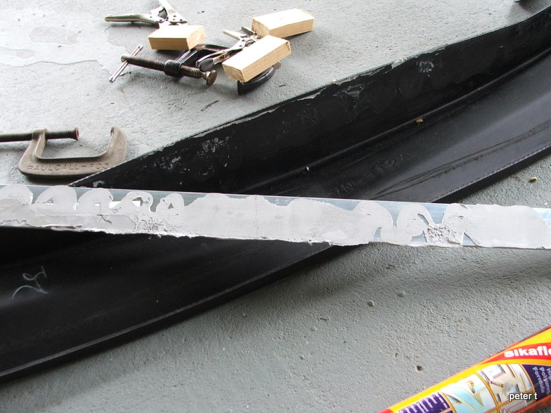

peter t Posted April 3, 2011 Author Posted April 3, 2011 What a bummer. Sikaflex didn't stick to the pu spoiler. I am off to the hardware to find something that will work. :'( Quote
RB30X Posted April 3, 2011 Posted April 3, 2011 Peter when I was fitting mine, I sat it upright on a piece of black 5mm Polyurethane sheet. I traced the shape of the base of the spoiler on the sheet then cut it out allowing about half a foot for the back of the lip. I flipped it upside down and screwed the sheet to the base of the spoiler letting a little bit protrude so it looked cool and a little bit racey. Then I painted the spoiler white and then installed the black sheet. This took all of the flex out. I basically copied a guy of HybridZ who did the same thing with a thin piece of aluminium. You can just see it here Quote

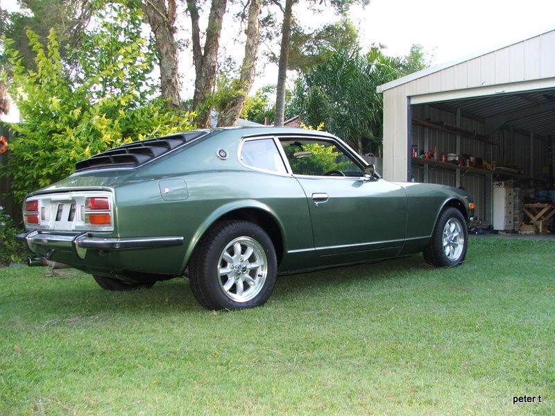

peter t Posted April 3, 2011 Author Posted April 3, 2011 Thanks Tim. Got some good glue from the hardware shop called fix all. Handy that the guy who works there is an ex panel beater. Thanks for all the help and a plus karma for you all. Sandblasted the foot rest, jack and some more small bits and got them painted today. Also fitted the speedo cable. Not sure what the blinds are for Dimitri, wont fit in the Z. Quote

peter t Posted April 9, 2011 Author Posted April 9, 2011 All is good. Passed with flying colours and nothing to do. Will be off to the Transport Dept as soon as I get home next week. Full insurance done through Shannons, only $330.00 for a year. ;D ;D ;D ;D ;D ;D ;D ;D Can you tell I am happy. Quote

peter t Posted April 17, 2011 Author Posted April 17, 2011 Good news, my wife walks with her friend of a morning and her husband is a old school mechanic and Barry came around fixed up the timing for me. we also synced the carbies and after a good clean and new plugs and points the Z is running beautiful. At first I fitted the electronic ignition {Crane} out of the parts car but could not get it to run but as Barry says just put a new set of points in every two years and it will be just as good. It is great to know an old mechanic that grew up with this sort of engine. Fitted the front spoiler and yet have to paint it but guess what, the wife reckons it looks great black. Just can't understand her sometimes. So next week it off to the MRD for rego now I have the roady and CTP and FCI. All that is left to do is get it back to UMR for a check over of the engine and a good wheel align then off we go. HAPPY EASTER EVERYONE AND DRIVE SAFE. Quote
