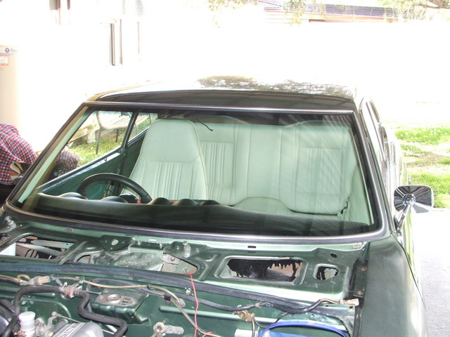

peter t Posted September 4, 2010 Author Posted September 4, 2010 $240 for a new screen fitted , why bother trying to do it yourself. $20 cash to put the rear back in and I got to drink a six pack without lifting a finger. Quote

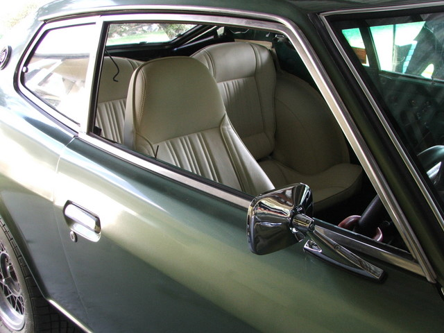

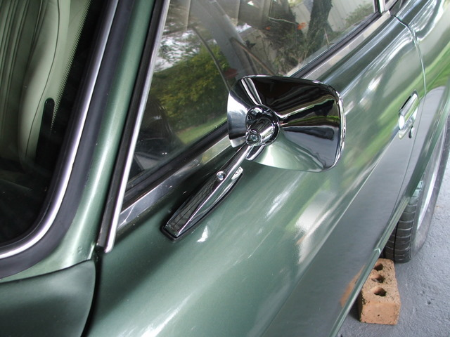

peter t Posted September 4, 2010 Author Posted September 4, 2010 Some more interior in today plus fitted the retro mirrors. Had the first drive today from the back pergola up to the shed. Wouldn't hold in gear so thought I would try the 280 spring loaded shifter and presto it worked. Now have to cut and weld it to the shape of the old one as you bust your knuckles on the dash trying to get it in 1 3 5 gear. Cleaned all the carpet out of the parts car as they are near new and retired to the fridge and the PC to post this. Quote

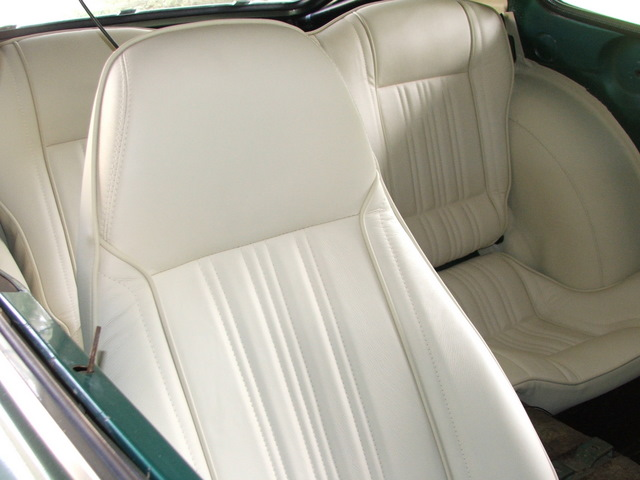

Bigfella Posted September 4, 2010 Posted September 4, 2010 more pics Peter I love that interior. I looked back on your posts but couldn't see who did it? Awesome Quote
peter t Posted September 4, 2010 Author Posted September 4, 2010 Interior is being done by Peter from All About Trimming at Slacks Creek. Top blokewith a name like that. Quote
garvice Posted September 4, 2010 Posted September 4, 2010 Leather? Vinyl? Price range or is it mates rates? Quote
peter t Posted September 5, 2010 Author Posted September 5, 2010 leather seats, the rest vinyl. $2250 the lot. Plastics covered in vinyl also. Quote
garvice Posted September 5, 2010 Posted September 5, 2010 Wow, that is a good price! Well done. Quote

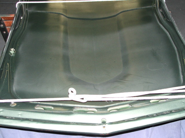

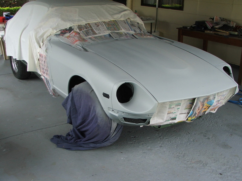

peter t Posted September 11, 2010 Author Posted September 11, 2010 Painted the underside of the bonnet today and will give it a bit of a polish tomorrow. Then I can fit it and paint the top side and guards again and hope the colour match is better. Next thing is to finish the interior then dismantle the parts car and start sellling the bits I Don't want. Quote

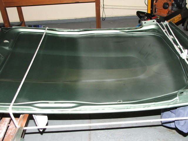

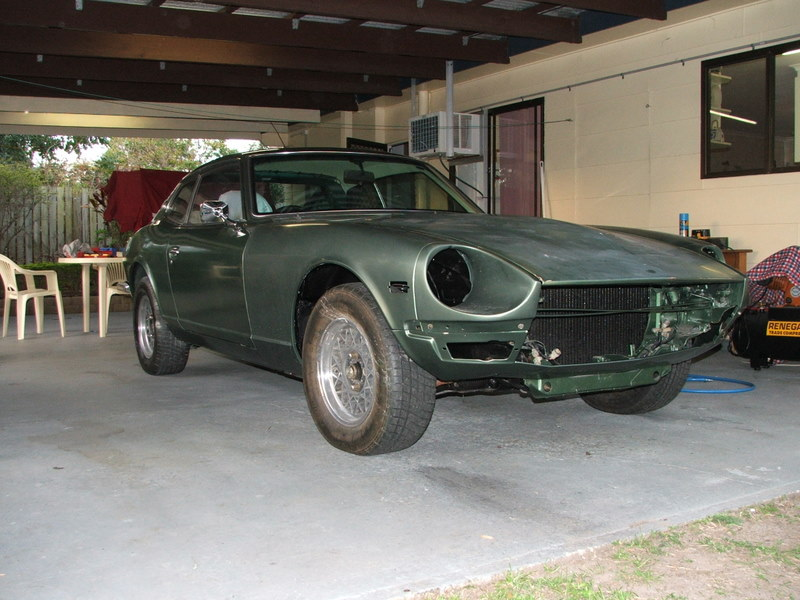

peter t Posted September 12, 2010 Author Posted September 12, 2010 Thanks Rev, Fitted the bonnet and other bits today ready for another attempt at matching the colour. I think I am getting to bottom of the tin and getting too much metal flake. Will get another litre and see if will match without too much stirring. In tin this paint is black but goes on green. I am really over painting metalic and will never do it again. Plain colour from now on. Quote

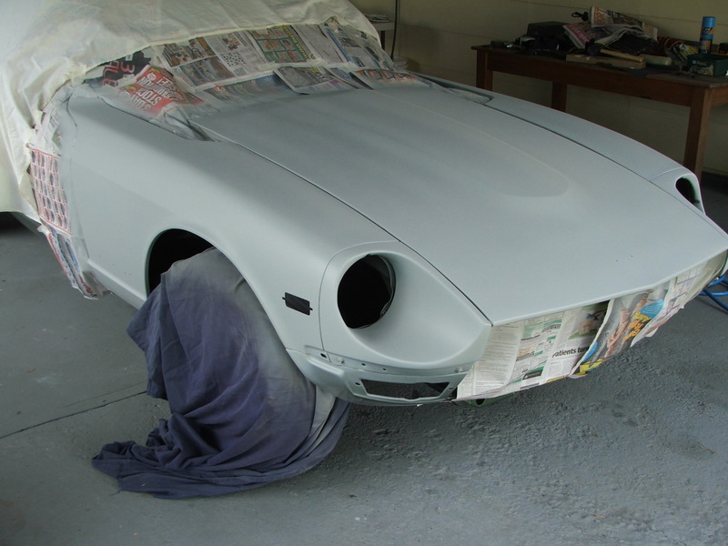

peter t Posted September 18, 2010 Author Posted September 18, 2010 Well it's Saturday and time to do some more work on the Z . The wife has gone to town to meet her sisters so I can play with the Z and get on the beer. I keep throwing the empties in the bin so she doesn't know how many I have had. So I rubbed the front half down again and laid a coat of under coat on. I will leave this to harden up and rub down next weekend and lay a coat of colour on and hope we will get a better match with the colour. I have a new batch of paint so I won't stir it too much and keep the fingers,toes and anything else crossed it will closely match the back half. If not, it will get a rub down and a coat of plain colour over the hole lot. Was going to order a heap of parts from TTT like Whittie has but not sure on the legalities of the parts in Qld for road use. Does anyone know if the parts would be ok here. The trimmer didn't turn up again to finish the interior but as I am paying him cash he must not be skint so why come. Not game to fit the parts myself as he has the tools to do it right and I don't want to stuff up his good work. Sold the wife's old car today and got cash so I told her I would invest the money for her. [Can now buy more bits for the Z] Time to go to the bin again and might spend the afternoon pulling bits off the parts car and tidy up the shed but I like looking out the kitchen window and seeing the Z parked there. Quote
RB30X Posted September 21, 2010 Posted September 21, 2010 I'm just going to throw it out there, but why don't you mix the can of paint thoroughly like you are supposed to, and repaint the whole car the same colour? Honestly, what are you chances of matching the existing new paint that came from the top of an unmixed or semi-mixed can, by taking more paint from a new can that you haven't mixed either? Sounds like a horror story. What happens when it comes out as a third colour. Save yourself some heartache and mix it up. Quote
reverendzed Posted September 21, 2010 Posted September 21, 2010 Pete, a light rub down, mask up and respray the whole car with 3 coats of color and 3 coats of clear with properly mixed metallic and good airflow will give you a great finish. A great paint job at this stage is only a day away! Rev. Quote
