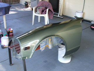

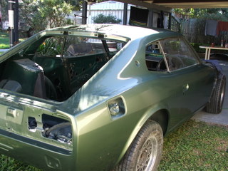

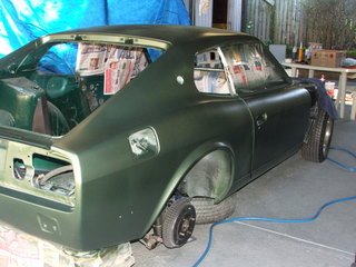

peter t Posted June 12, 2010 Author Posted June 12, 2010 Painted today. What a job I have given myself. :-\ Quote
C.A.R. Posted June 12, 2010 Posted June 12, 2010 Looking good. Are you going to colour sand it or just cut it? Quote
reverendzed Posted June 12, 2010 Posted June 12, 2010 Good Job Pete, have you put the clear over that yet? from the pics I'd say no, just remember to get the clear over that ASAP so that you don't get any marks on the paintwork. Rev. Quote
peter t Posted June 12, 2010 Author Posted June 12, 2010 Can't colour sand Lurch as it is metallic. Yes Rev I laid about 3 coats of clear on it after about 2 hours. Will give it a rub with 1200 and another 3 coats of clear than cut and polish. Pics were before clear. Quote

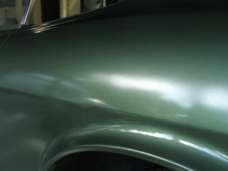

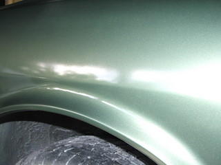

peter t Posted June 13, 2010 Author Posted June 13, 2010 What a day. Spent all morning rubbing back with 1200 then after a good wash down appliied about another 4 coats of clear. Looks like a army duck in the shade but when the sun hits it it really sparkles. Will leave it now untill next weekend then cut and polish. Its not perfect but I can live with it knowing I did it myself. Will look good with a set of nice shiny wheels and maybe a couple of silver stripes up and over the top. Next I have to paint all the rest of the bits like the guards etc. At least now I can get the hood lining in and start getting all the interior bits out of the house. That will make the other person that lives here very happy. [Wife] Quote

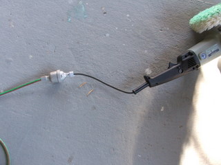

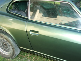

peter t Posted June 19, 2010 Author Posted June 19, 2010 Well I spent the morning painting at the daughter's place and come home and give the army duck a cut and polish. Shortened the polisher cord a bit when it got wraped around the head but finally got the job done. Not perfect but hell not a bad job considering this is only the second car I have painted. Metalic as well. It will do me. Everyone else can only get 10 feet close to it. It really sparkles in the sun as you can see. Now to clean out the inside and get the seats etc in. You never know I may yet get to finish by Christmas and go for a drive. Quote
Scoota G Posted June 19, 2010 Posted June 19, 2010 Ha, i did the same thing to my polisher cord two weeks ago. Felt like a real amatuer. Quote
peter t Posted June 25, 2010 Author Posted June 25, 2010 Jerk more like it. Had to get rid of all my electric garden tools for the same reason. Trim the shrub and finally ran out of cord. Easier to fill with petrol and pull the cord. Quote

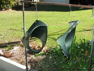

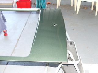

peter t Posted August 7, 2010 Author Posted August 7, 2010 Got the guards, buckets and rear hatch painted today. Should be on the road by Christmas if I am lucky. Quote

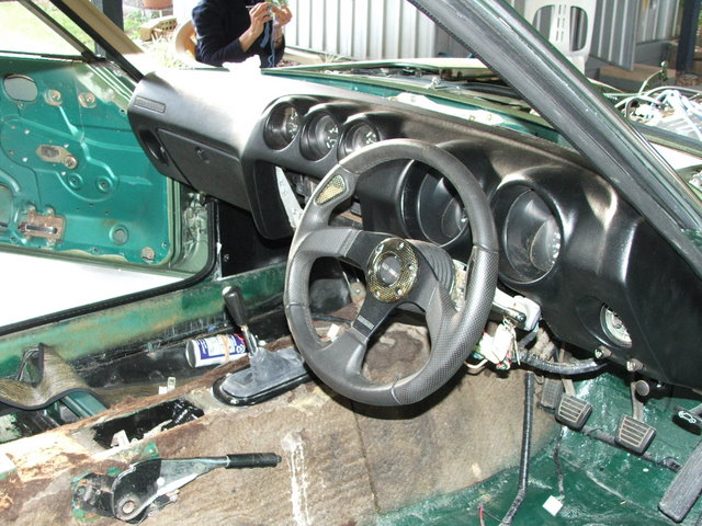

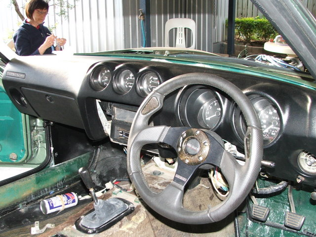

peter t Posted August 28, 2010 Author Posted August 28, 2010 Got most of the dash in today, Charging the battery so I can check the guages before fitting the centre of dash. Staqrting to come together at last. Quote
PeterAllen Posted August 28, 2010 Posted August 28, 2010 Peter - I like the image of Mrs T (?) knitting - reminds me of Madame Defarge. I can just imagine her yelling out to you, "Le guillotine, le guillotine" every time she spots an invoice for the restoration! Quote
peter t Posted August 28, 2010 Author Posted August 28, 2010 Holy crap, I didn't realise the cheese and kisses was in the pic. Now I am really in trouble. At least she comes in handy when I need a hand lifting things and holding things in place. She is a good TA. Quote

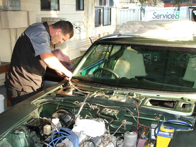

FuzzyDropbear Posted August 30, 2010 Posted August 30, 2010 Just had a quick search through the forum and found this thread http://www.viczcar.com/forum/index.php/topic,7088.0.html which covers it. Sikaflex or that double sided 3M tape sounds like the go Should look good with that colour. By the way, nice colour choice Quote
peter t Posted August 30, 2010 Author Posted August 30, 2010 Fuzzy you are a legend. I knew I read it some where and Rev came to mind but couldn't find it. IT is not my strong point so thanks for the help. Quote

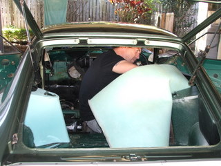

peter t Posted September 3, 2010 Author Posted September 3, 2010 Front and rear glass is in along with the dash. Just have to get the trimmer back to do the tunnel and install the panels and carpet. then seats in and off to get plates. Quote
RB30X Posted September 3, 2010 Posted September 3, 2010 Well done mate, feels good to do it yourself hey. Wouldn't feel good if you cracked it though. Quote
peter t Posted September 3, 2010 Author Posted September 3, 2010 Hey thats not me in the pic. I was behind the camera not in front. Pays to get the pro's to do some jobs. Quote
