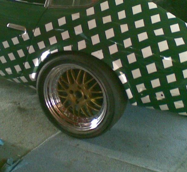

PZG302 Posted May 24, 2010 Posted May 24, 2010 Rev, a solution that may work for you to getthe wheels and tyres under the guards at the rear, works on my circuit racer with 8" wide rims, is to fit an eyebrow flare. The ones I use are cheap fibreglass ones from a suziki 4WD only about an 1" or so wide and are attached by some screws into the guards, for a neater job sikkaflex would work a treat. Quote

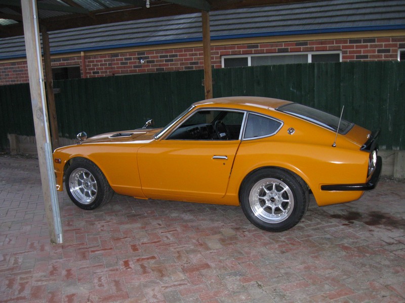

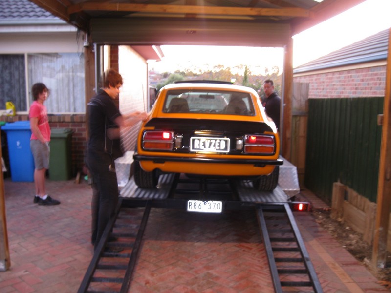

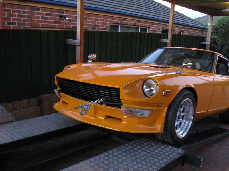

reverendzed Posted May 26, 2010 Author Posted May 26, 2010 Here we are I think this is the first full side profile pic! first time out of the garage that she went into looking very tired and...brown! 6 months later and she looks a little different. It's now on the trailer ready to get a few final things done before her debut! Rev. Quote
620Z Posted May 26, 2010 Posted May 26, 2010 Rev can I ask why the mirrors on the front guards? Or has this been covered earlier in this thread? Quote
620Z Posted May 26, 2010 Posted May 26, 2010 Ha Ha I thought there might have been a theme or something he was aiming for. I guess we all add our personal touch of individuality to our cars. Quote
luvemfast Posted May 26, 2010 Posted May 26, 2010 I guess we all add our personal touch of individuality to our cars. "YES WE'RE ALL INDIVIDUALS" "I'm not" Quote
RB30X Posted May 27, 2010 Posted May 27, 2010 Just needs some flares now.... LOL Heheheheee yeah that black rear lip needs some flares to go with it hey. That front on shot looks awesome. Quote
reverendzed Posted May 27, 2010 Author Posted May 27, 2010 Thanks for the comments guys. Craig, the mirrors on the fenders was to go for that 'JDM" style look, They're not as practical as door mirrors but I like the difference of them. I mounted the winch to a random piece I fond in my collection, I think it was someones home made attempt at a front bumper mount and it worked pretty well. It is now at Daniel Moore's for some final touches and hopefully ready by the 17th for the Jag club meet. Rev. Quote

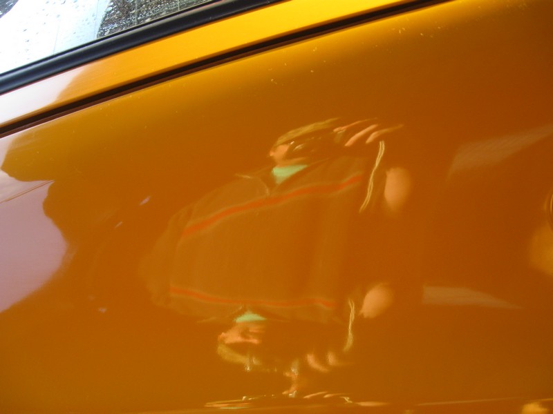

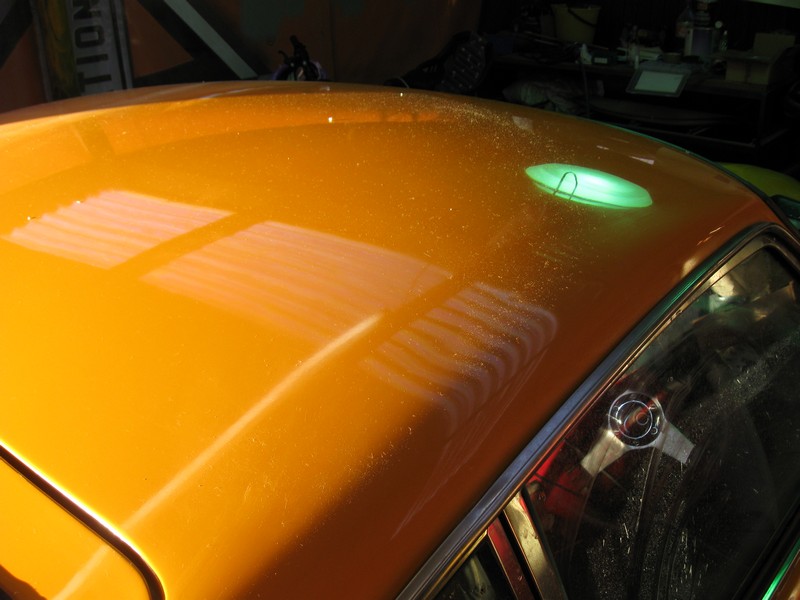

reverendzed Posted June 12, 2010 Author Posted June 12, 2010 A few hitches on my way to get RWC yesterday and ...no wipers! Thanks to Mayhem we got that sorted and too late to get RWC! Booked to go to Vic Roads on Tuesday but doubt if I'll make it now! The other thing is that the Carbs whilst fine at stationary rev, die under load, lots of coughing and backfiring...so I'll try to be there thursday night otherwise it may be there on a trailer! :'( Anyhow today I wet sanded and gave it the first cut, it cam up pretty good, next is a machine polish with a black foam and then ...maybe a hand polish, if I get time. It's nice to finally see a good reflection in the paintwork. Rev. Quote
