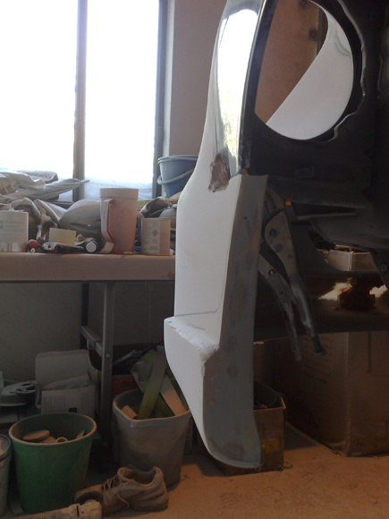

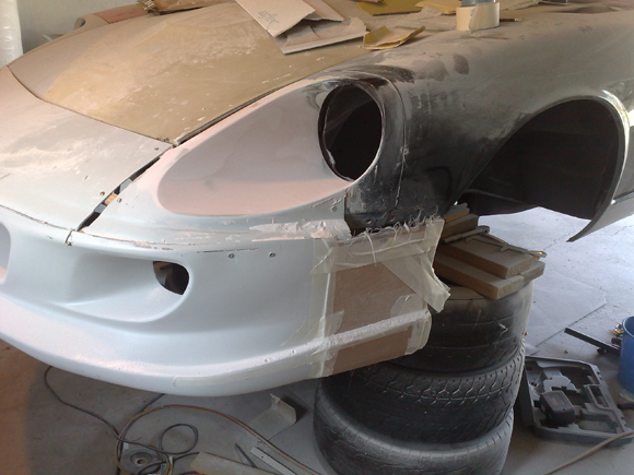

Sirpent Posted January 26, 2010 Author Posted January 26, 2010 Happy Au-"Z"-tralia day all........ I decided to dedicate half the day to the "Z" and the other half to the family, so a bit of progress, slow but sure, managed to fibro the LH Head lamp bucket in place, reshape the cone and fibro up the lower bar to wheel arch extension using some cardboard as a temp pattern to lay it all down on. Cheers John Quote

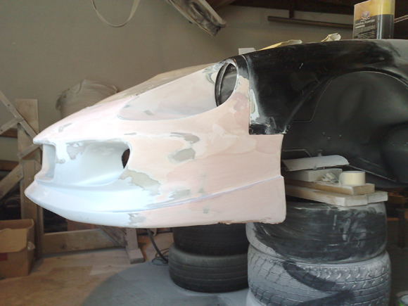

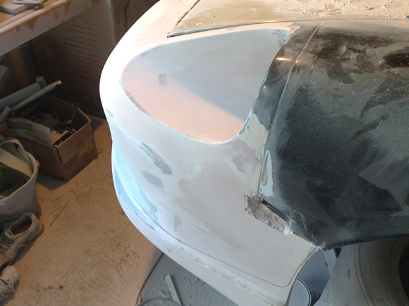

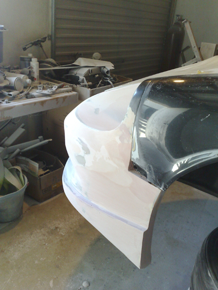

Sirpent Posted February 6, 2010 Author Posted February 6, 2010 Okay, The annual Sat arvo update for those following this build and the Hybrid G-Nose Im building, and also becuase Lurch and Mick felt I needed to do more Bog work on it .......... From the Baron of Bog for your viewing pleasure............... Quote

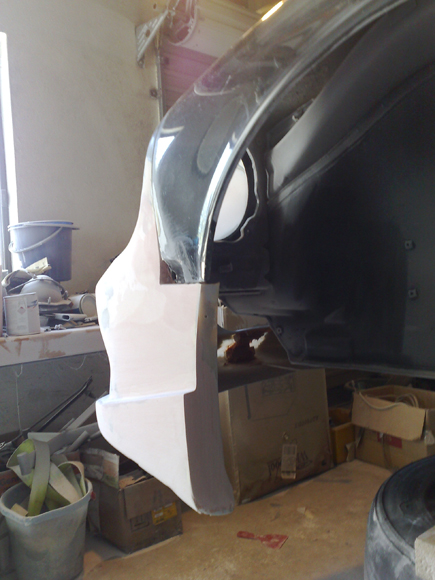

Sirpent Posted February 6, 2010 Author Posted February 6, 2010 As you will all note the bottom half extension to the guad is now all done, I have also hand drawn a line where the lower lip will raise to and which then curve and have the same lip as the fender. The lower edge of the bottom edge will be cut back for a straight finish front to rear towards the end of the bar build. Quote
Sirpent Posted February 6, 2010 Author Posted February 6, 2010 All in all everything blend and flows well, and Im happy with the overall profile as shown in the rear looking forward shot, I am still contenplating what to do with the bar cavity in the guard, more than likely I will be fabricating an in fill piece out of sheet metal so as it is a smooth guard / bar fit. Quote

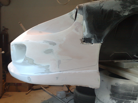

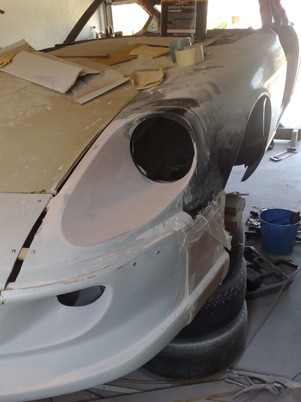

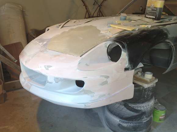

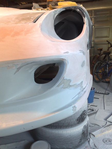

Sirpent Posted February 7, 2010 Author Posted February 7, 2010 Thanks Mick, MMMMMMMMMMMMMMMMm I see what you mean, but it's starting to take on a very shark look the more I eye it out. Just got in from the garage having finished the re-alignment of the lower lip and finishing up the headlamp bucket / air dam to guard alignment, the recess looks a lot smaller now and I have decided I will be smoothing the guard out to give it a flowing finish. Some pics (Sorry if this is becoming A.N.A.L. as far as the pics are concerned guys. Cheers John Quote
C.A.R. Posted February 7, 2010 Posted February 7, 2010 Needs more... Errr... Never mind Looks very shark like actually. Is it aesthetically pleasing to you at this stage mate? Quote
Sirpent Posted February 7, 2010 Author Posted February 7, 2010 Well........... I'll put it to you this way, every time I run my hands over the contours I get a twitch.........LOL No seriously, its like every one says, you have to see it in real life to appreciate the overall effect, but yes Im stoked at this stage, once I can get it in some EP primer, I think the camo effect of the body filler will give way to the contours and shades of the lines. As I said, sorry about all the pics. Cheers John Quote
Sirpent Posted February 9, 2010 Author Posted February 9, 2010 Hi all, Forgot to mention this in my last post.............. As you can all see there is a Shiester load of fibreglass and Bog / Bondo I am using on this prototype bar, went down to Super Cheap on the weekend to stock up on their 2kg Septone Body Filler at around $49.00 a tin, well their EFTPOS machine was out of action, so I stepped next door to Bunnings, in the house paint section I found what is labelled "Builders Bog" in a 4kg tin for $45.00, and while reading it realised it is actually made by K&H, the auto products group. Short story, its the same kit as the autofiller, and worked a treat, so save yourselves about 50% on your Bog needs and go for Builders Bog instead. Cheers John P.S. you can see the can in one of the pics above, it's the green can on the garage floor under the car. Quote
