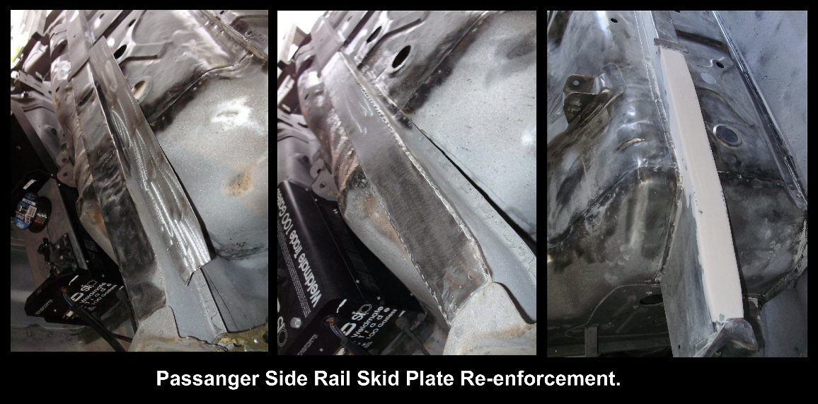

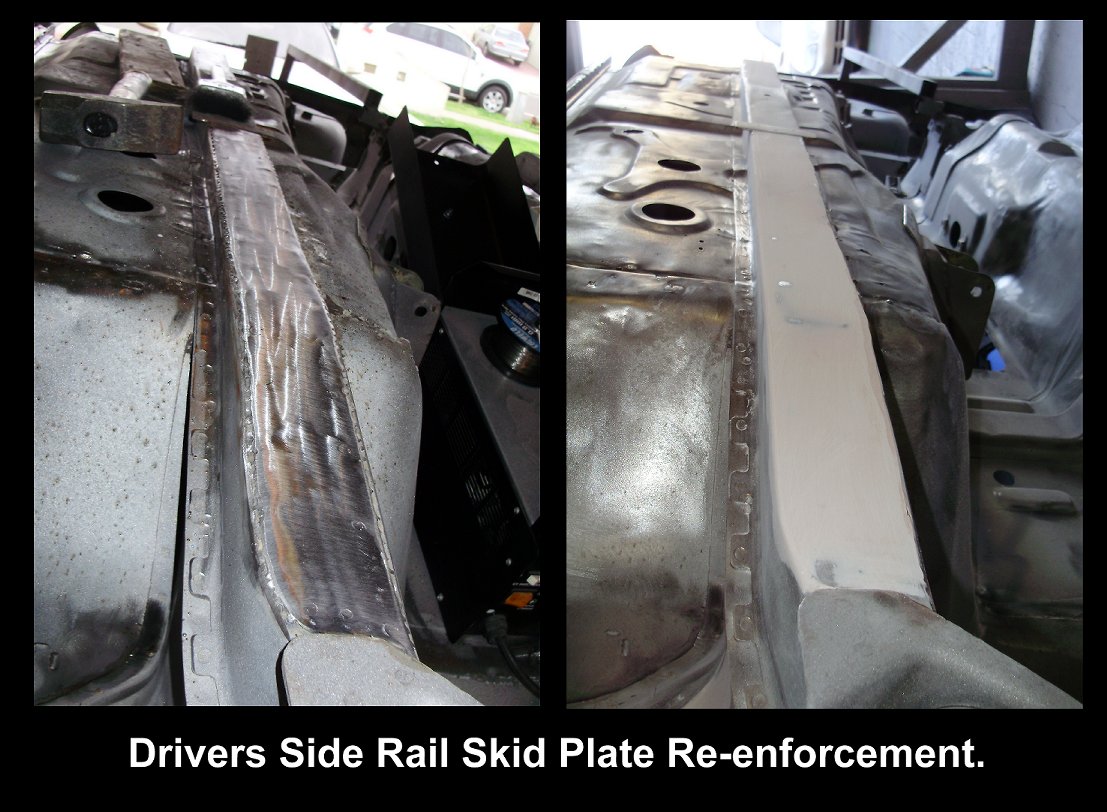

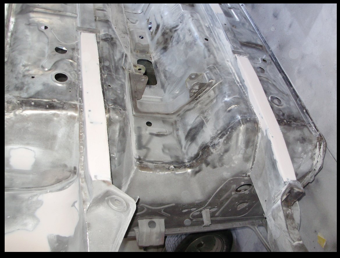

Sirpent Posted September 20, 2009 Author Posted September 20, 2009 Thanks Mick, But a long way to go, so I take it we are on for Tassie 2011 ? here are some pic's of the undercarriage work, all remaining OEM seam sealing now removed, pan totally wire brushed back, final fill work being done before re-seam sealing and final application of Plasti-Dip. Cheers John. Quote

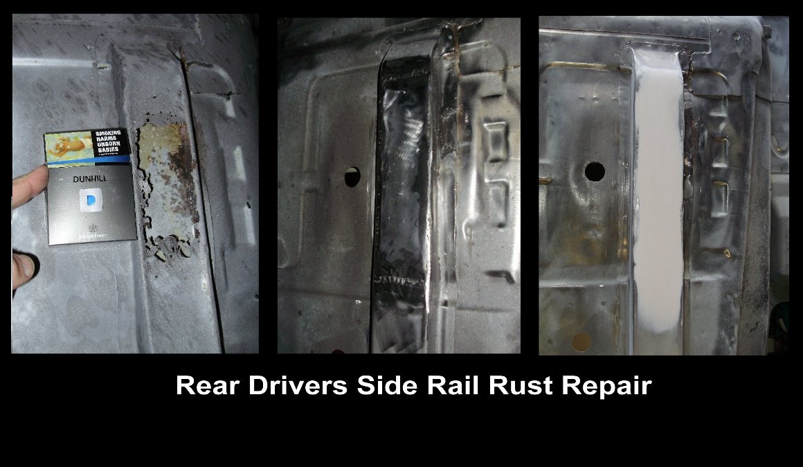

Sirpent Posted September 20, 2009 Author Posted September 20, 2009 Pic #4 Inner passanger skirt battery tray repairs and finishing Quote

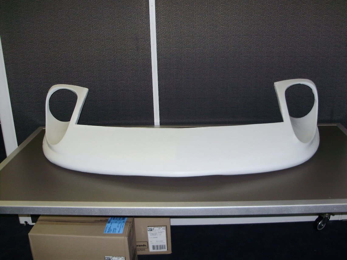

Sirpent Posted October 9, 2009 Author Posted October 9, 2009 Well, Just in case there are any doubting Susans out there, Fraser delivered the upper G-Nose section to my workplace today, (see pic) and look like we may come to an agreement for the eventual nose I build myslef to be reproduced by ALFA. Also, I am going to try and produce leses for the finished item which may also become available, watch this space over the coming months, yep sorry, need to get the guards backl on the car to start the nose build first. Cheers John Quote
