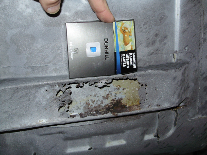

Sirpent Posted August 31, 2009 Author Posted August 31, 2009 Pic #5 Worst of the rust, actually about all there was apart from a couple of pin hole sized ones, this is on the rear end of the passenger side rail. Quote
C.A.R. Posted August 31, 2009 Posted August 31, 2009 If thats the worst of the rust, I'd be laughing! Quote
Sirpent Posted August 31, 2009 Author Posted August 31, 2009 Thats it Lurch, guess the 3 hail Mary's before he started blasting away must of helped. Quote
Moderators Zedman240® Posted August 31, 2009 Moderators Posted August 31, 2009 Is the battery area as good as it looks? or has it been repaired before? can't quite tell from that angle. looking real good there.. Quote
lightmaster240z Posted September 1, 2009 Posted September 1, 2009 looking good. Were you happy with the soda blasting being done on site? Was there much mess when he finshed the job ? By the way the rust inmy rail were far greater than that just ask Dr Z. Quote
garvice Posted September 1, 2009 Posted September 1, 2009 Pic #5 Worst of the rust, actually about all there was apart from a couple of pin hole sized ones, this is on the rear end of the passenger side rail. See, smoking even gives cars cancer. Looking good, does the soda blasting leave a layer on the car? It almost looks like it is primed in some of the photos. Quote
Sirpent Posted September 1, 2009 Author Posted September 1, 2009 Hey Guys, Thanks for the positive comments, feels good to get a reaction, its lonely at times working on a project by yourself and comments good bad or indifferent all have a positive effect by either re-enforcing what you are doing or making you re-examine the path you take before it's too late. looking good. Were you happy with the soda blasting being done on site? Was there much mess when he finshed the job ? By the way the rust in my rail were far greater than that just ask Dr Z. It was a combination of garnite and soda, basically the entire undercarriage, engine bay, inner area tail lamp panel inner skirts and tubs were done with garnite, then the 1/4's and roof where done with soda, the effect of the garnite leaves a surprisingly matt but minimal pitting effect, if you look at the left hand inner skirt you will notice what look like brown spots, this is where I used a scotchbrite wheel on a hand grinder to take off some material the blasting missed and they are actually very polished sections now but for some reason the reflection of the flash made them look brown. Through out the pics you will notice small dark specs, these are material residual the blasting missed however come off pretty easily with a bit of spot treatment with the scotch pad. All I will be doing is cleaning up these areas then I will use a surface cleaner like prepsol to desolve any soda film left, after that I will re-seal all the panel seams with urethane beads and then apply something I came across that I even suprised myself with "Plasti-Dip" Plasti Dip is the material you can buy in small quantities thats used to dip the handles of hand tools into to create a grip surface, great thing about it is it loves going straight onto bare metal, can be purchased in 10 litre cans and is sprayable, I intend sealing all the floor pan, inner skirts and tubs with it and the retailer reckons it will never chip, totally water proof the surface and soundproof the structure. With the soda blasted panels, you will see that the left hand rear 1/4 is a lot more reflective, the guy who did the blasting recommended I go over it with sandpaper before applying anything on it and using a prep wash also, I ran the "Scotch brite" pad over it also and the surface is incredibly smooth and reflective, the swirl marks are minute and a result of the rotary action of the machine. The rest of the car still has a soda film over it and I will leave it as is until Im ready to prep the panels for refinishing as it offers a degree of moisture resistance. As far as the mess, I ended up spending 2 days sweeping vacking and shoveling over 175 kg's of material that went through the blaster, if you attempt this try to do it outside. PPL will probably notice that the rear of the inside hatch area is still in the cars original duco green color, I decided to stop the blasting at the centre floor bulkhead juncture as the paint here is in great original condition and Im just going to prep it with a thinners and scotch brite wash then finish the area off with the rest of the interior panels in a black enamel. Is the battery area as good as it looks? or has it been repaired before? can't quite tell from that angle. looking real good there.. The battery area is as you see it, there are some small drill holes from drilling out the spot welds and some very minor rust pitting in the metal that I have to weld up, I saved the tray which is intact and in perfect condition, but as I said before the bay is going to be wireless, and the battery stored in the rear of the car out of site along with all the electrical components and fuse box then I will run looms through the sill panels up the insides of the hinge pillars and through the air galleries of the upper skirt re-enforcements to the the headlams and various connection points on the motor via the openings where the radiator plastic feed ducts were. Im not going to be using the side aircon dust any longer as Im installing a factory aircon set up I came across on here from one of the members. Hopefully I will have the 50 odd pics up on a web page I will post the link to in this thread, I took pics of every rust prone area on the car so as when its done the insurance company can appreciate its condition prior to restoration and also in case I ever go to sell it, which I doubt will happen while Im around. Quote
