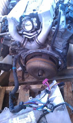

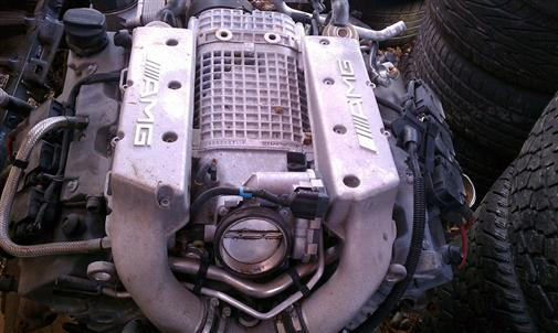

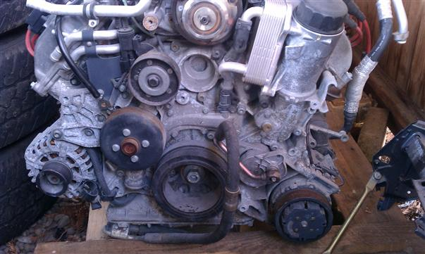

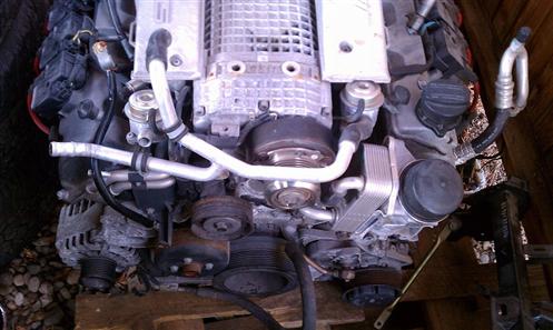

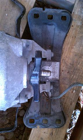

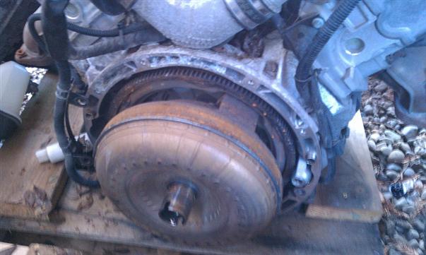

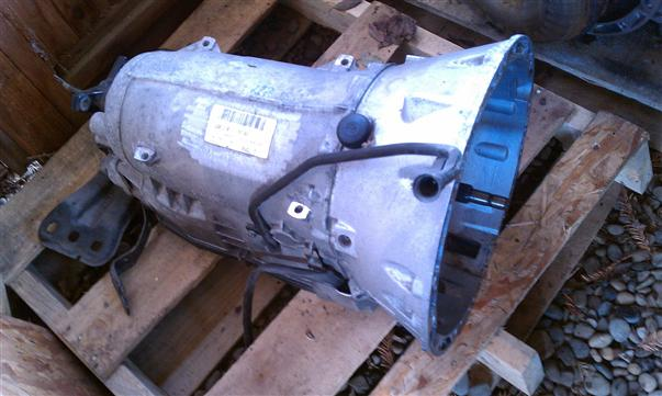

Sirpent Posted February 25, 2011 Author Posted February 25, 2011 Just recieved some pics of my "Actual" new toys pre cleaning and packaging, I have just included the main ones rather than all the looms etc etc etc. Cheers John Quote
KatoKid Posted February 25, 2011 Posted February 25, 2011 Very exciting John. Looks like you will have a similar issue as me.....all the aluminium parts on my engine were badly corroded from the salt they use on the roads. Is yours from up north were they get snow? Make sure you get the tailshaft. Accelerator pedal as I assume its fly by wire? Power steering lines, auto lines, shifter, all mounts, air inlet tubes and airbox. Even stuff you make think you may not use. Quote
benny Posted February 26, 2011 Posted February 26, 2011 Hey Kato, I recently had the same issue with an rb i had with corrosion. You can buy a product from autobarn could blitz alloy cleaner, works a treat!! Quote
Sirpent Posted February 26, 2011 Author Posted February 26, 2011 Very exciting John. Looks like you will have a similar issue as me.....all the aluminium parts on my engine were badly corroded from the salt they use on the roads. Is yours from up north were they get snow? Make sure you get the tailshaft. Accelerator pedal as I assume its fly by wire? Power steering lines, auto lines, shifter, all mounts, air inlet tubes and airbox. Even stuff you make think you may not use. Hi David, yep good advice. There are a whole lot of items you mentioned that are included but I didn't upload, and he has told me that he will pack up anything left that he wont need as a bonus. Yep the car is from washington State upper west coast of the USA bordering on Canada, I will probably do a minor strip of the motor anyway, and then send the parts off to get soda blasted as I did with my Weber's, As far as the condition of the units I'm happy, these are as they were taken out of the car, so no apparent oil leaks and from what I can see no accident damage indicated on any of the components. See what I meant by the size of the trans David, for a 5 speed it miniature. Hey Kato, I recently had the same issue with an rb i had with corrosion. You can buy a product from autobarn could blitz alloy cleaner, works a treat!! Benny You have to be careful with some solutions as they are meant for truck washing and can have an acidic effect on non alloy parts, thats why I will strip and soda blast items once they have been stripped to the core. Quote
KatoKid Posted February 26, 2011 Posted February 26, 2011 Thanks Benny but Im going to do same as John and strip all the aluminium bits off and have them blasted. Need to give it a good clean and paint, new front and rear crank seals etc anyway. Quote
RB30X Posted February 26, 2011 Posted February 26, 2011 You can't blast some things though like alternators if you want to use them again without rebuilding. Brush on some truck wash and let it sit for a few minutes then hose off. This will remove any engine grime. That alloy cleaner as mentioned above is an aluminium de-oxidiser which removes that yuk coating on the ally parts. Brush that on everything a few times and hose off and that motor will be looking as sexy as it will sound. I did the above on my old dirty motor when I first got it. Quote
Sirpent Posted February 26, 2011 Author Posted February 26, 2011 I understand, And thats what I meant when i said strip down to the core in instances like the alternator. Considering the time frame the alt for instance has been sitting around and also the fact that the body has been effected from salt spray I'd be better off having the thing checked and if need be overhauled. Anyhow, its all speculation until I see it in real life. Cheers John Quote
