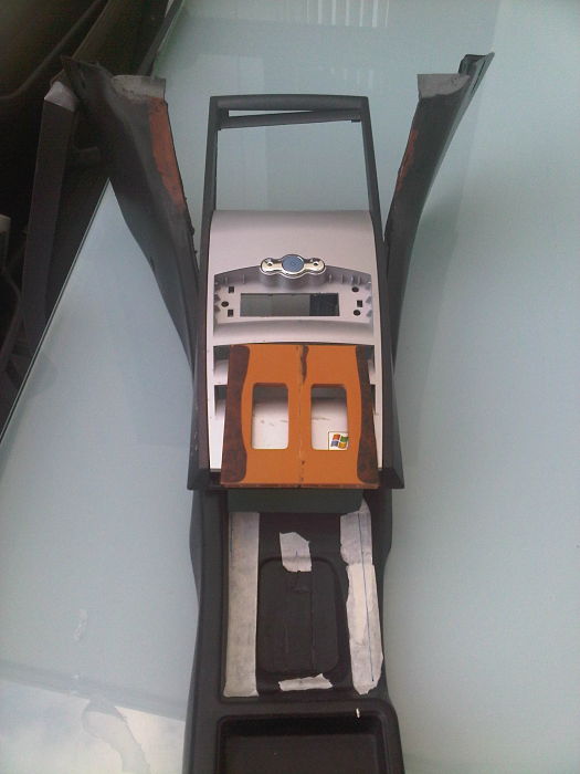

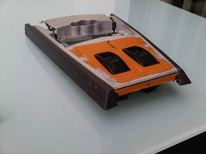

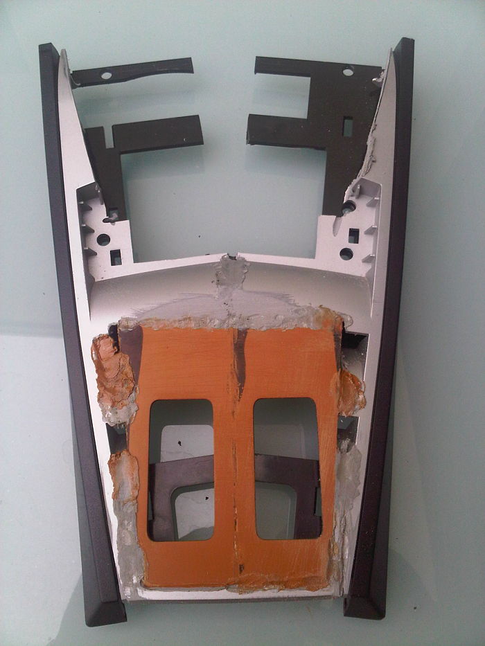

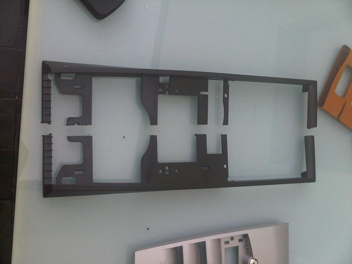

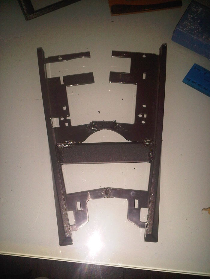

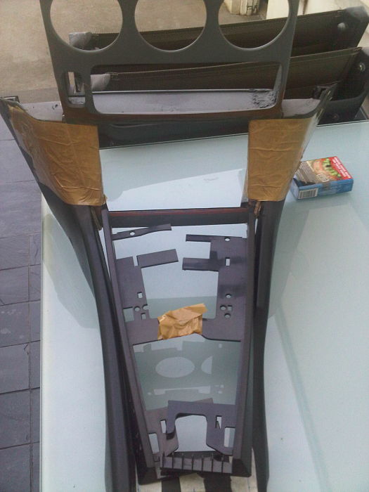

Sirpent Posted May 1, 2011 Author Posted May 1, 2011 Started looking around at what I could use and modify to produce the centre console fascia......... The wonderful thing is that so many items today are mode from plastic and if you look carefully enough you re bound to come across something that has the intricate well fitting forms you need, in my case I needed something to fabricate the fascia from and also something that would act as the bed in which it sits, low and behold, I came across an old Compaq PC case I was going to turf and the front fascia gave me some idea's, the following is what transpired. As soon as I get the gear shift bezel I will be able to lock up the front surface and fabricate a support panel to mold into the new fascia. Cheers John Quote

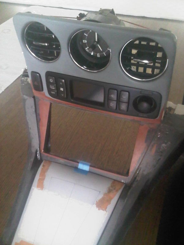

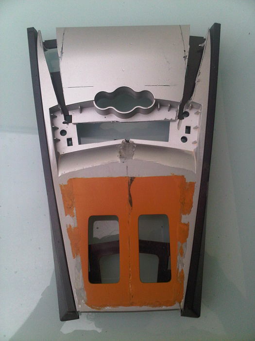

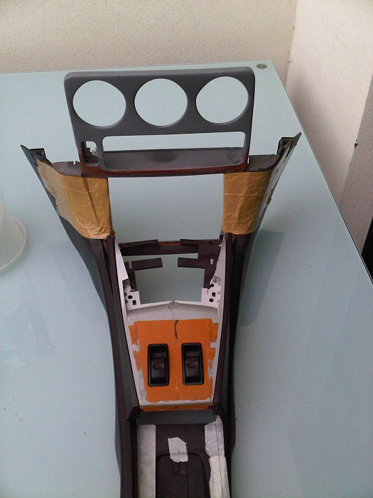

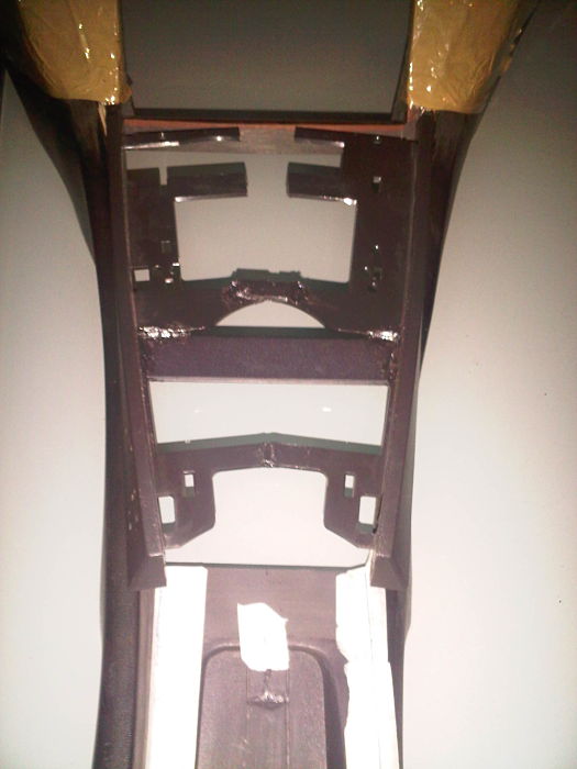

Sirpent Posted May 2, 2011 Author Posted May 2, 2011 Centre Console Gear Shift Fascia now almost done, obviously an access point will have to be cut out for mounting of the gear shift bezel etc. That will the determine where the reinforcements will go on the underside, next is to set the surround of the fascia in black into the centre console and weld that into position. Cheers John Quote

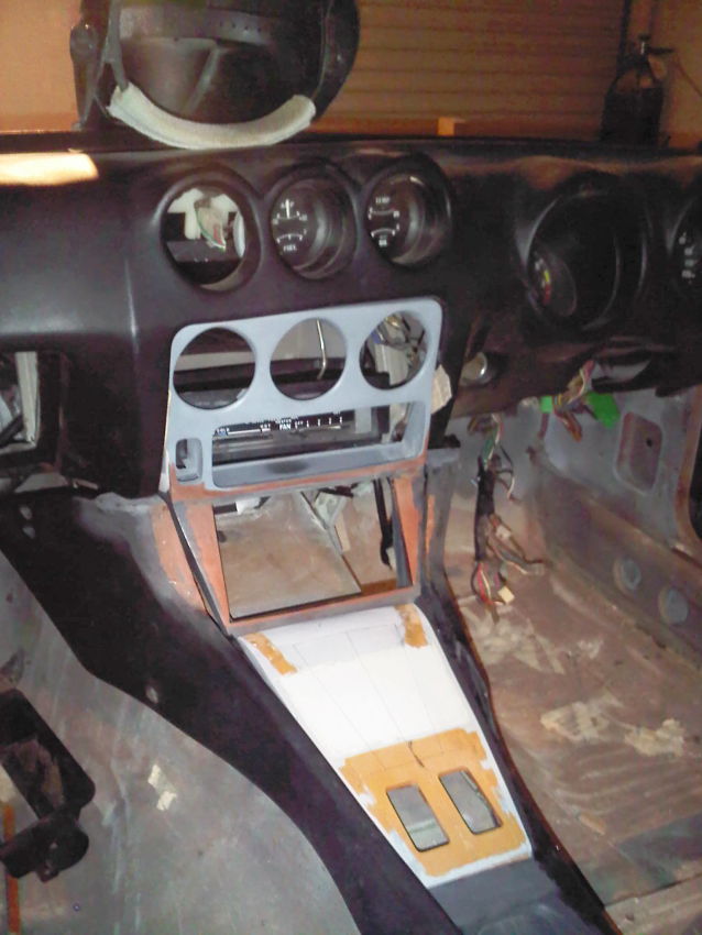

Sirpent Posted May 2, 2011 Author Posted May 2, 2011 First trial fit of the 3 pieces together in the car, some tweaking to do but overall alignments are good Cheers John Quote

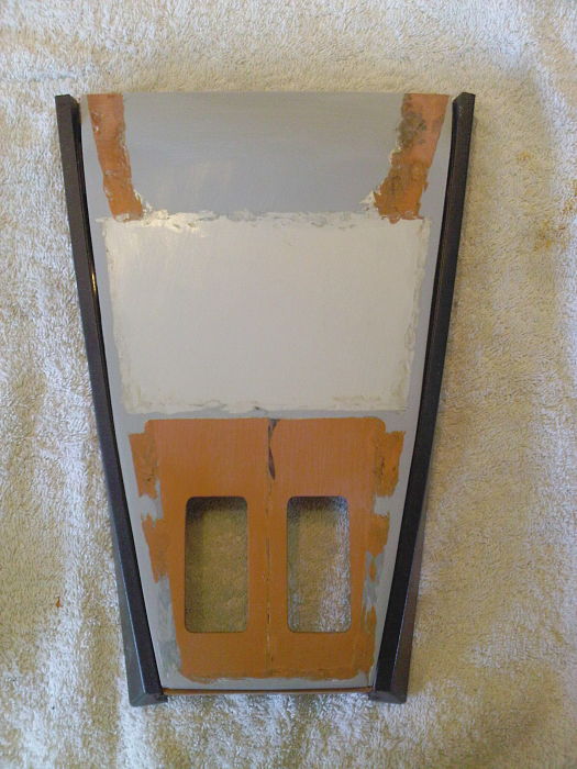

Sirpent Posted May 6, 2011 Author Posted May 6, 2011 Into the home straight now, matching and refining alignments, doesn't look like much but a SH*T load has been going on as far as bringing all these components together. Cheers John Quote

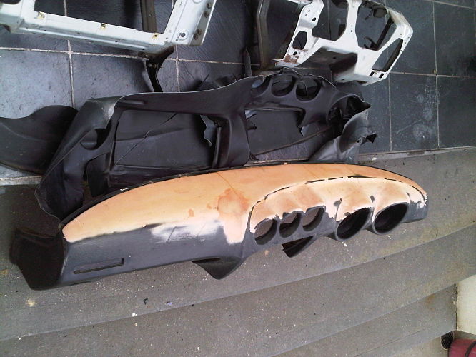

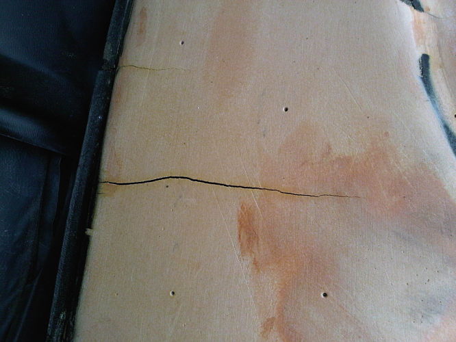

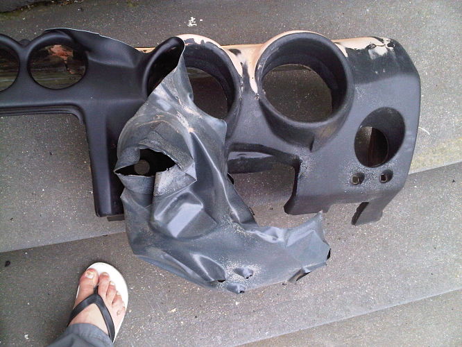

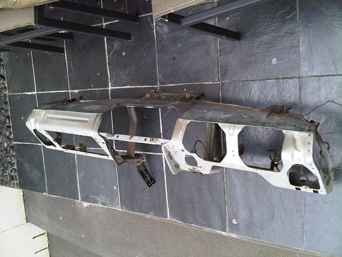

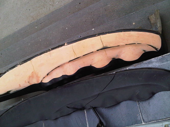

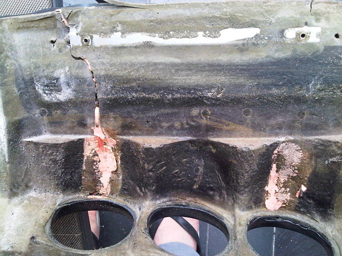

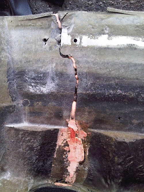

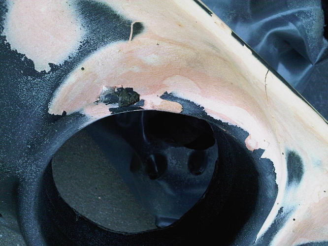

Sirpent Posted May 16, 2011 Author Posted May 16, 2011 Wasn't sure whether to call this post "Because I care I share" or "Well may you say God save the Queen because nothing will save your dash" Anyhow pictures paint a 1000 words and I'm sure these will interest some, this is my dash, which looked nice in previous candid post pics and anyone would have been pretty happy with it in their car, however I needed to do some mods to it and intend to have it eventually re-trimmed in "Alcantara Suede" so it was time to peel back the years so to say. This dash was reconditioned by the Dashboard Doctor in 1992, in 1994 it went into storage, do the sums, 2 years in an every day driver and then 16 years in an underground car park, didn't move an inch nor get any direct sunlight. Now I'm not having a go at the good Doctor, in 1992 they were the best at what they do and I was very happy with what they sent me back, no complaints, and materials may have changed since then so I'm not even sure if this is the standard any longer as far as repairs, but in case it is, and you have had a dash done this way, this is what you may be expecting in the coming years. Structurally the pad is in bad shape as a candidate for even a trim in Alcantara, and I will need to fix it so that it has longevity, this time I will be doing the repairs myself and am currently looking at different materials and techniques as to how to do it, what I'm hoping to end up doing is coming up with a DIY solution rather than just using fillers. So just thought I would share. Cheers John Quote
salty Posted May 16, 2011 Posted May 16, 2011 Johnno, that looks to be "bog"? and the black "cover" you peeled off is what? leather, vynil, plastic? Quote
Sirpent Posted May 16, 2011 Author Posted May 16, 2011 Johnno, that looks to be "bog"? and the black "cover" you peeled off is what? leather, vinyl, plastic? Buy the man a cigar ! Yep bog it is, and then they vacuum form a new skin over the top using a sheet of vinyl, that's the actual process, there is no adhesive in between new and old surface, just the vacuum shrink effect so peeling it off is pretty simple. Quote
salty Posted May 16, 2011 Posted May 16, 2011 so, where is the top vac formed to?just the top section or all of the dash? Quote
RBZ 260 Posted May 18, 2011 Posted May 18, 2011 believe it or not they still use the same technique John. Well the guys here anyway. What i did with mine is gauged the cracks lot wider till healthy looking sponge/space invider style foam is reached. Than filled it with u guess it with expanding foam. Sanded it into shape. than fiber-glassed the top half. sanded, filled as u will a car body. painted it two pack primer. it all worked fine but it did have one flaw. with large gaps i suggest u insert a 3-6mm rods or wide mesh inserted as deep as possible into the original foam. this should stop the separation between old and new and keep it in shape. alternatively make a fiberglass mould of a good dash. than no issues of cracking or getting out of shape. sorry if none of that made any sense. got a bit of a headache Quote
