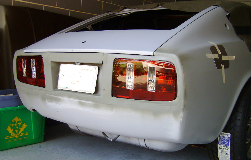

benny Posted July 13, 2011 Posted July 13, 2011 Hey Sirpent, A guy in the US has just grafted in the lights you wanted- http://forums.hybridz.org/index.php/topic/101082-a-forcesbeyondcontrol-78-280z-v8/ Ben Quote
Sirpent Posted July 13, 2011 Author Posted July 13, 2011 Hey Benny Yeah saw this before and dont really like the exicution, by blanking out the entire rear and then sitting them on top it looks very bland, I was thinking of building mine into the original garnishes so as when they are bolted in the rear retains that lip line like the original Zed does. But hats off to him for trying it nevertheless, just not how I might/will do it. Cheers John Quote
NZeder Posted July 13, 2011 Posted July 13, 2011 Nice find Benny, this does show you how the size of these lights look on the S30 even if not mounted/installed in the method you are thinking of. Anyway I have attached a smaller picture of the setup (I have asked permission to do this and if he denies this I will remove this attachment) Quote
Sirpent Posted July 13, 2011 Author Posted July 13, 2011 Hey Thanks Mike I think you can see what I mean now about the loss of the lip effect and how they seem to get lost in the process, however the overall fit looks good and Im pretty sure that by retaining the hosuings and then using a contrating clolos to the body work for the entire rear garnish they will look pretty contemporary with the rear looks of the car. Cheers John Quote

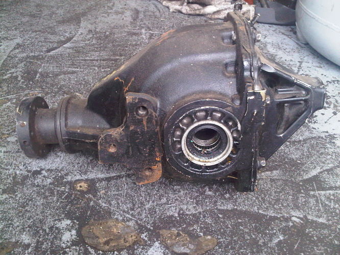

Sirpent Posted July 20, 2011 Author Posted July 20, 2011 AT LAST It's official, motor should be here at Melbourne Docks on Friday 17th of August !!!!!!!!!!!!!!!!!! To celebrate I went out and purchased a diff today, I decided after much thought surfing and consolation, (Thanks Peter Mc and Peter Allan) that I will be installing an M86 LSD diff used in the BF XR6 Turbo's and picked up this 30,00K diff, ratio is 3.46:1 So this weekend I have some reason to get to work on designing and mocking up a new cradle assy which will support the diff and firm up the rear suspension, I chose this over the commodore equivalent due to the mounting arrangement. Cheers John Quote
KatoKid Posted July 20, 2011 Posted July 20, 2011 Hey, good news John! Diff mounting shouldn't be too hard but the two Peter's have probably mentioned the importance of driveline alignment which is somewhat dictated by your tailshaft or more to the point the type of joints. Did you get the MB tailshaft? Assume it will be rubber guibo at the front and CV at the rear? If yes you will need to juggle crank centreline and pinion nose so they are aligned as the rubber guibo wont tolerate even a small amount of deflection. I think most T56 are rubber guibo at the output? Quote
Sirpent Posted July 20, 2011 Author Posted July 20, 2011 David, All correct, and I realise that, so will have to look at the alignment strategies that a Falcon or Commodore use and then decide what goes between the box and diff, at this stage I just want to mock up a prelim cradle to see overall fit then fine tune a final version once the motor and box are available for trial fitting, all in all I think the package should work nicely though. Quote
