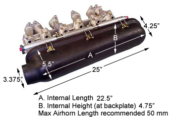

Scottz Posted November 12, 2010 Posted November 12, 2010 Anyone using one of these? (Top-End Performace - website pics). {My first attempt at attaching a pic - hope it works :-\}. Quote
Riceburner Posted November 12, 2010 Posted November 12, 2010 I actually got one of those and the fibreglass was so terrible I didn't even use it, also it will only clear the strut tower if you run a shorter intake manifold such as Mikuni. Quote

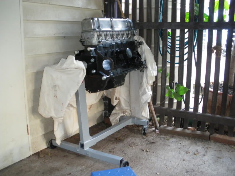

stevo_gj Posted November 12, 2010 Author Posted November 12, 2010 Well had a successful day borrowing a winch and bunch of gear from Greg that resulted in me getting the engine up on my stand. Thanks Greg, hope your knee operation heals quickly so you can get back on the road again soon! Quote

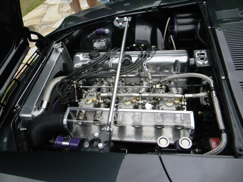

sexual_sushi Posted November 15, 2010 Posted November 15, 2010 I posted this on Rev's thread a couple of months back, looks slick and has the best of both worlds! Quote
stevo_gj Posted November 16, 2010 Author Posted November 16, 2010 I don't suppose you have more details of that engine? I'm assuming it's a custom part, but if by some small miracle they purchased it from somewhere I would be all over that. Quote
kobes Posted November 16, 2010 Posted November 16, 2010 Possibly I am missing a step in the logic, but i presume there is a filter somewhere in the air intake? or a pod filter at the end of the air intake? otherwise i would presume containment's could still be introduced into the box? Do not suppose you know what setup was being run on the other end of the air pickup? Quote
stevo_gj Posted November 16, 2010 Author Posted November 16, 2010 Pretty sure there is a pod filter at the end of the hose leading into that intake. Quote

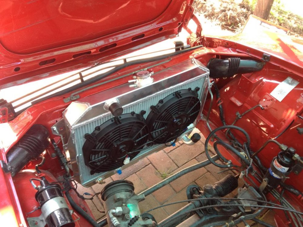

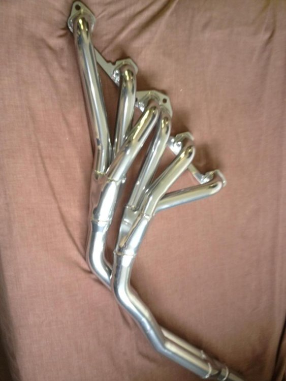

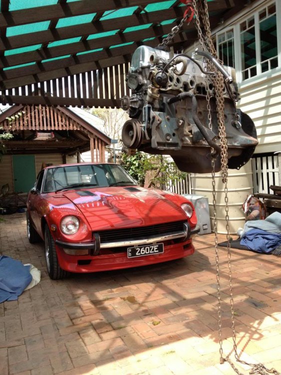

stevo_gj Posted December 23, 2012 Author Posted December 23, 2012 Hey guys! Well the work has begun on the motor, I pulled it out and sent it off to be rebuilt a couple months ago. I should be getting it back in early Jan. Unfortunately I could not install the 240z pistons due to my cylinders being slightly too large from wear. So brand new flat top aftermarket pistons are going in as recommended by the builder. I have bought the Stewart Wilkins entry level extractors HPC coated. Based on advice from another thread I am going to install a stainless 2 1/4" exhaust with magnaflow straight through resonator and muffler. I have installed the new radiator, ready for the engine. Anyone want to buy either of the following: Ebay 240z/260z extractors (painted silver), untouched original Nissan 240z flat top pistons? Quote
Administrators gav240z Posted December 23, 2012 Administrators Posted December 23, 2012 From memory its easier to install motor with radiator removed. Will also help prevent accidental damage. Quote
Gordo Posted December 23, 2012 Posted December 23, 2012 +1 on the radiator, you might need a bit of room to swing the motor around. Looking good though. nothing like spending the Christmas holidays in the shed. lol. Quote
