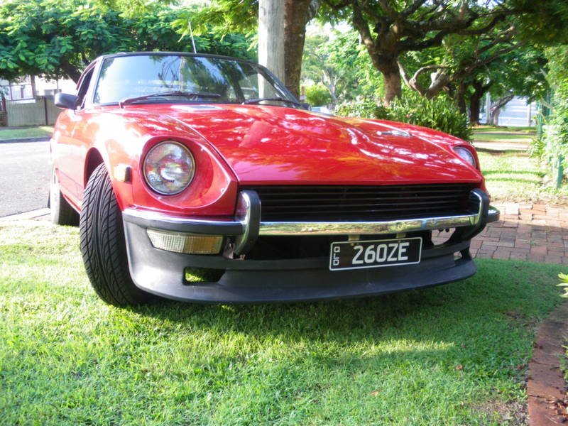

stevo_gj Posted May 4, 2009 Author Posted May 4, 2009 Finally, a pic of my car with its painted air dam <a href="http://www.shaun-maluga.com/Images/Z/ZRun/_MG_9192_cropped.jpg"><img src="http://www.shaun-maluga.com/Images/Z/ZRun/_MG_9192_cropped_small.jpg"></a> Quote
