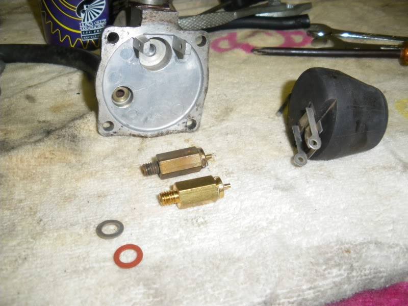

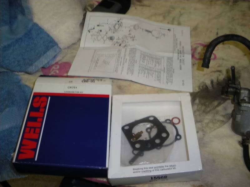

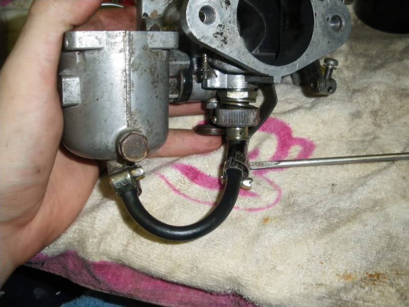

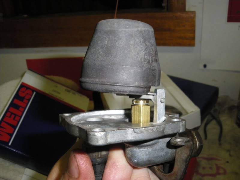

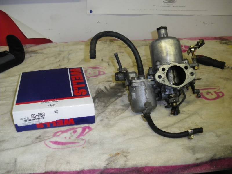

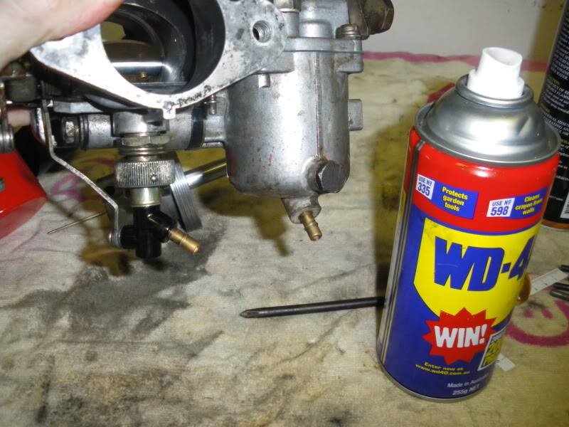

stevo_gj Posted December 25, 2009 Author Posted December 25, 2009 Got the car back today mix of good and bad news. The air conditioning is working well. The car is running very roughly. I'm pretty certain that it's related to the old points dizzy, if you've ready my other stuff you'll remember that the module was broken on my replacement electronic unit. I've just got a replacement for it so I'll be having a go at fitting it on Monday (after I get back from woodford). I recently purchased a rebuild kit for my carburettors, I thought I'd post a couple pictures of what was included in the kit and how it went together. This is the kit that Black Dragon sell in the US. Here is the contents of the kit as it came: I took off the old hose which was quite thick. It is recommended by the guys at Ztherapy that you should use thin hose as it stops the jet from sticking when you pull the choke on. In the kit the valve on the float bowl is replaced. The float bowl gasket is also included in the kit. And finally, I made sure the jets and needles were aligned well enough such that the pistons fell at the same speed: Pretty good camerawork for my teeth Quote
