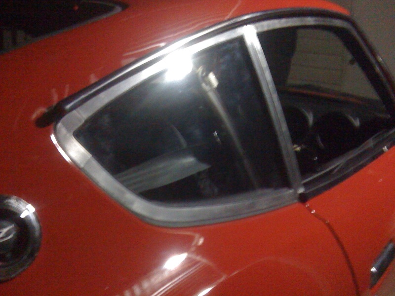

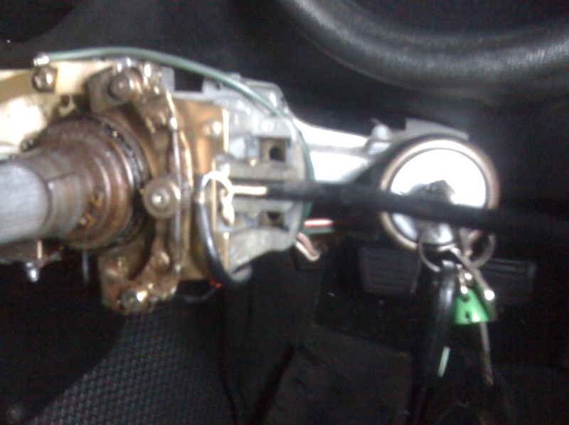

stevo_gj Posted April 30, 2010 Author Posted April 30, 2010 Well I got the car back today and the new rubbers look wayy better. I need to get some polish onto the newly revealed stainless steel rear quarters but I'm pretty happy with it. On the drive home the indicators stopped working (it never ends). I took off the steering wheel and little black box covering the wiring but I can't see anything wrong with the mechanism. Nothing happens when the indicator is triggered in either direction, and it stopped suddenly when driving. I could see two white and one green wire coming out of the back of the indicator switch so I thought I'd try bridging them to see if the switch was the problem. No such luck apparently. None of the fuses in the fuse box appear to be blown and the fusible links are intact. Are there any other fuses I should look at? I don't think the bulbs could be blown since that usually makes the others indicate faster... Any ideas? Quote
peter t Posted April 30, 2010 Posted April 30, 2010 Could be the flasher unit. Does your hazard lights work as they run off different flasher units. Quote
stevo_gj Posted April 30, 2010 Author Posted April 30, 2010 Could be the flasher unit. Does your hazard lights work as they run off different flasher units. Don't have hazard lights and the flasher unit is only about 10 months old. I'll try replacing it tomorrow anyway and see if that helps. Any other ideas? Quote
PZG302 Posted April 30, 2010 Posted April 30, 2010 Don't have hazard lights and the flasher unit is only about 10 months old. I'll try replacing it tomorrow anyway and see if that helps. Any other ideas? My money's on the flasher unit.... Switches tend to get cranky and operate intermittently before they finally shit themsleves. Easy solution Steve, turn it into a race car, then when things like indicators fail, who cares they are only extra weight anyways Quote
stevo_gj Posted April 30, 2010 Author Posted April 30, 2010 Haha good to hear it might end up being an easy fix. First thing in the morning I'm off to supercheap. daily driving racer has a nice ring to it That method I tried of bridging out the switch using the wires at the rear, should that work normally? Quote
peter t Posted April 30, 2010 Posted April 30, 2010 Have a wiring diagram if you want it and some spare flasher units you could try if you want. Quote
stevo_gj Posted May 1, 2010 Author Posted May 1, 2010 Peter I think I will definitely need that wiring diagram, any way you could send an electronic copy to stevo_gj AT hotmail.com ? So it turned out the flasher fuse had blown and it just looked fine. Shaun tipped me to pulling it out to get a good look and sure enough there was a tiny break. yay! problem solved right? Wrong. The next two fuses (10A then 20A) that I have put in have blown after about 5 minutes of driving. I can't be 100% sure that its not something I've done when I opened up the cover and had a look at the indicator mechanism. Whatever is causing it, at the same time as the fuse blows my head unit switches off and then on again. I'm thinking I might check to see if the head unit wiring (which I did) is dodgy or is exposed or something like that. I'll borrow Shaun's voltmeter and get a wiring diagram and start probing. Anyone have any ideas on possible causes? Quote

stevo_gj Posted May 2, 2010 Author Posted May 2, 2010 Got side swiped at the carpark at Uni yesterday. Some guy reversed out and obviously started turning too soon. After cleaning the black shiver in the area up it's not nearly as bad as I thought. I'll just wait a couple months until I'm taking the car back to the painters to get the dent and paintwork fixed. It's been a bad month for Zs... As Shaun suggested I took off the console and redid a lot of the wiring for the Retrosound head unit so that its easily removable and much neater. I've blanked off a couple of potential causes of the fuses blowing and it all went back together nicely. I even managed to chop off the broken end of the aerial wire and reattach the same end from a newer cable. I didn't think it would work but surprisingly as soon as i put it back in the radio I had better reception than I can remember. To facilitate this work I bit the bullet and went to supercheap to spend about $100 on small tools and consumables to do the wiring properly. I've also run 2 RCA cables and the amp switch wire under the console so I shouldn't have to remove it when I buy the amp I plan on getting. This amp will power the speakers that are going inside the MSA style speakerbox Shaun made. Quote
