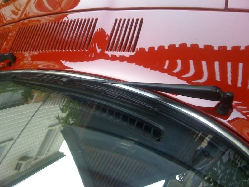

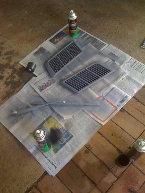

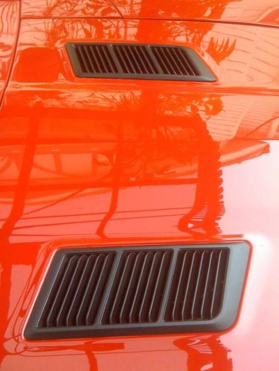

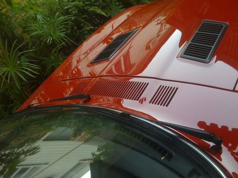

stevo_gj Posted February 21, 2010 Author Posted February 21, 2010 Hey thanks for the comments guys. I'm pretty satisfied with the ride height (inch lower than stock thanks to king springs), I already have to angle it over speed bumps and driveways, so any lower would be inconvenient. will you do with the side front mudguard indicators that are still painted black? Hey Lynton I'm pretty happy with them for now. I'll look at them in the future perhaps but as Shaun said they don't look out of place. I decided to give the car a full detail today in preparation for going to Shannon's tomorrow. While I was at it I primed and painted the windscreen wipers and bonnet vents. I'm a pretty poor painter, but they look a lot tidier now. Quote

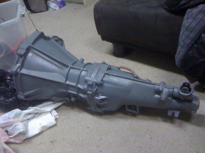

stevo_gj Posted April 28, 2010 Author Posted April 28, 2010 Shaun and I installed my new gearbox on the weekend. It has the internals of an S13 including a double synchro on second and a VL main shaft, and the external appearance of a 260z box. As such it bolted up nicely to my L26 with the only exception being that the starter is now fastened using nuts rather than a thread into the gearbox itself. We took it for a test drive tonight after sorting out the starter motor bolts and found it to have good and bad points: Firstly I quite like the fact that there is no whine in any gear, it make driving a lot more peaceful. However there is a little crunch every time the box is put into second gear. Shaun said it was possibly the synchros. I'm hoping it is something that is related to it being a 0km box meaning it has never been driven and therefore once the synchros are worn in this noise will stop. Also it is quite clunky to change gears and it is very difficult to find first gear. Apart from those two things the box is good and I am enjoying driving it. Quote

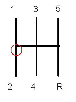

stevo_gj Posted April 28, 2010 Author Posted April 28, 2010 Thanks for giving me something to think about Lynton I don't think double clutching takes the problem away. Where sells this redline stuff? I don't think supercheap does. What does it do? It doesn't actually grind as it goes into second, just grinds as I am moving the shifter past the location I have circled in red on the picture below. It seems to go into 2nd gear fine its just as the shifter slides past this location I hear a little bit of gnashing. If I am really careful I can make it grind less by not pushing it to the left so hard, however this level of care is impractical for normal driving. Quote

Hunter Posted April 29, 2010 Posted April 29, 2010 Stevo if the gearbox is working fine just with that little blip as you change through to second, don't worry about it just drive it. Does not sound like the gearbox is going to blow a poofle valve anytime soon. Quote
