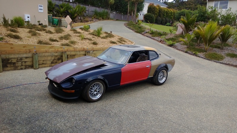

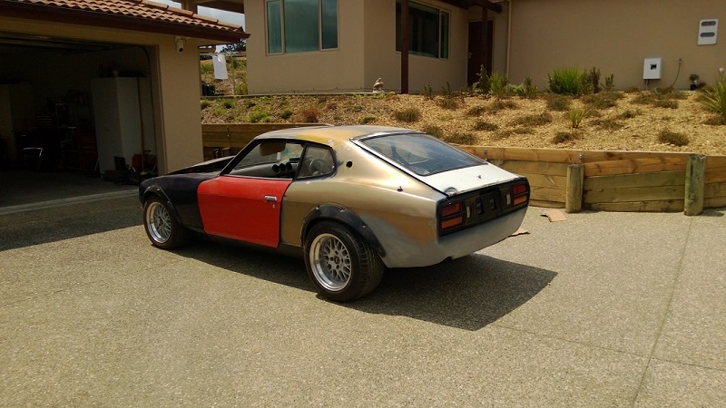

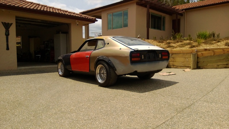

  11. Can't believe its been almost 2 years since I've posted about this After a ton of work removing rust from the rear including a new slam panel as well as smoothing the rear end - finally feel like i'm on the home stretch. Car is now moving and out of garage - obviously you could argue it still needs a paint job (can't rush these things) Next cab off the rank - It's off to get chassis rails and floors done at the local panel beater
