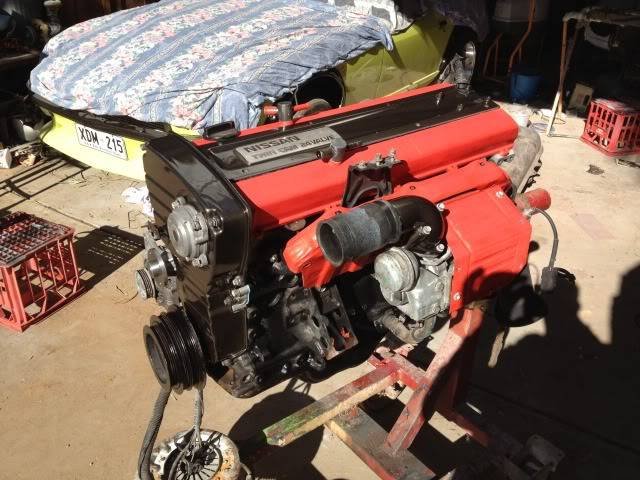

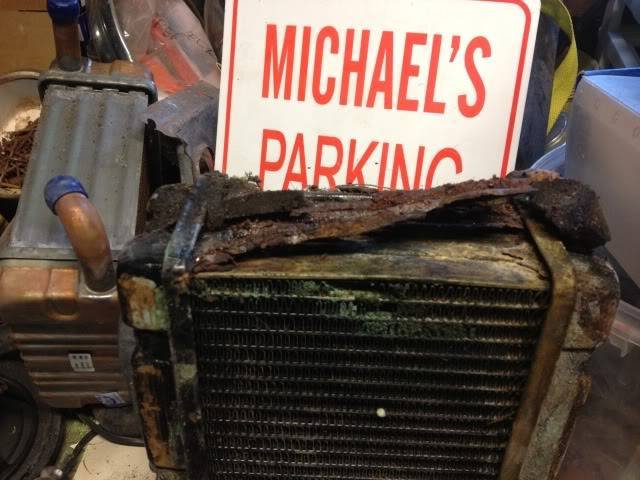

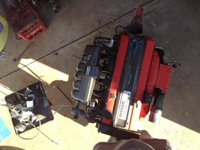

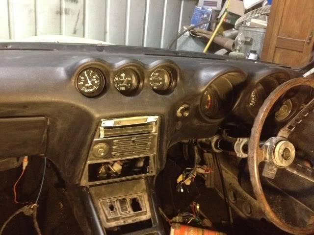

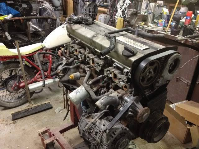

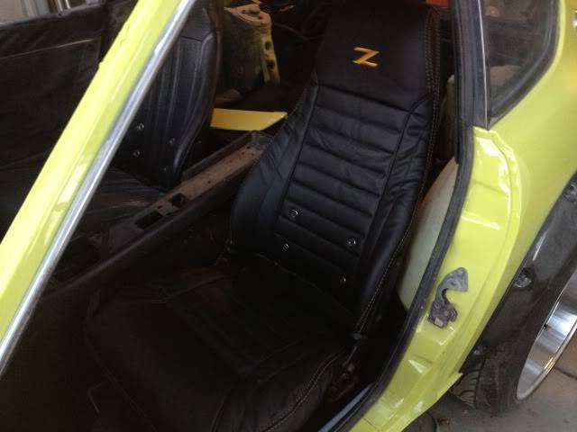

zzzzed Posted June 1, 2012 Author Posted June 1, 2012 Heyyyy!!! Time for an update.I have installed the dash but first i had to replace the heater core. As you can see the old one was a bit rusty then i installed the dash (Still have things to do before it is finished) I ordered some ebay special seat skins and slipped them over some seats i got from Roberto. I am 95% happy with the fit. But then i can remeber roberto saying he had some extra foam added to the seat base so that might have made a difference to the fit Now i am in the middle of prepping the engine to be fitted to the car. I currently have it stripped to bare block and head. I am replacing the timing belt and water pump while i am at it. I cant wait to get the engine sitting in the bay so It stops looking like a 4WD. Quote

Moderators Zedman240® Posted June 2, 2012 Moderators Posted June 2, 2012 I made a mistake of not replacing the water pump while the engine was out on a stand.. "yeah the water pump feels alright..I won't bother" I thought. Installed the engine, filled it with water and guess what, small little trickle of water from the front.. @!#$@#$#@% followed. And what's worse, I did change the timing belt so I was almost there.. Quote
zzzzed Posted June 2, 2012 Author Posted June 2, 2012 Yeh it dosnt take much effort to change the pump while it's apart and because the engine has been sitting for a while the water pump seal could more than likely have gone dry. Quote

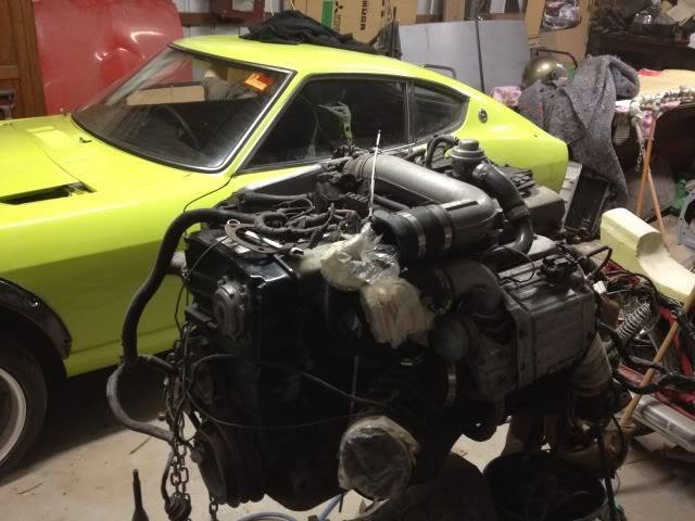

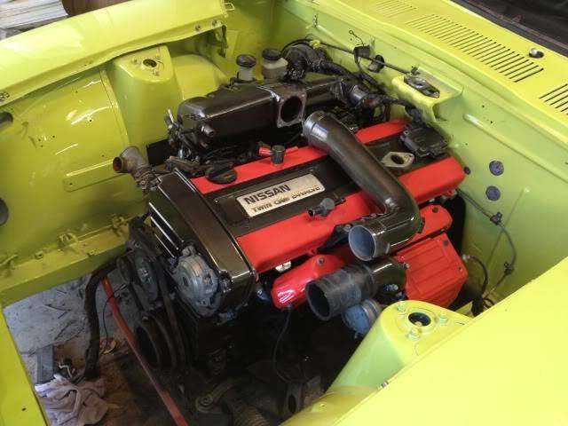

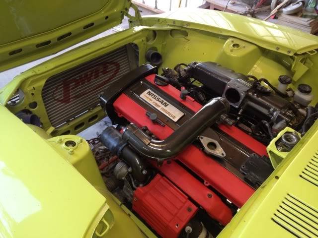

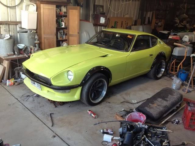

zzzzed Posted June 11, 2012 Author Posted June 11, 2012 I thought i would dedicate this weekend to my 240 so i managed to get a fair bit done. I finaly got the engine in so it is now very close But first i have a major hurdle in the wireing of the rb, This has been my bigest fear of the whole build so i will be asking a few questions if i get stuck. Any way here are some pics I had rely hoped that it would have sit lower with the engine in, I hope the king spring lows will settle down a bit after a while Quote
Ledge Posted June 11, 2012 Posted June 11, 2012 Hi Mick Looks good man, Cant wait to see it. The springs should sit a bit but i don't think they will go as much as your hoping Regards Paul Quote
zzzzed Posted June 11, 2012 Author Posted June 11, 2012 might have to go some coil overs in the feuture Quote
luvemfast Posted June 11, 2012 Posted June 11, 2012 Schwwiiiinnnngggg!!!!!!! Quickly becoming a fav build for me at the moment. Where's our YouTube updates Mick? Quote
zzzzed Posted June 11, 2012 Author Posted June 11, 2012 yeh i guess i am due for a youtube update Quote
Roberto Posted June 11, 2012 Posted June 11, 2012 Since you are such a superstar with the welder and grinder Mick, you could lower the spring perches. This would be the most cost effective way plus you still keep the progressive spring which is great for street use and will be balanced with your rear springs. Quote
Brabham Posted June 11, 2012 Posted June 11, 2012 Projected power output? Wow that engine is hard against the firewall, any further back and it would be in the passenger seat! Did you get Castlemaine engine mounts or are they custom? Cheers Quote
zzzzed Posted June 11, 2012 Author Posted June 11, 2012 there is about 10 mm between the fire wall and the engine. The mounts were already on the engine when i bought it from benny Quote
zzzzed Posted June 11, 2012 Author Posted June 11, 2012 do you think the engine is to far back? Quote
