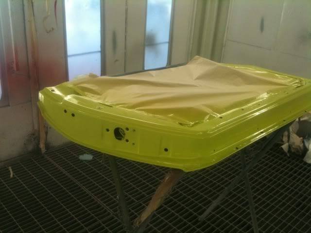

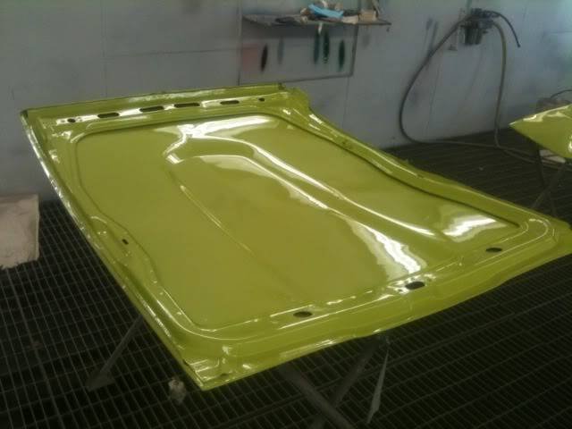

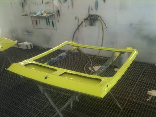

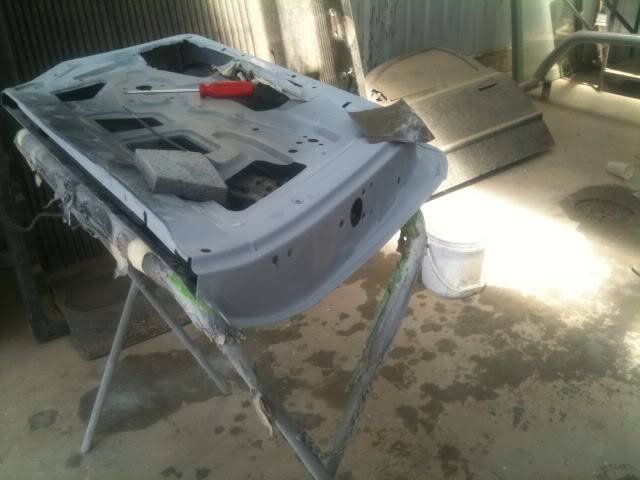

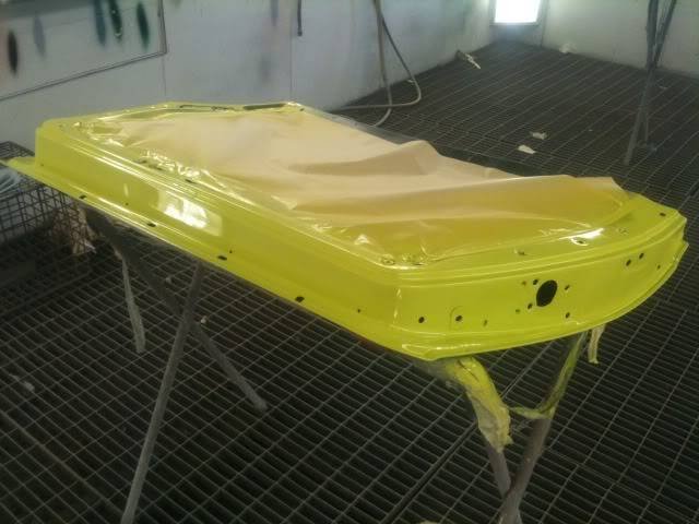

zzzzed Posted November 2, 2011 Author Posted November 2, 2011 The final stages are here. ;D ;D ;D I am in the middle of preparing my new house to move in to so am busy busy. the only chance i get to work on the zed is during my lunch brake. However i am still making progress. I am Now up to the edging out stage. which involves sanding all the door jams and under bonnet and hatch and so on with 600g wet. then my boss rick will hit these areas with colour. Then i will bolt it all together for the last time and then sand the rest of the car ready for paint Quote

zzzzed Posted November 14, 2011 Author Posted November 14, 2011 Factory colour? Got any pics? It looks awesome Yes it is the factory lime yellow that this car was painted in on the assembly line. we have only painted the inside of the doors at this stage but there will be more as the weeks go on thanx guys. It is getting exciting Quote
Brabham Posted November 15, 2011 Posted November 15, 2011 What brand of paint are you using and can they mix it from the code or did you get it matched? Cheers Quote
zzzzed Posted November 15, 2011 Author Posted November 15, 2011 its ppg paint. had to match it because the from code the tinters are not available any more i think they said it had someting to do with there lead content. It looks awesome out in the sun light Quote

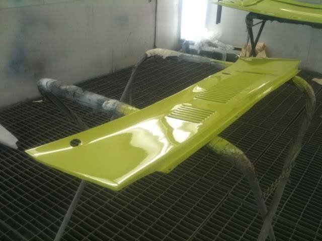

Roberto Posted November 22, 2011 Posted November 22, 2011 Straightest looking cowl panel i have ever seen. Now that is worth licking Quote
zzzzed Posted November 22, 2011 Author Posted November 22, 2011 yeh i got lucky with the cowl. zero rust and zero dents Quote
