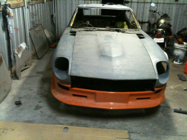

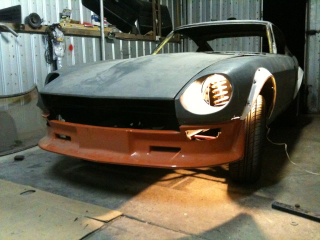

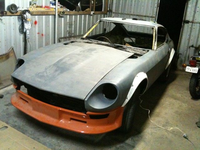

zzzzed Posted September 6, 2010 Author Posted September 6, 2010 I dont want you all to think i am slacking off so i shall show you were i am up to. I have fitted all the panels to the car so to see how they fit.. I have fond that the front end is out of square by about 5 mm so i am going to take it to work in the next few weeks to put it on the rack. I am just waiting for a guy to come pick up his car from work so i have the room In the mean time i shall be getting the removable panels ready for primer There will be more youtube in a couple of days Quote
Roberto Posted September 6, 2010 Posted September 6, 2010 Looking good Mick What measurements did you make to determine your front end is out?? Quote
zzzzed Posted September 6, 2010 Author Posted September 6, 2010 just basic cross measurements from factory bolt holes on the bulk head to the strut towers. I only used a tape measure, but when i get it to work i will use a Tremal gauge Quote
