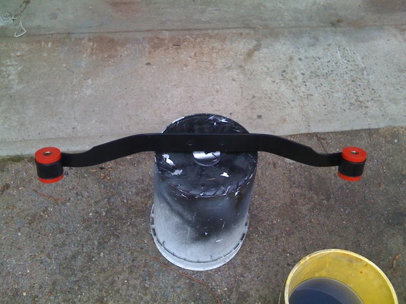

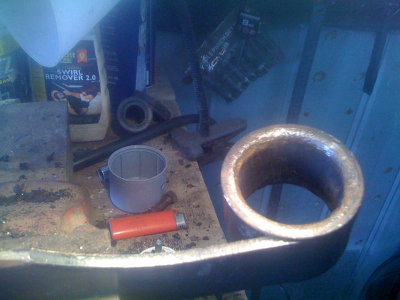

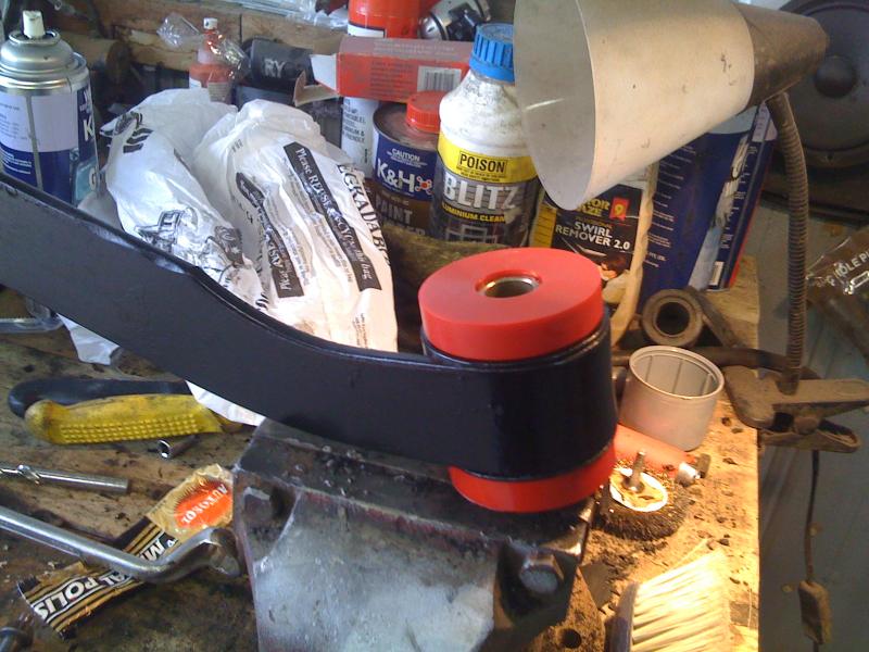

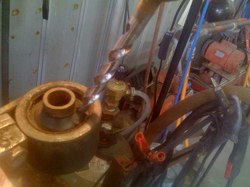

zzzzed Posted May 6, 2009 Author Posted May 6, 2009 i got some done today I put some new bushes in my mustache bar which involved drilling out the old rubbers Quote

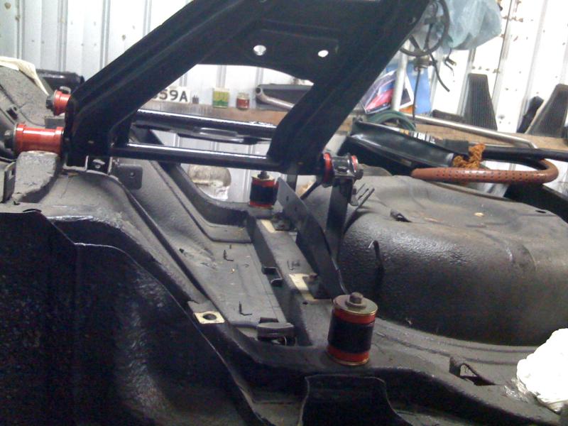

zzzzed Posted May 6, 2009 Author Posted May 6, 2009 i also painted my sway bar. This is a 260z 2+2 sway bar so it is a bit heavier than the standard 240z sway bar. I also reassembled my rear cradle a little bit just to make it feel like i have been doing something. I never noticed that one trailing arm is up side down I thought this was dodgy until i looked under my 260z and noticed it was the same Quote

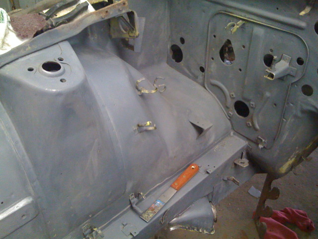

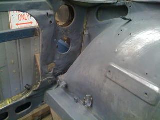

zzzzed Posted September 10, 2009 Author Posted September 10, 2009 yeh mate I have been working on the engine bay. I have removed all the paint from the bay and now i am fixing all the imperfections. i have removed the battery tray and found a bit of rust underneath, surprise surprise. Also the rad suport is a bit out of shape so ill be doing a bit of work to that. I am now trying to get a couple of hours a day work done so hopeful i will have a few more updates to show you guys cheers mick Quote
zzzzed Posted September 10, 2009 Author Posted September 10, 2009 i have also made up a new return line's for my fuel injection. Here are some pics of my engine bay Quote

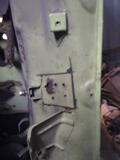

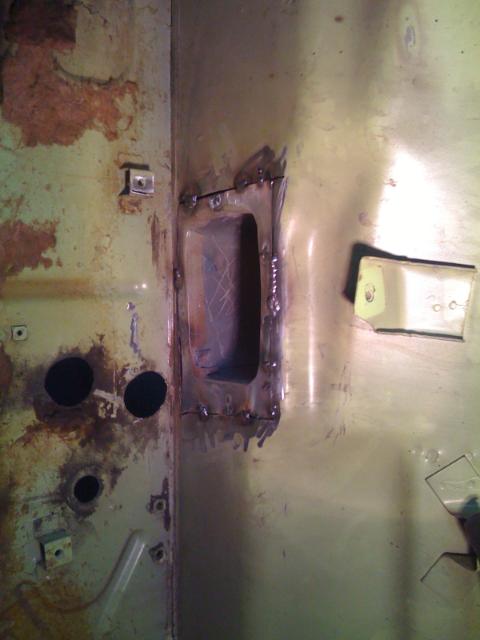

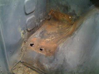

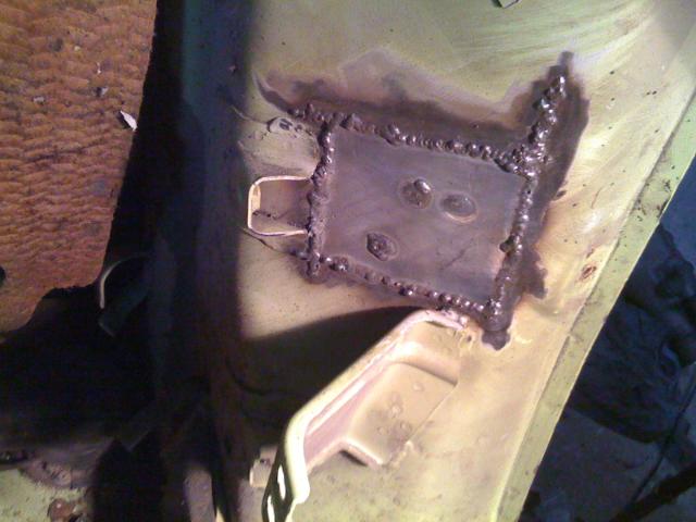

zzzzed Posted September 24, 2009 Author Posted September 24, 2009 Hi guys I thought i would put in an update. Over the last week or two i got a bit more rust work done on my car. First was the battery tray which i removed to get better access. I figure with the battery tray i might bolt it back in so it is removable. I also removed some rust from the under dash area the heater duct was the worst so i cut the whole duct out and made a new one. check out the pics Quote
zzzzed Posted September 24, 2009 Author Posted September 24, 2009 the heater duct.. The last pic is of the new duct tac welded in. I still have to finish it Quote

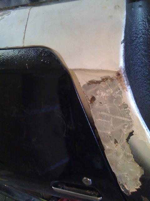

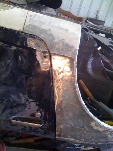

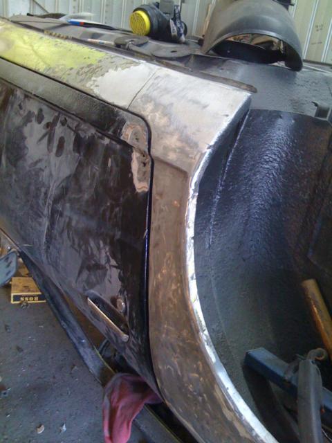

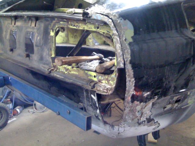

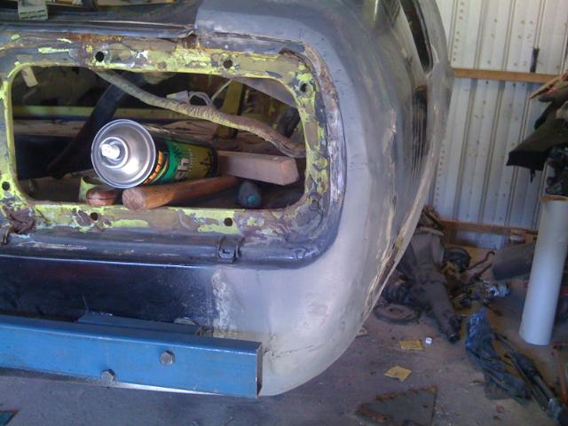

zzzzed Posted October 25, 2009 Author Posted October 25, 2009 I got some more bodywork done this week The right rear corner was squashed flat and full of bog so i cut it out and welded in a new section Whoever restored this car last fabricated a new beaver panel but did a rather dodgey job at welding it in, so i redid this as well. Quote
