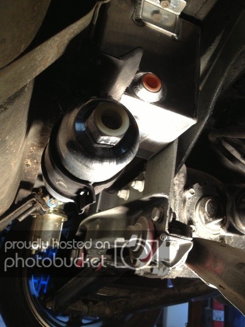

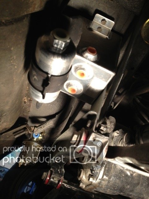

zzzzed Posted September 29, 2012 Author Posted September 29, 2012 step by step, inch by inch, closer and closer to firing this beast up. today I mounted up the fuel pumps and surge tank. tomorrow i will plumb them up ready to run I think the bosch o44 will be adequate but i think the carter might have to go, from what i have herd they are rather noisy but i will give it a chance Mick Quote
jamo240 Posted September 29, 2012 Posted September 29, 2012 Hey Mick...I run an 044 on my RB25 installation. It also has a little walbro that feeds the surge tank. It works fine feeding through a 3/8 fuel pipe. I would also recommend isolating the mount for the pumps...I did it to mine (they used to be solid mounted via a mounting plate), and it is a lot quieter with the isolation. CHeers Jamo Quote
Riceburner Posted September 29, 2012 Posted September 29, 2012 I think the carters have isolation rubbers included but they are still crazy loud.... It's like having a hammer drill under the car and that was with a full interior! Quote
zzzzed Posted September 29, 2012 Author Posted September 29, 2012 Cheers for the tips guys. It will be sure to be improved apon once I can get it running. Then I will be able to get it to work and up on the hoist to make life easyer. Quote
dat240z Posted September 30, 2012 Posted September 30, 2012 I have the carter black as a surge pump in my rb 240z and with isolator or not, its very loud and racy! Im going to try the walbro one next Quote
jamo240 Posted September 30, 2012 Posted September 30, 2012 You don't need big noisy pumps as lift/surge tank pumps lads. Because they are filling the surge tank at no pressure (compared with feeding fuel to the injectors under pressure), you only need a relatively small pump...the inline roller cell or turbine walbro or similar pumps are quiet and do a fine job without all the in-cab noise. I double isolate mine (pump is isolated onto the bracket, and then the bracket is isolated onto the body, (using the rubber bushes that mount the ABS module on the R33 skyline). If you follow that sort of approach, there should be minimal noise in the cabin. Cheers Jamo Quote
