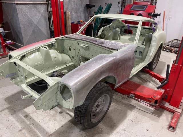

C.A.R. Posted March 5, 2025 Author Posted March 5, 2025 (edited) Update time! Late last year (2024) we moved premises to a larger facility, so that slowed progress on the 240Z. However progress WAS made and the Z was moved closer to paint. Since the body was painted in tinted high build primer in October, it's had enough time to cure and we've assembled more of the drivetrain, so much so we are VERY close to starting the engine. But before we do, we decided to sand the primer in preparation for paint. My painter prefers to have the front guards and doors attached and the vehicle able to be moved under it's own power as it's easer to deal with once it's in the booth. So Graeme DRY sanded the primer to 240g with the splines then 400g on the DA: The grey patches are spot primer to cover any cut-throughs. Tony - the owner - wants to come down from Sydney to be here in person when the engine is started for the first time - I'll post a video when this happens. Edited March 5, 2025 by C.A.R. OdinZ, CBR Jeff, Enzo and 1 other 4 Quote
