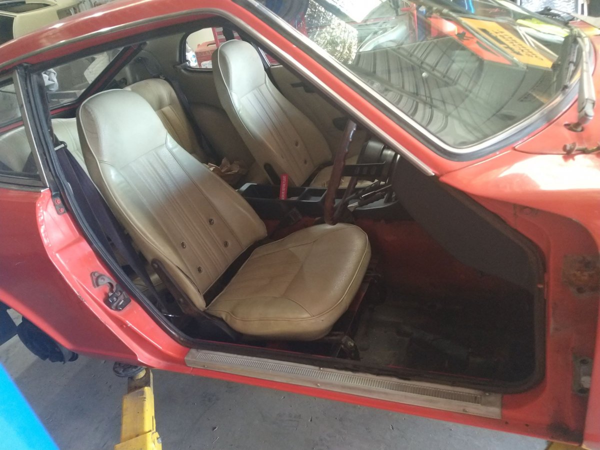

OdinZ Posted December 14, 2017 Posted December 14, 2017 (edited) 1976 260z 2+2 Manual Not a lot to add here, but I figure I start something off here. This will most likely be a slow process, as most things that I am doing are new to me, even some of the simplest tasks for most. I have been around cars & motorsport for a bit, but other than stereo systems, & headlights, I have never really needed to touch anything on a car before. (What have I gotten myself into) To date, I have installed a new speedo cable (removed and reinstalled tacho & speedo), got the choke cable attached on the rear Carbs. And bought new fuse panel cover, choke knob, trip reset knob. Small bits and pieces. This weekend (I finally have a free weekend, shhhh, dont tell the wife) I plan remove the heater valve/c0ck as it is leaking coolant into the foot well and see if I can fix that myself, as these seem to be really hard to find brand new, or cost over $200. I have seen Sirpent rebuilt his, so I will give that a shot. And based on the recommendations of a few people, might as well get my Heater core re-cored at the same time. Probably go to Dandy Radiators. Any advice on removing this valve? I am hoping I dont have to pull the dash out (I know do not need to pull the dash out to remove the heater core). Edited January 24, 2020 by OdinZ MikeZ 1 Quote

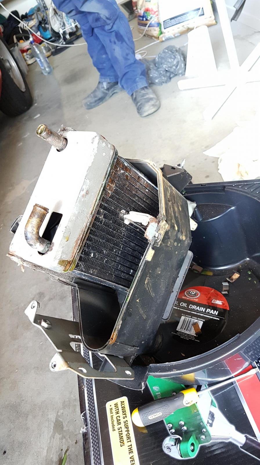

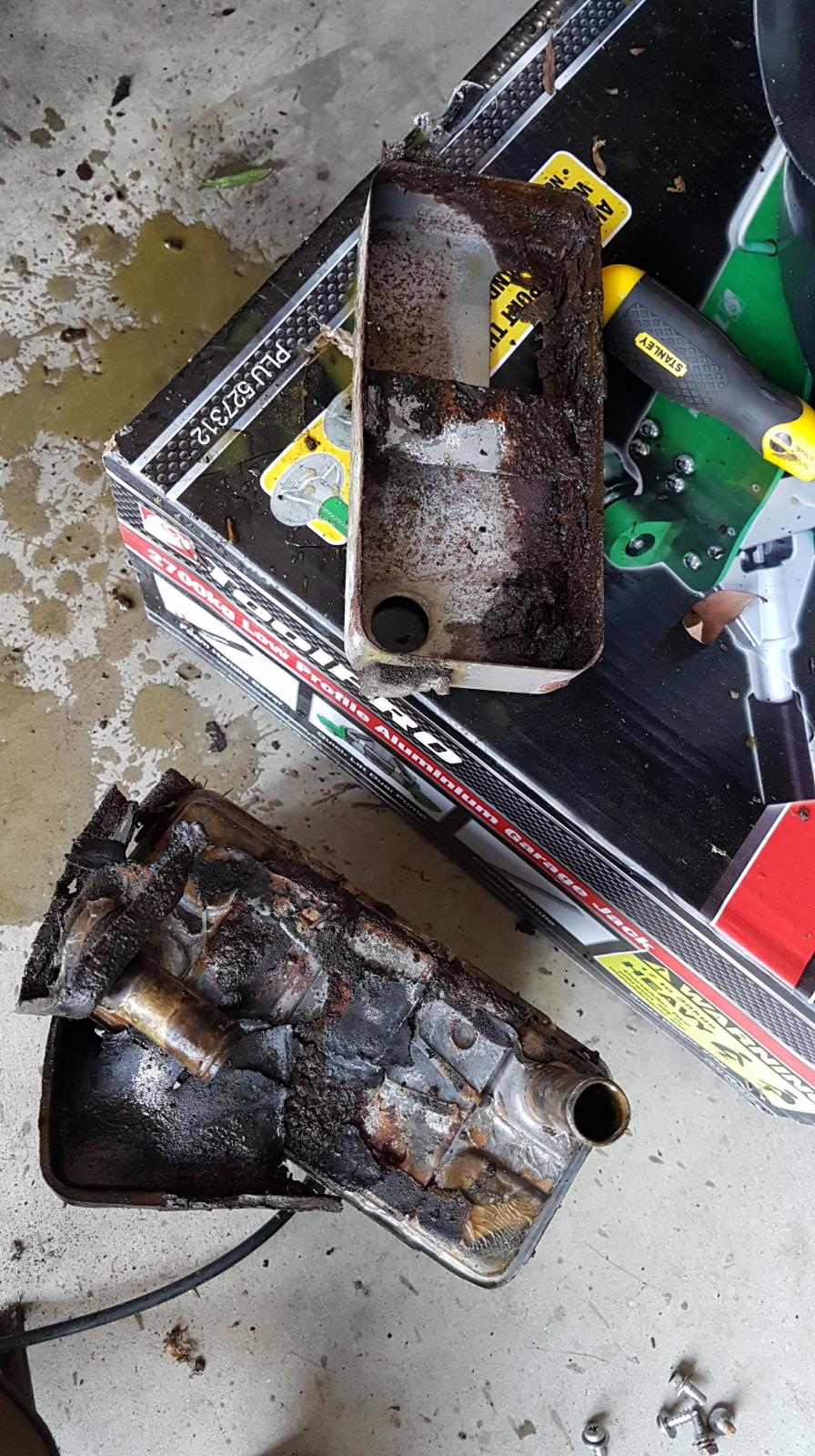

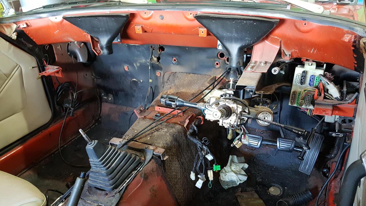

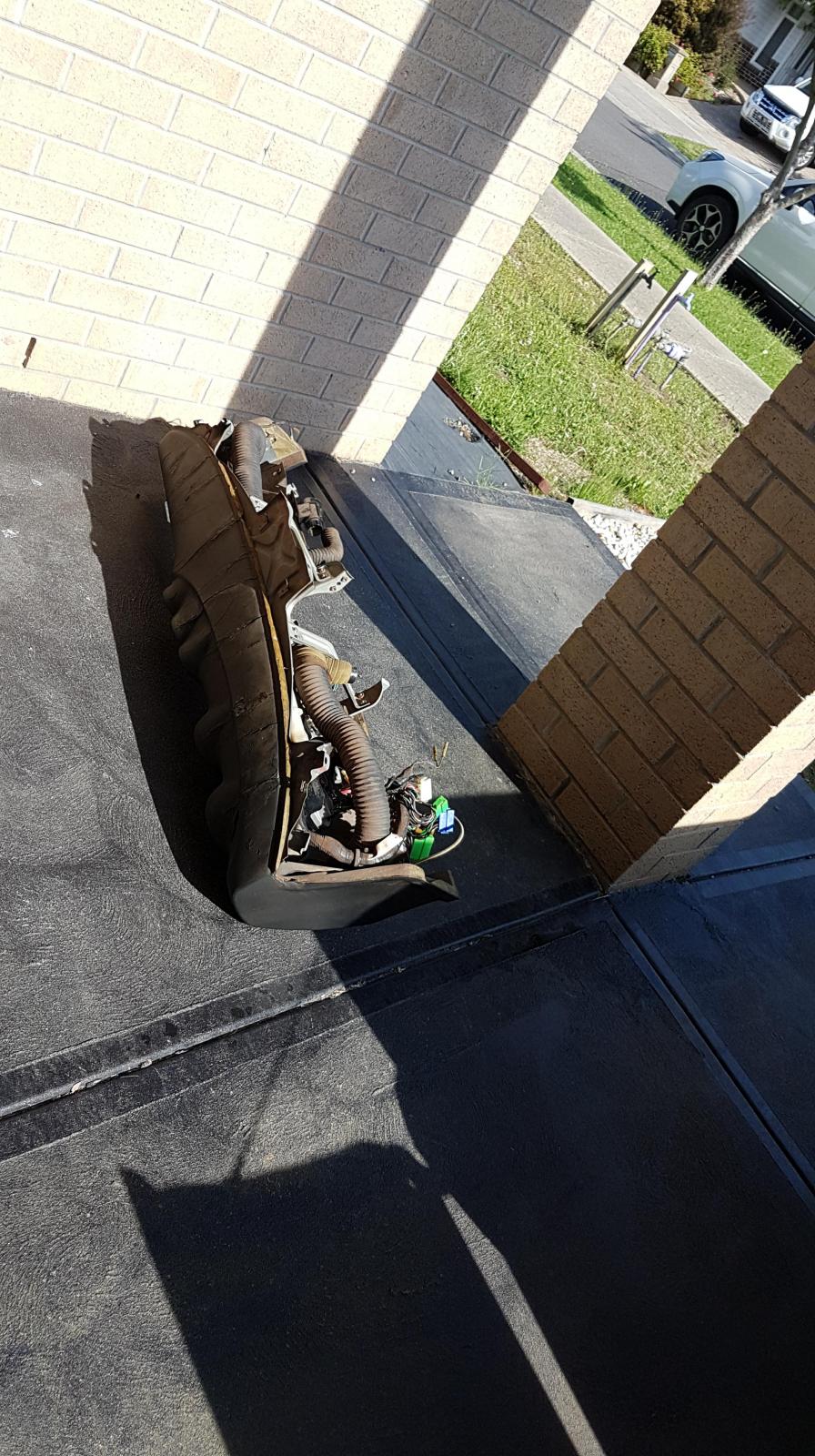

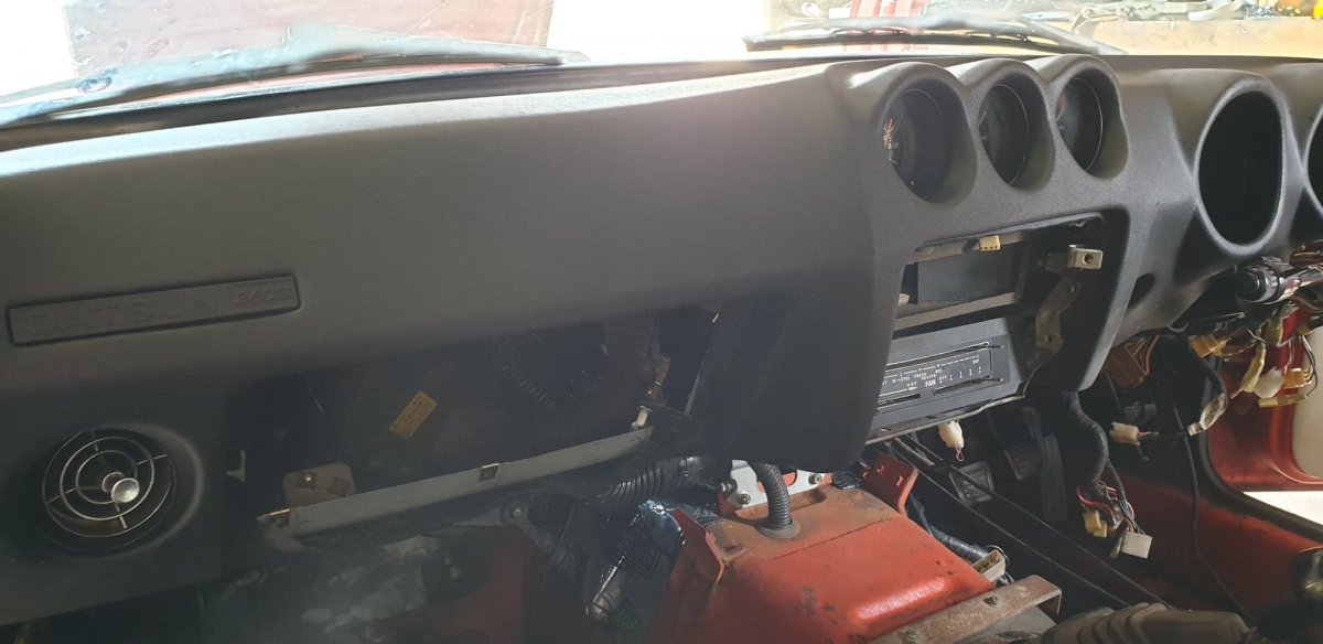

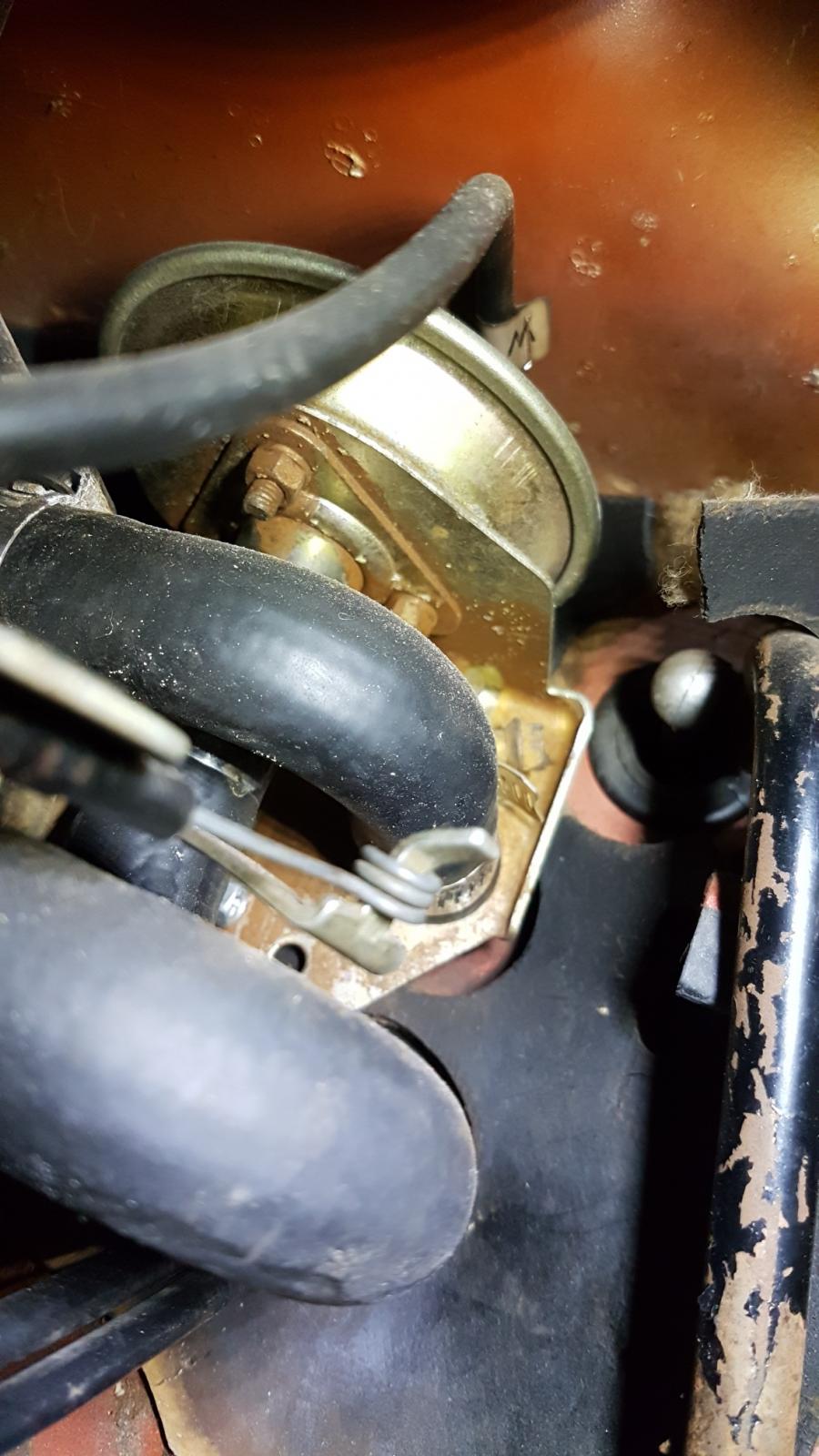

OdinZ Posted December 17, 2017 Author Posted December 17, 2017 (edited) So as planned, i was going to attempt to pull the heater valve & core out by myself, luckily for me a certain tall, knowledgeable, well known, and handsome member of the forum had offered his expertise for an afternoon to help me with this. And I tell you what, thank the God of Thunder he did! I most likely would have been bashing my head trying to get these out, then spent a whole day, or two, trying to do this. Removing the core & valve without removing the day was attempted, and not so successful, it seemed more time consuming than what it was worth. The fan blower unit came out, then the dash, condenser unit, valve & heater core. The heater valve seems to have decent enough sealing, but the diaphragm seals will most likely need replacing, as there is evidence of some leaking from this valve. The heater core looks quite corroded, so I will look for a new one, or decent enough second hand one, and get that re-cored. Seeing as the dash is out, I will look at getting this down to the dash doctor to get reskinned, and get LED globes for the dash gauges. Also, clean up the inside, replace the grommets, and maybe even put some sound deadening down in the front. And sort out the carpet, I have a new set of dark green carpet (came with the car), anyone want to swap for black carpets? HA Edited December 17, 2017 by OdinZ GongZ, MikeZ and C.A.R. 3 Quote
GongZ Posted December 18, 2017 Posted December 18, 2017 ...Seeing as the dash is out, I will look at getting this down to the dash doctor to get reskinned, and get LED globes for the dash gauges... Be aware that if you fit LED dash lighting - that the dimmer control will not work. I hope to convert to LEDs one day too, and I found this solution; http://www.protizmo.com/Product-Info/AILD-1/ It dims the LEDs using pulse width modulation. If you fit PWM - all the bulbs to be dimmed need to be LED, because incandescent bulbs don't like being 'pulsed'. To choose the correct model you need to know the maximum resistance of the rheostat. I would like to know what your rheostat measures if you get a chance while the dash is out. OdinZ 1 Quote

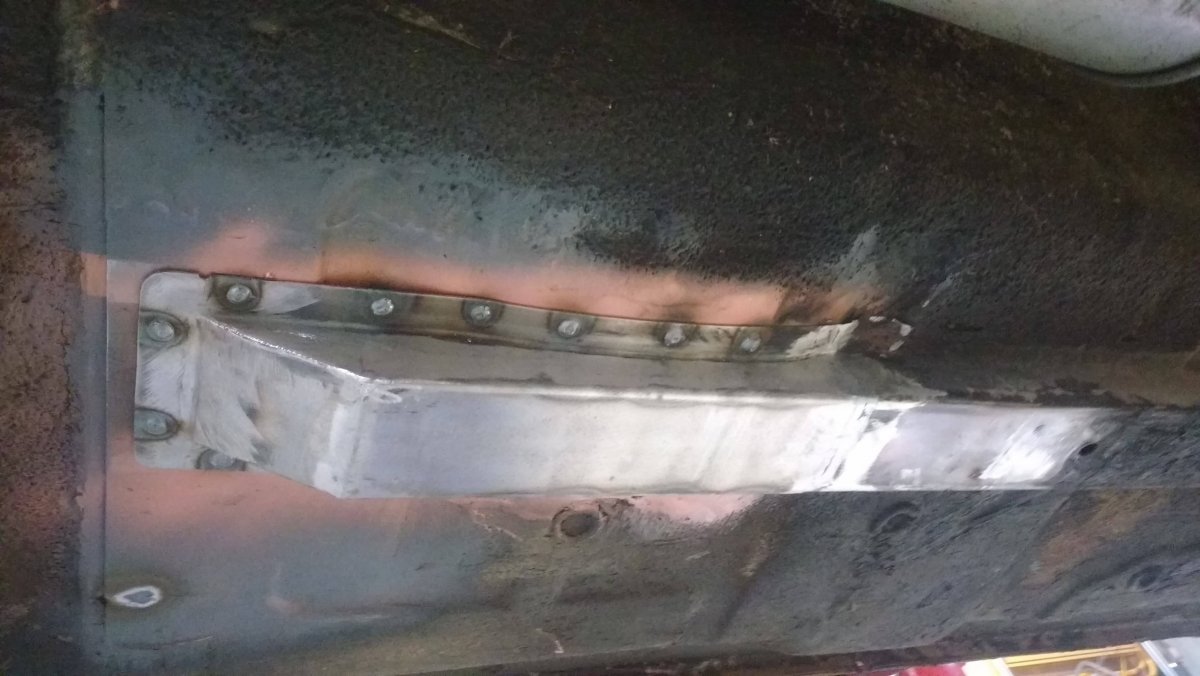

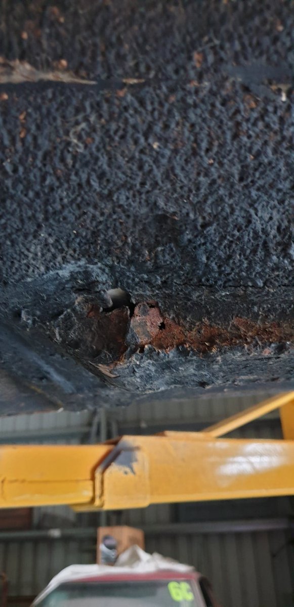

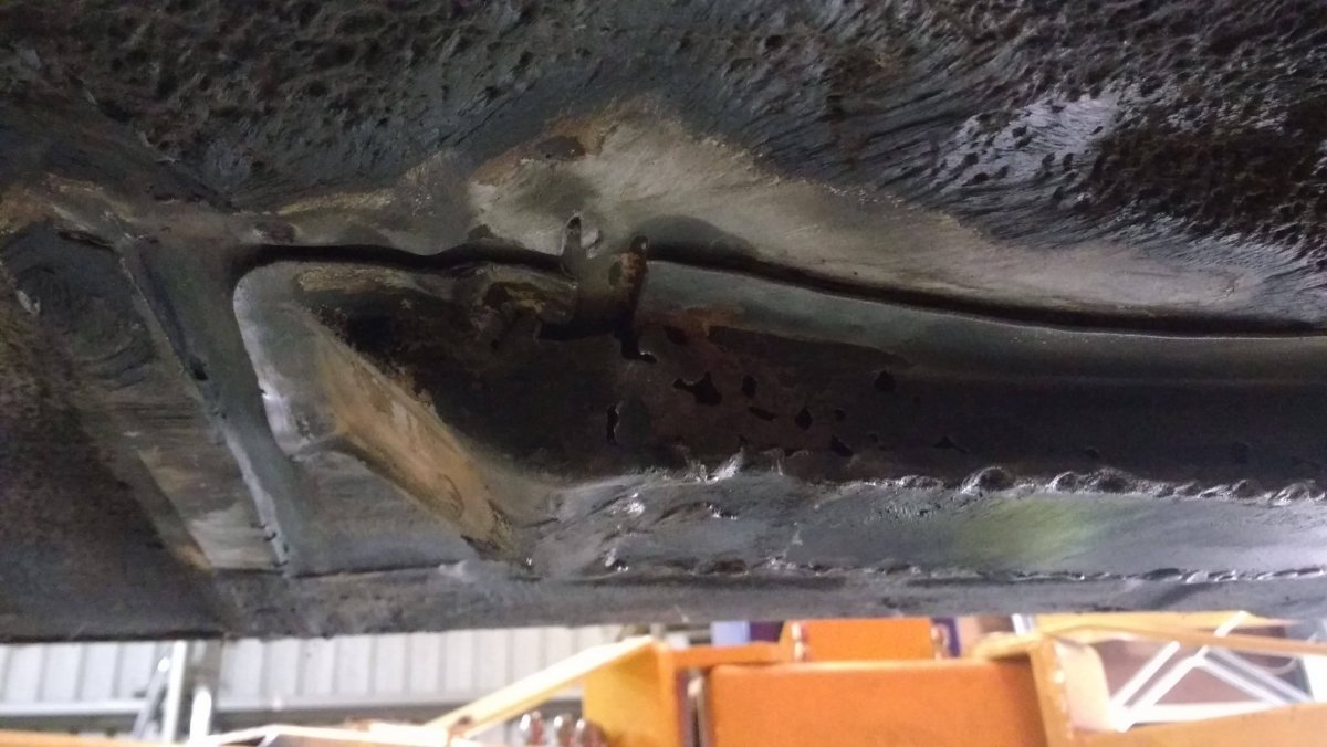

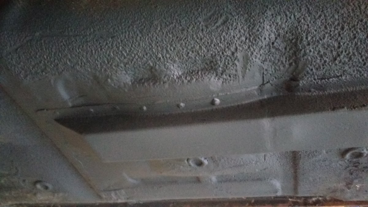

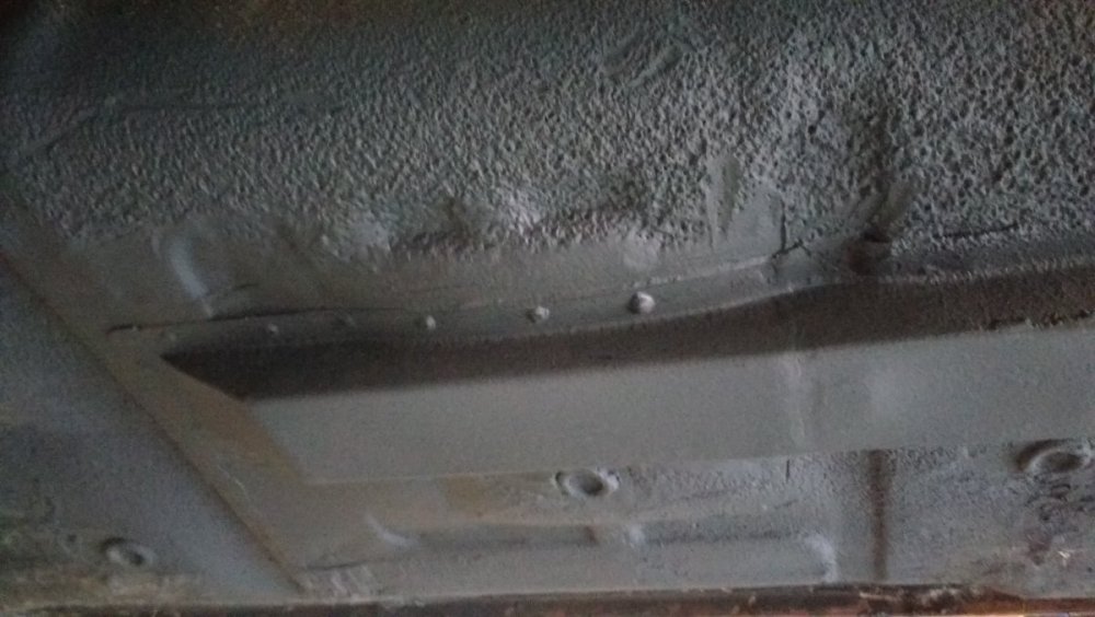

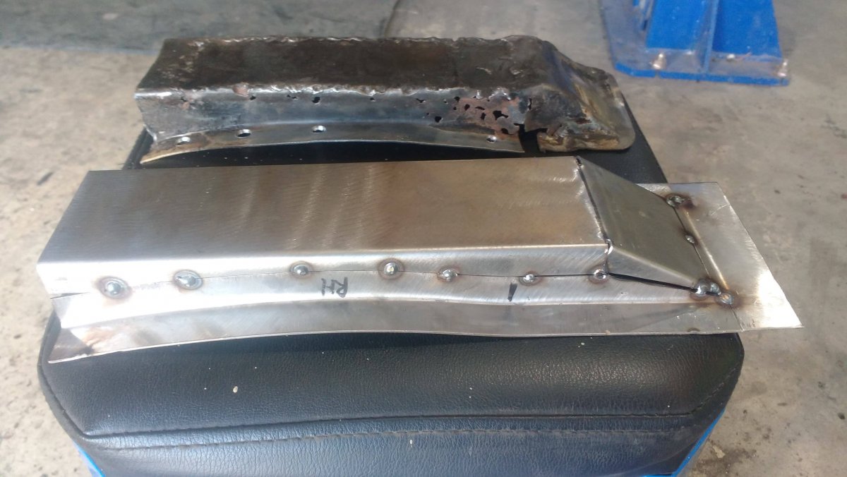

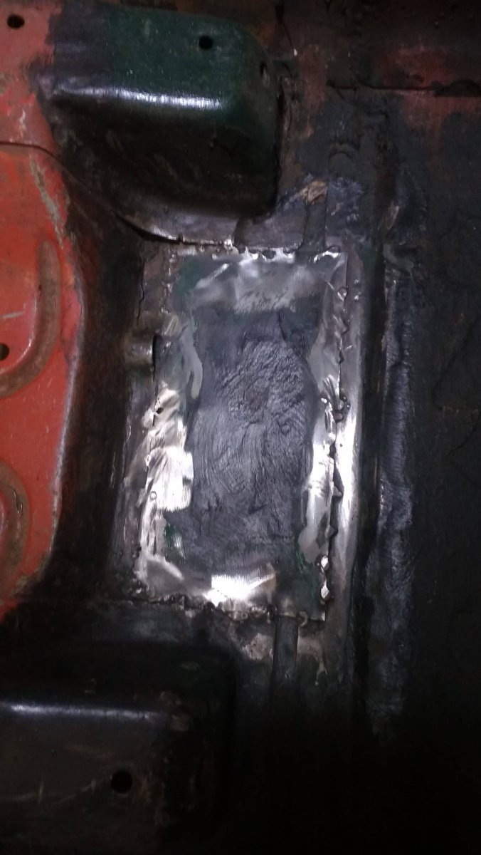

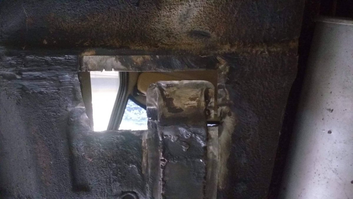

OdinZ Posted May 13, 2019 Author Posted May 13, 2019 (edited) As mentioned above, we had really struggled to load the car onto the trailer, and it also didn't roll easily in the shop, turns out front brake calipers & rear wheel cylinders were seized. Also all of the suspension bushes needed replacing & the tie rod ends, as well as one of the rear wheel bearings. Of course, what would a Datsun be without some rust, some great work by CAF with the repairs, I am very happy! Edited May 13, 2019 by OdinZ gav240z and PeterAllen 2 Quote

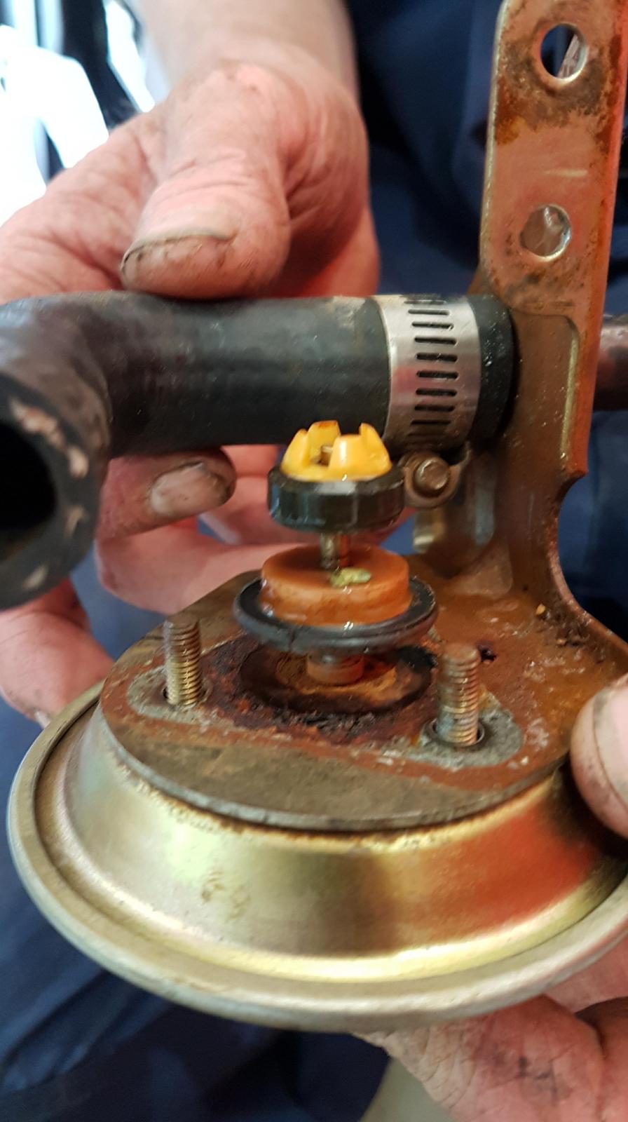

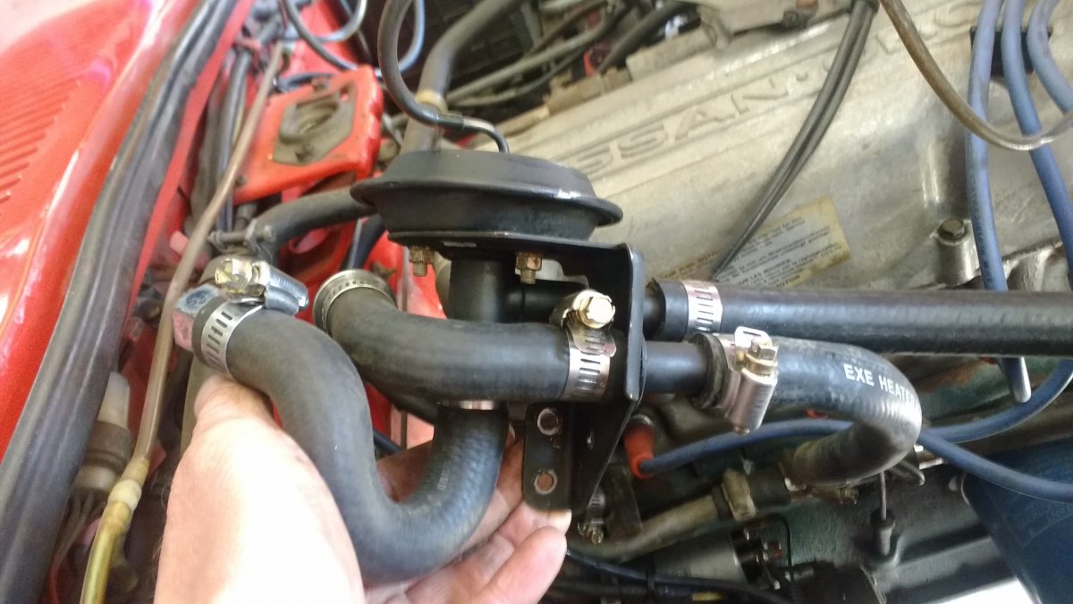

OdinZ Posted May 13, 2019 Author Posted May 13, 2019 Next up was the was the vacuum heater valve, I had attempted at rebuilding it, but the o-rings I was given for it were undersized, so Lachlan rebuilt it again, but now I think I have a leak somewhere else when I run the heater, FFS! Quote

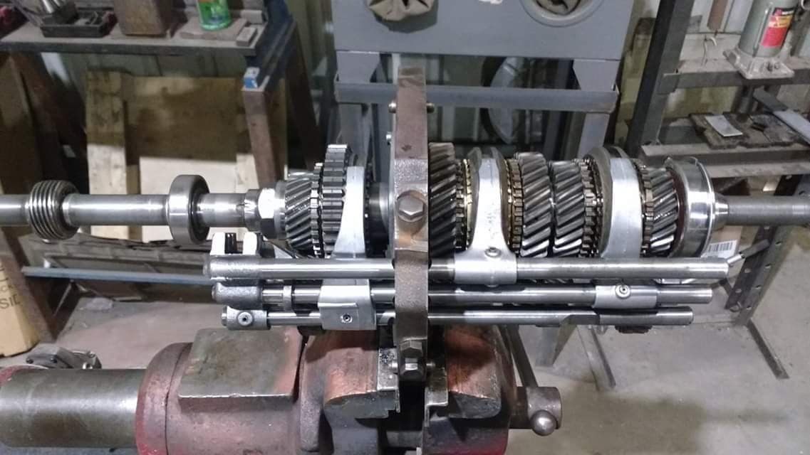

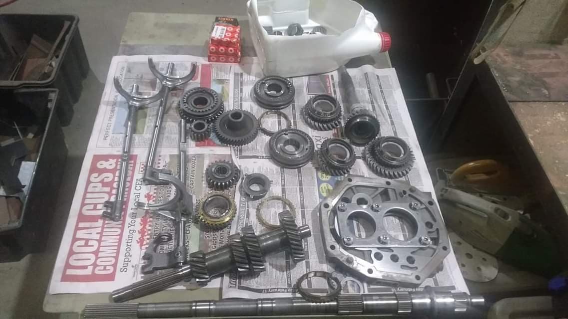

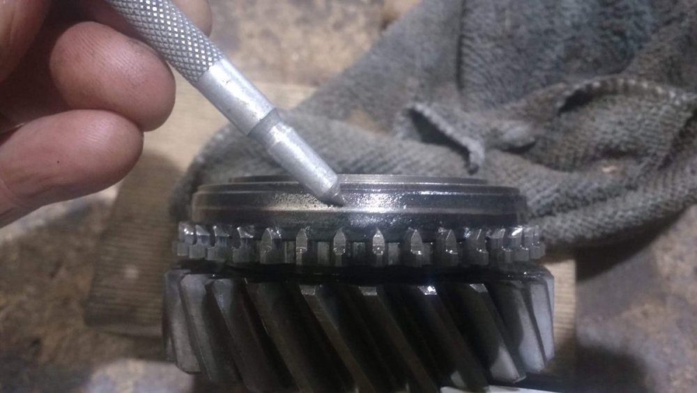

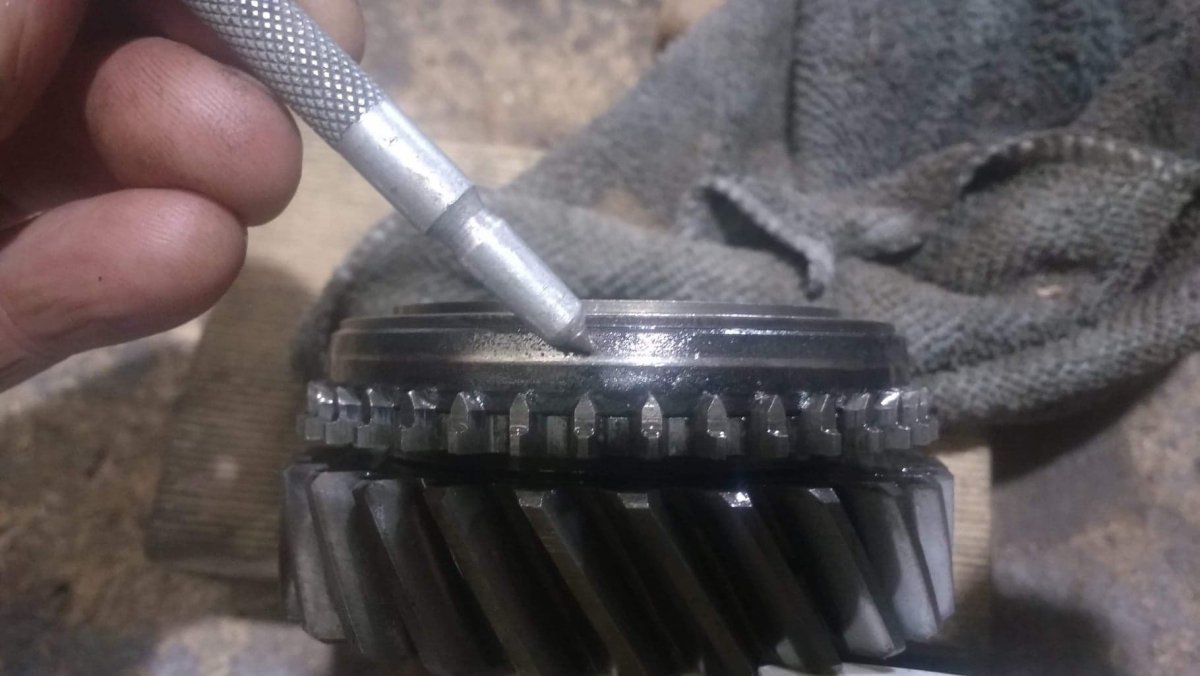

OdinZ Posted May 13, 2019 Author Posted May 13, 2019 Next on the menu was to get the gearbox rebuilt, because you know, just some worn syncros I had also sourced a later 280z donor box for some parts & to use the bell housing for the reverse lockout. Lachlan's updates on all of the work he did were great! I have driven the car a couple of times since I have picked it up, and the gearbox & short shift kit feel great! PeterAllen and gav240z 2 Quote

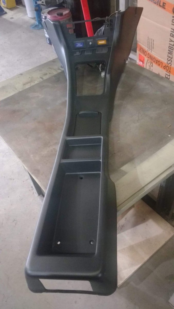

OdinZ Posted May 13, 2019 Author Posted May 13, 2019 CAF had also sent my centre console off to be restored by a local legend, it looks amazing!!! gav240z 1 Quote

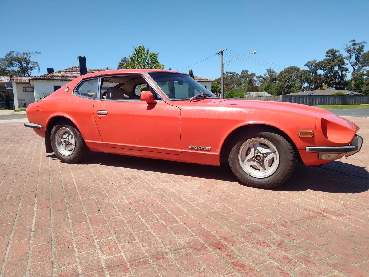

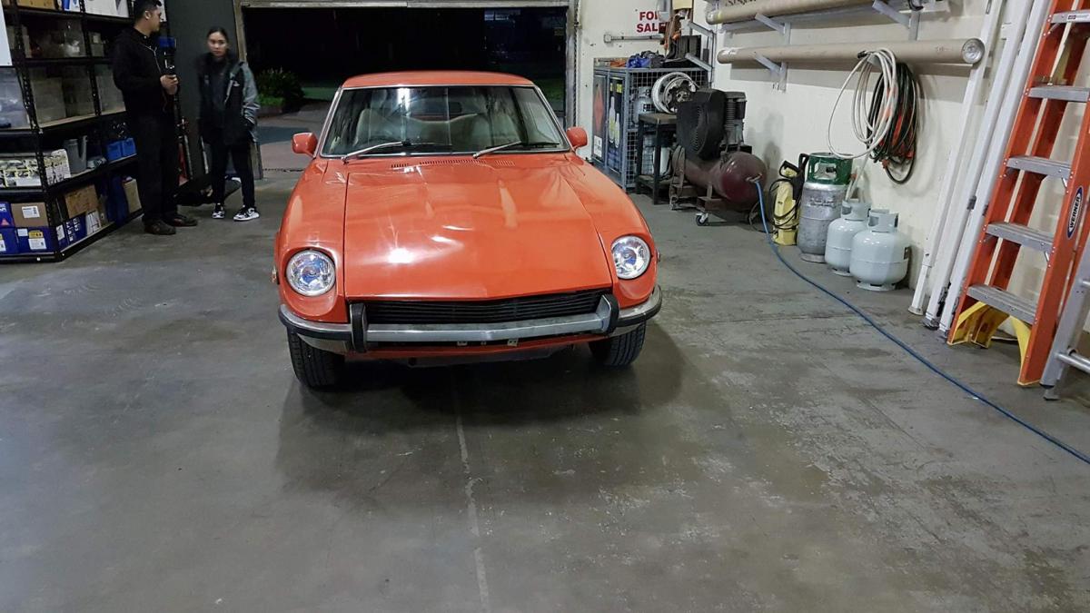

OdinZ Posted May 13, 2019 Author Posted May 13, 2019 I have already picked the car up, drove it home on UVP. Of course, it had to rain that day, but atleast I got to wash off any dust left on it and dried it when i got home. gav240z 1 Quote

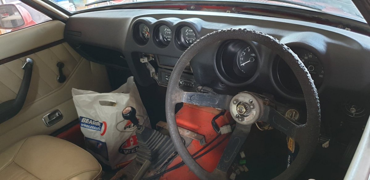

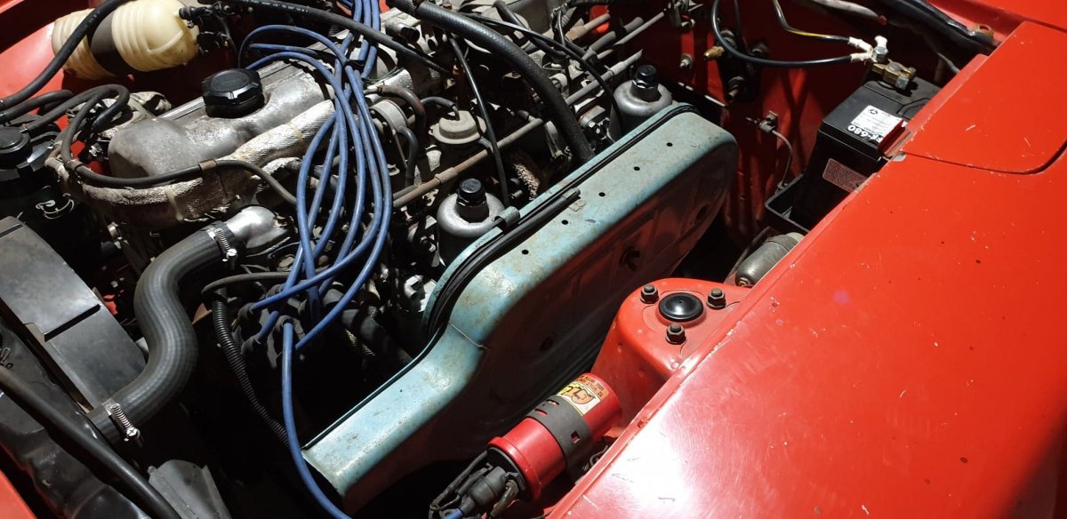

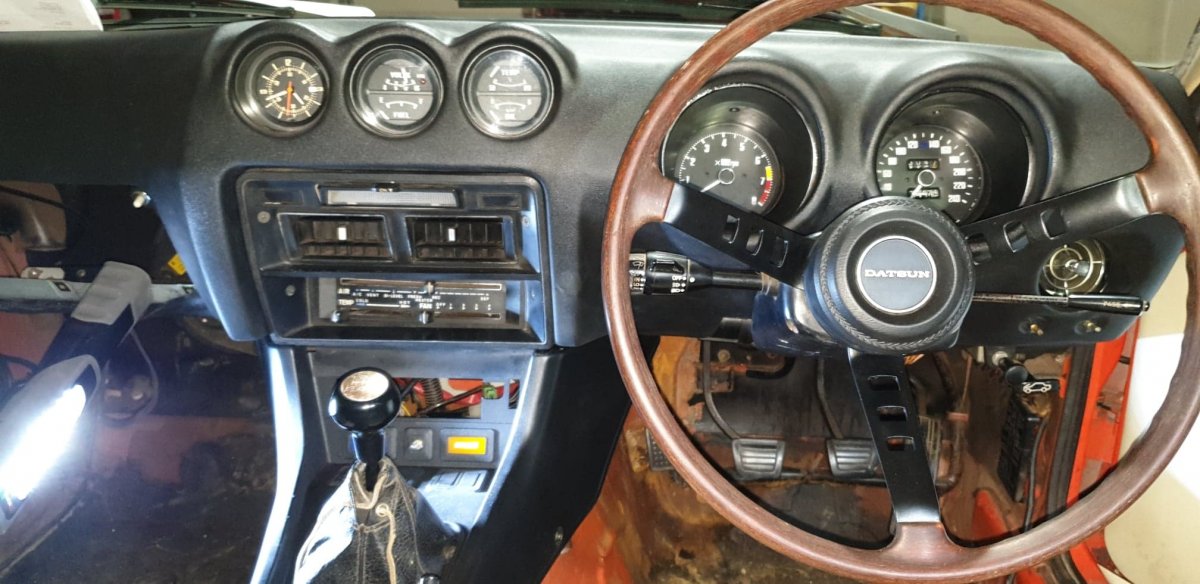

OdinZ Posted May 13, 2019 Author Posted May 13, 2019 Last couple of things I needed to do before it went for it's road worthy check was install the centre console & change out my shitty 260z steering wheel and replace it with my 240z wheel and also install the borrow air box from a mate as his had already been modified to sit on round top carbs MikeZ 1 Quote
Administrators gav240z Posted May 14, 2019 Administrators Posted May 14, 2019 Looking good, but don't throw out your "shitty" 260z steering wheel. You can get them restored and I reckon they look good! Quote
OdinZ Posted May 15, 2019 Author Posted May 15, 2019 1 hour ago, gav240z said: Looking good, but don't throw out your "shitty" 260z steering wheel. You can get them restored and I reckon they look good! Thanks Gav! Haha, if I have learnt one thing from you, it's hoard! I mean don't throw things away. I probably won't ever restore it though, as you know I have a comp repro wheel hiding somewhere gav240z 1 Quote

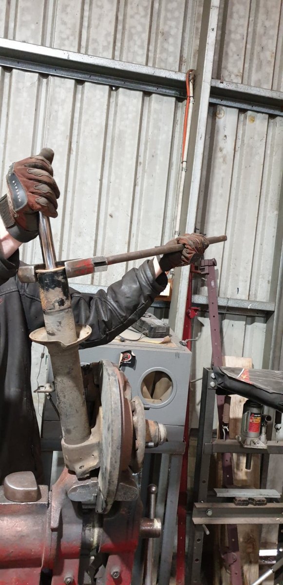

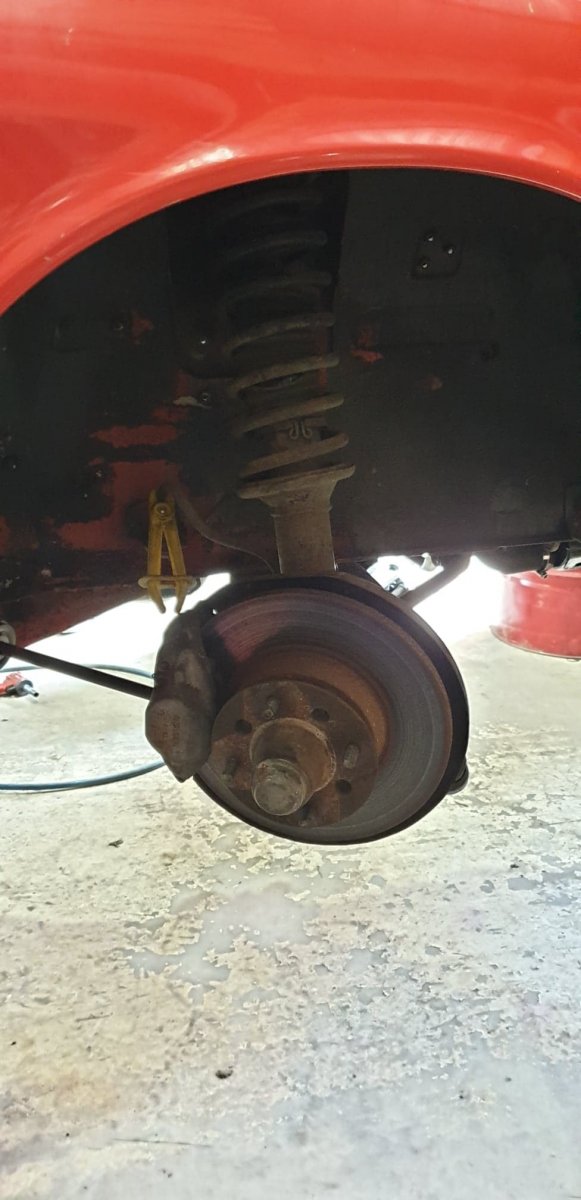

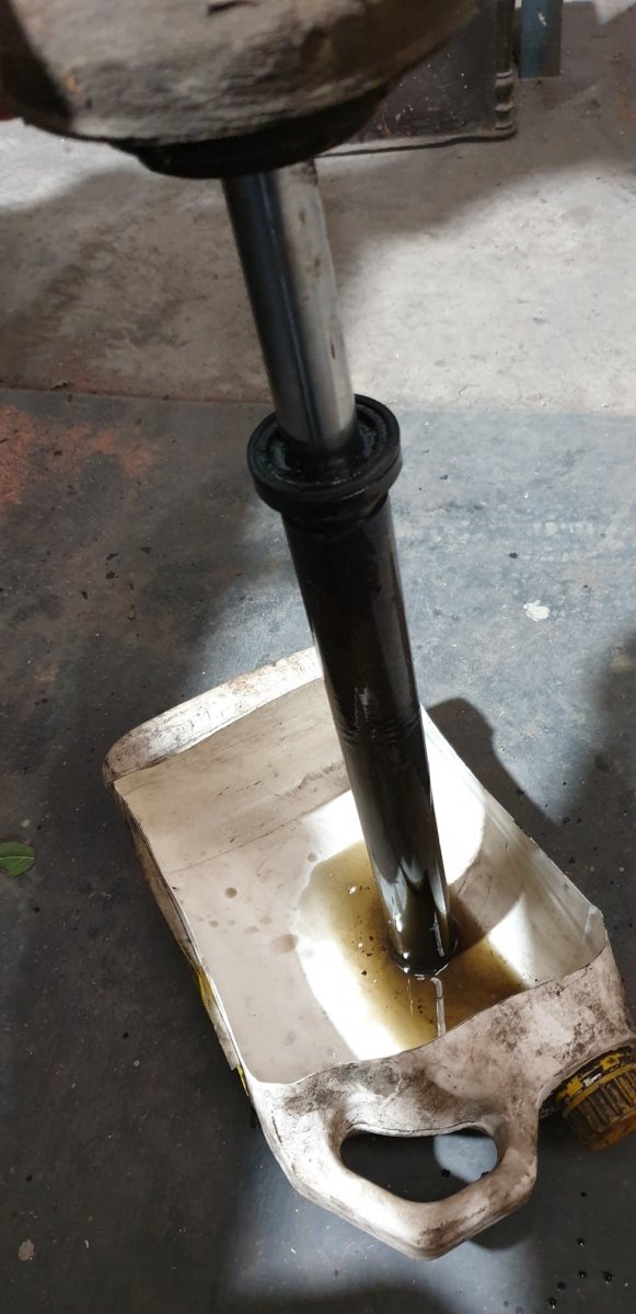

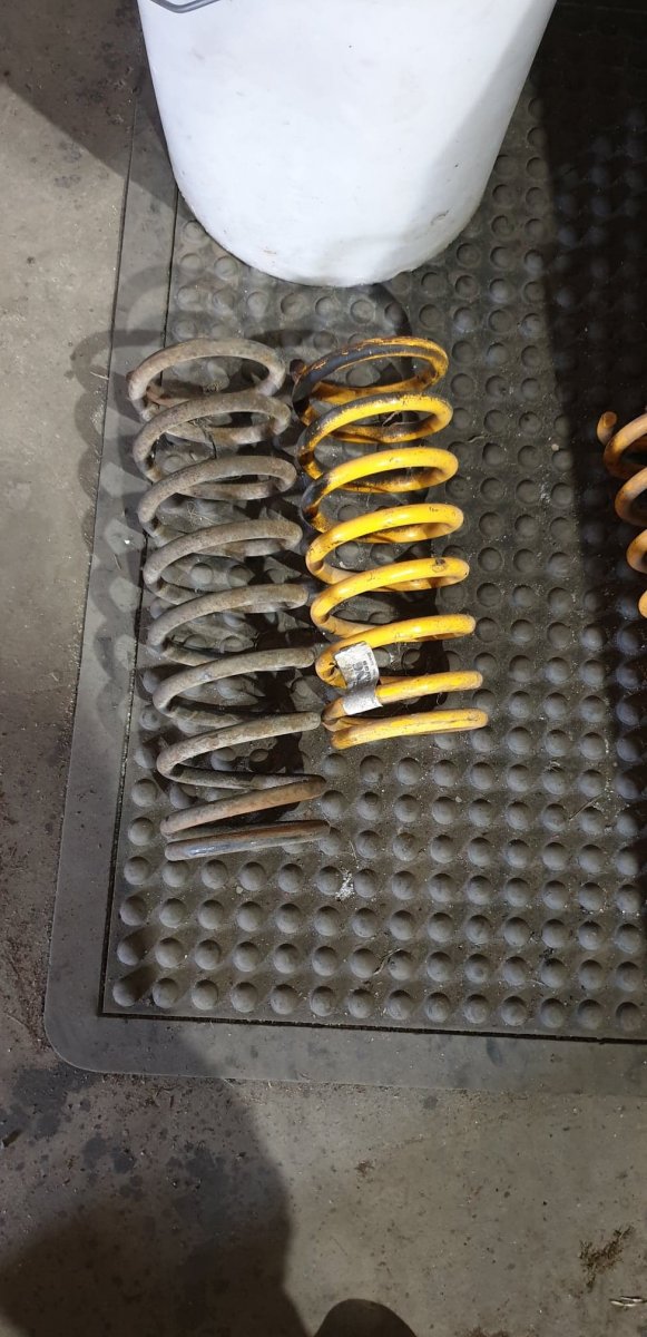

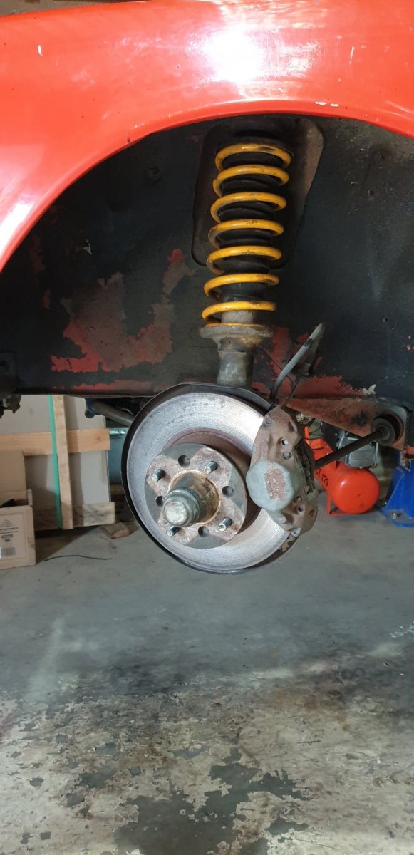

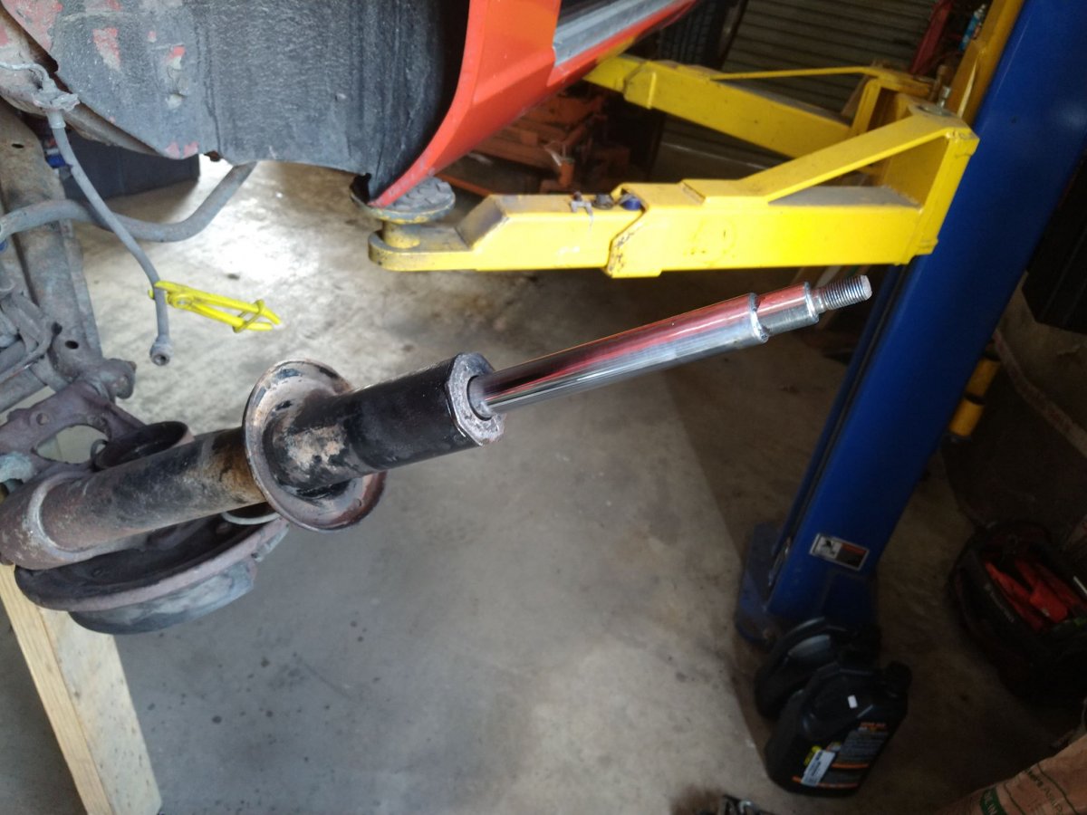

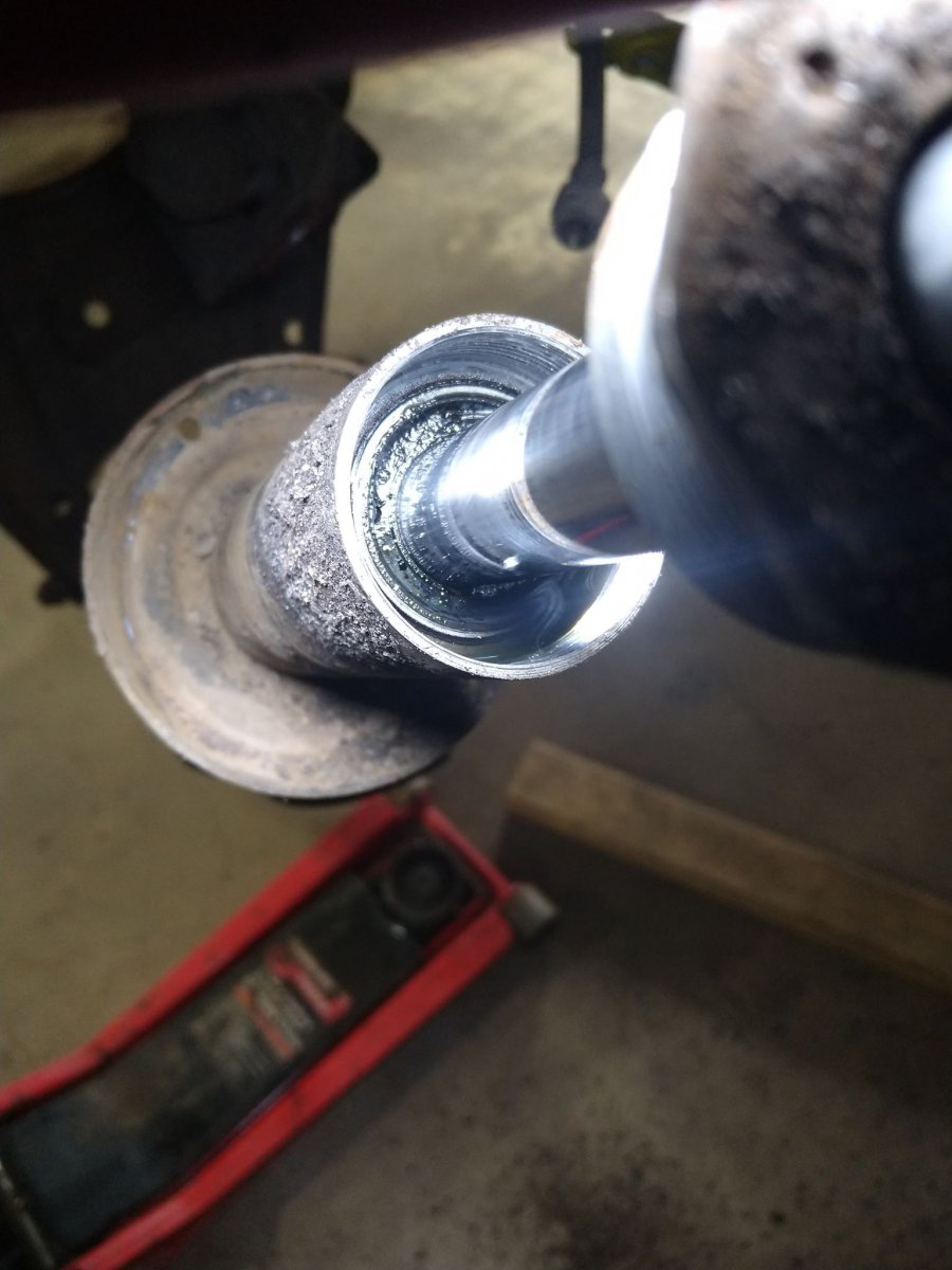

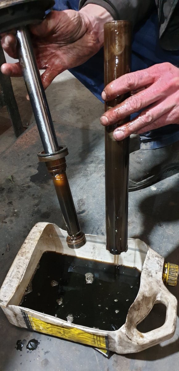

OdinZ Posted October 25, 2019 Author Posted October 25, 2019 So the weekend came along, and as I wanted do some work on the car too, well actually learn a few things, I went down for the day. We pulled the front suspension off and disassembled the wet-legs. There was only one wrench for this job! From the looks, and smell of things, the wet-legs had the original fluid inside of them! Yummy.... So we cleaned the tubes up as best we could, and put in some new ATF, and then put the second hand king springs on the fronts. We had to wait for the new rear springs & RH rear wheel bearing to come in, and they have now been installed. C.A.R. and AndBir 2 Quote
AndBir Posted October 25, 2019 Posted October 25, 2019 1 hour ago, OdinZ said: curious about whether I had the original "wet-legs" still on the car. I am sure mine still does, may have to look at doing an oil change as well :-) Quote
OdinZ Posted October 25, 2019 Author Posted October 25, 2019 4 hours ago, AndBir said: I am sure mine still does, may have to look at doing an oil change as well :-) I am yet to drive it, but Lachlan says it rides well! 6 minutes ago, lightmaster240z said: Looking better on the ground Ha.....just a little better. Thanks Bruce! Quote

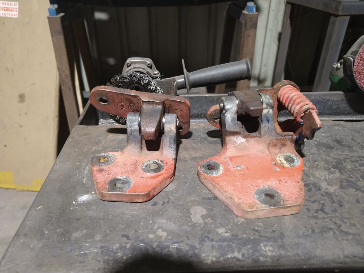

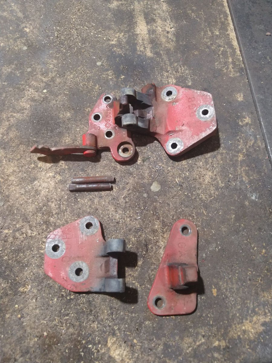

scotta Posted October 25, 2019 Posted October 25, 2019 Where did you source the door hinge pins from. I’ve seen some on eBay but quite expensive. Quote
KatoKid Posted October 25, 2019 Posted October 25, 2019 (edited) You can buy pins a bushes from Nissan Aus. They aren't specifically for a Z but are the same dimensions from some other model. Its in my build thread somewhere with part numbers. Found it! Edited October 25, 2019 by KatoKid OdinZ, gav240z and C.A.R. 3 Quote
